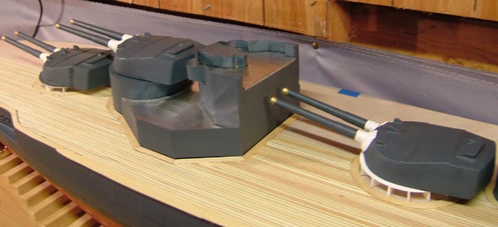

We are having a change tonight from planking, on ID we have some metal decks, I never like just painting over ply or plastic, I like to plate my decks, some times with cardboard but this time a new technique with the litho plate,
Looking like batman, this is the deck pattern of the rear superstructure when cut out, it is turned over and marked off like 8ft x 4ft sheets of steel, then it is scribed on the back lightly.
Next it is glued down using contact adhesive.
Combings are cut round the edge, at the back of the turret I have shown some riveting.
Opposite side.
This is the shape of the upper deck.
Turned over and a fold put in to it,
Fitted in place and glued down, now you can see where the fold went.
An overall view of the structure with the three turrets.
With this method you could plate a modern ship if you took your time, and would look effective.
enjoy.ARH :wave_1: :wave_1: :thumbs_up_1:

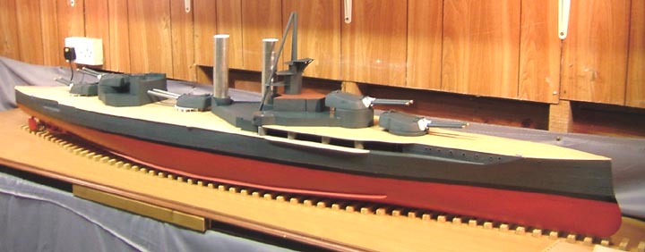

Hi Guys, I will continue with the funnel (smoke stack.)
The next step was to mark and cut out 4 rings .
The inner part was saved and glued on the the base of the stacks.
These were cut out on the vibro saw.
One ring sanded to shape, this is for the top of the stack. Ring fitted in place.
Cut from litho plate and shaped round , this fits inside the ring on top.
Fitted in place.
Steam pipes, made from aluminium and opened up at the top to make a flared opening, 2 brackets fitted.
Stern view, second top cowl fitted, and stack painted.
All top and bottom cowls fitted.
The forward stack had 2 steam pipes, but most of them were encased in a metal trunking, this was made out of a brass box section and super-glued to the stack.
enjoy, ARH :wave_1: :wave_1: :thumbs_up_1:

We will continue with the stack.
First the birds nest on the top, made out of wire and soldered.
Scribe a circle and divide it up into 8, at each point drill a hole. Then place each section in and solder.
Fitted in place.
Now we start on the lookout post and search light platform, first stage marked out on 1/64 ply. Cutting the same shape out of litho plate that fits under to re-enforce the structure.
These are the brackets that attach the structure to the funnel. Bent to shape and super glued in place.
First part in place.
Marked out and bent to shape, the metal protection, glued in place.
This is the floor of the search light platform, drilled ready for handrails and a quick paint, a little easier to do it at this stage, just one coat for now. Fitted in place, also p/e ladder.
A overall view of the work.
enjoy. ARH :wave_1: :wave_1: :thumbs_up_1:

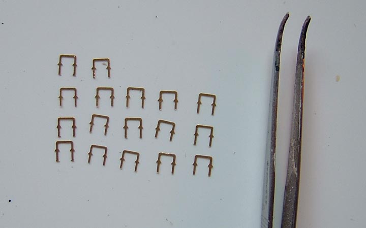

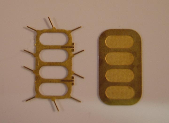

Hi Guys, We will continue with the P/E, this time it is water tight doors in 1/96. There are 24 doors and 24 thickening sections with the locking handles. These were �7.50 + p&p
The two sections cut out
Glued on top of one another.
One fitted on the bridge.
3 fitted on the lower deck.
These are hand and foot holds, they fit up the main support for the derricks to gain access to the top, over 40 were fitted.
This shot is not to clear, you can just see them in place, also 8 incline ladders fitted, handrails will be fitted later.
