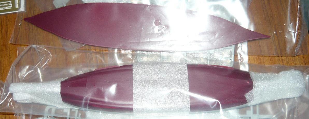

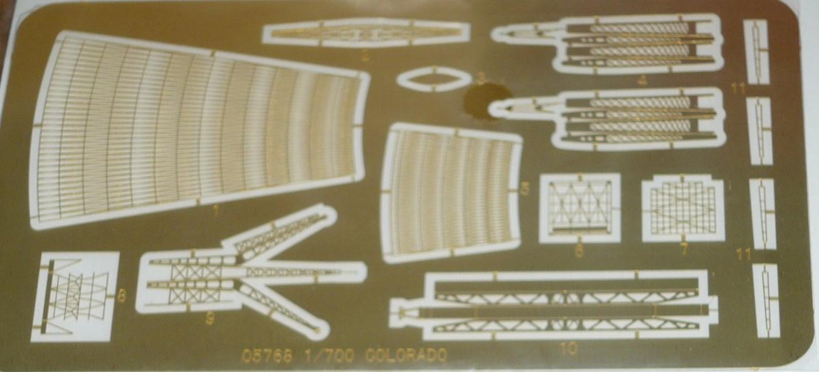

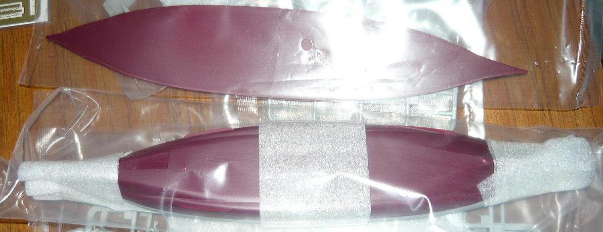

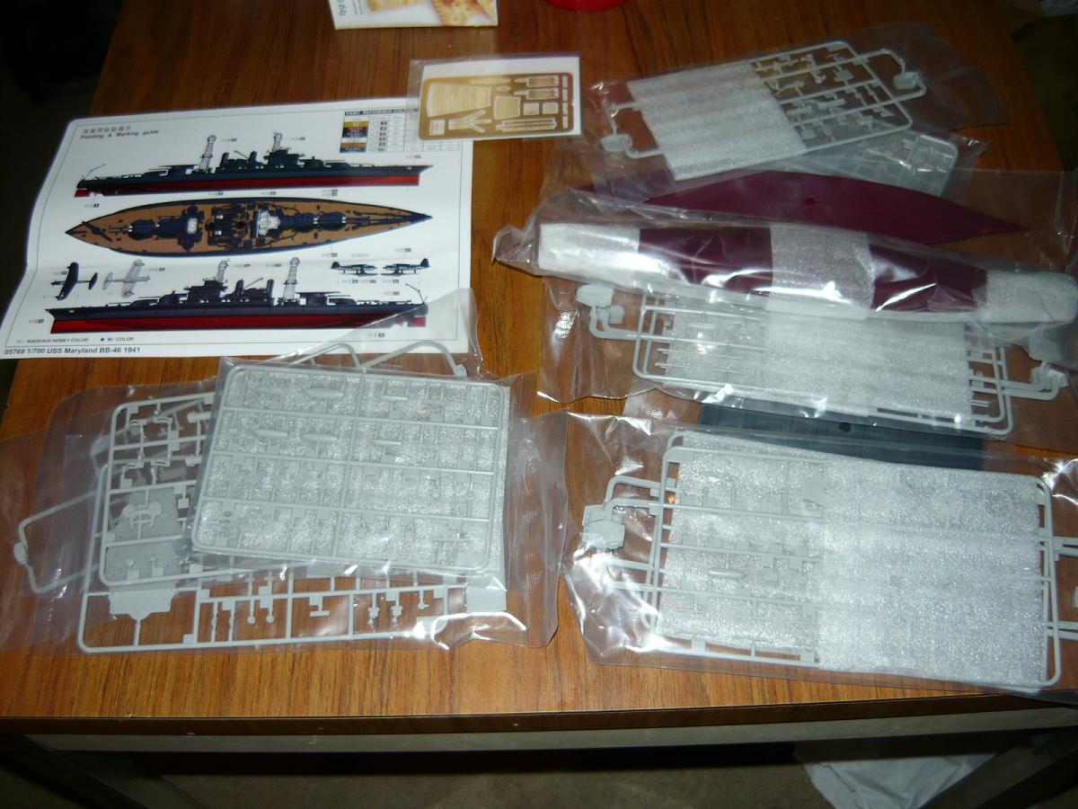

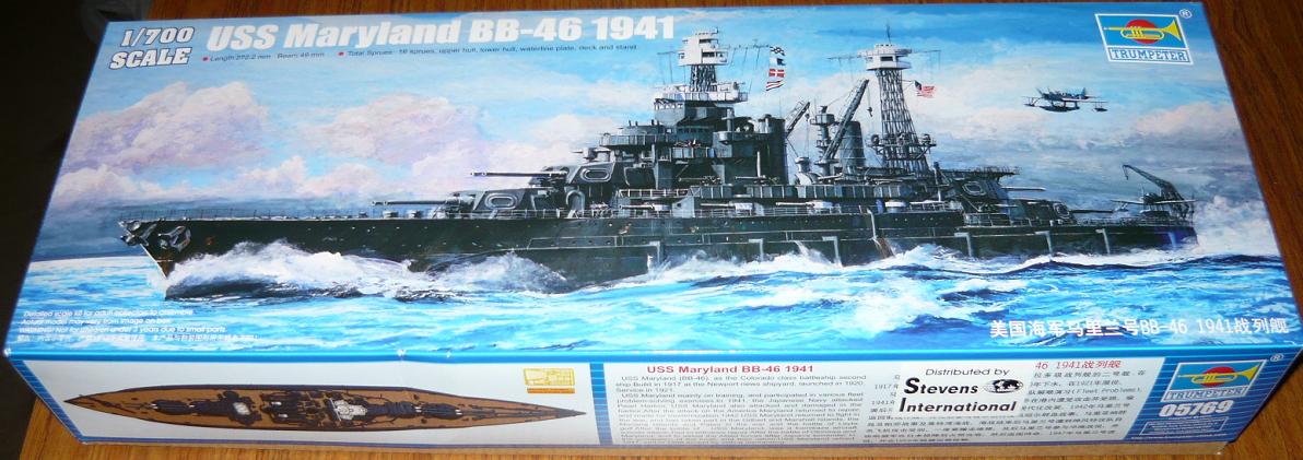

Just got the USS Maryland BB-46. Always wanted a model with Cage masts - the epitome of Battleship Majesty (always loved them) thought it would be 2 piece (split down the middle) plastic to glue together, but its brass - never worked with brass - any advice? Also can make it full hull or WL (I like WL cause it sits easier & I can visualize better what the real one looked like)

I find most battleships, no matter how good looking in pictures, end up looking a bit "fat" as full hull builds. Maybe an as-built Maryland could be full hull, but a 1941 version with those bulges (bear in mind Trumpeter's bulges are also way too big to be accurate) is not appealing. Make her waterline (I did
The kit is great overall but the PE is quite soft and a bit fragile. I have worked with PE before but never cage masts so this was a bit new for me also.
For the cage masts, basically you need a tapered tube, something like a pen or a fat paintbrush handle will do provided it has a constant slope from one end to the other. Then you just roll it up. Like I said it is very soft so it will roll readily. Do it slowly and carefully, it is MUCH harder to undo if you roll too far. Once the seam touches, run some CA glue down it to finish it off. You will find once it's glue up like this it's surprisingly stiff and strong (the shape is very good structurally, hence why it was used). Still handle it with care as you can dent it and make it oval if you fiddle with it too much. I would not roll them up until you are also ready to stick them to the hull. Again, use CA for this as nothing else will stick brass. Position it carefully because it sets super-fast so you don't get a second chance.
Also, always paint all the PE on the fret before trying to remove it or put it together.

what I was afraid of.Vlad wrote:the PE is quite soft and a bit fragile.
ah - thanks for the tips (all of them.)Vlad wrote: ...use CA for this...always paint all the PE...before trying to remove it

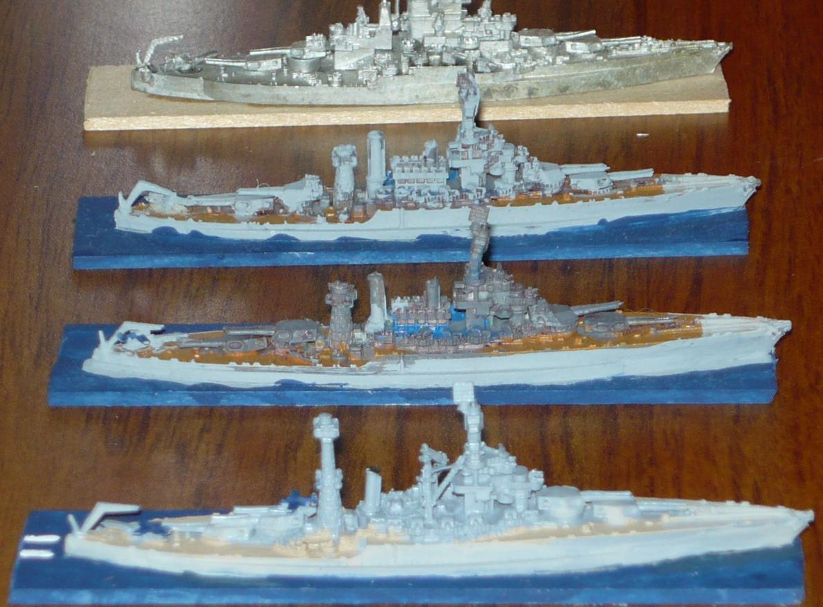

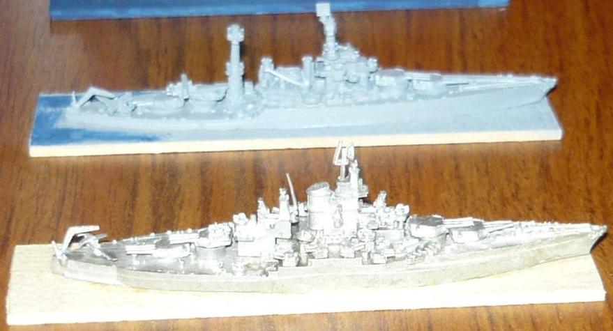

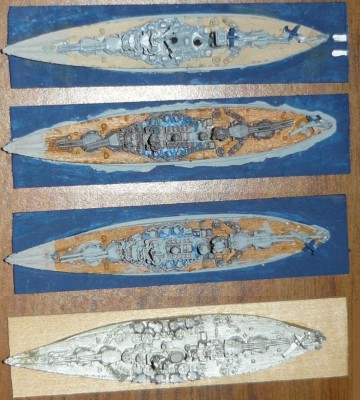

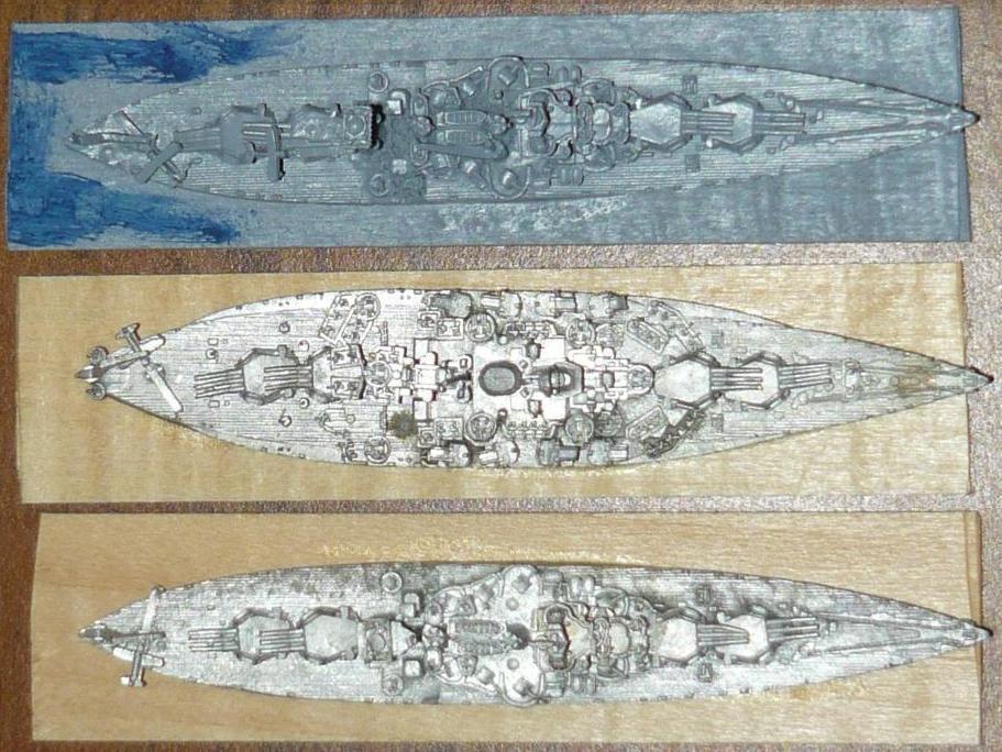

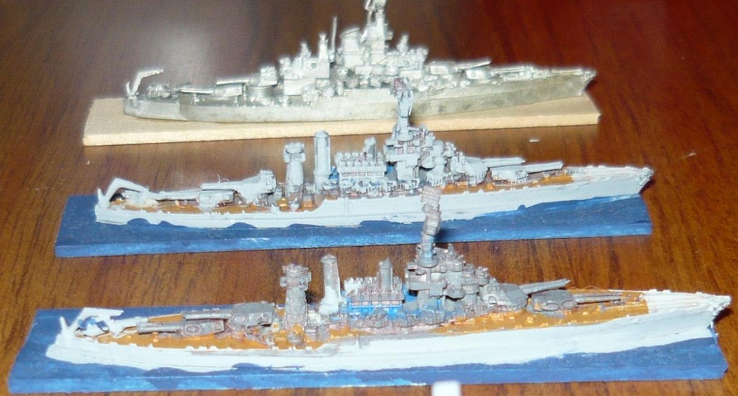

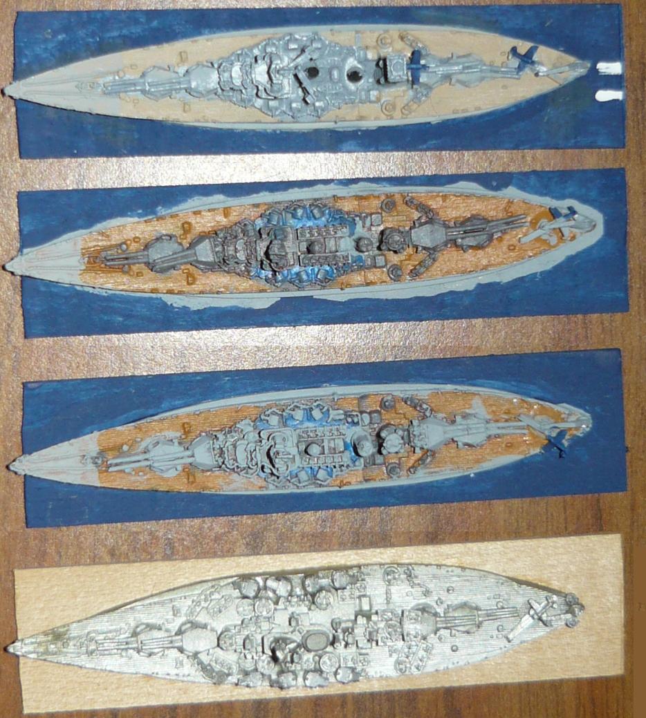

did they combined my post with this one??? - I didn't know what this post was - (Maryland was a Colorado class, though Maryland got in the water first {due to delays} Colorado was ordered & numbered first - BB-45 Maryland was 46 - despite what some
publisher in England claims
)...anyway...Here's my 2400 scale - still working on WVs paint.

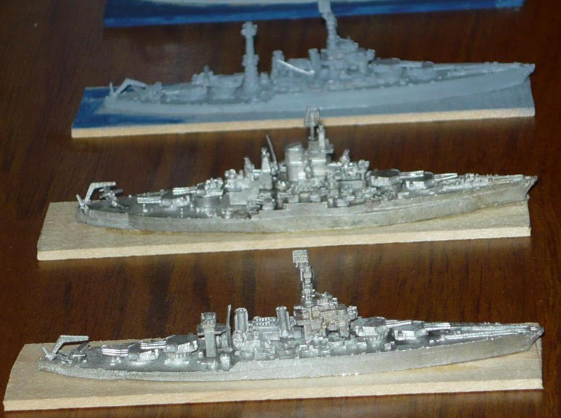

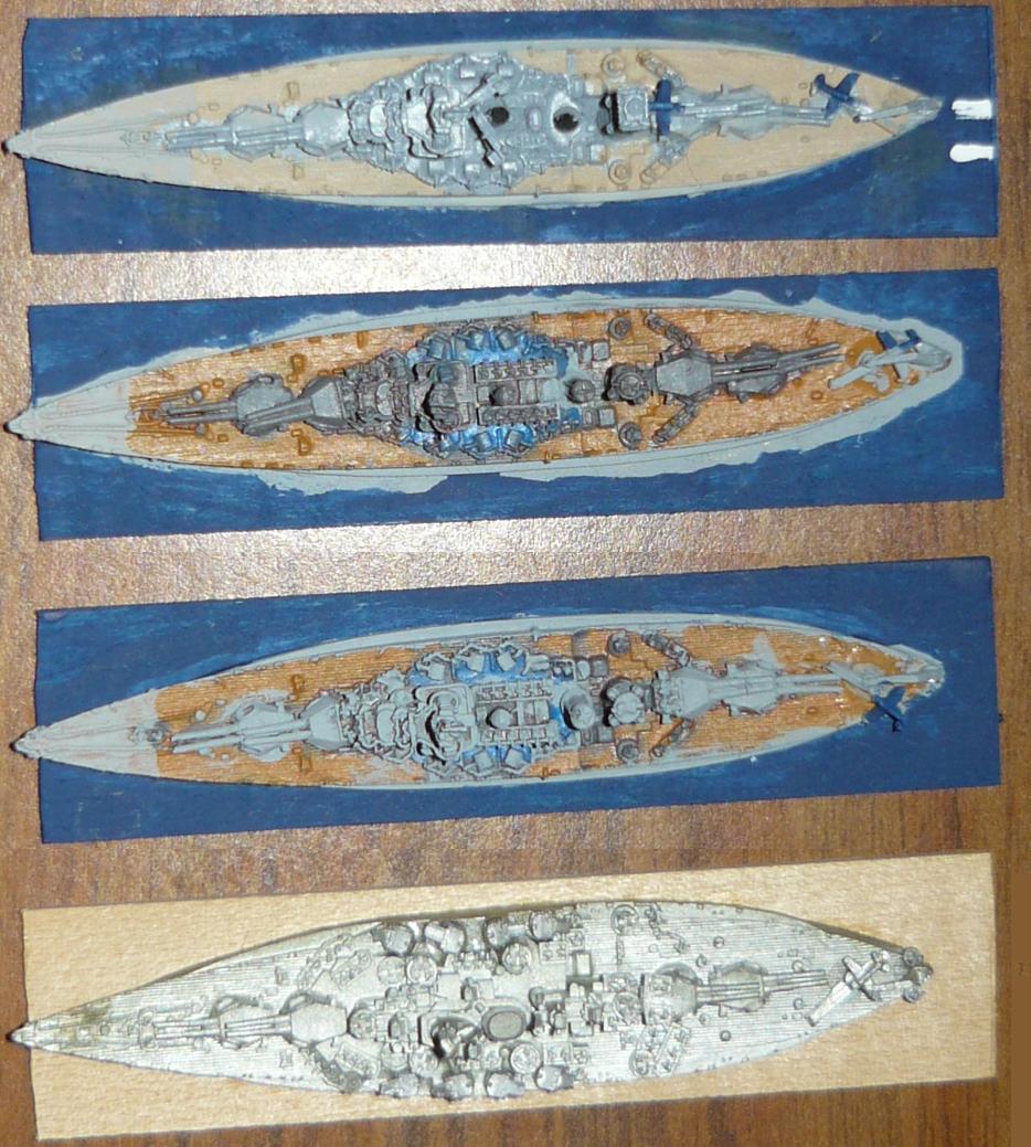

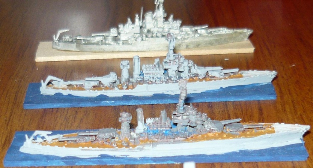

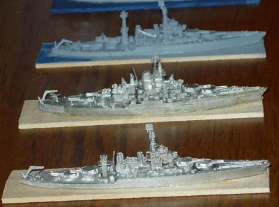

oh, yea - I guess - heres my Tennessee's as well - paint in progress.

Don't know exact - but you can see from my minis above Ml. & Col. received much less extensive bulging than W.V. (Or Cal. & Tenn.) - theres were as wide as the Mk38sAndrew D BB39 Sec wrote:Any idea of the specifics of how wide the torpedo bulges should be, then? Beyond just eyeballing it for TLAR ("That Looks About Right...."). 3mm? 2?

You can see that above (prev page) - if you look at my top pick - Maryland '44/5 is the bottom painted next to unpainted WV you can see the tan main deck & to the sides are the tapered bulges in grey.Dick J wrote:...Maryland and Colorado blisters increased beam...at the waterline. It tapered in somewhat above the waterline...
