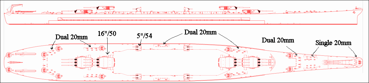

Ok gents, here's a little teaser for y'all:
Thats the beginnings of my USS Montana design.
so far she ships:
13 quad 40mm bofors mounts
28 dual 20mm mounts
8 single 20mm mounts
4 triple turret 16"/50 mounts
4 dual 5"/54 mounts
She'll carry 6 more 5"/54 mounts and several more 40mm and 20mm mounts. What do you guys think so far? Any suggestions for the bridge/superstructure? I could provide a USS Iowa vs USS Montana comparison drawing if anyone wants.
so far she ships:
28 dual 20mm mounts
4 dual 5"/54 mounts

That's as far as I am at the moment. A few questions if I may though,wr wrote:Get rid of ALL AA aft of 'Y' mounting, except those at the stern.
Get rid of ALL single 20mm.
Pull in tight against the bulkheads, those 40mm mounts that are appropriate.
May we see the rest of the layout?
Why get rid of the AA aft of "Y" turret?
I can understand getting rid of the single 20mm
Now, about pulling in the 40mm mounts tight against the bulkheads, wouldn't that limit their firing arc? I would think that having them out in a more open space such as this would provide a better arc giving a better AA protection.

Abram,
She's lookin good!
Now, you asked, so, here's the comments:
1. Hull Contours. Your front end is very long and very narrow. That would get you a higher speed, but you'd only be able to use it in fair weather and calm seas. The Iowa class was strongly criticized for being so wet up front due to the forward section being so slender. Your design looks proportionally even longer and narrower than the Iowas, which, combined with being longer and heavier, would lead to some majorly serious problems with even moderate seas. She'd have to slow down to avoid driving the bow clean under, and probably everything back to and including A turret would be unservicable and possibly damaged. The other weapons would suffer from reduced accuracy due to the amount of pitching the ship would do.
2. Beam (lack thereof). This is an inherent design flaw with the Scheme 8 design. They are just too narrow for their length, and will roll easily. Bismarck & Tirpitz were noted for being exceptionally stable firing platforms with regards to rolling and had length to beam factor of 6.97. (length divided by beam) The Iowas were somewhat stable with a factor of 8.21. Fletcher class DD's routinely rolled thru 40 degrees with a L/W factor of 9.64. The numbers you listed for your MT give you a factor of 8.4. The lower the number, the less rolling. So, while you're not as bad as a DD, you'll still roll more than an Iowa.
3. AA. Personally, I see no reason to delete any of the AA mounts on your plans. The only suggestion that I can make is this: If you're going to make twin 20's, then go with all twins and don't bother with any singles at all.
That's about it.
Bill
She's lookin good!
That's about it.
