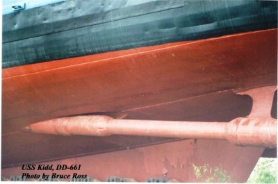

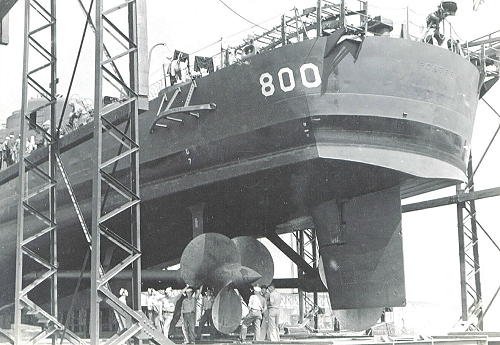

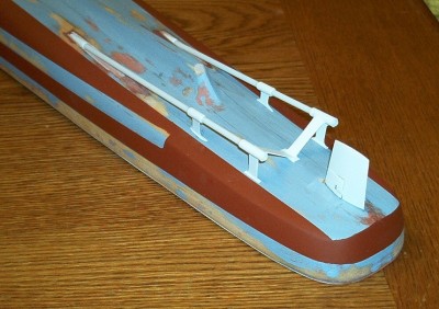

Rudder, propeller shafts and struts have been fabricated and installed.
The rudder has a working hinge though I may fix it in position to keep it
from swinging freely. The real ship's propeller shafts were painted. Had
the real shafts been left natural steel as they are on many other ships, I
would have used aluminum tubing instead of styrene. Styrene tubing is
easier to work with and since the shafts are to be painted I chose styrene.
Also note that on a Fletcher, the shafts exit the hull offset; one shaft being
longer than the other. This is due to the machinery and engine layout
inside the hull.

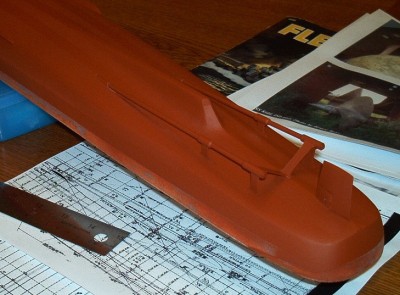

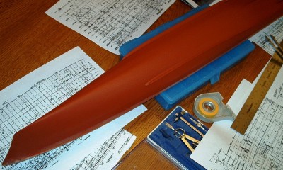

Hull plating has begun. The real ship's hull plating is 1/4" thick steel. In
1/125 scale, 1/4" = .002 inches. Since that's pretty thin I chose to
replicate the subtle plating by making the raised plates from thicker
layers of primer.

Hi Steve,
Being an ex Stoker, I am always interested when it comes to fitting the running gear. It was quite unusual for prop shafts to be off set and you have replicated this quite well.
I always use car body Red Oxide for my hulls. Red Oxide is what is used now on real ships, although years ago, it was in fact Red Lead, which is now banned.
Nice update Steve, I look forward to more progress on this model.

Hi Steve Are you using a shell expansion drawing for the plating? I found when plating Rurik that having no shell drawing made the whole job very problematic and left me rather uneasy as to whether I was correct or not but having a good library of books on ship yard practice helped enormously. I eventually ended up using gum strip paper at around 20thou. The laps are almost invisible which at 1:96 is as it should be. I enjoy very much your postings as you also deal in styrene a medium I use often.

Ah yes, red lead, not red oxide. Correction made to the post above! I do remember a fun movie called "Operation Petticoat" starring Cary Grant and Tony Curtis where a Gato/Balao class submarine is hurriedly repaired
using the two primers available at the port: red- and white lead leading to a pink boat. Very funny movie.
Yep, thanks to one of my heroes, Bruce Ross, I am following scans of a Bath Iron Works shell expansion drawing for late war Fletchers built there. Photographs of DD-804 and others built at Seattle-Tacoma show slight differences in the stern plating but the rest looks identical. The overlapping stern plating for those built at BIW is a distinct
band that runs round the transom. Seattle-Tacoma ships' plating appears to wrap around the bottom (and the bottom corners of the transom are rounder - not as pointy as BIW-built ships). You can see in the photo of the model above how the red overlapping plating wraps around the bottom.
Yes, indeed. Bruce Ross was kind enough to send me shell expansion drawings. It made life so much easier. Love your Rurik!Dave Wooley wrote:Hi Steve Are you using a shell expansion drawing for the plating? I found when plating Rurik that having no shell drawing made the whole job very problematic and left me rather uneasy as to whether I was correct or not but having a good library of books on ship yard practice helped enormously. I eventually ended up using gum strip paper at around 20thou. The laps are almost invisible which at 1:96 is as it should be. I enjoy very much your postings as you also deal in styrene a medium I use often.

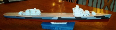

Hull plating is complete.
The hull is now ready for anchors, hawse pipes and painting. The area
below the boot stripe will remain unpainted red primer.
Also visible are the offset propeller shaft openings.

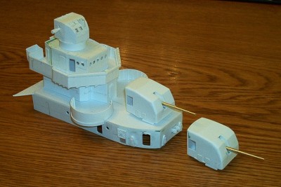

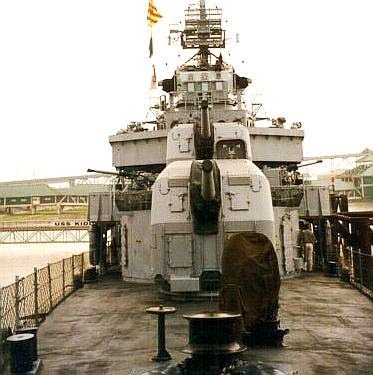

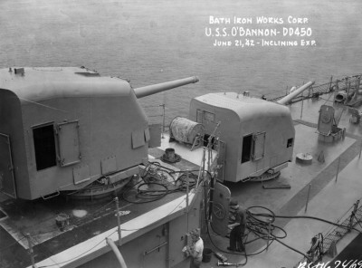

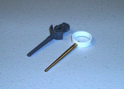

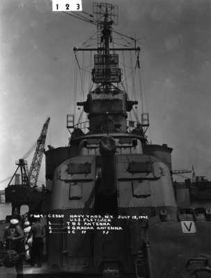

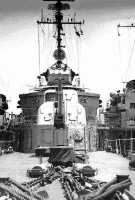

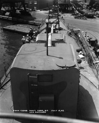

Replacement brass 5-inch/38 caliber main gun barrels turned by Steve Nuttall.
- The real gunhouses were asymmetrical; the gunhouse is larger on one side to accommodate the additional crew on that side (the fuse time-setting mechanism was on just one side of the gun and thus the crewmen who set the fuses needed additional space to work). The centerline of the barrel, however, is exactly above the centerline of the barbette.
- Photo courtesy Bruce Ross.
- 661kidd 7a.jpg (50.38 KiB) Viewed 1277 times

Nice observation there Steve, of the correct barrel alignment, something that many modellers would have not noticed. The barrel is certainly an improvement on the one from the kit.
Good upgate.
Some of the fittings I have for Victorious, are a bit crude and will need some altering to make then look better, eventually.

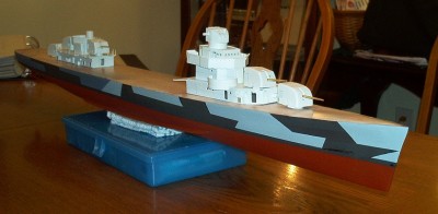

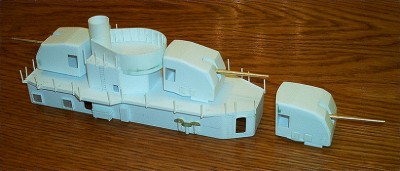

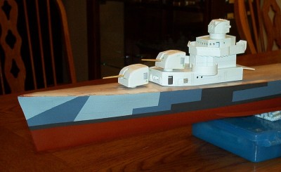

Replacement barrels installed. Detailing the gun- and deckhouses
continues.

Thanks, fellas! Abe your Liberty Ship is looking great. Les, I will certainly check out those rails. Thanks for the tip!

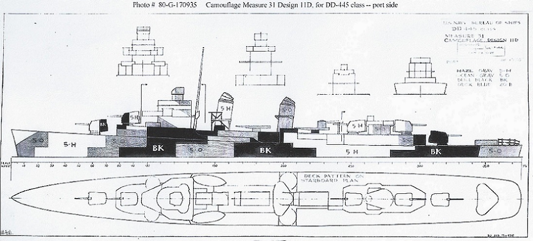

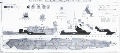

Hull is painted. I just love camouflage. There is some touch-up to do. The flat "red lead" below the waterline and the flat black are simply automotive primer sprayed from a can. I really like the slightly brownish look of red automotive primer for use in painting the bottom of model ship hulls.
The lightest color, Haze Gray 5-H, is actually Model Master "Light Ghost Gray" which looks less violet than their Haze Gray and better to my eye. The medium gray, Ocean Gray 5-O, is Testors Poly Scale Ocean Gray 5-O. Neither was toned down for scale effect. These two colors were airbrushed using a Badger 200.
The colors were masked with Tamiya Masking Tape (very good stuff).
- Photos of Seattle-Tacoma Fletchers painted in Ms. 31 11D indicate that the port bow scheme is slightly different than the measure specified (see bottom drawings). Although I did not have photos of the port side of DD-802, I did for one other Seattle-Tacoma Fletcher painted in this scheme (USS Rooks DD-804) so I assumed Gregory was painted similarly and went with it.

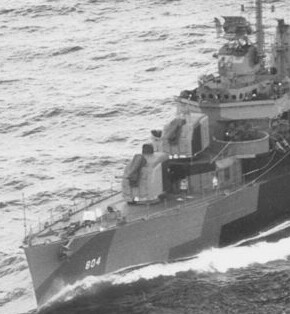

- Seattle-Tacoma-built DD-804 in Ms. 31 11D. Note the variation in the Ocean Gray wedge near the bow.
