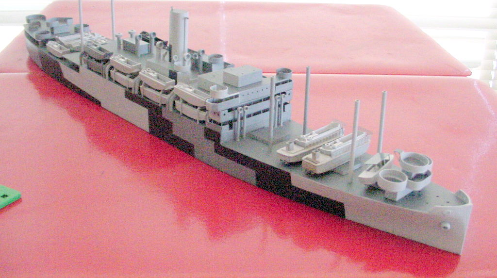

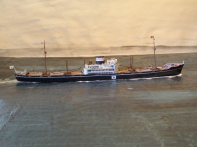

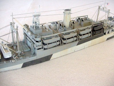

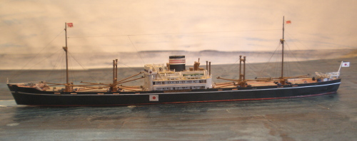

APA-12

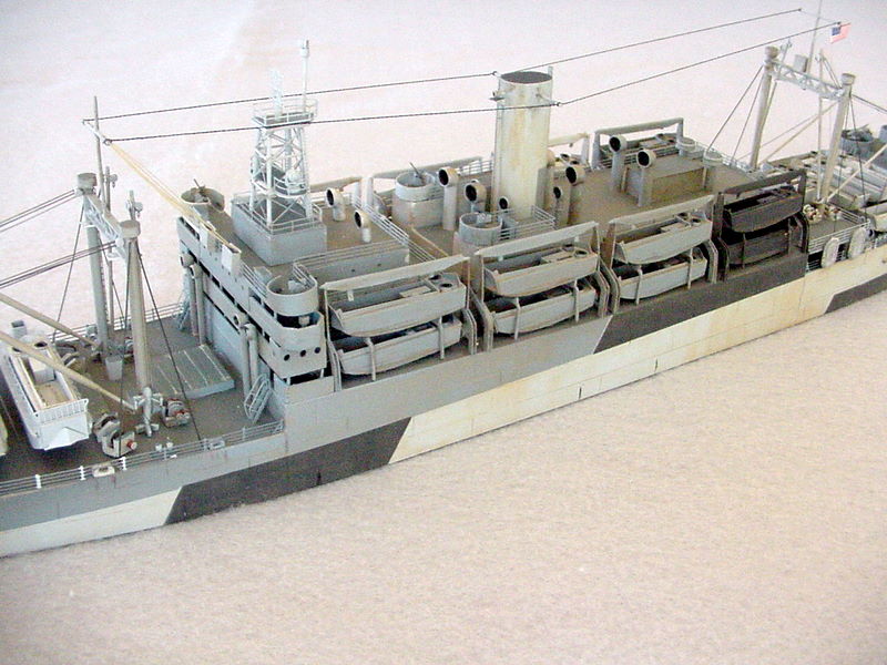

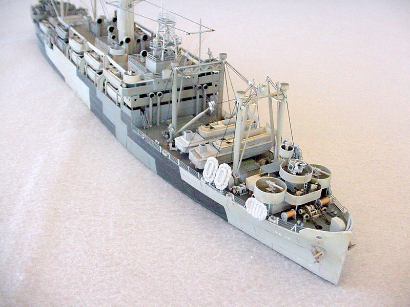

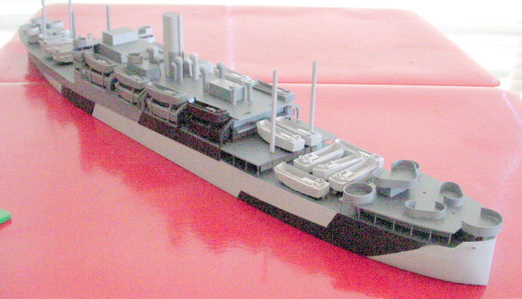

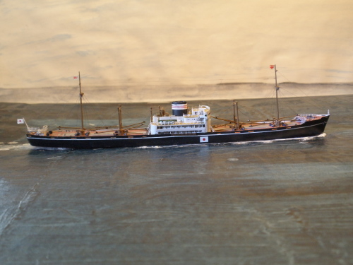

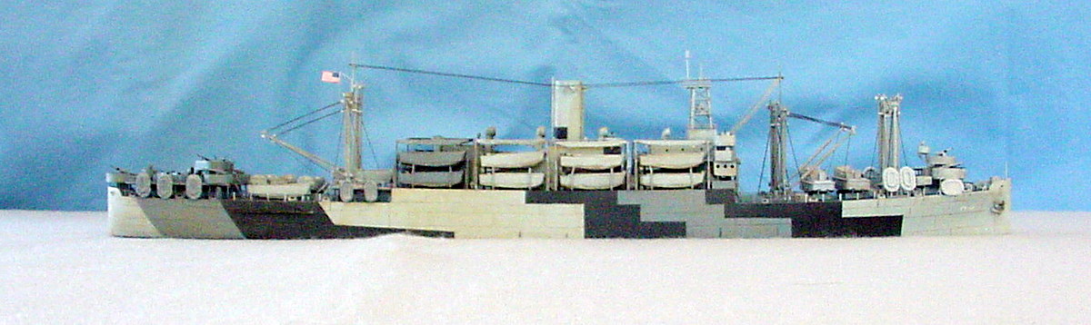

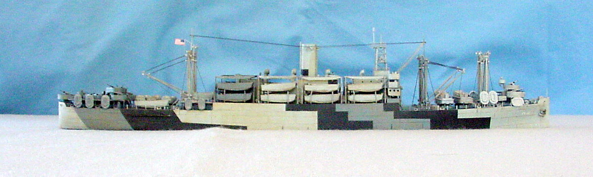

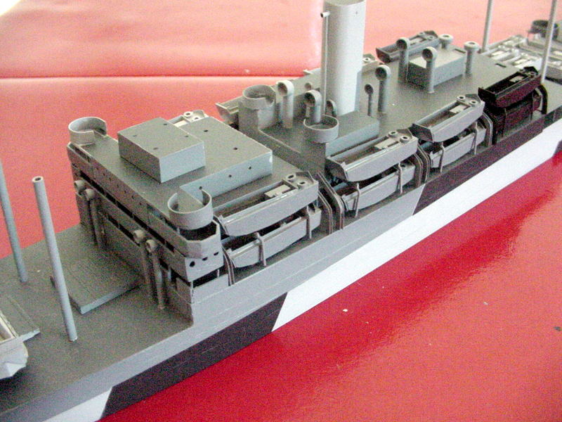

The ship after painting, most major parts dry fitted - the first approximation of what she will look like. Still to go...fixing, weathering and all the details. Am happy with the result to this point.
Pic 1 is the goal, pic 2 to 4 is what there is now.

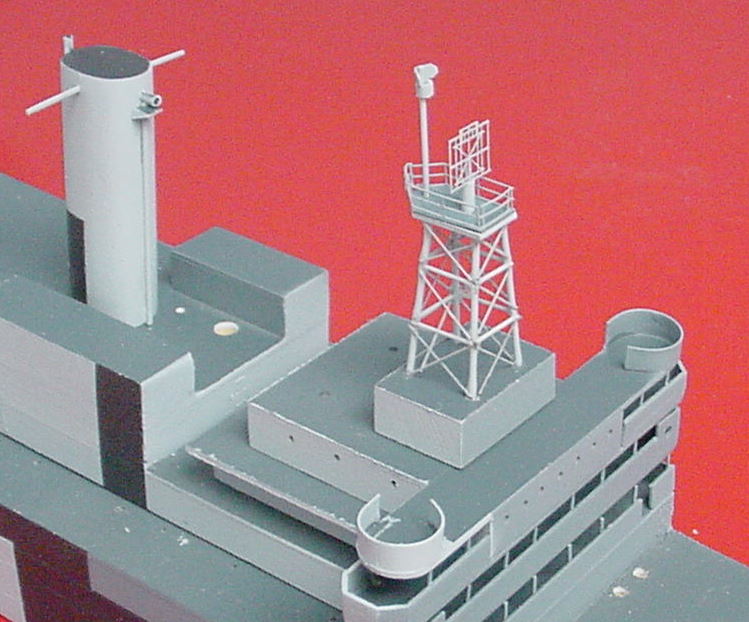

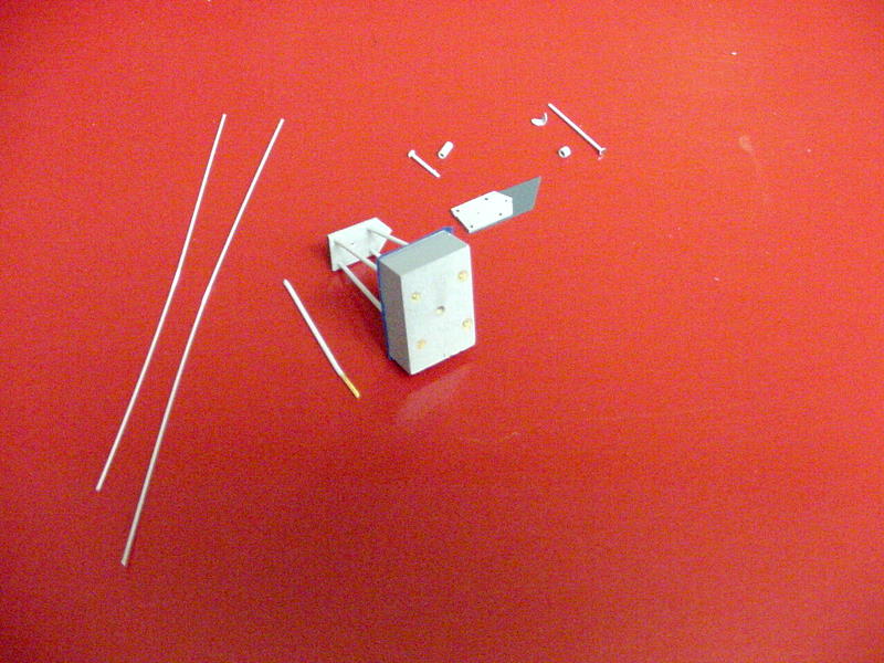

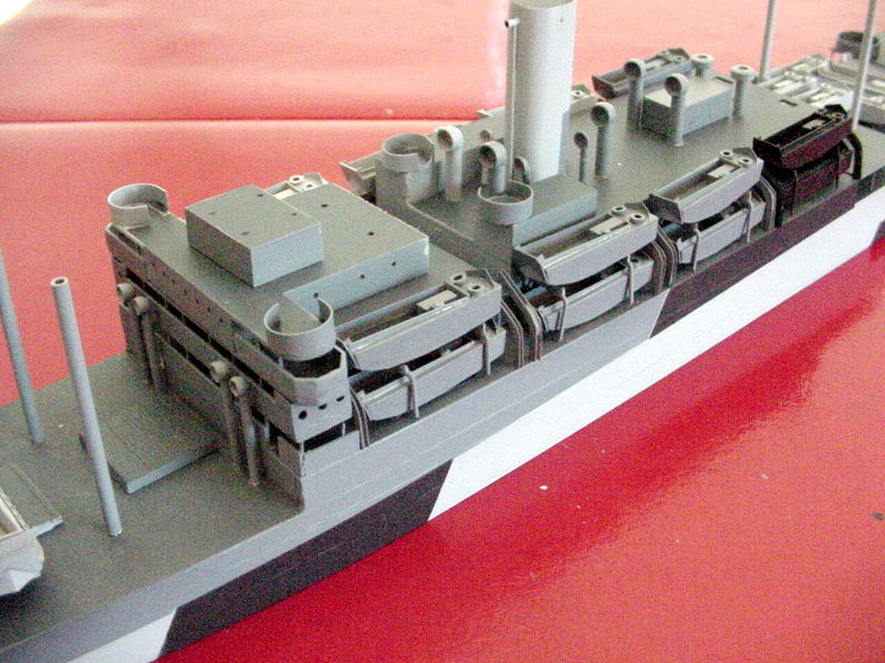

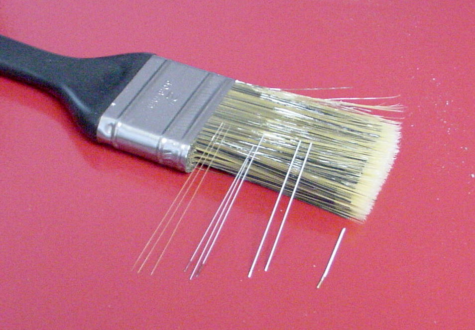

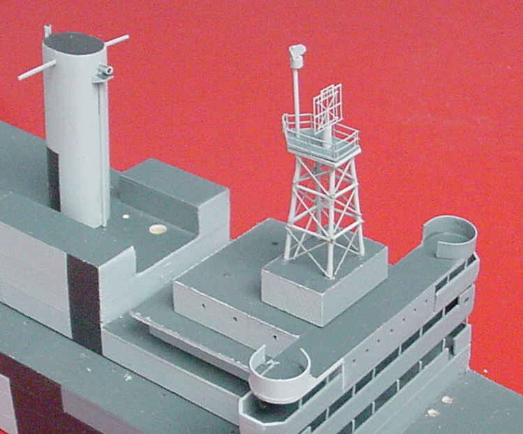

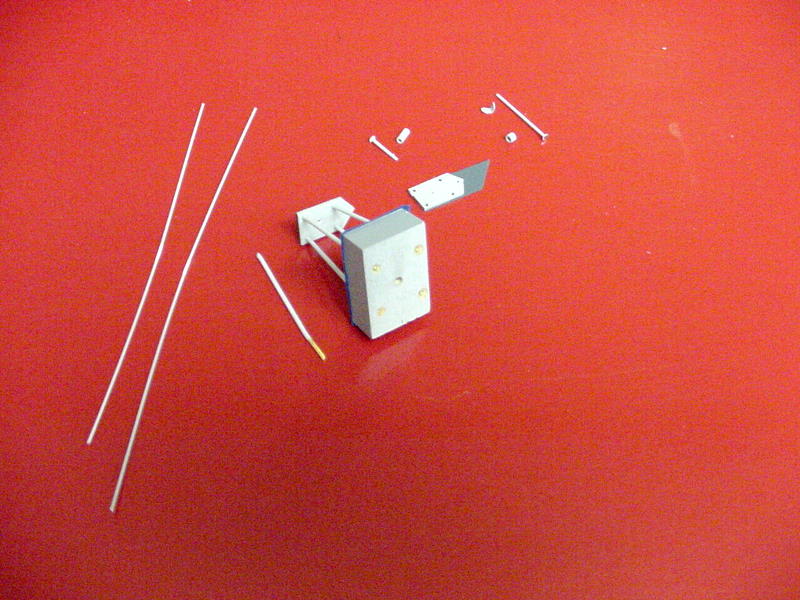

The radar tower, or what you do when there is no PE.
Pic 1 the paint brush, from the left
........008" bristle, unpainted is stiff manilla line, dyed with a black Sharpie is stiff steel cable.
........014" black bristle, painted for use as the diagonal brace.
........025" styrene rod painted for horizontal beam.
........035" brass rod painted for vertical column.
Pic 2 assembly
Pic 3 roughed out, in place.
Pic 2 assembly

Great mast & radar Jim (the radar itself is PE, right?).
Inspiring model
Inspiring model

The air search radar is definitely PE (no way I could not duplicate that) , if I had or could have found a PE tower that was close, I would have used it. But necessity is the mother of a scratched out part.
