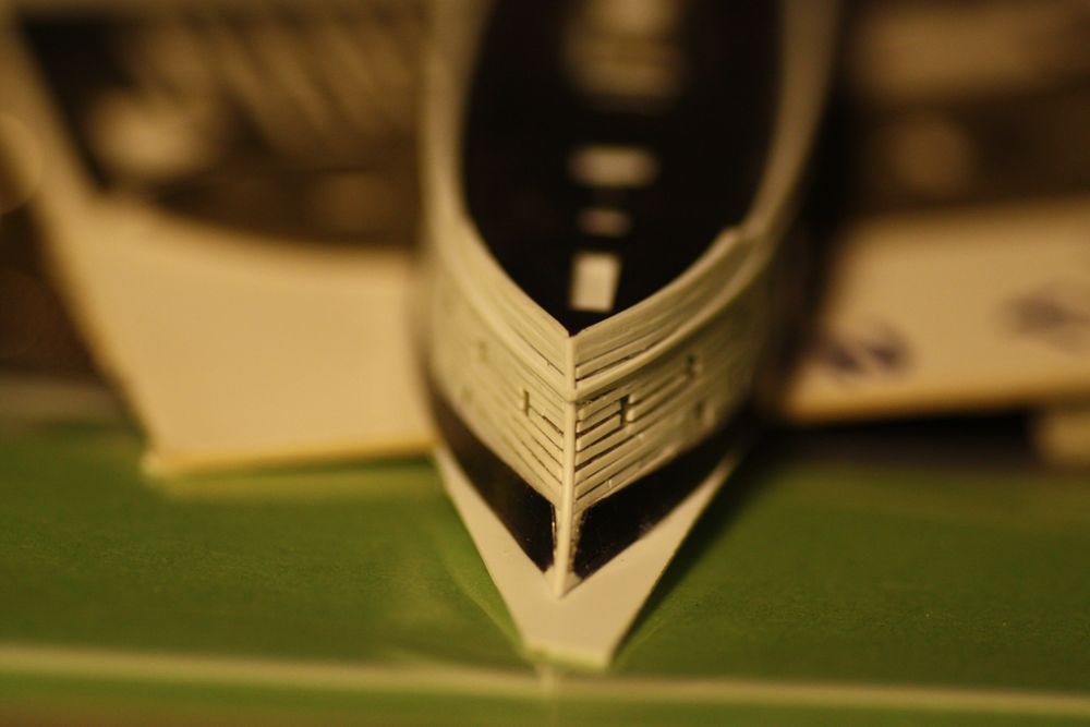

Bending wire to shape for the bow.
Bow arc in place... it worked! :woo_hoo:

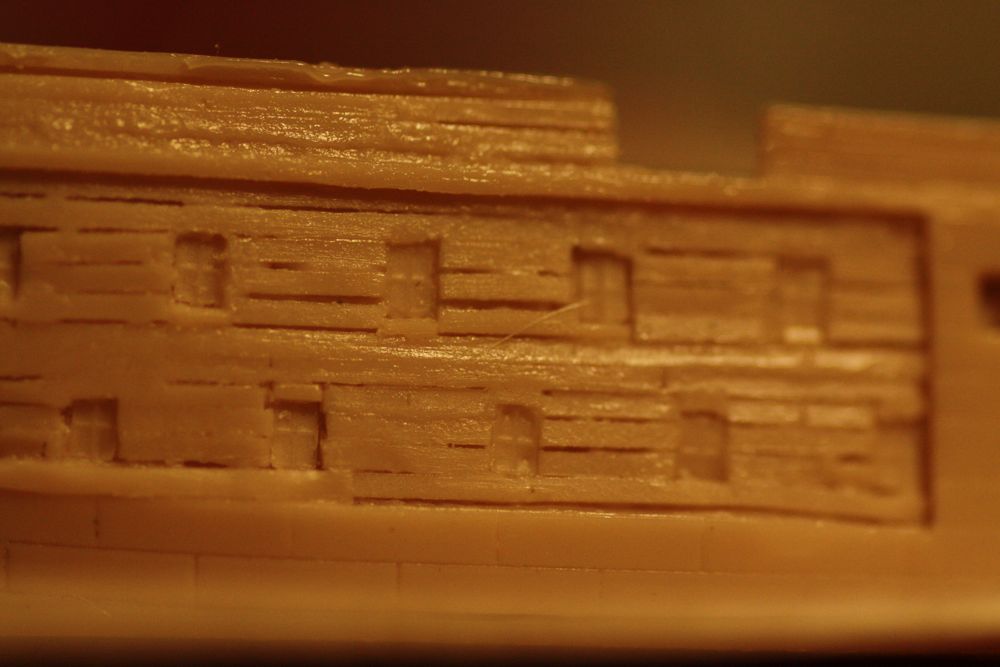

Detailing the lower wales. The actual ship had two rounded wales here. The only way I could think to reproduce them was again with brass wire.
Very difficult to fit two brass wires close together with CA and make them uniform as well.
Not uniform.
I decided to remove the brass wire and leave the styrene strip in place. This particular detail defeated me. :heh:

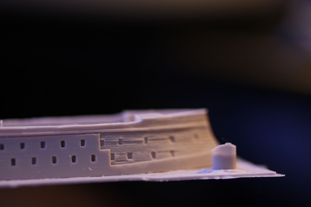

Cast #1. Now on it's way to France. This was my first look at the payoff for two months of work.
Bulwark detail did not cast well. The thin brass wire detail did not survive casting intact.

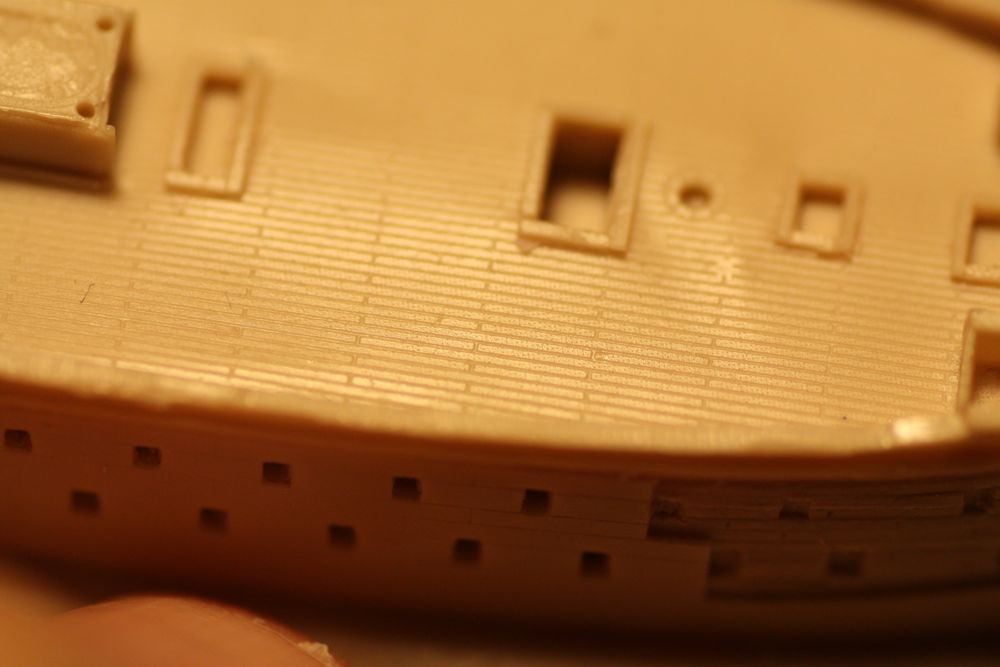

Deck looks good.
Funnel a bit rough but with nice delicate sides. Could be cleaned up with a little sanding.
Armor detail came out nicely.
Armor plates very difficult to photograph, and can only be seen in the bare resin by creating a sheen on them.

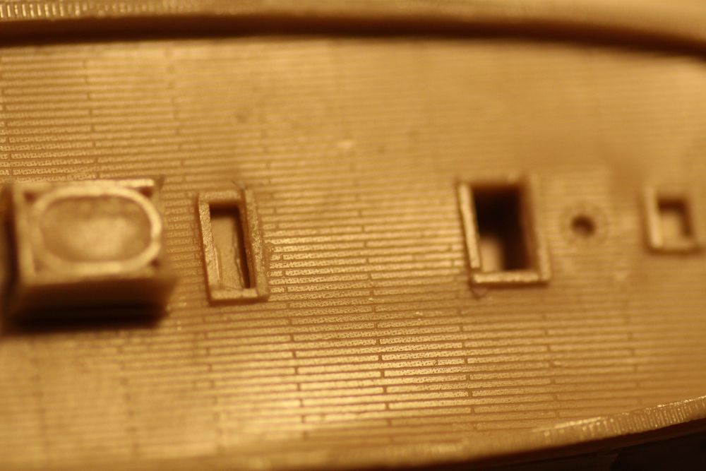

Planking detail.
Closeup shot of deck.

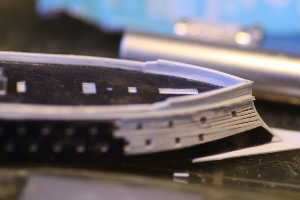

Port quarter bulwark damage. The reason for this is that the brass wire, although secured to the bulwark was not completely sealed to it, and came away in bits after casting as a result... another lesson learned. :heh:
Bits of mold material sticking out of different nooks and crannies...
