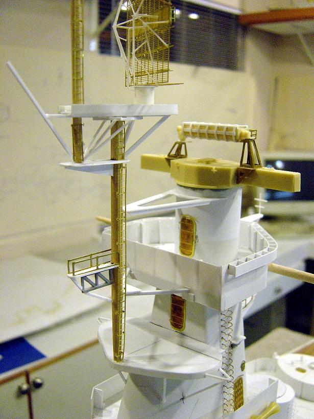

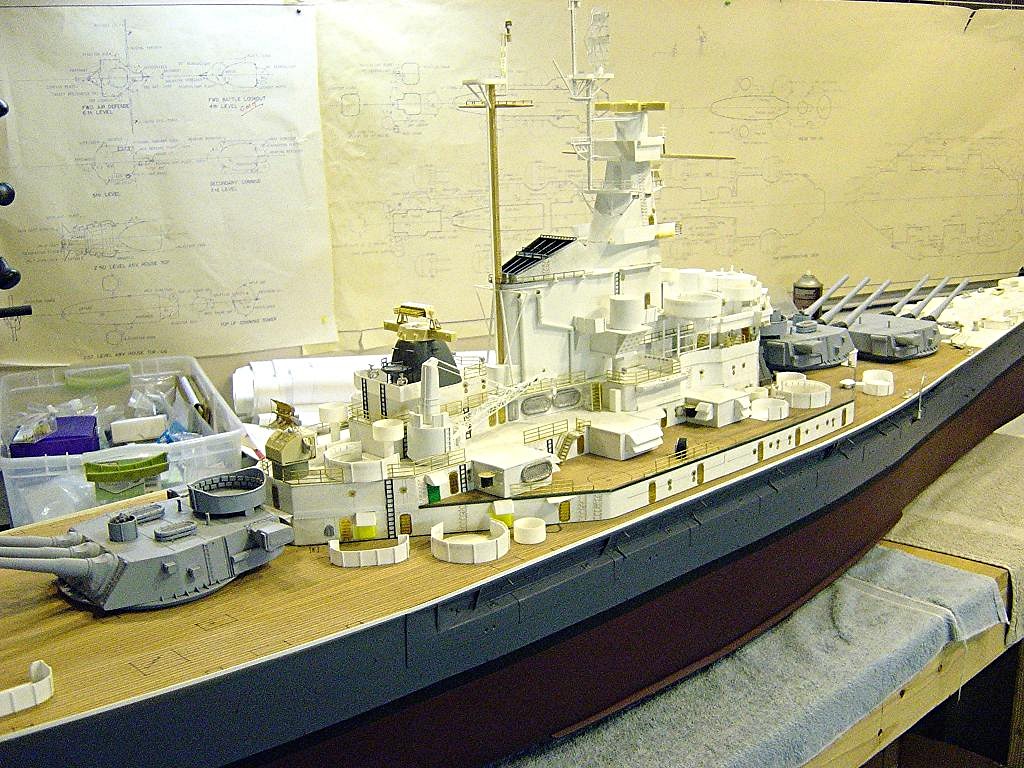

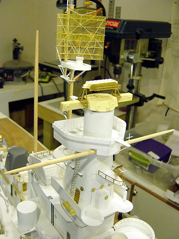

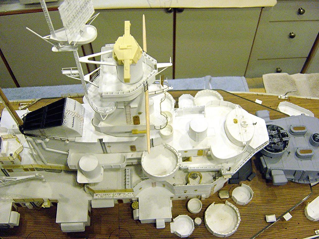

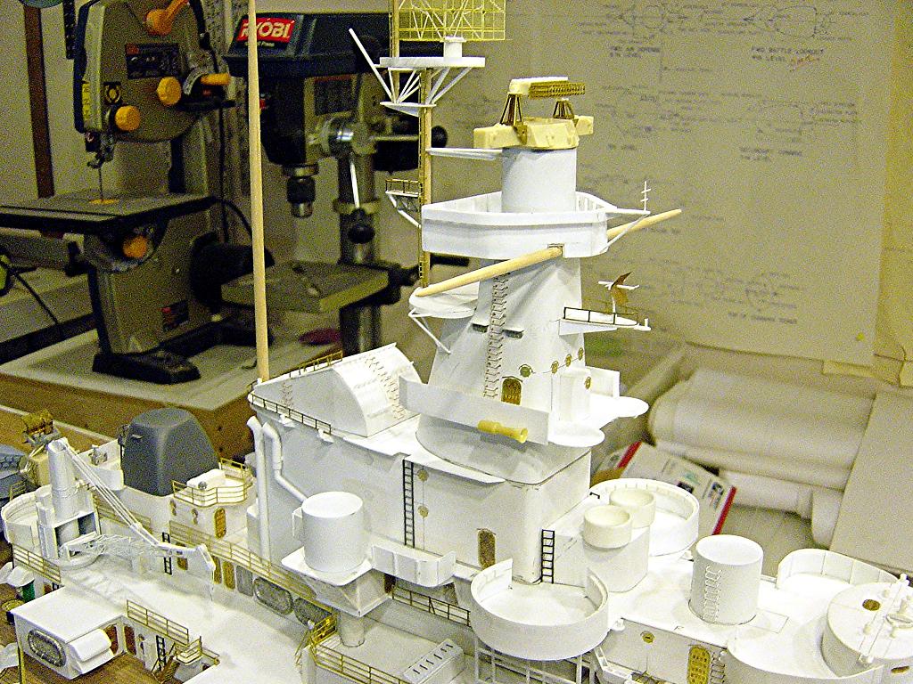

Hello again all! :wave_1: Work continues on Indiana's superstructure. I am happy to say that now all major sections and levels are completed. A few small details to add, but most of the major work is now finished. There sure is alot of platforms and different levels. I did'nt fully realize how many until I started to build them one by one. Let's take a look.................
Here is a stb. view of the work completed on the fwd. citadel. Note I have added all the relevant platforms to the structure. I have also completed the forward mast assembly. A few items need to be added yet such as searchlights, more railings, ladders, sky lookouts, etc. Signal yardarm also needs to be finished. The funnel cap, the deck just in front of it and the citadel are dry fit for now, I'll permanantly mount them soon.

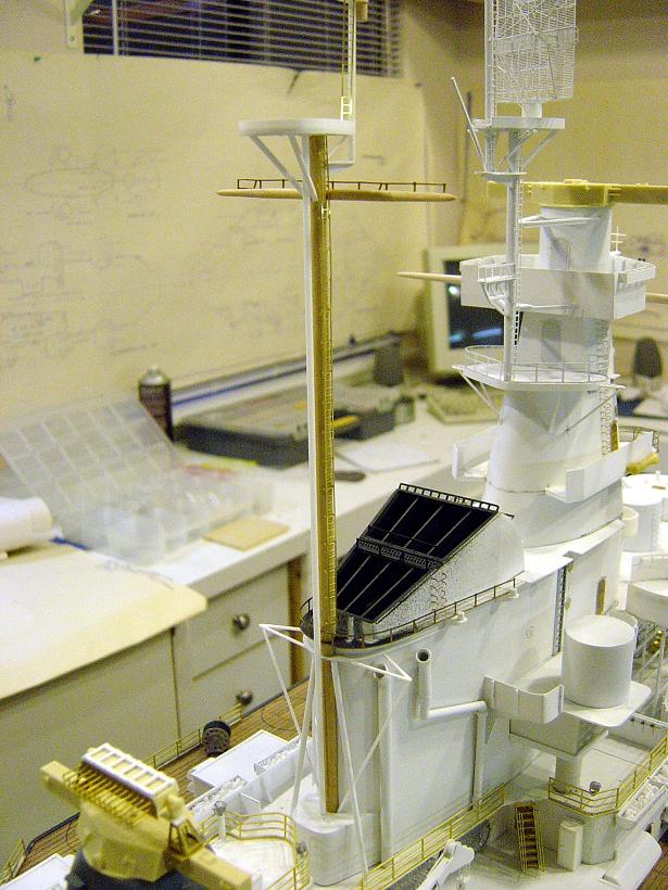

Stb. side again, looking fwd. The masts and signal yardarm are tapered wood dowels. Mainmast not finished yet. These two masts are small models in themselves, and are rather time consuming. One of the challenges is to keep everything straight and level.
A closer view of the forward citadel details. Note the large SK radar screen. By late 1945, other ships in the class replaced this with the updated SK-2 air search radar. A round antenna rater than the "bedspring" look of the SK. I found no evidence that Indiana ever recived the SK-2.

A dead on view looking aft. As I stated earlier, keeping everything straight and level is a bit of a challange when working with several individual pieces. Things have to be checked and re-checked before final assembly. Looks pretty straight to me, thank goodness!

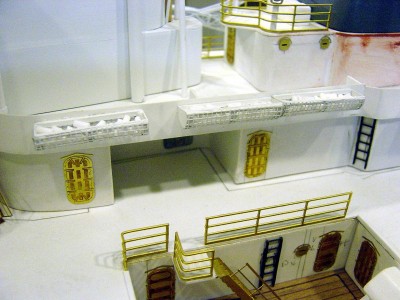

A good shot here of the bracing beneath all the platforms.

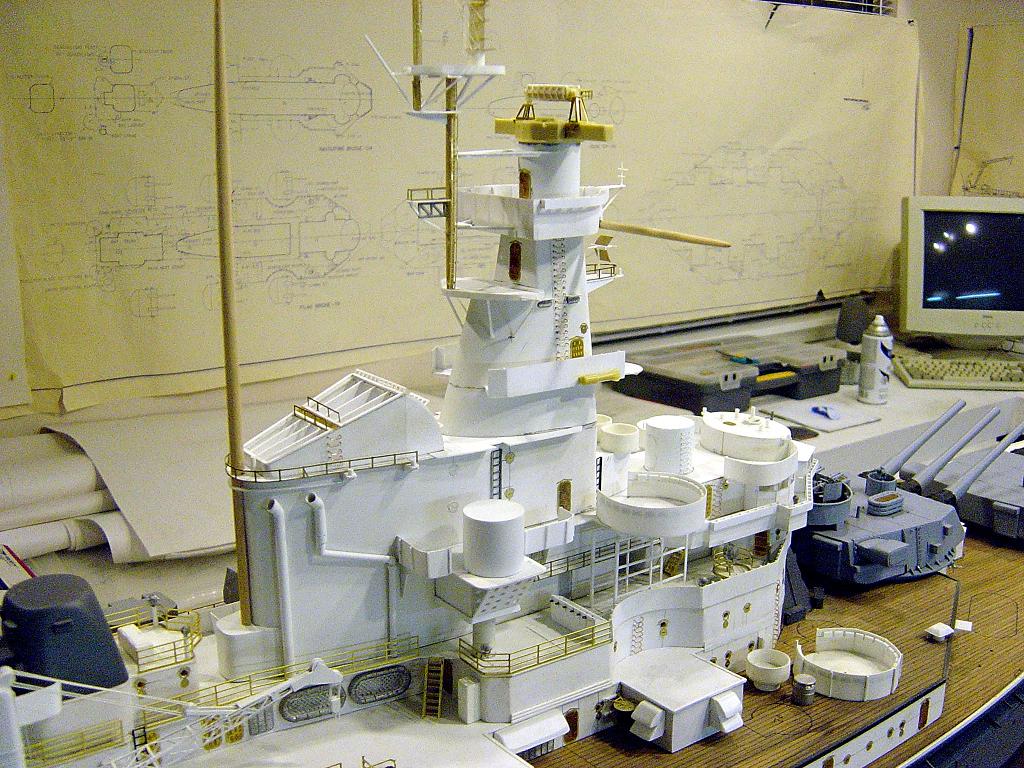

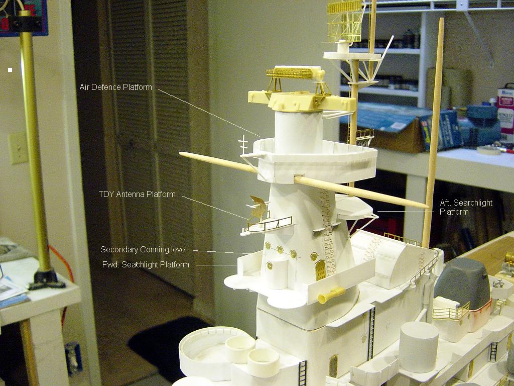

A portside view here. I have made notations about the various levels on the citadel structure.

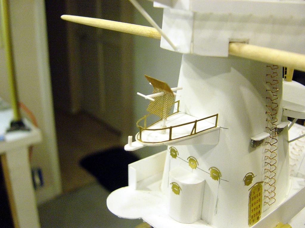

A close-up here of the TDY antenna, a radar- jamming device. I scratchbuilt this one as there are none available.

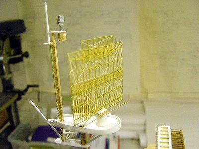

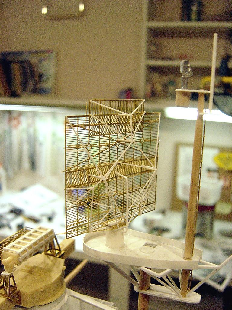

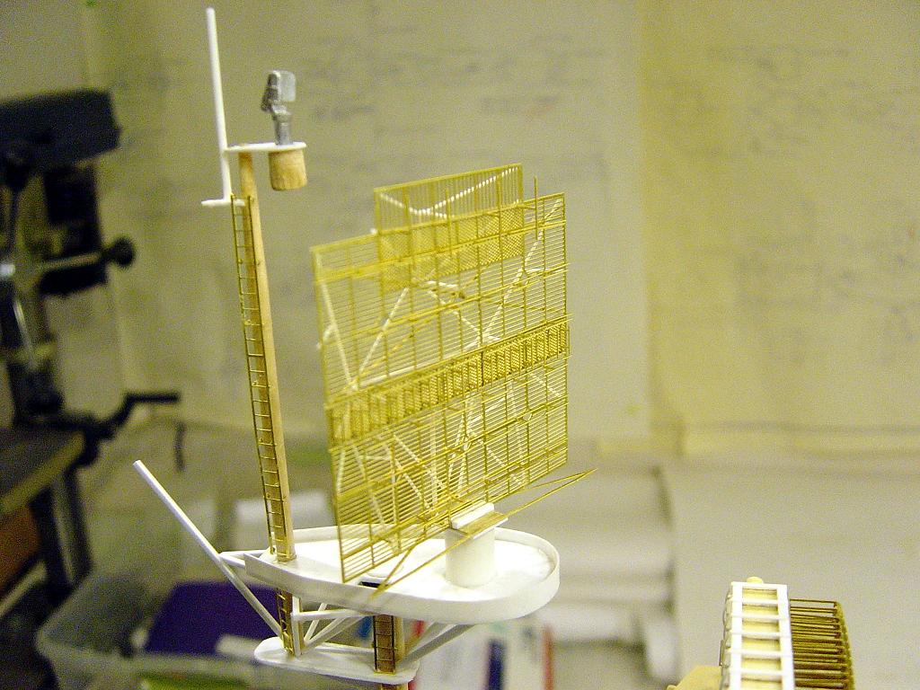

A close up of the back of the SK air seach radar screen. The screen and the dipoles are brass p/e from JR Haynes. Anything you see in white must be added as it does not come with the piece. In this case I used .020 styrene rod. The base is a larger diameter styrene tube. The smaller antenna on the topmast is the SG antenna, surface search radar. There is another on the mainmast as well as a secondary air-search radar, the SR.
Here's a front view of the SK.
Well, that's it for this update. Alot more smaller items to add, as well as completing the mainmast assy. Then it's back to the maindeck areas for more "stuff"! Will I ever be done??? Stay tuned, more to come...............I continue on......... :wave_1:

she is going to be one bad ass battleship .the sk radar is a work of art,as is every thing else about the build. you make difficult cutting and fitting look easy,i know it is not,great work. :thumbs_up_1:

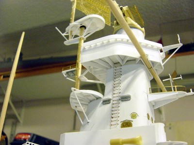

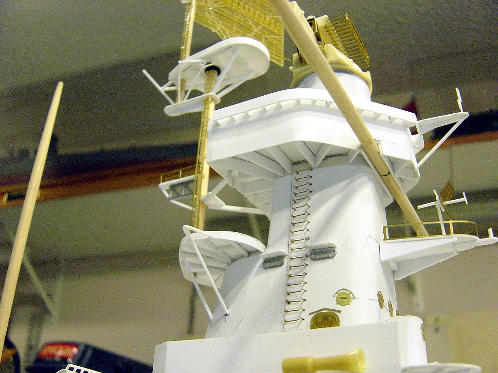

Hello again all :wave_1: Here's a new update on the construction of the ship. I have now completed the mainmast, and have fabricated and installed the last of the AA Gun and related director tubs. I have also finished the 15 floater net baskets. Things are getting more and more busy on BB-58's decks! Lets take a look.........
Here's an overall view of the mainmast looking forward from stb. side. made from tapered wood dowels, styrene and brass etched parts. SR air search radar not yet installed. The SR was a back-up to the SK.

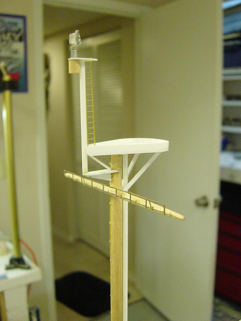

Top of the mainmast here. Note the SG surface search radar at the very top. Small wood dowel beneath the SG is the drive motor. Ladders are etched brass. Radar is cast metal.

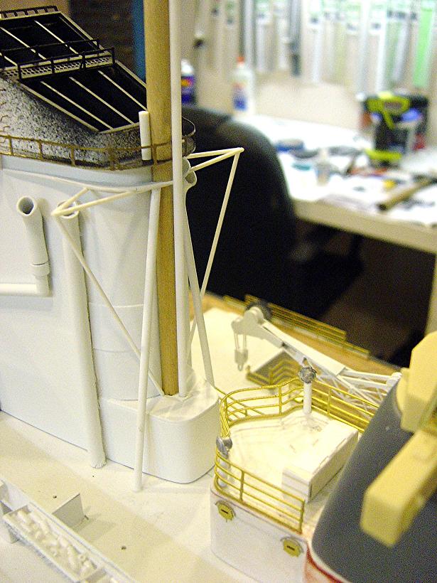

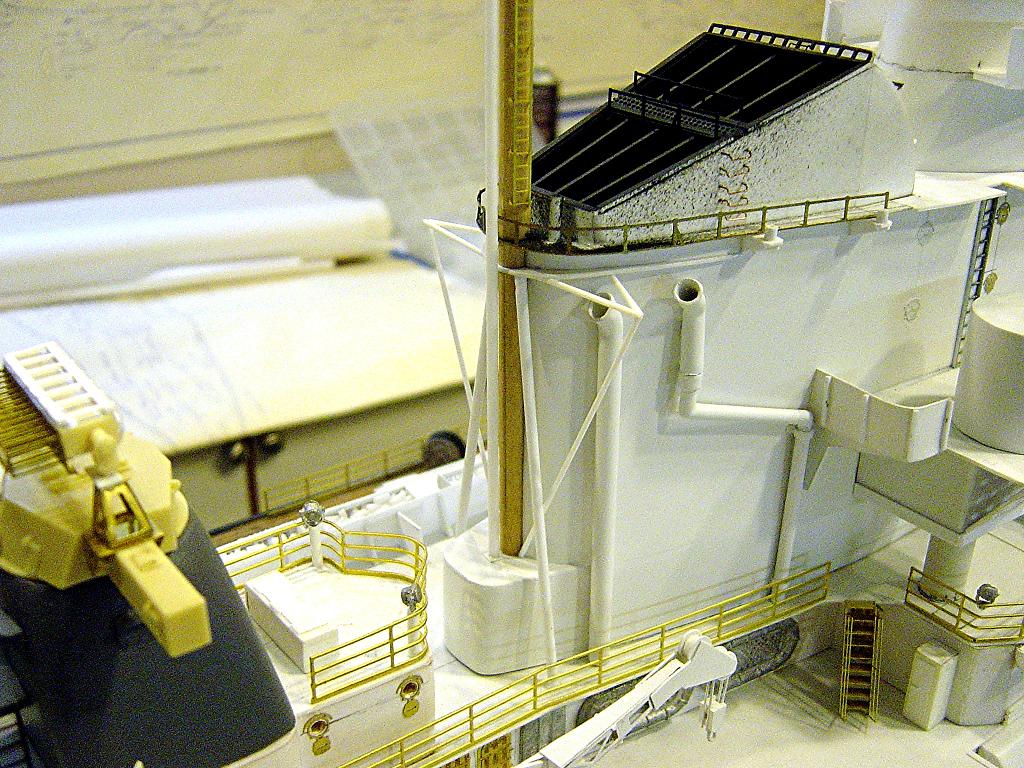

A close up of the lower support structure for the mainmast, stb. side. Note how the lower part of the mast is faired into the funnel.
Another view of the lower supports from portside. Note one of the floater net baskets in the bottom left of the photo.

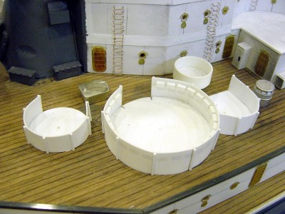

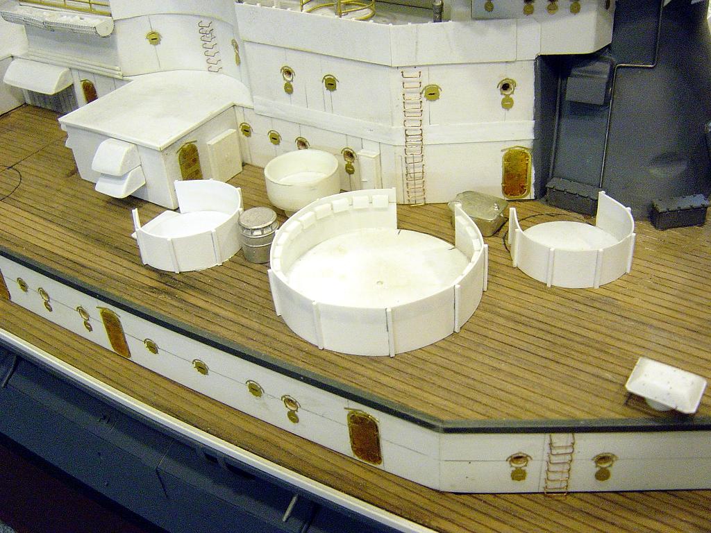

Completed gun tub arrangement on stb.side forward by the base of the conning tower. Small tubs are 20MM twin locations, large tub is the 40MM quad, while the other tub that is raised slightly is for the 40MM director. Ammo hoist hatch and vent are cast metal.
Portside arrangement here which is slightly different than stb.side. Gun placement is the same.

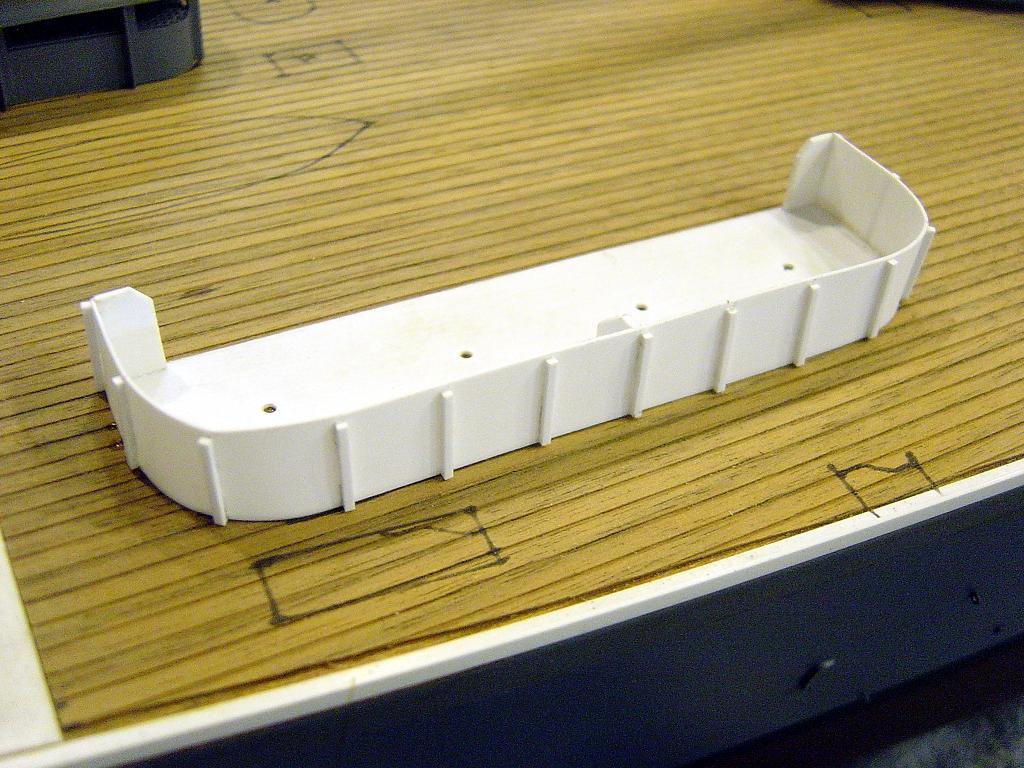

20MM tub here, stb.side next to #2 16" turrent. There will be two guns here, same on portside. Just aft of these tubs, there will be two more 20MM guns but with no shielding at all. I assume they were a portable mount. Note the davit for the accomodation ladderway.
This tub is aft of the #3 16" turrent,stb. side. It shields 4 guns. The portside one is slightly smaller and shields 3 guns. All tubs are fabricated from styrene.

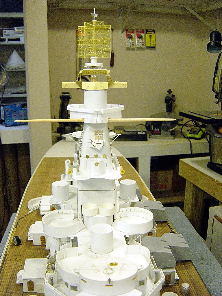

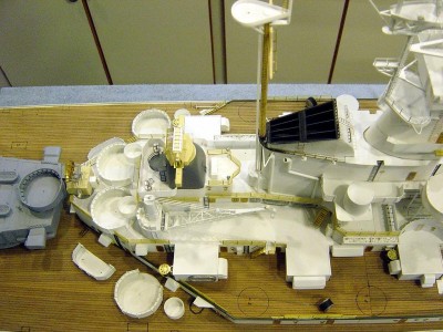

An overhead view showing the general arrangement of the superstructure. Lot's of styrene and alot of fabricating.
Another overhead view a little farther aft.

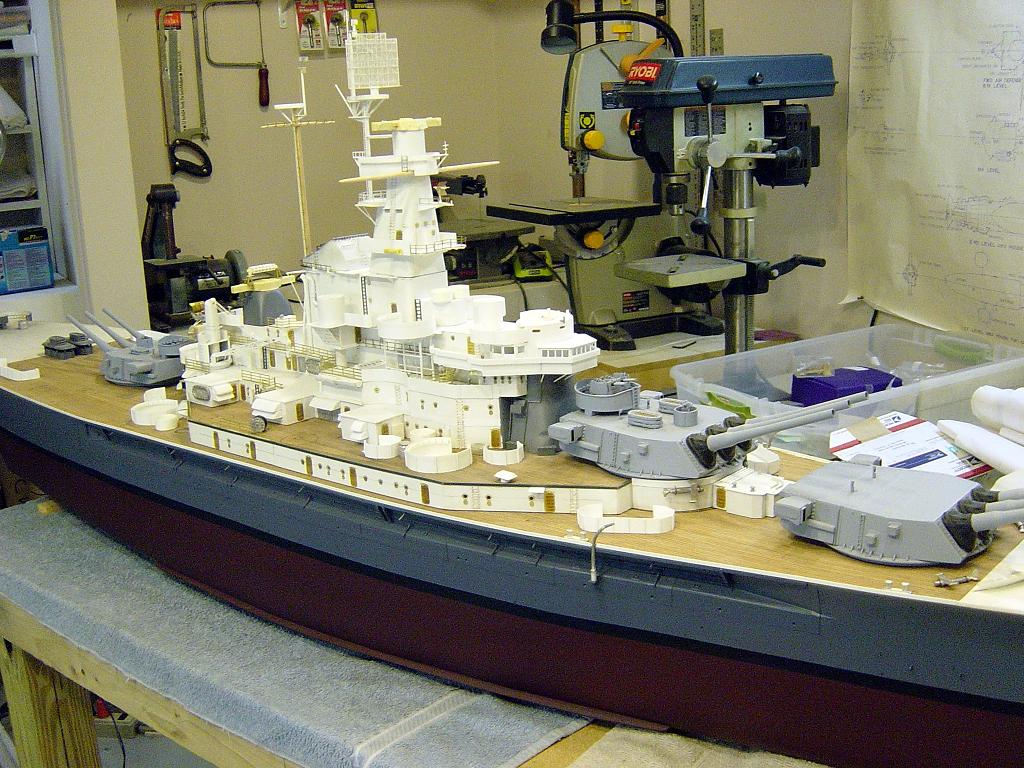

Almost the whole ship, stb. side. Hard to get it all in to the camera frame!
One more overall view, again from stb. side.
