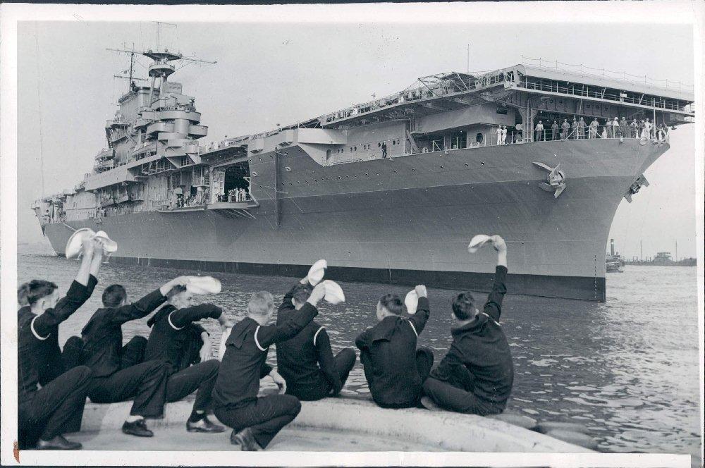

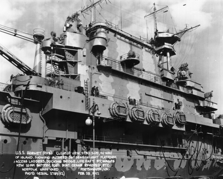

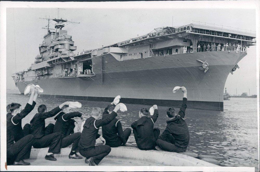

Here's an additional change to HORNET I've noted as I work on the hangar deck sides. In this publicity photo, note that the forward boat crane is still in position as are both searchlights on the stack. Note the structure 'hung' from the flight deck level and running from just aft the the stack to just about even with the mainmast vertical. Its forward end is just a tad forward of the forwardmost boiler air intake.
This was the clearest photo I had on hand, but the forward end of the structure is clear enough.
On this photo, the forward boat crane is gone, the forward searchlight on the stack (among other things), and so is 16' of the structure (now with life rafts attached) as seen here:
I checked my MD Silver plans to see if there might be a reasonable explanation. Since the plans represent HORNET 'as built', the room on the forward end of the structure is there and is labelled: 'boat crane machinery room' and does sit almost immediately below the crane's location on the flight deck level. Note in the second picture the structure ends aft of the forward two boiler air intakes. I measured the plans and the room is 16' long - didn't pull that one from the rectal locker.
I looked at ENT and her structure seemed to remain full length through '42 at least, but her boat crane had not been removed. After her shipyard work in '43 the crane is gone and it looks as if the structure is somewhat shorter but I can't quite tell.

John W. wrote:Here's an additional change to HORNET I've noted as I work on the hangar deck sides. In this publicity photo, note that the forward boat crane is still in position as are both searchlights on the stack. Note the structure 'hung' from the flight deck level and running from just aft the the stack to just about even with the mainmast vertical. Its forward end is just a tad forward of the forwardmost boiler air intake.
John, you are correct in your observations. Dick J and I had discussed this very feature some time ago. The machinery room for the boat crane was cut back on a 45 degree angle and that rectangular structure that houses several rooms was shortened as a result. Yorktown and Enterprise did not have this structure altered even after the crane was removed. Enterprise kept that crane longest, until her 7/42 work at PHNY, but the underlying structure remained as built. My belief is that this was a weight shaving measure in CV8, as several other little items were shaved. Note the shape of the second tripod platform as built, which matched her sisters, and post 1/42 for example. The saluting cannon platform on the starboard side of the island above where the crane would have been was also cut back. Interestingly, Tamiya captured this difference on their 1/719 scale models of Hornet and Enterprise.

Mike -
Thanks as always. Did I miss this earlier on this thread? If so, sorry to repeat.

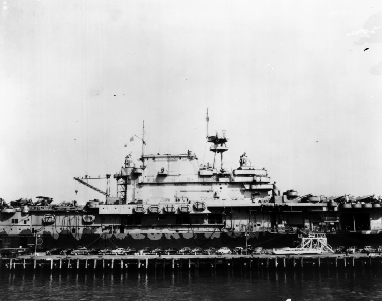

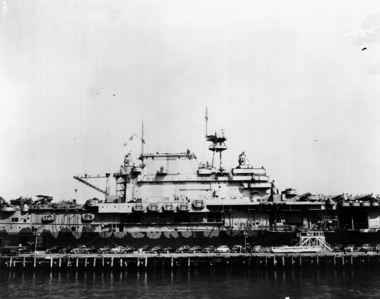

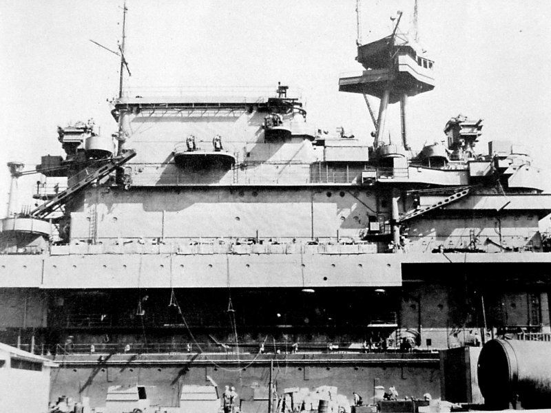

Just so I'm clear on what you are saying in your reply, was the forward edge of the boat crane machinery room on HORNET cut back at a 45 degree angle? It looks to me as though the room was eliminated altogether leaving a 90 degree corner when viewed from overhead (if it wasn't for the flight deck, of course). I did see this somewhat grainy photo of ENTERPRISE which does look to me as though the corner was beveled (again, in plan view that is)
'ENT Before'
'After'
As with HORNET, the 'before' shows the leading edge of the machinery room essentially even with the mainmast vertical column, the 'after' shows it cut back. In the case of ENT I can convince myself the forward edge is beveled because I don't see any portholes (airports) in the first ten feet or so.

Careful reading too much into those Enterprise photos. The apparent difference is very small, and the "target angle" is not the same. The lower photo is more forward of the beam (note that both trailing legs of the tripod are visible while the portside one is completely wooded in the upper one) which can distort the alignment of the projecting outer bulkhead relative to the more inboard island.

John W. wrote:Mike -
'ENT Before'
'After'
John,
Look at the sun lit and shadow portion of the cut away area just in front of the life raft. You will see that 45 degree angle showing as a bright triangle of sunlight here:
BTW, Dick J and I discussed this in private e-mails, so you did not miss it in a post here!! As for the Enterprise photos, note the location of the signal flag lockers. In Hornet's case, the end of the rectangular structure is well aft of a vertical line up to the front end of the locker. In Enterprise, both photos show the rectangular structure ends ahead of the locker. Also note the location of the three intake grills below the rectangular structure. In Hornet, the rectangle is cut back aft of the entire first grill. In early Enterprise, it is in ends in front of the grill and maybe a few feet was cut back in the later CV-6 configuration. I never looked closely at post 10/43 CV-6 in this regards but you may be right, it looks cut back a little bit, but it was just a few feet, not nearly as much as in Hornet. It looks like it was cut, maybe to the first panel of the first intake grill, while Hornet was cut fully aft of both panels of the first intake grill. Got to put a ruler on plans to be sure. I have pre- and post 10/43 plans to compare, soon as I can dig them out.

OK, copy all Dick and Mike. I didn't see ENT as being identical, but that's neither here nor there.
I buy most of what you say about the leading edge being beveled. I can't explain the shadow / sun pattern any other way than as the bevel as you say, Mike. BUT! It's actually TWO different bevel angles - halfway it's about, oh, 45 degrees or so, but the second half as it gets close to the vertical bulkhead it's probably more like 30 degrees. (I picked that because in engineering drawing we only used two triangles: a 45 degree equilateral and a 30 / 60 / 90, so I'm sticking to that.)
Seriously, though, look at the photo below carefully and you can see the underside edge of the structure in question at the forward end. It really is two angles and they show pretty clearly, especially in the original photo when it displays larger.
I agree the room was removed to save weight. Maybe that portion of the deck still needed support for the AA guns and so they kept part of the structure for that reason. DFK.

John W. wrote:OK, copy all Dick and Mike. I didn't see ENT as being identical, but that's neither here nor there.
I was interpreting that as a 90 degree for a few feet then the 45 degree angle starting back a bit from the starboard side outer bulkhead of the rectangular structure, but I can see where you might get a short stretch of 30 degree than going to 45 degree. I always viewed it as starting a bit back from the original structure, but your underside read may show a shallow angle before increasing to a more severe one. No plan exists that I am aware of showing the 2/42 modifications, so that photo series is all we have to go on. A bit of faith must get mixed into these situations!

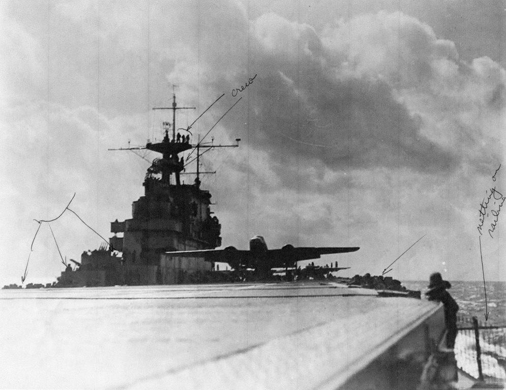

Roger. Looking aft and along the starboard side, I'm planning to use a 30 degree angle for about the first half the divergence, turning outward to a 45 degree angle until the forward edge meets the side of the box structure. As you've beat into my head, I will paint it 5-O. I will mix the paint for that 'new' area to a slightly darker shade to reflect the number of months it is newer than the 5-O already painted on at commissioning. (Just kidding.)
I'm assuming the photo you posted was from the movie unless the organization of the flight deck had broken down badly. Pri-Fly looks like a set fixture.

John, I was just studying a blowup of that color shot. I think it is way more acute that 30 degrees for the first little section, say maybe 10-15 degrees. I think it is far less than the halfway point where is goes to 45 or so degrees. (Are we going at it from opposite directions? I am looking at it from outer edge of box structure going in. 10-15 degrees oriented against a port/stbd cross-ship beam line for first few feet increasing to about 45 until it hits the hangar bulkhead.)
The shot is a clip from Thirty Seconds Over Tokyo, but I am fairly certain it is the actual "real" footage as they weaved in several real takeoffs into the movie. If you see it running, you'll realize it was not all movie set footage. Pri-fly and flag bridge have the right modifications that the set model did not. It was more "as built." Added key features to note, there is a man in prifly in second window back, and the canvas wind dodger around the roof of prifly, and the angled signal light bar on outer the edge of prifly, all not in the movie set models. It is grainy, but you can also see some camo pattern in prifly structure. Also, note the wet deck reflections next to the island. They may have grained it up to blend with set footage. I must have gone through that movie frame by frame! They did a good job for the time. Some set footage and model work is hard to spot. As for those books, read them all! If you last read TSOT in high school, you might want to get a recent printing. I got a hard cover recent print and it is a More lame spammers, please ignore, the moderators will delete version than the abridged youth oriented version we all read in the school library. Also, Ellen Lawson has added a nice postscript with lots of info in it.

Mike - Some must think we're round the bend with some of this discussion. Oh well.
Looking at the last photo I posted, and assuming I could hang on the underside, outer edge of the structure with suction cups (can't believe I saying this) and moving forward from the back end starting under the #3 1.1" mount I go until I reach the forward end of the outside under edge. Looking at the picture, I can see the underside of the forward edge changes direction inward (left) at an angle that looks to be about 45 degrees inward from the edge which was parallel to the ship's centerline. So right now as I follow it I am headed port 045 relative (or 315 relative if you prefer). As I move along that angled outside lower edge a number of feet, I come to the second bend where the angle changes to the right maybe 15 degrees relative to the 45 degree edge I have just been traveling along. So I am now traveling port 030 relative (or 330 relative if you prefer). When this edge joins the vertical bulkhead it makes about a thirty degree further turn (to my right) in joining the bulkhead which brings me back to 000 relative.
Hopefully that either clears it up or confuses it sufficiently that you agree with me to shut me up. The key is the underside edge in the photo just above the most forward boiler air intakes.
I don't have a good photo annotation program to draw an arrow where I mean, unfortunately. I know there's some kind of platform on the angled front edge to which we are referring, but I don't believe it shows from this angle looking upward and forward.
My comment about the picture had to do with a couple of swabbies standing out on the middle of the deck during a launch with no apparent duties - wearing dark blue dixie cups, no less. (Thought the dark blue hats came in later in the war.) Can you say FOD in that wind? I don't recall any film taken from directly aft of the B-25s as or after they took off. Maybe that's the last plane leaving, but it just doesn't look right to me.
I have an eye for details, but as always I defer to your expertise as amply demonstrated before. If you say it's real, then I'll agree you say it's real.
(I'm headed out of town early tomorrow, so if I don't respond to any return posts, that's why. If I'm wrong, I'll own it.)

John, now I think you are trying to walk me off the plank! What heading are we on? Anyway, I think you are right about a catwalk in front of the angled section. it would be there to allow access to the refueling rig and hoses that are suspended there. See how this blow up works for you.
I went back and re-studied the TSOT screen capture above. Damn! It IS a movie set shot. I compared a photo of Capt. Mitscher standing on the roof of prifly during the takeoffs with that shot. The canvas wind dodger is what gave it away. It went all the way to the end of the railing. In that shot it ends short. Also the pilorus is missing. Plenty of dark blue headgear showing though. Carpenter's rule, measure twice, cut once failed me here. I measured several indicators and still got fooled. The movie guys did a good job of blending it into reality! And they must have had the 2/42 revision plans because the set captures the mods. They had me fooled for 18 hours. I must hold my head in shame, but it is a credit to them.

Mike -
The lighting just looked off - just not real enough to me. It's hard to describe.
I agree the headgear is dark, but they look like knit watchcaps (I think that's what my brother called them) that you would pull down over your ears to keep you warm and to keep them from blowing off. The hats on the swabbies in the movie set picture are dixiecups.
Not sure if you are seeing the double angle I'm talking about.
Here's a zoom on the area where I see the double angle.
Call up the original on a photo editor and zoom in a bit and see what you think.

John, I definitely agree about the double angle. There is short stretch moving in from the "box" outer edge that is about 45 degrees, then a run of several feet at about 30 degrees then a longer run up to the bulkhead at a more acute angle of maybe 55 degrees. Three separate angles, ending in front of the first intake grills, where the original structure ran to. It's just that you were describing it from the opposite direction that I was. Wish I could find a better shot of what is in front of it post-mod. I believe that small catwalk may have been left there after the mod. I think these shots are revealing about that catwalk platform:
I thought the first guy behind Mitscher might be wearing a dixie cup, pulled down a bit. These shots though, clearly show blue dixies on the raid:

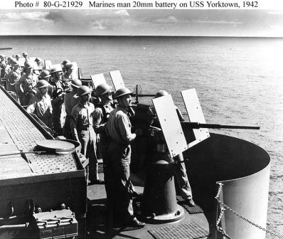

I'm 5-9 - probably close to the guys in this picture. My wingspan is 18". Just saying that the waterway looks noticeably wider than the shoulders of any of the guys when comparing the waterway and the guy closest to it at the same point. Yup, they are not standing quite square to the waterway, but it still looks wider than 18" to my eyes.
YKTN 20mm gunners.jpg (30.79 KiB) Viewed 7731 times
The waterway is made of the same perf metal as the catwalks and island exterior decks. I haven't figured out a good way to cut P/E perf plate that narrow and parallel. Yet. I've taught myself plenty of stuff I never thought I'd have to, or for that matter - ever thought I'd want to.
See, 24" is easier to scratch than 18" - it's 0.017" wider. Hmm. Skip it. Never mind.
