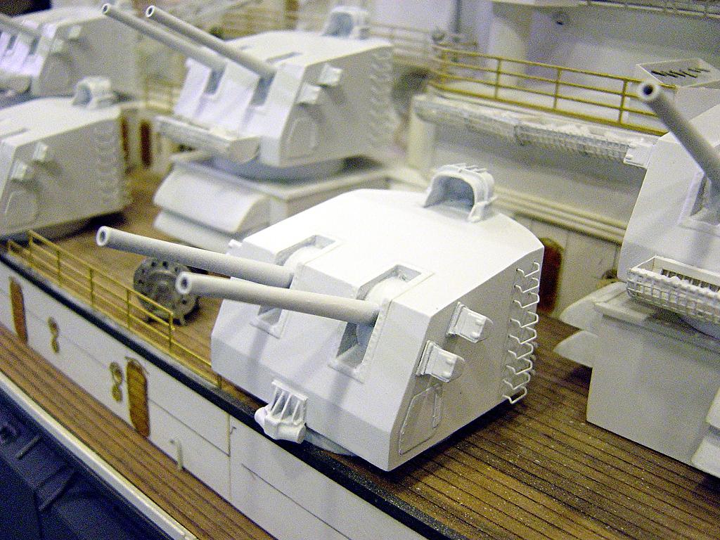

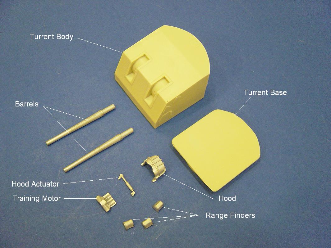

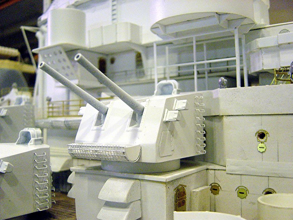

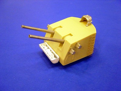

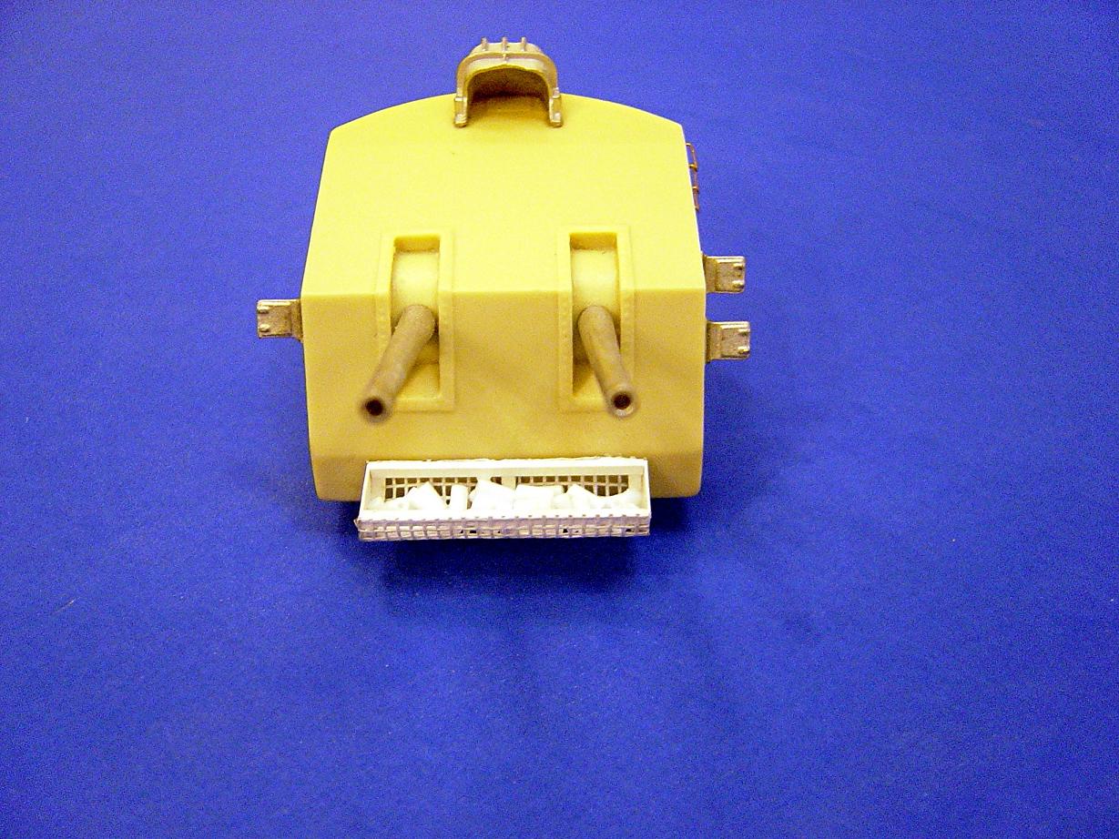

Well, one good turrent deserves another ( Dave Wooleys last post on Kiev)! :big_grin: Heres some photos of the 5" twin turrents on the Indiana. I am again using a small kit from JR Haynes. The kit contains 10 pieces and is made up of cast resin and cast metal. The resin castings are excellent and are virtually free of defects. Same goes for the cast metal parts, very well done. Assembly was simple. I added ladder rungs and floater nets where applicable. About $30.00 each, US. Lets take a look..........
Heres a view of the kit and a breakdown of the individual parts. Also comes with an assembly guide.Turrent body and base are resin, the rest of the parts are cast metal.

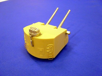

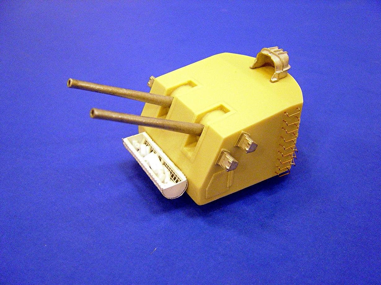

Heres the turrent assembled. Holes for the gun barrels must be drilled out. Note I have added the ladder rungs and the floater net basket.
Front view
Front view
Rear View
Rear View

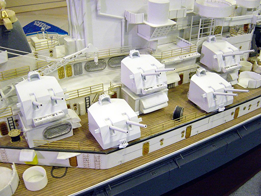

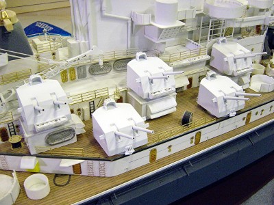

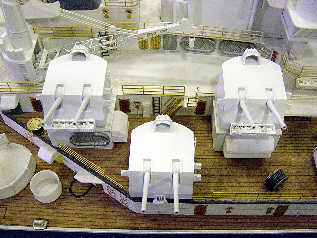

Heres the five turrents on stb. side. Same arrangement on port. Turrents are primed and await final paint work. A few more views below.....
Five more to make, then on to the directors for these guns....Stay tuned, more to come....I continue on............ :smallsmile: :wave_1:

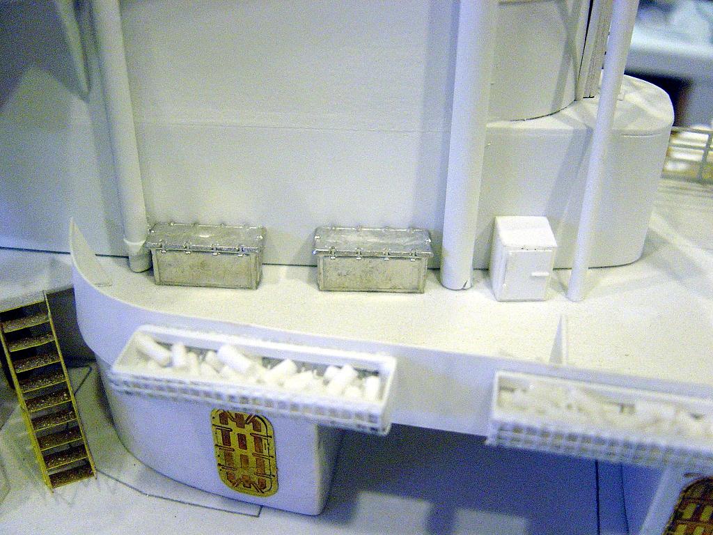

love them floater net basket's

I probably missed this too...
On your five inch turrets, did you hand make all of the external ladder rungs or were these a vendor item? Also, did you create a jig to help line them up? I assumed that they had been inserted into holes before gluing.
Excellent turrets!
Thank you.
Bill Waldorf
Waldorf Productions
Waldorf Productions
Posts: 541
Re: USS Indiana BB-58 Scratchbuild in 1/96 - 1944
Post by Bill Waldorf »
sgtmac wrote:I probably missed this too...
Excellent turrets!
Thank you.
Hello Sgtmac, The ladder rungs are a vendor item from Proto Power West/ A-Line. They are HO scale drop style grab rails, made for freight cars, but work very well here. I need so many, that it was easier to get them pre=formed rather that bend them one by one. And yes, I made a drill guide from sheet styrene. The rungs are attached with medium CA. HTH.............Bill W. :wave_1:

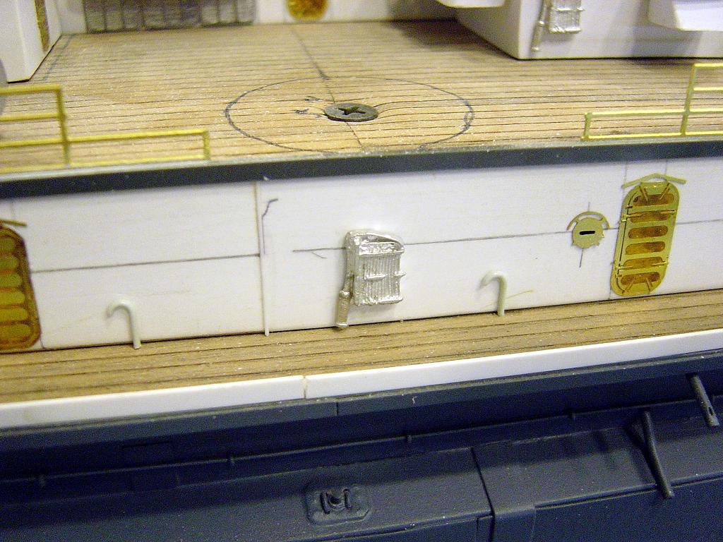

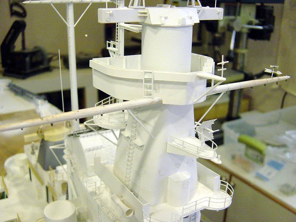

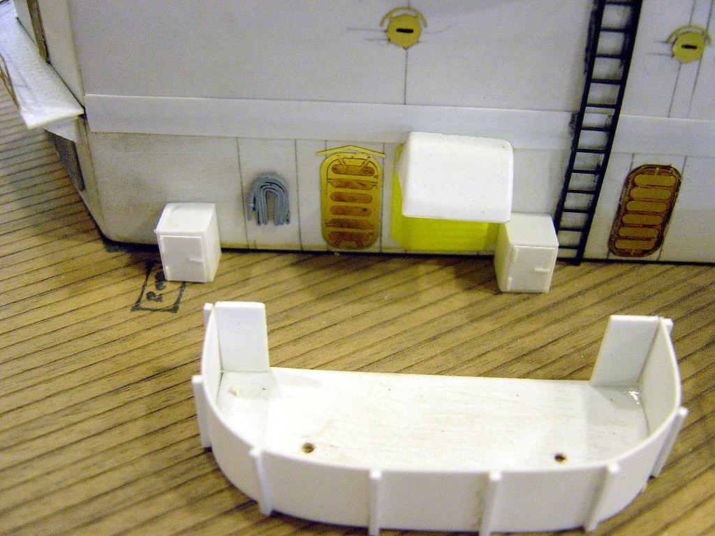

Hello again all :wave_1: ! Been awhile since I have posted so here goes. I have been adding a few more final details before I begin final paintwork on the Indiana. Everything but directors, radars, and guns have been added to the superstructure, as well as the main deck of the ship itself. My main focus now is to paint the superstructure. It will be a time consuming affair, but get ready for a transformation! :cool_2: I am going to attempt to paint all the haze grey areas at the same time to avoid color shifts. After that, all the decks will be hand painted by brush with deck blue, as well as most horizontal surfaces. Lets take a look..................
Note the small ready sevice lockers here for the 20mm guns. These are scratchbuilt from square styrene tubing, .010 sheet, and .020 rod. I made 20 of them and they are located near the gun locations.

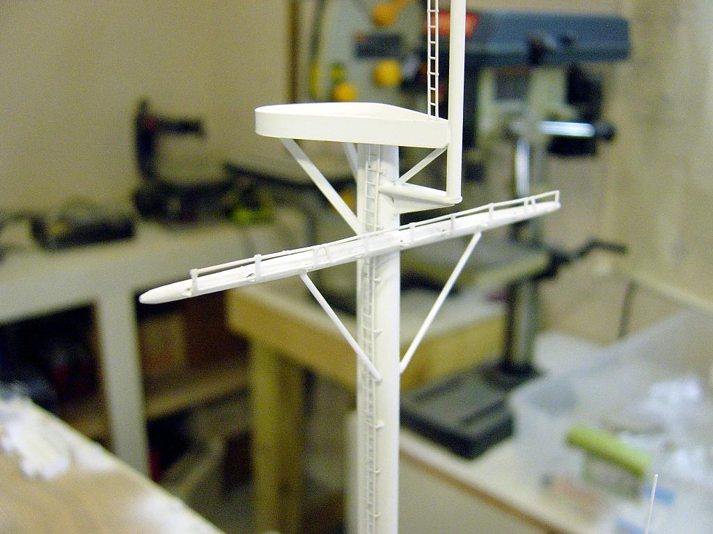

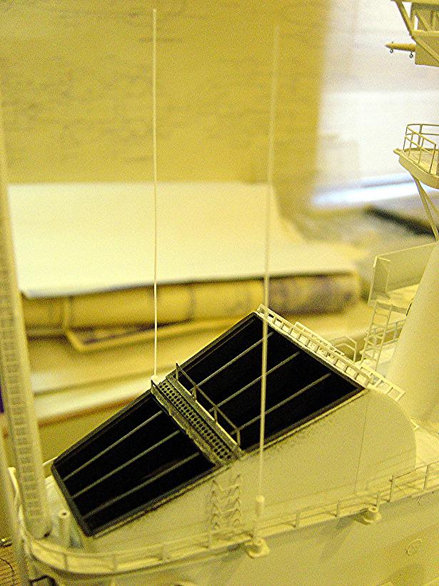

Here we have a couple of whip antennas, made from .020 styrene rod and a small bead as a resistor. There will be 9 of these around the ship.
Another small addition are these cast metal fire hose racks, 10 located around the superstructure. Also note the small gooseneck vents.
Additional 20mm r/s lockers added here. These are cast metal.
Forward yardarm now completed and installed. Note the small eyelets for the signal flag halyards, and the wind indicators, speed and direction. Also added more support struts.
Additional support struts added the the mainmast yardarm.
One of six mounting screw locations for the superstructure to be reattached in its exact position. These will be hiiden. Note how they are countersunk a little.
The rest of the brass p/e railing added to the structure.

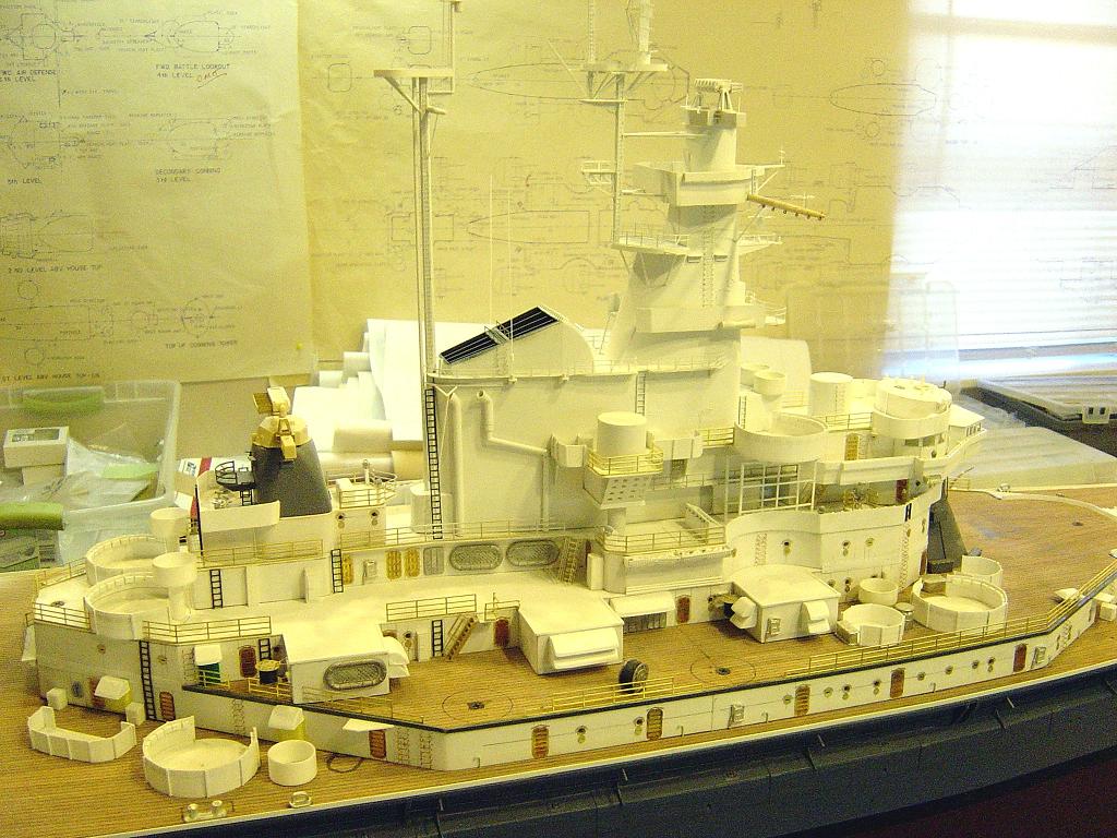

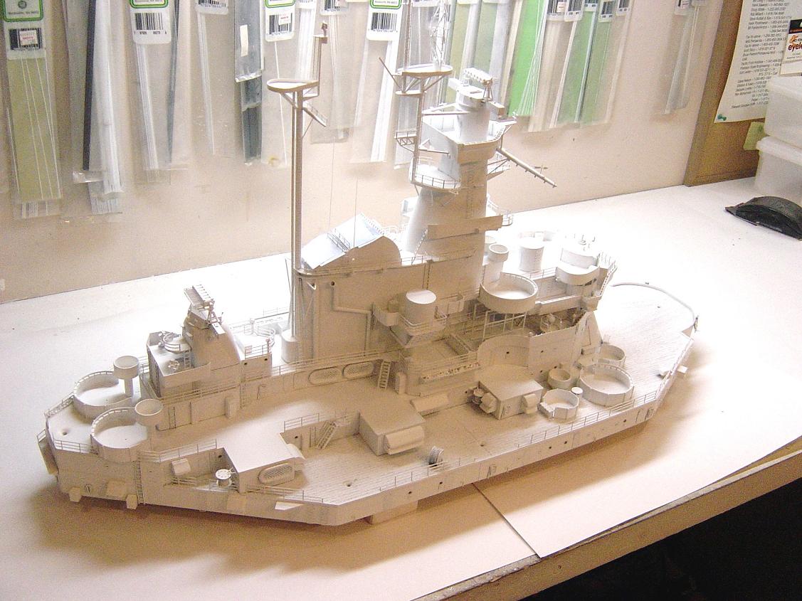

An overall view from stb. side of where things stand now. Again note the mounting screws.
Another view from portside.

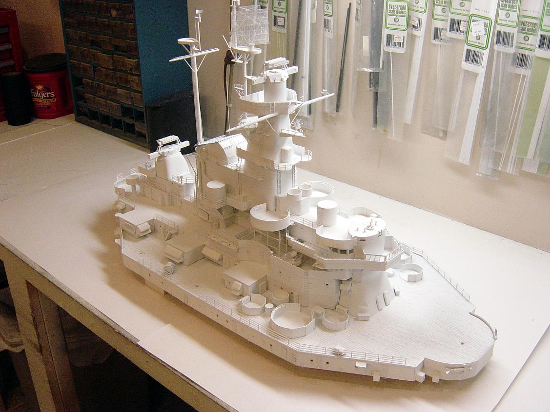

Superstructure now removed and being readied for primer coat. Looks bare without it, don't it??
Superstructure now primed and ready for final paintwork.
Another view.....
Another view.....
Well there you have it.......As I said, get ready for a transformation. Stay tuned!! More to come. Almost there!! I continue on.... :wave_1: :thumbs_up_1: :thumbs_up_1: :thumbs_up_1:
