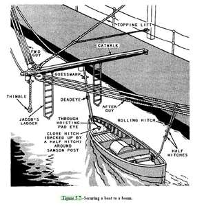

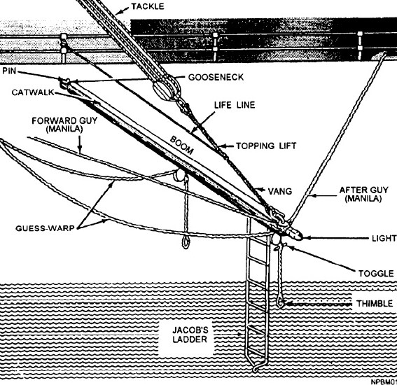

Post by Russ2146 »
:big_grin: :thumbs_up_1:
I really don't think the block and tackle portion of the topping lift is too long.
Boat Boom2.jpg (19.77 KiB) Viewed 2149 times
There's only one more detail you could put in. Can you spot it? :heh: :whistle:
PS I think the difference in the Forward and Aft guys in the two diagrams is due to the size of ship involved, so the second diagram might be a cruiser or BB

Russ,
Are you talking about the Guess Warps? I'm thinking of adding them, if not just a line from the boat's bow cleat to up to the boom. It'll probably bug me if I don't complete the Guess Warps all of the way from the boom to the ship's cleats, though. consider it done.
You're always keeping me honest, Russ. I appreciate it all. :wave_1:
