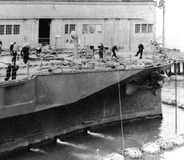

Cowl vents can usually be rotated. This photo of Pennsylvania shows the same vent rotated to the side.
Steve Sobieralski
Tampa Bay Ship Model Society

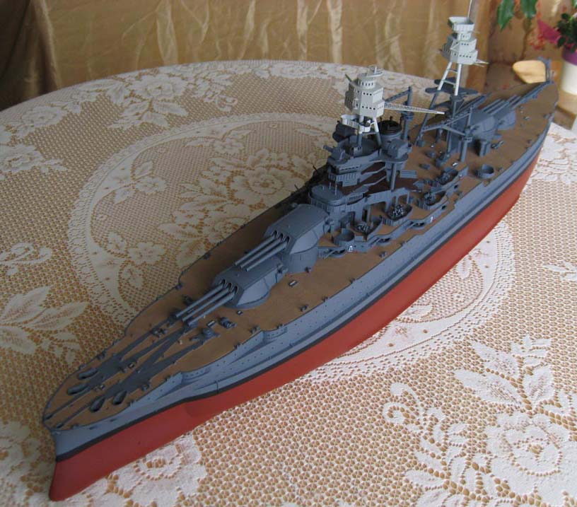

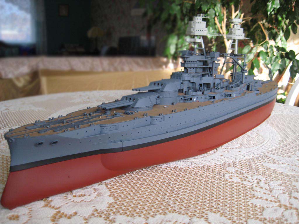

- dsk
- Posts: 641
- Joined: Fri Oct 01, 2010 5:44 pm
Re: At 'Em Arizona Fans!
AFAIK only White Ensign Models offers 5-S Sea Blue, and they've been out of stock for a long time. You could always try mixing your own, but I wouldn't know what colors to add or what ratios to use. I can't mix colors to save my life, so on my model after fruitless experimentation I finally gave up and bought Model Masters #1923 Gunship Gray (FS36118) in both rattle cans and bottles. I figured I'd simply make it dark grey and consider it Fall of 1941 since nothing came close to matching 5-S in a premixed can. Imagine my surprise when it actually came out a blue/grey similar to 5-S in many respects. Maybe a bit darker than true 5-S, but still a pleasing color nonetheless.
Note: My model is unfinished and still missing many pieces.

- JohnD
- Posts: 90
- Joined: Sat Mar 05, 2011 2:10 am
- Location: Sydney, Australia
Thanks for the quick reply,
Your Arizona looks very good. Gunship Gray looks to be the way to go. The difference between it and the light gray topmasts match the photos of the Arizona well. The combination of Gunship Gray, Light Gray, Insignia Red turret tops and Tamiya Buff for the decks, should make for a model that really stands out, once I've sorted out the hawseholes and external fuel pipe and anything

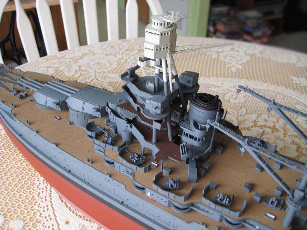

- dsk
- Posts: 641
Here's a couple more pics. The Gunship Grey is indeed a dark grey in the bottle, but once it dries and out in natural light it definitely has a blue tint to it. By the way I used Model Masters Dark Tan (FS30219) for the wood decks and their Camouflage Grey (FS36622) for the fighting tops. The brown on the flag decks is Tamiya Acrylic Flat Brown, but I don't have the part number with me so I'll have to edit this thread tonight with the correct info. The issue of whether or not the flag decks were covered in brown linoleum is up for debate, but I decided to go ahead and assume the Admirals all wanted linoleum under their feet.JohnD wrote:Thanks for the quick reply,
else that turns up.
JohnD
Out of the box you'll find the hawespipes are angled in a way that they won't even allow the anchors to pass through. I had to carefully open them up a bit on the inside, and do some filing on the anchors as well to allow the shank to be more of an angle with the fluke. However as you can see I still haven't installed them yet. The external fuel pipe is easy, just get some really small styrene rod (again I'll have to check what size I used) and glue it to the side of the hull. If you have a copy of Stillwell's book (or can borrow one from the library) the pics will show you exactly how to route it.
