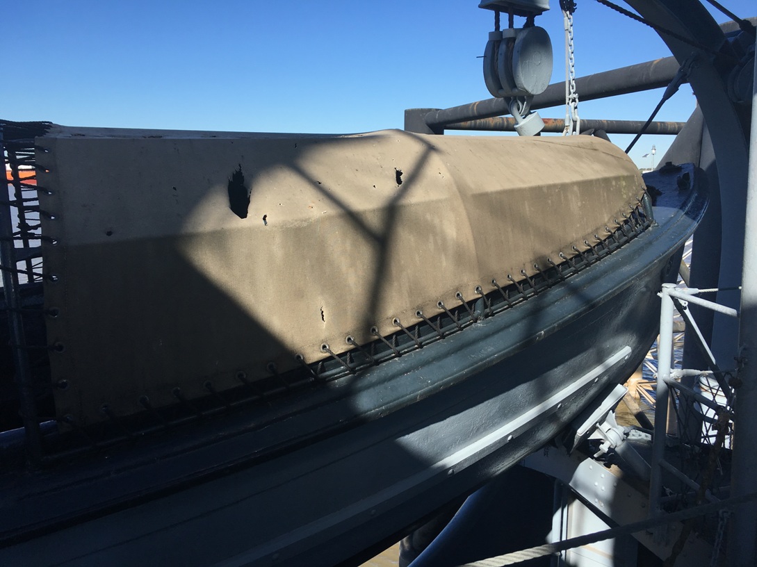

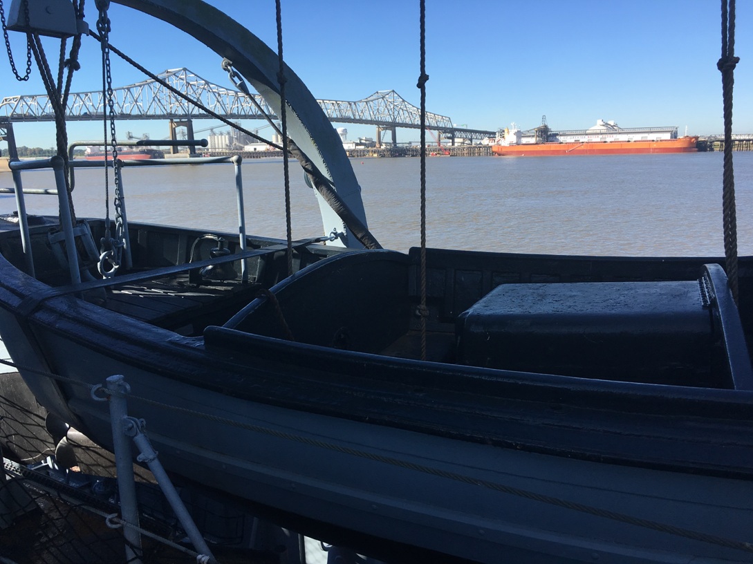

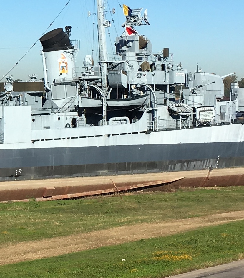

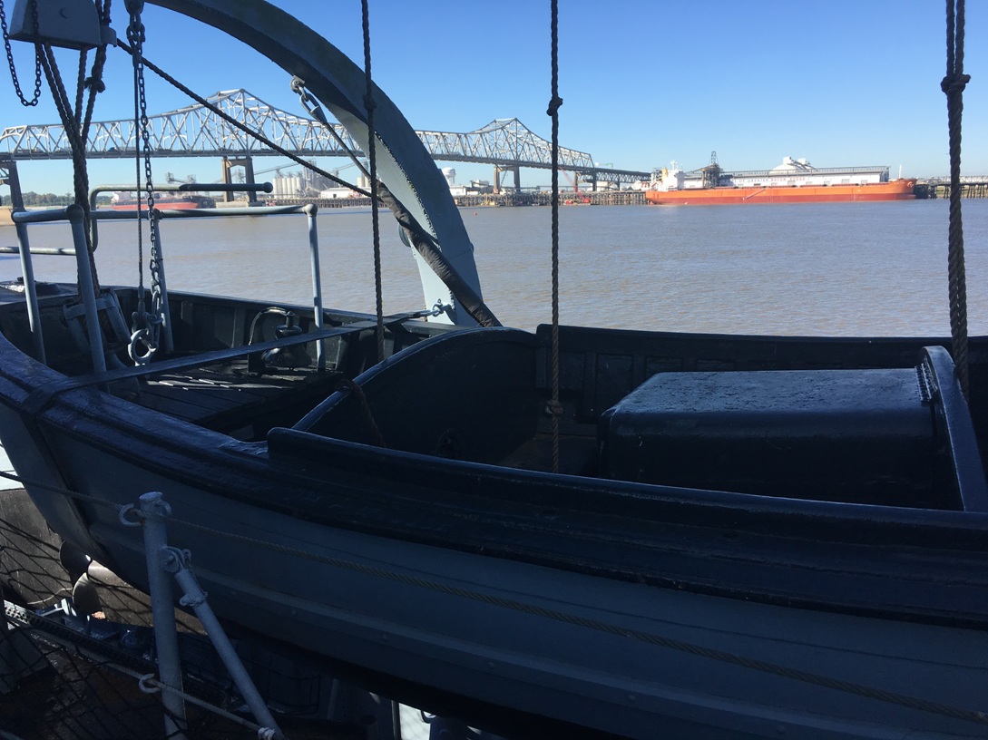

Further bit on the boats. The anti-fouling was typically painted black. The top was painted the deck color and the hull and any thing sticking up was painted the relevant bulkhead color. If the bulkhead behind the boat had more than one color they typically matched (like splinter shields did). But in the case of the Hornet that was not an issue. Canvas tarps might have been or not have been painted depending on the case. These three pictures are from the USS Kidd (sorry about the quality of lighting, it was on my phone when I was in Baton Rouge). I know it is not the same paint measure but what I mention is still valid.
I will go through what I have on CV-8 and see what I can get you.

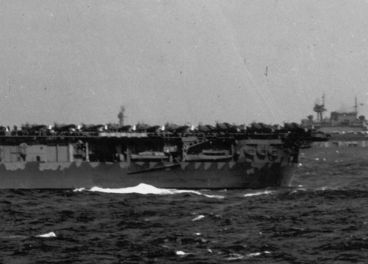

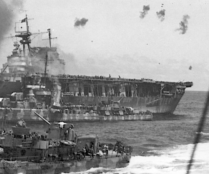

Okay I have two more crops. These are of CV-8, but the clarity bumped in too much is not great. Given what I shared above you can likely make out what I was talking about. The painting was SLIGHTLY changed post Midway when they changed her radar and AA loadout.
Pre Midway
Santa Cruise

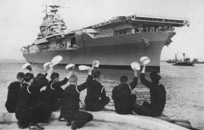

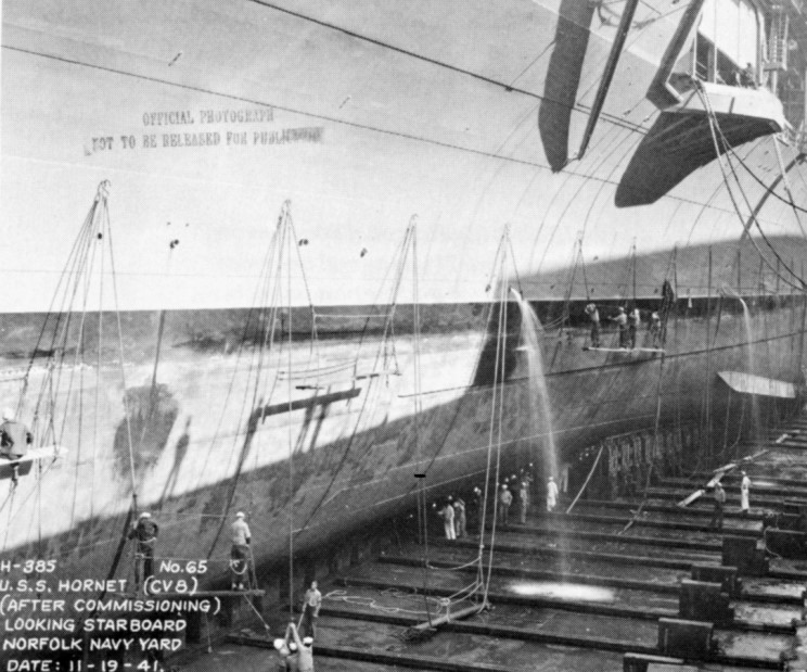

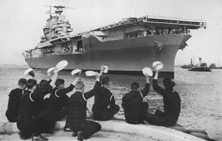

Glad to help. One thing I forgot to point out in the picture of HORNET's boottopping on page 29 is that she is light so the BT is very prominent. Here is a picture of her sailing past a jetty at NAVSTA Norfolk with a group of sailors sitting on the jetty rocks - you can see how light she is, and the lack of armament. She has yet to have her 5"/38s mounted, nor her smaller cal AA fit including the 'bandstand' on the focs'l for the two 20 MMs, so she's riding high.
Here's a picture of HORNET in DD where you can see the Boottopping clearly and estimate its size using the sailors nearby (I picked 48" - I doubt those sailors were all 6'). Note the top of the BT and the top of the armor belt (where the sailors are scraping and painting) coincide.
Even as she sailed for the Pacific, she was more heavily loaded with additional AA fit and some items like most of her boats, the boat crane adjacent to the island, and other equipment removed to compensate for some of the added weight. (Each 20MM mount with pedestal weighed about 1600 Lbs.) The pictures you see of her after Feb 1942 show her considerably lower in the water with little BT showing.

Thanks, appreciate the help. I did notice the difference in the waterline. Almost appears that later after she was prepared for the Doolittle raid the waterline was actually smaller in height. Are there any good plans of the Hornet around on line. I really need a good drawing of the forward port holes at the front of the bow of the ship. Trumpeter have them as an oval shape so it's filling time and then re drill.

The design waterline of a ship essentially assumes the ship's weight doesn't change between design completion and construction completion - an unlikely event. It may change later if changes are made, say, to the hull (such as blistering on ENTERPRISE in order to compensate for more weight and to improve stability.). For HORNET, the boottopping top during the Doolittle Raid was unchanged from the picture above with the sailors on the jetty. The ship has more weight aboard for the pictures of the Raid and so sits deeper in the water. USN ships were generally overloaded after the beginning of the war due to added equipment and AA guns not envisioned when the design was finalized.

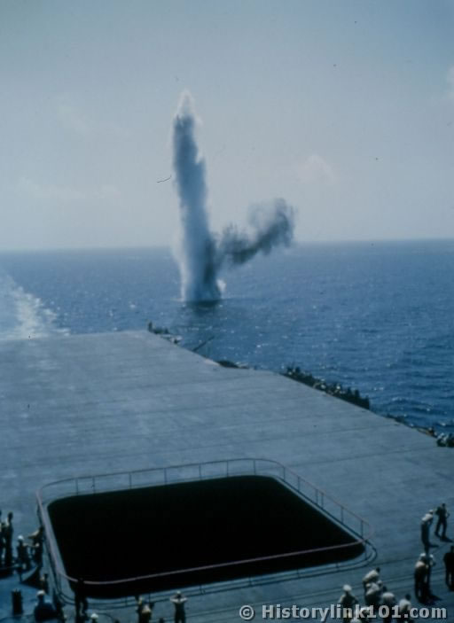

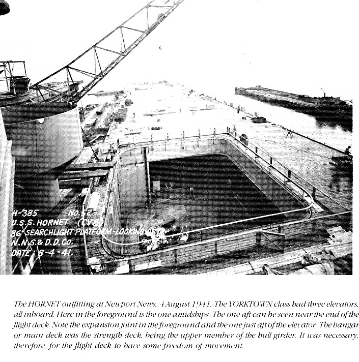

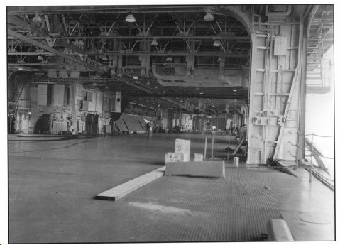

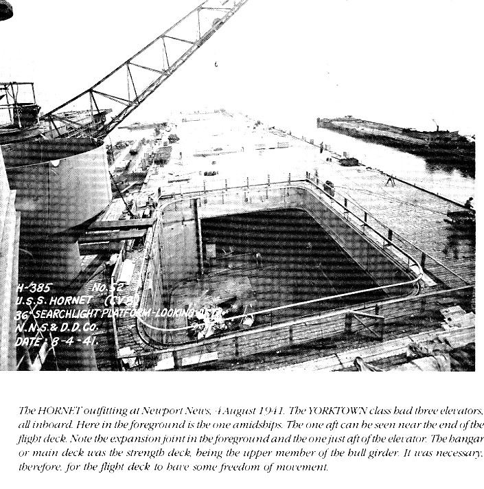

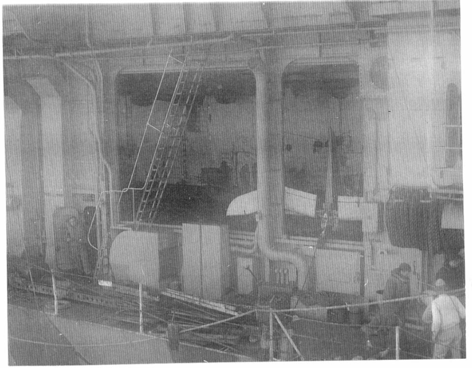

Thanks! Much appreciate the help and info. I have one other question re the Class of Carriers and their elevators. I understand that when the elevator is at deck level the elevator pit in the hangar deck is exposed and fenced off? I'm currently trying to improve the Hornets hangar deck and scratch building new interior wall etc so it resembles a carriers hangar bay not what was provided in the kit.
Max
John W.
Posts: 518
Re: Calling all USS Hornet CV-8 fans
Post by John W. »
Max -
Not entirely true. At least on the YORKTOWNs, when the elevators are at flight deck level a secondary elevator bridges part of the elevator pit - about a third of the width - so that men and equipment could pass across it from fore to aft. Especially for the aft (#3) elevator, this allowed access to storage space behind the elevator and on the wall of the elevator shaft. On that same after wall, there was a door providing access to the fantail.
Tracy White posted a couple of pix in one of the CASF threads - one of the YORKTOWN class threads. I don't remember which of the three it was, but there are a number of pix in all three of those threads that show a lot of hangar deck details including the hangar deck elevator wells.
John
Angeliccypher
Posts: 1381
Post by Angeliccypher »

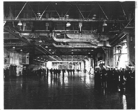

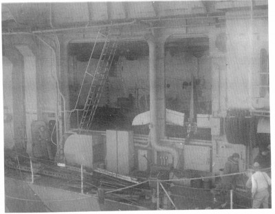

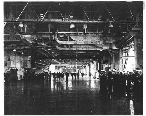

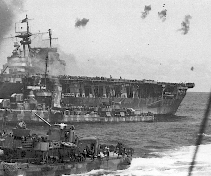

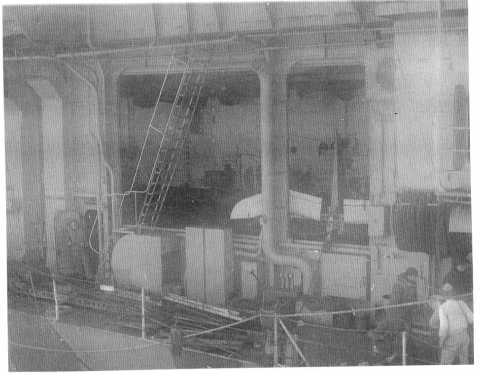

Here is what I have involving either the hangar or the deck railings around the elevator on the Hornet. I would also recommend looking at the "Warship Pictorial #44 Yorktown" as there are 3-4 pictures in there that are great of CV-5. I had a photo somewhere that I can not find at the moment which showed planes in the hangar with at least one plane and several spare parts hanging from the support beams on the overhead.
5F1   NOTE DARK STRIPE R SIDE OF FLIGHT DECK..tif
5F1 NOTE DARK STRIPE R SIDE OF FLIGHT DECK..tif (384.72 KiB) Viewed 7453 times
