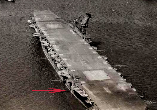

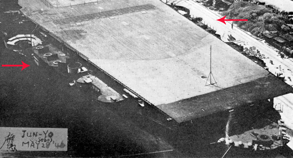

This is one of the problematic areas. TROM mentioned "each beam far aft". From The aerial view from her stern, I could spot the battery of 3 launchers on her port aft sponson. The starboard side is hard to see. I'd say I don't see any from this angle.
A view looking aft on the starboard, I'd say I can't spot them from this view either.
Instead, they can be found in the forward part of the ship, 3 launchers on starboard side and, I think, another 3 on the opposite side as well. (Tamiya place the launchers in the forward part in their kit.)

5. six racks of 30-tube (180) 127mm. (5-inch) AA phosphorous rocket launchers mounted in sponsons on each beam far aft.
DK: The TROM is incorrect. They were place to either side of the forward end of the flight deck. See photos below.

No AA rockets aft at all, only at the bow.

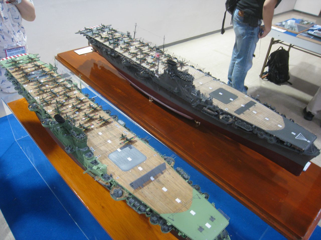

This link will take you to a great 1/350 version of what you propose, less a camouflaged flight deck: http://hobbycom.jp/my/774037658e/photo/products/42604

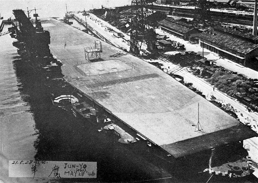

Dan, the model you just linked to has rocket launchers on the port quarter as well as on both bows. That also seems to be supported by the ship photos above. Rockets on both bows and on the port quarter, but not the starboard quarter.Dan K wrote:My pleasure.

Nicely staged model.

Yeah, that's definitely a model.Dan K wrote:Nicely staged model.

Looks effective. The postwar view of Junyo's flight deck is clearly more worn from lack of maintenance.
