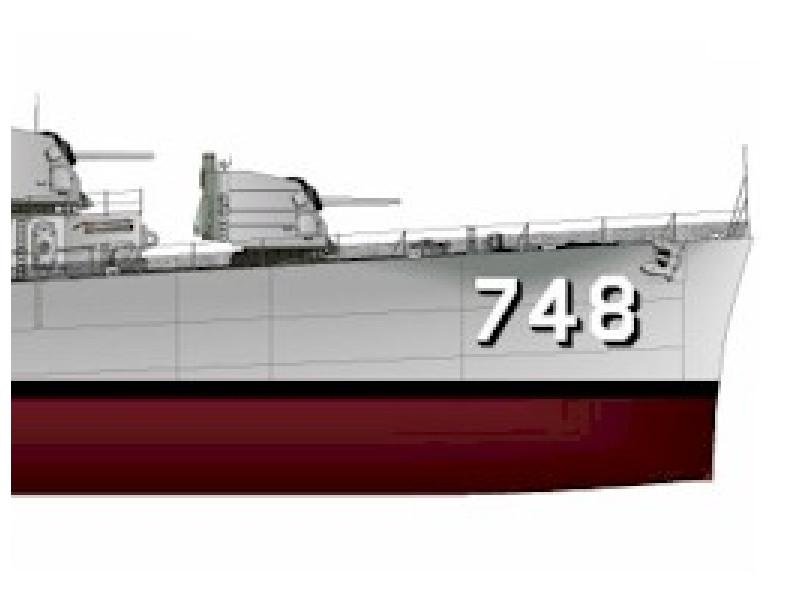

What do you mean by "Will like to see pennant number!!"?
Do you mean putting the radio call sign signal flags on the model?

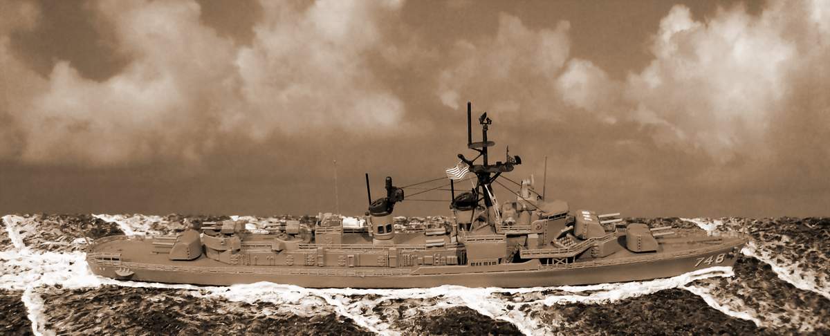

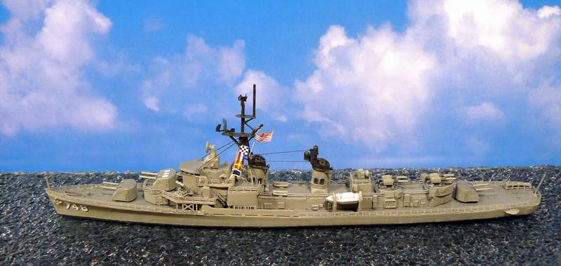

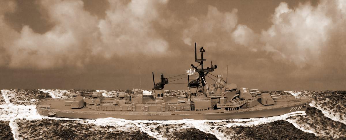

I think she's ready for paint! The radars are in the mail...............

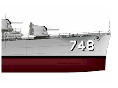

Hi NukeMM!NukeMM wrote:Jimmy,
Thanks for the kind words. I'm getting better as I go along.
I just received some 1/700 signal flag decals in the mail from Pacific Front Hobbies. They are "Trident Hobbies" brand decals. The signal flags look just a little too, big however. I'd need to put on an even larger ensign flag to make them look right. We'll just have to try and see.
You are welcome.
I was referring about pennant number painted in the hull, not the call S flags... I love to see the numeral 7 painted in models!
See the pic..........
http://www.navsource.org/archives/05/0574813.jpg

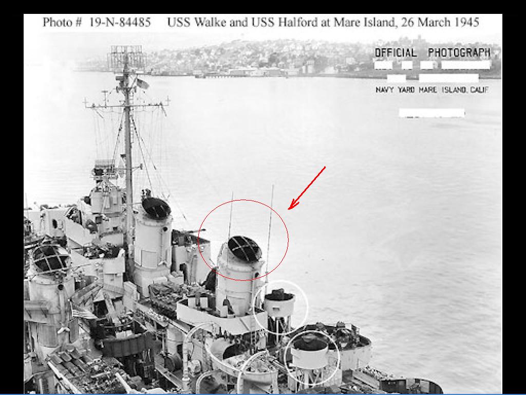

Re: Calling all USS Sumner/Gearing class (DD) fans
Yes, you are correct.... see the funnel cap in the photo...... and the veteran served on her!!!! ( USS "Harry E. Hubbard": She's so beautiful in the photos!!! ( Use female gender for ships!!!) )NukeMM wrote:I'm working on a 1/700 Skywave/Pit-Road Sumner kit conversion into the USS Harry E. Hubbad DD-748 for a veteran who served on her (him?) from 1962 to 1966.
I used the bridge section of the Gearing kit and JAG's PE from their FRAM II kit for the mast. I was going to change the stacks to the later tapered funnel version, as shown in an art print that the veteran had, but I think that that artist's rendition was incorrect. I have seen no photos of the HEH with the tapered funnels, at all, for any time period, so I'm going to stick with the original stack design.

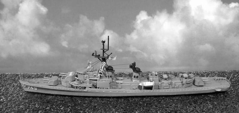

Mast is OK!

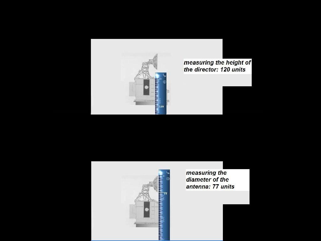

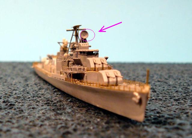

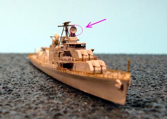

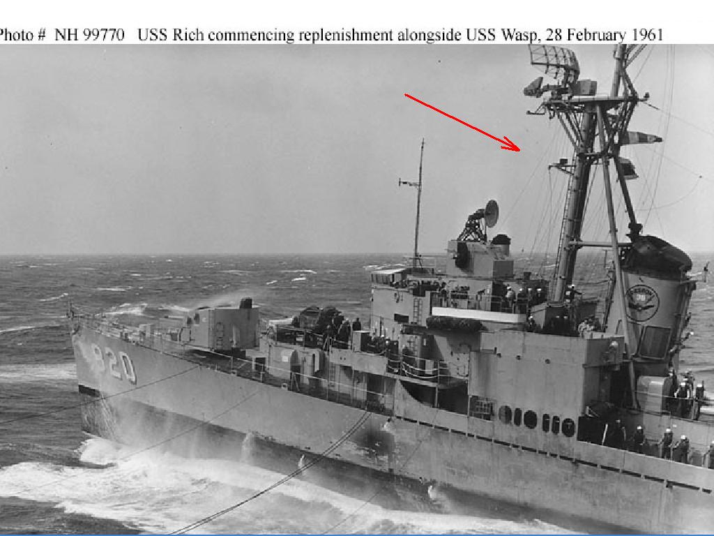

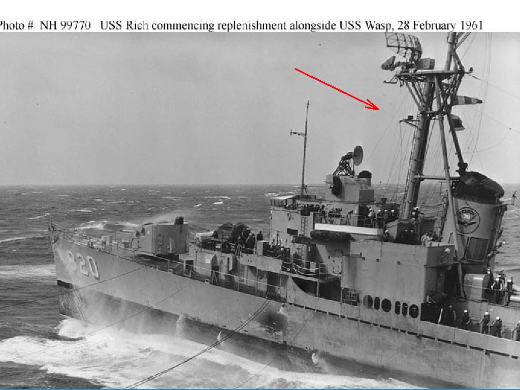

In the period 1962 to 1966 Sumner� class were using LARGE hull numbers............ not the old little style......

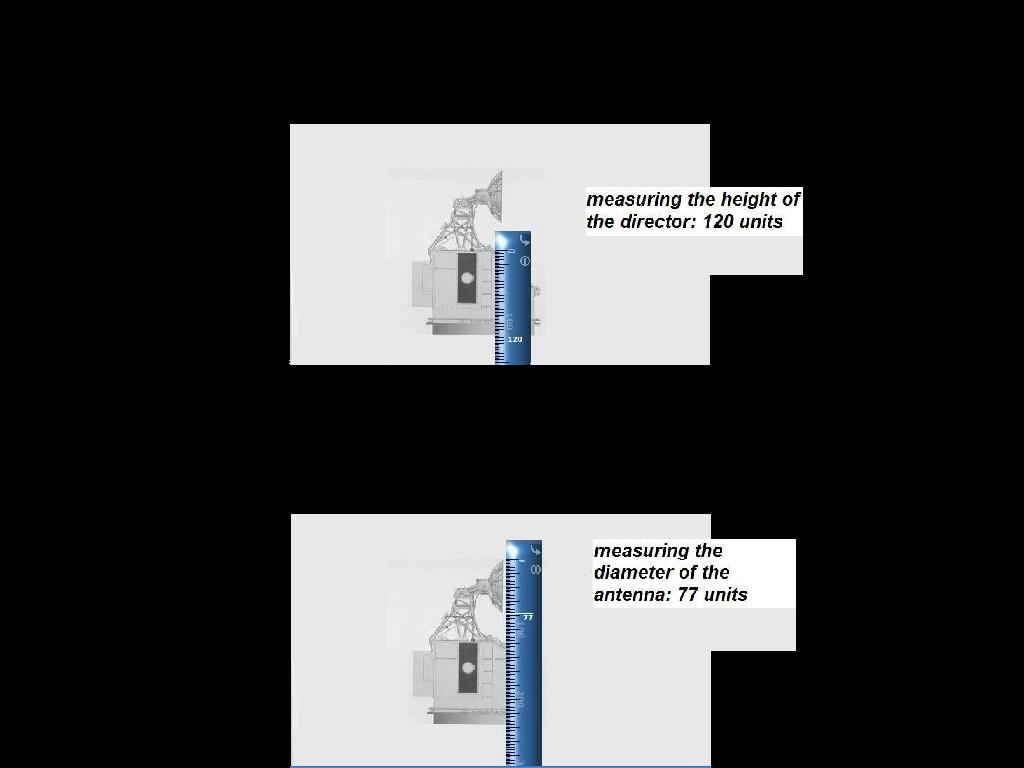

I was examining the proportions of the antenna and director mk 37 and seems to me that the antenna in your model is a bit bigger than should. I took some measures of those parts and post a drawing......... if the image tells and you can understand!
Measuring some plans for the mk 37 director I could notice a proportion of 77/120, or 25/31 between the diameter of the antenna and the height of the director ........
This is just an opinion in order to improve your model!
Nice regards: Jimmy
Nice regards: Jimmy

Thanks for your calibrated eye! It must come in pretty handy. Most of modifications have been by eye and not actual measurements.
The Mk37 dish came with the kit. But maybe I have the wrong dish mounted on it. I'll double check. I have a lot of 1/700 part sprues that I am using, back and forth.
Thanks for the pointing out the light mount in the middle of the mast. I hadn't noticed one in photos of the Hubbard on NavSource.org.
I will post photos of my completed model after it is in the hands of the Hubbard veteran.

Hi NukeMM!!NukeMM wrote:Jimmy,
Nice to me to give a little help, sorry to point some mistake, but you know your model pleases me at all. I put some link to "Allen Sumner" plans that may be of some use, even if in a different configuration.
What about scratchbuilding a new antenna if you don't find a new one in the right scale?
Keep the photos coming!!!
Nice regards: Jimmy

Jimmy Conway wrote:Hi NukeMM!!NukeMM wrote:Jimmy,
Nice regards: Jimmy
Jimmy,
I guess that the dish antenna did not come with the kit, but from a Skywave/Pit-Road Equipment Set. It is the smallest dish that I have. I have a smaller one from a spare JAG resin sprue, but it is too, fragile to clean up and install. I'm going to live with the radar dish that is on it. The veteran won't tell the difference, but I'll keep this in mind for next time.
A fellow shipmate of the veteran of the Hubbard just now provided these two photos of the Harry E. Hubbard. They would have been really nice to have had when I started the modification of the model. I think that I have gotten it pretty close for this small scale. I do notice that the tripod mast on my model doesn't extend down to the O2 deck. The photo-etched tripod mast that I used was from JAG's Sumner FRAM II and I don't see how it could have extended down to the O2 deck from the O3 deck. Unless, I should have attached the aft stanchions of the tripod to plastic rod and extended it further down. Maybe that's how it was supposed to be done, even on the JAG model. I wish that I would have realized that before now.
Here is a glimpse of my Hubbard's mast.

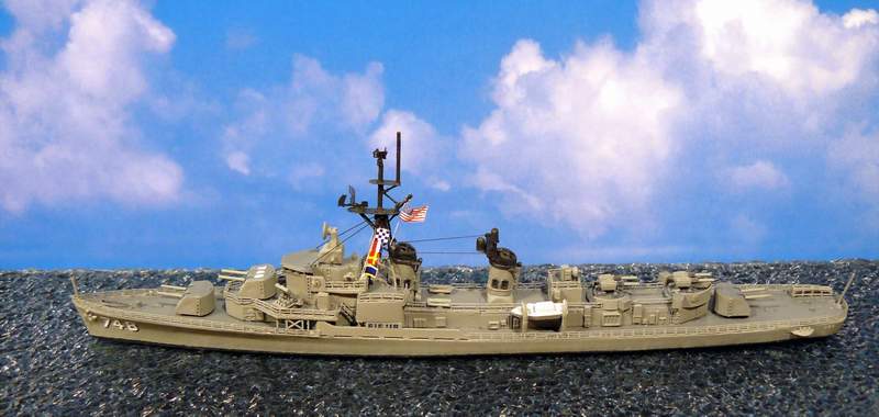

- Jimmy Conway
- Posts: 786
- Joined: Wed May 23, 2007 10:46 am
- Location: Rio de Janeiro - Brazil
NukeMM,
your model is very nice, the photos are great.
I hope the veteran will be very glad with the model and the job you made.
I like very much the way you put the model, just as a little diorama, even with a blue sky!!!!
I made some BW version for this photo, to take back the ship to the 50"s!!
See as follow!
Nice regards: Jimmy
See as follow!
Nice regards: Jimmy

NukeMM
- Back-Aft Models
- Posts: 2980
- Joined: Tue Feb 05, 2008 12:44 am
- Location: Omaha, NE, USA
How is this effect, Jimmy?
