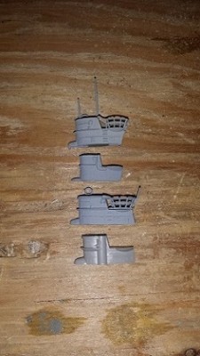

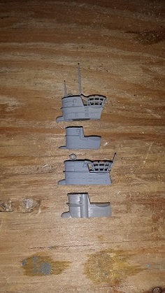

So im wondering who has the scale wrong?
The top is AFV Type VII Bfollowed by the Hobby boss type VIIA. I think it SHOULD be the same coning tower. Next is the Revell Type VIID followed by the Hobby Boss Type VIIC which again, those two towers SHOULD be the same size. Any takers on this one?

Well, they are NOT the same conning tower types. The number of variations is very great, and this already started with the VIIA (which was in fact called plainly 'VII'). Before the war there was only this small platform carrying a 20mm, but then it was enlarged to form the first Wintergarten platform. So both apply to the VIIA.The top is AFV Type VII Bfollowed by the Hobby boss type VIIA. I think it SHOULD be the same coning tower. Next is the Revell Type VIID followed by the Hobby Boss Type VIIC which again, those two towers SHOULD be the same size. Any takers on this one?
Something similar for the VIIB: originally (see all pictures of U 47 returning from their victory at Scapa Flow) just a small platform, but later the same ship had a more extended platform too. Also, the VIIB had some visible air trunking on the outside of the tower, which seems particular for this type.
So forget about there being a small number of distinct tower shapes, there are really a lot of variations of each basic type, and you need to study photo's of a particular ship (at a specific date!) closely.

Well Im aware of all that, but by looking at the material I have it looks like the AFV Type VIIB tower is bigger than the HB Type VIIC tower. I dont think that should be the case. My point is that I think the hb conning towers are under scale.
