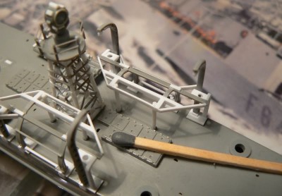

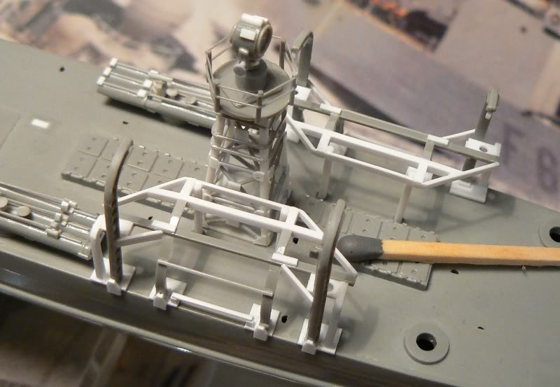

Here are the twin davits, minus the railings in the outer elements. Made using three pieces of the box, and the rest made with Evergreen strip and rod.
It needed quite a bit of work, including a complete reconstruction after being completely finished the first time -- after the painful discovery that they were two milimiters too wide, and would not suit by the searchlight tower :censored_2:
I hope you like them.

Tracy White
Posts: 10632
Location: EG48
Post by Tracy White »
VERY nice... much more than what I did!
That area was a pain for me as I had to change the dimensions on the midships superstructure (Gallery superstructure) and it affected the pre-cut PE sets I had quite a bit.
wr
Post by wr »
Dear Willie,
Do you intend to fit four sets of torpedo tubes?
What do the photos of Cambeltown show for the above, also, are the two sets of davits of the original USN pattern, or has one of them been replaced by the RN style?
Willie
Posts: 696
Location: Vigo, Spain
Post by Willie »
Hi there, WR,
No, I intend to install only two sets of torpedo tubes ( the two fore sets ) as the aft ones were removed in Refit 1 stage.
The holes you see aft are the place of the removed torpedo tube sets, that have been filed-down, but not completely erased yet.
The davits are the ones of the original USN pattern. The pic of mid. 1941 is very blurr, but this detail can be clearly seen in it, as these davits had a very distinctive shape, very easy to recognize.
In the same pic the fore torpedo tubes are seen pointing forward, as was commonly the case, and this is a tip we can make good use of too.

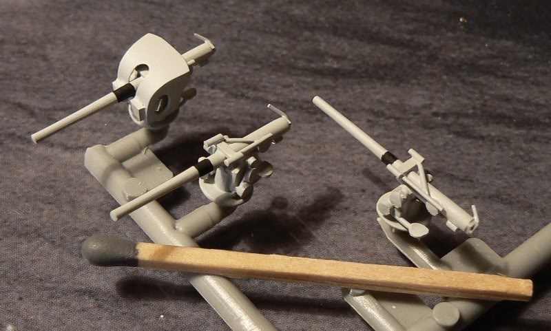

Hi all,
Here you are a pic of the three main guns, already glued, painted, mounted and ready to set in place.
The setting of the shield for gun no. 1 was quite exasperating, as I had to achieve a realistic compromise between the gun mounting, the height of the shield and the length of the gun optics and brakes. All things considered I think it is not too bad.
I hope you like it.
Very best regards from Spain,
Willie.[/size]

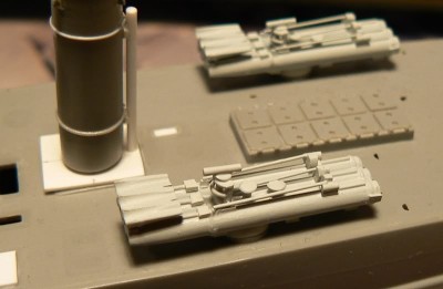

The torpedo tubes are ready as well, with covers folded.
As usual, the paint was thinned to a 30 %, to make it very fluid, and allow the little details come up after it dries.
Brgds,
Willie.[/size]

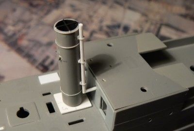

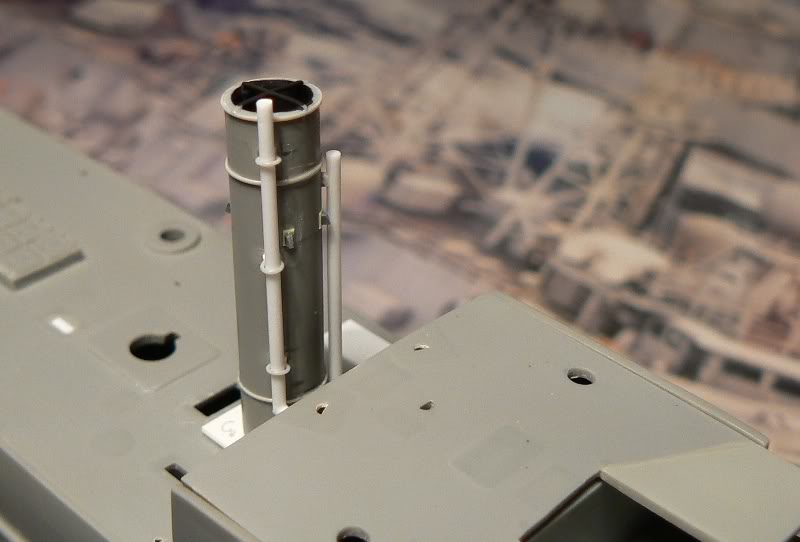

A little trick that was a headache until I found out how to solve it, just in case it is useful for somebody.
Stack nr.3 is quite strange, as it has got not only the steam exhaust, but also the galley stack.
This last stack is placed almost 90 degrees on deck but slightly turned aside from the centerline, in a quite uncomfortable position to be fixed after the completion of the model, so that it was necessary to place it before finishing the rest of the model. On the other hand, the height of the lower part of the tube has to be exact, as it has to be inside the hole on the galley bulkhead, so after much hesitation I decided to build three rings with stretched sprue, to place them on three little plates made with yogourth container, to slide the rings on the tube, and to glue them on the stack.
In the process we achieve two things : [a] The tube is perfectly mobile to be placed in position, and to adapt distances and angles to the galley bulkhead before glueing, and we achieve a greater realism, as the galley stack was actually fixed to the main stack in this way.
This is the first time I build mobile pieces, and I am modestly satisfied of the results.
Very best regards to you all,
Willie.[/size]

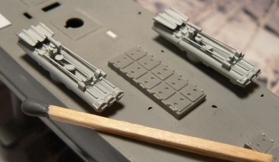

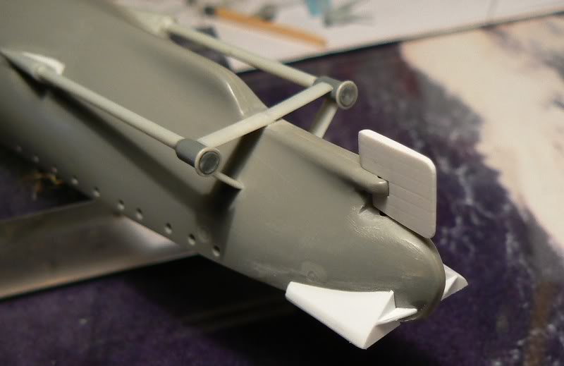

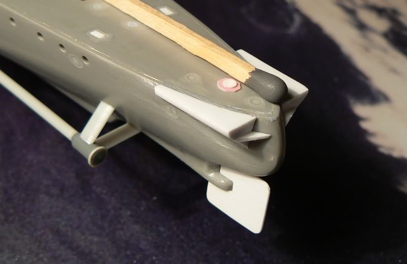

A couple of the elements I was very anxious about : The outboard supoports for the depth charge racks, a distintc element of the Town Class. They are made with four elements each, all of them the with the corresponding curve of the hull.
I think I have achieved to avoid the joints, so that I do not have to use putty, which would be very difficult to sand away here, in such limited spaces.
The process of construction of both rudder and screw shafts can be seen quite clearly as well. These are two of the elements whose construction I enjoyed most.
Very best regards,
Willie.[/size]
