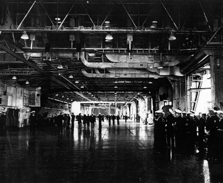

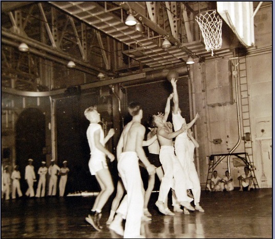

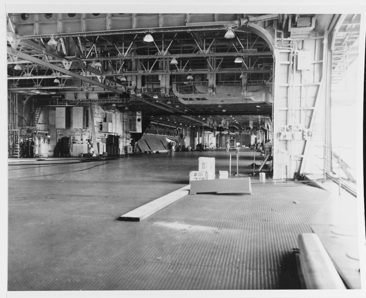

Building the 1/200 scale kit. Would anyone know if the inside of the hangar doors since being roller doors would be white the same as the rest of the hangar bay walls or perhaps they were left in their natural metal state? I've searched online but can't see any details pics to clarify.
Thanks in advance.

The more I investigate it's possible that the hangar bay bulkheads and overheads were in fact painted silver not white. The hangar doors are a darker shade again due to different metal. There's a photo of the hangar bay of the Wasp showing this and I wouldn't think the Hornet would be much different. I'm going with anodize silver with steel for the doors.

The silver would have been the pre-war carriers and we don't know when its use was stopped, so it's possible that Hornet was commissioned with white bulkheads and overheads. It's something the modeler is going to have to decide on their own at this point as we don't even have documentation that proves silver paint, let alone orders discontinuing its use.

Thanks for the feedback Tracy. Attached are a couple of photo's of the Hornet around commissioning time that I found. The overheads in both photos appear to be metal and not white. The bulkheads I'm not sure.It would be great if we could one day find the documents proving one way or the other.
