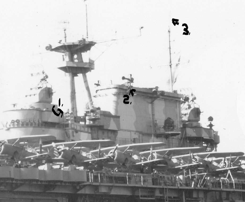

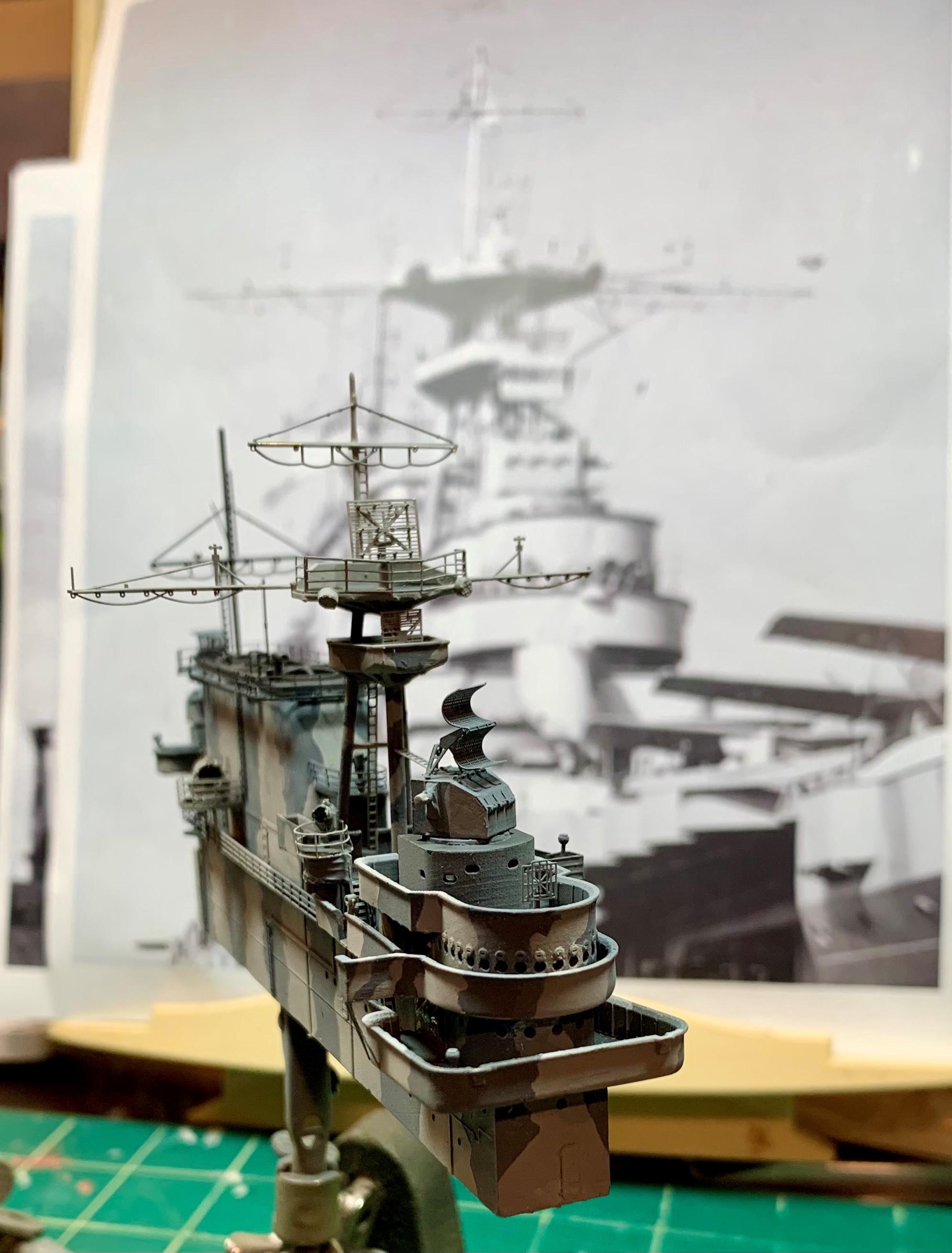

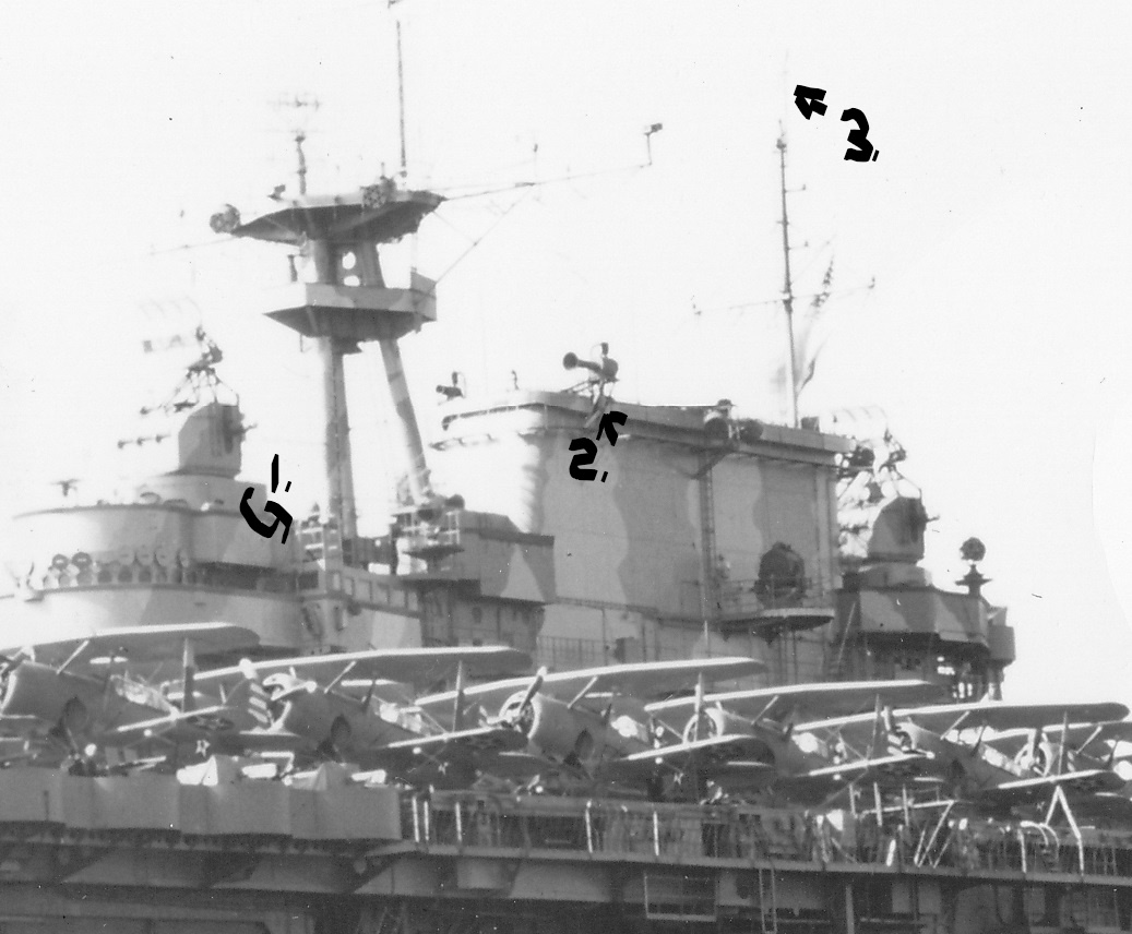

A few more CV-8 related questions, on this anniversary of her demise....
1 - What's this? A pelorus?
2 - Any better shots of this area where the siren is? I have tons of photos from NARA, I've perused all the usual sites, but this is the best I can find
3 - what's this skinny pole on top of the main mast?
Here's a crop of the siren area
HornetIsland03 (2).jpg (52.62 KiB) Viewed 11814 times

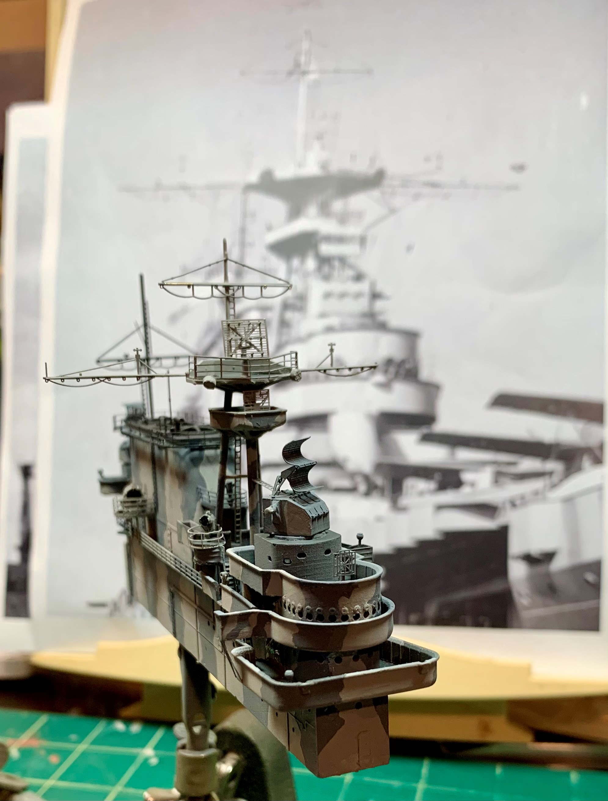

Trying to dress up the island with a bit more detail.
Posts: 8593
Re: Calling all USS Hornet CV-8 fans
The searchlights look like they are painted a darker color than the the rest of the island. What's the consensus - black?

Martin -
Fine looking work there. Very impressive.
I might be able to shed some light on your questions, but I don't have a good HD version of the picture to which you refer. Having said that, do you have a copy of Davis Doyle's recent book on HORNET? If so, check out page 50. The photo shows the general area to which you are pointing with arrow #1. The photo is looking aft, taken from forward of that area (just aft of the Mk 37 director). There is what looks like a DF loop in the area where your arrow points. In some photos, the loop is apparently turned perpendicular to ship centerline and is not clearly seen as a loop. It does show up as a loop in the MD Silver plans (p.43). Also in the page 50 photo, just inside the splinter shield / windbreak on the port side is an odd looking device shaped kinda like a carronade. It does not show on the MD Silver plans. But forward of the spot where the picture was taken and inside the shield around the Mk. 37 there is a notation there calling out a "target designator" (p. 28). The plans show one to port, one to starboard. Not sure which of the devices your arrow could be highlighting, though, but here's a veritable "52 Pickup" of choices for you! OBTW, on pages 53, 55, and 56 in Doyle there are photos that show the searchlights mounted to the stack - port and starboard - that do appear darker than surrounding painted areas. I can see no obvious reason for the color differences other than different paint color.
Arrow #2 - The plans do not show the ship's horn / whistle in that location so I have nothing that tells me anymore than what you show. MD Silver plans (p. 92) show a decent view of the "Loud Speaker Foundation" close to the middle uptake as shown in the picture. But no similar foundation for the horn anywhere on the top of the stack. It might have been moved up there in the post-commissioning yard period in Jan / Feb '42 to get better sound coverage. Doyle's book on CV-5 (P. 40) shows YORKTOWN's horn located on the stack's centerline at the forward edge, and at about the same height as CV-8's. The foundation is more elaborate.
Arrow #3 - MD Silver plans (p. 81) indicate the top section of the Mainmast is a (wait for it . . .) "Flag Staff". At the very top is a flat device call a "Trident" (???) with halyards attached. The flagstaff appears to slide down along the starboard side of the mast for bridge clearance. Page 80 shows how the Foremast hinges aft also to clear bridges.
HTH

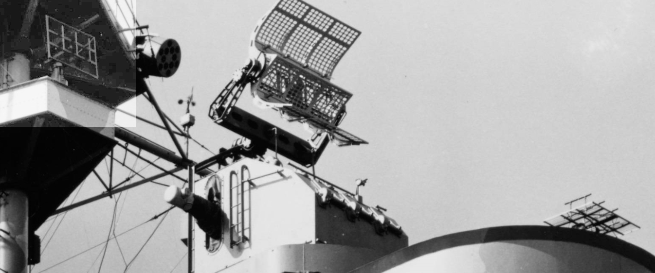

Thanks John - appreciate your comments and the info. I'd love to get a better look at the structure that DF loop sits on - it doesn't seem to sit on the deck, surrounded by a cage, as on CV-5 and CV-6, but appears to be raised.
One last question - do the MS plans indicate what the antenna in front of the forward Mk37 director is? There's a small pole and antenna there, and I can't figure out what it is.

Martin -
SPECINT alert. The following based on speculative intelligence.
The DF loop is pretty large, therefore I suspect it is used for ship's navigation - deriving a line of bearing to a shore transmitter most likely, - as opposed to the small loops located at and under the aft flight deck rounddown. The construction plans for HORNET show three bar railings in a number of places on the upper island structure which were later replaced by splinter shields during the yard period before she sailed for the Pac. I am guessing the loop was raised up on a small, probably circular structure so the loop could have a clear sight line above the steel splinter shield / windbreak.
The small antenna forward of the Mk 37 and atop the pilot house roof is actually a hamburger cooker - one of those rectangular mesh devices where you put the burger between the two sides and close it the device so it doesn't drop the burger on the charcoal.
No, probably not buying that I'll bet. Oh well, in that case turn to Doyle's CV-8 book, pages 54, 55, 58, 59, and 60 and you'll see the antenna. Looks like a small rectangular radar antenna similar to a BI (see Doyle CV-8 book p. 49). Similar but not the same. The photos on p. 54, 55, 59 show the antenna apparently horizontal, the two shots on p. 58 and 60 show it apparently vertical. The shot on p. 60 is particularly cool as it shows most of the antenna grid visible against a light backdrop. Perhaps it is a small backup surface search radar for entry to a foggy port.
End SPECINT.

I note the antenna shows up in your picture posted above, now that I know what I'm looking for - looks like a "T" forward of the Mk.37 peeking just above the splinter shield / windbreak above the pilothouse windows.

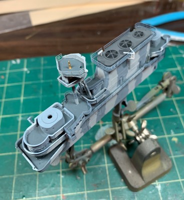

Thanks John. Seems like the only views I get of it or what Tim the Toolman had of Wilson, his neighbor.

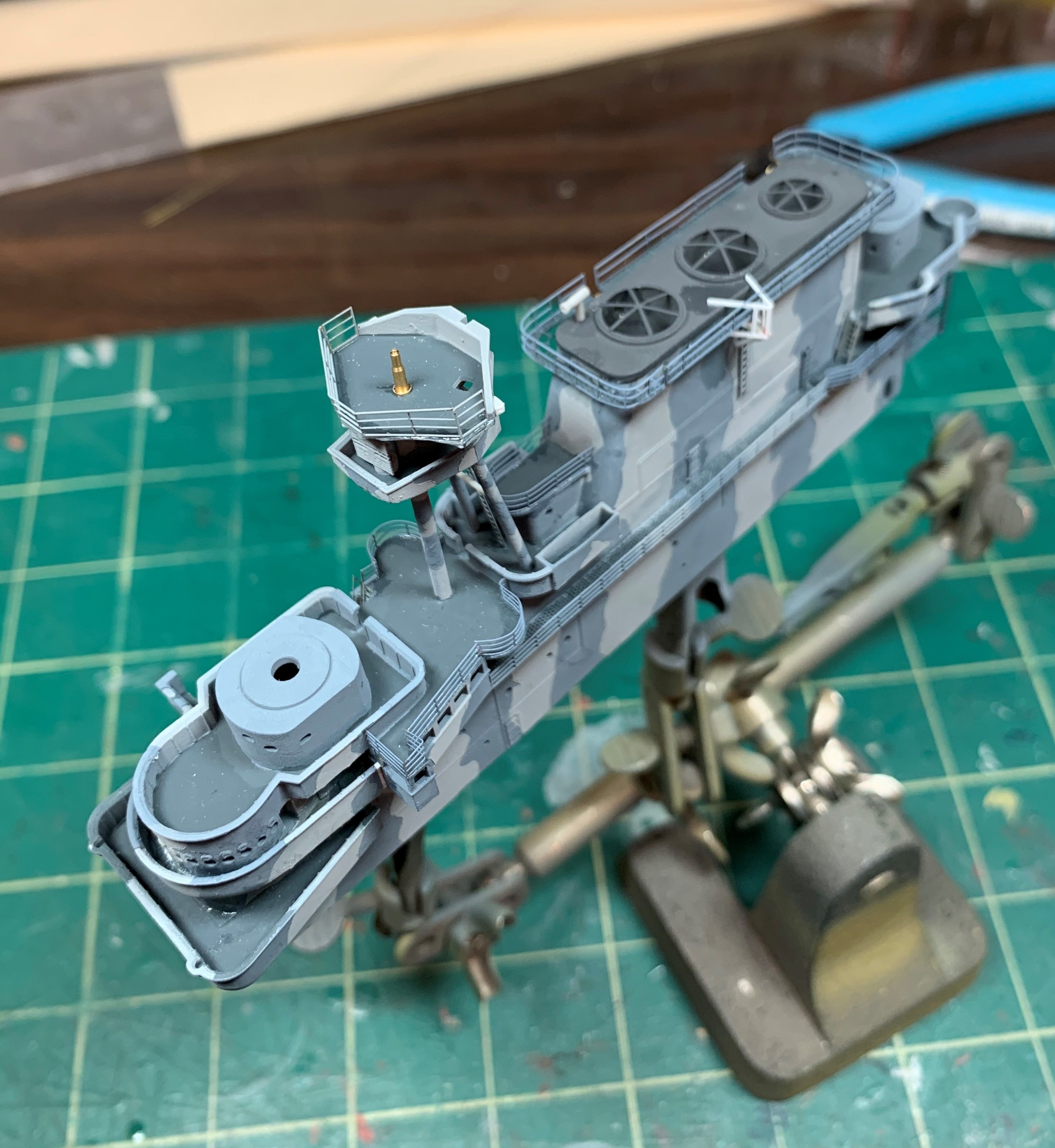

I cobbled something together with a 1/700 SC radar and plastic rod. No one can tell me I'm wrong, since they can't see it either!

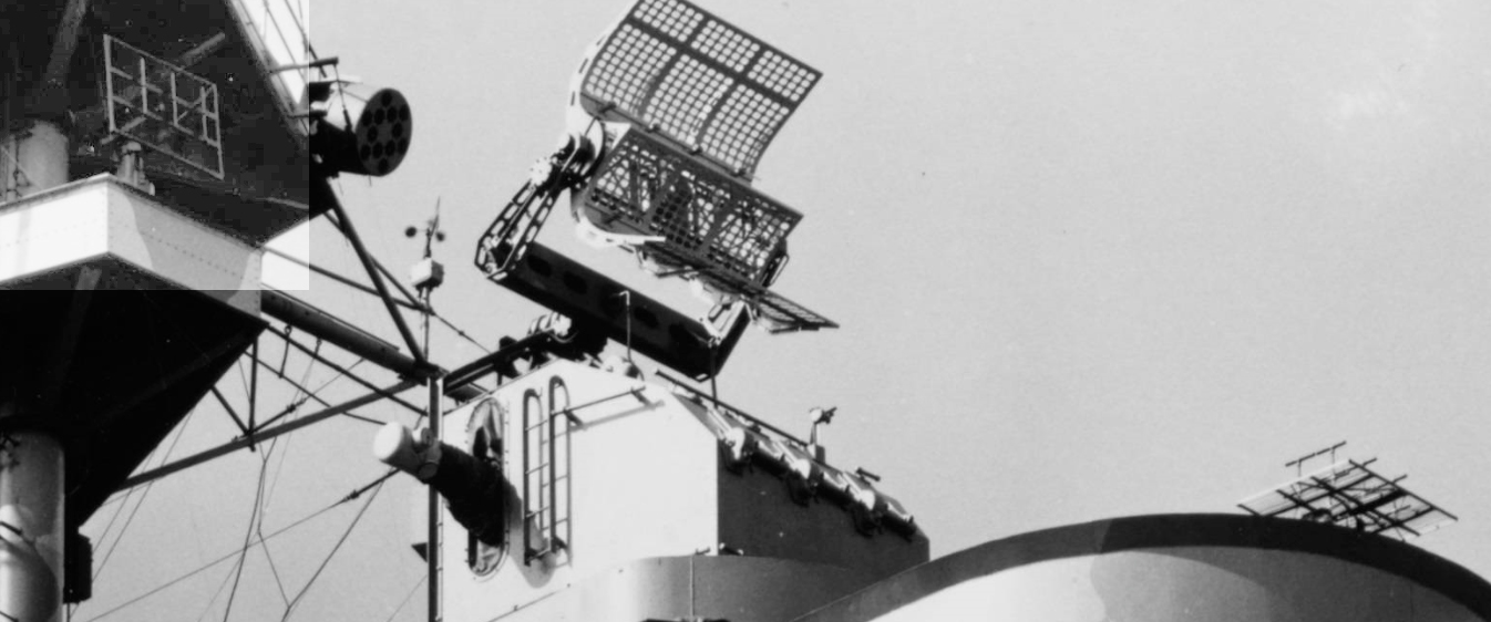

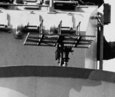

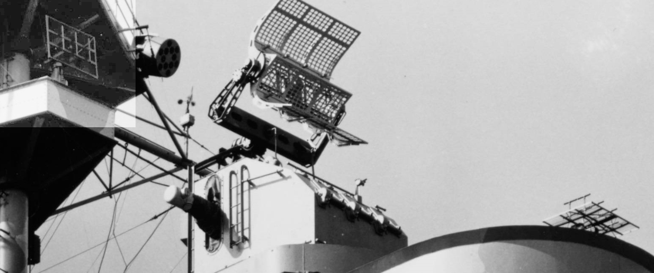

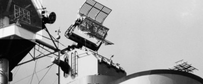

I've noticed same antenna in the yard photos of CV-8 -- to me the reflector aimed upwards looks identical to the "BI" antenna on the foremast platform described in the Doyle book. I recall Rick Davis mentioning something about these IFF systems being trialled on the CVs, but now that I search back for it, I can't find the post... it was somewhere either in this thread, the YORKTOWN thread, or the ENTERPRISE thread... :woo_hoo:
Attaching a view I have - the BI antenna on the foremast platform has had brightness/levels adjusted to make the detail more obvious.

Posts: 8593
Thanks Ian. That's the clearest look I've seen of that area.
Rick - thanks for the info. The location of the smaller antenna is a head scratcher, as it would only be able to transmit in receive in a limited arc. At this point, no one can tell me what I've fabricated is right or wrong!

Martin, I can't answer your question directly, but somewhere in the back of my mind I thought they had two of these Yagi antennas, which as you can see are hard to see. The problems with line of sight and correlating these separate antennas from the search radars, was why the USN went with colocating the search and fire control antennas with the IFF antenna. In the early periods with the FD radar and SC/SC-1 search radars on destroyers (and other ships), the IFF function was handled via the BL "stovepipe" antenna which was omnidirectional and less than precise on which aircraft was a friend and not.

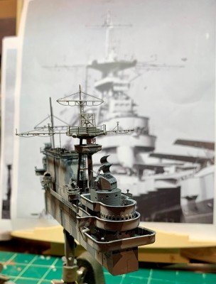

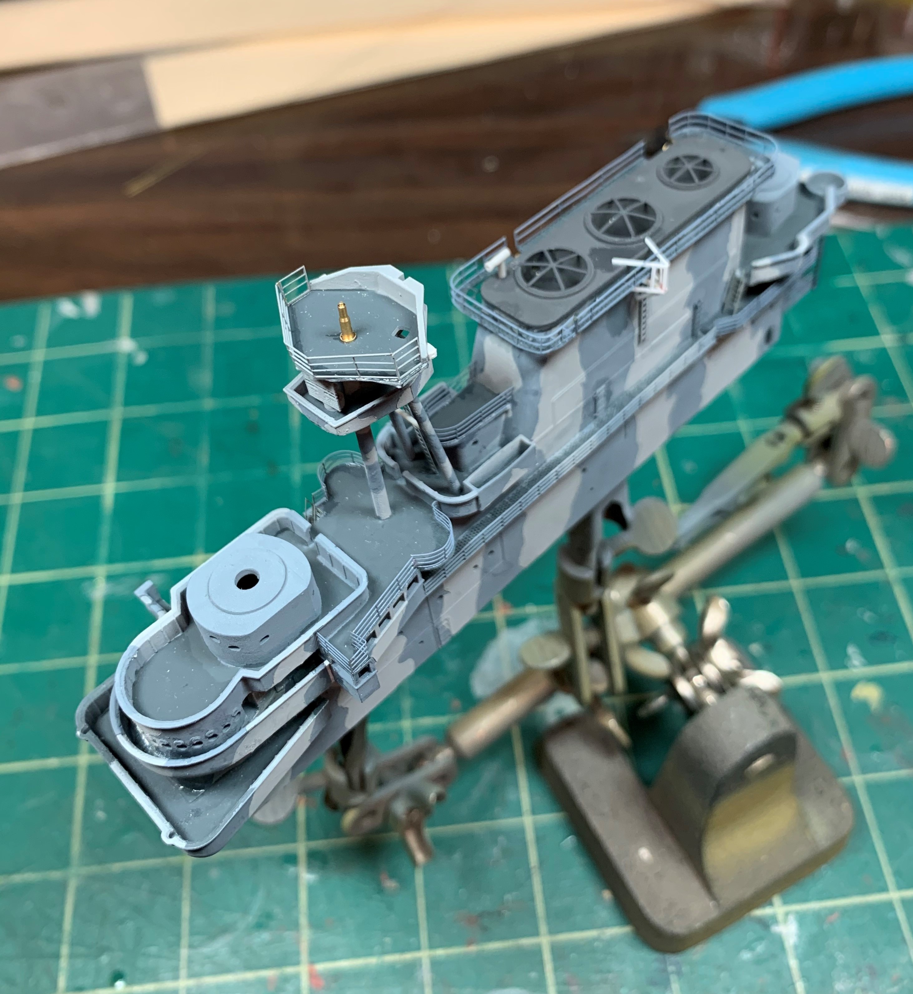

I improvised. No one can tell me I'm wrong (of course, now a picture will show up)

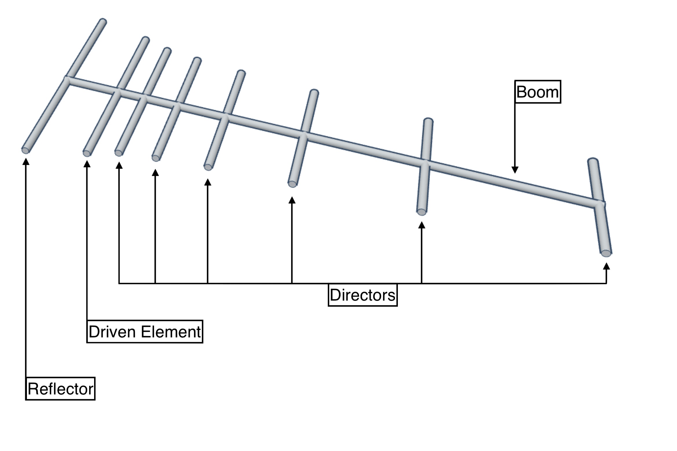

You don't have to change anything if you don't want to. As you say, not many people will know the difference. But, the antenna you have made before the Mk 37 director isn't a Yagi type antenna. Look at the image that Ian posted and it is clear that the antenna before the Mk 37 director is a Yagi type. The antenna in the foremast, is a mattress/curtain type antenna. Without getting into antenna theory, "Mattress/Curtain" type antennas, like SC, CXAM, etc can be called "vertical arrays" that use multiple dipoles to get more power gain with a reflector screen. Yagi antennas, use "horizontal arrays" stacked in series and maybe also in parallel to get more gain. Yagi antennas were seen on a lot of USN aircraft during WWII. They were more compact and feasible on an aircraft platform. A common type of Yagi antennas seen today are for use as TV and radio antennas.

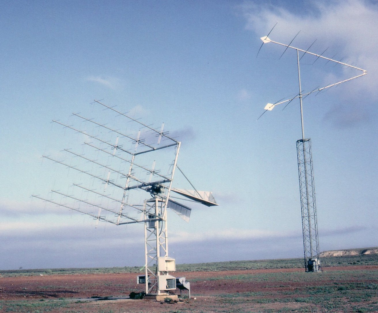

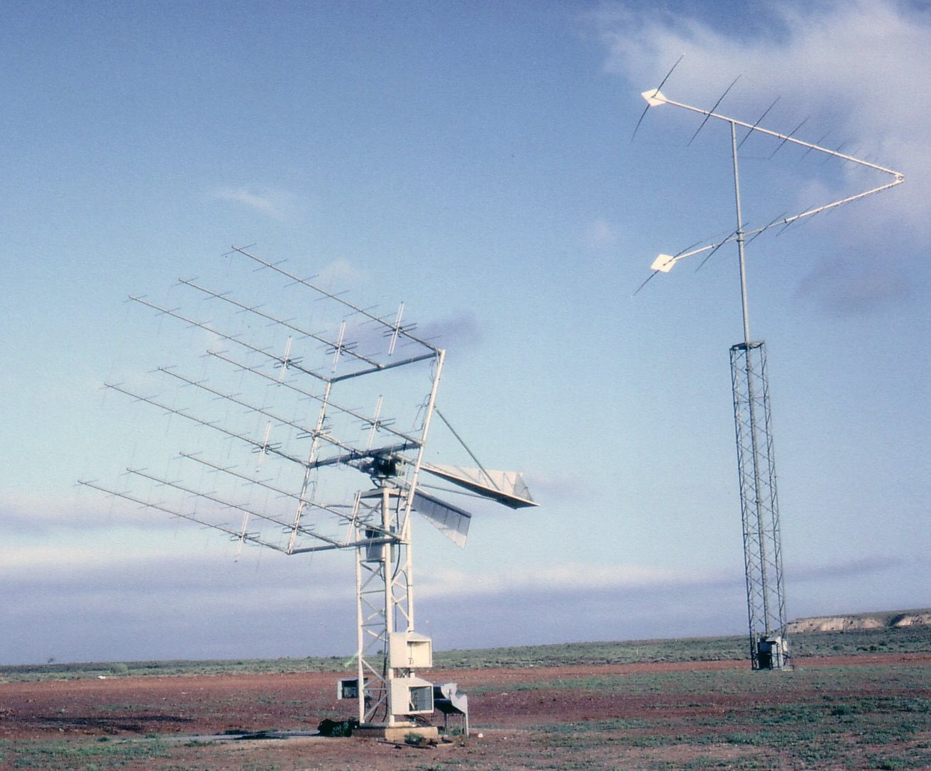

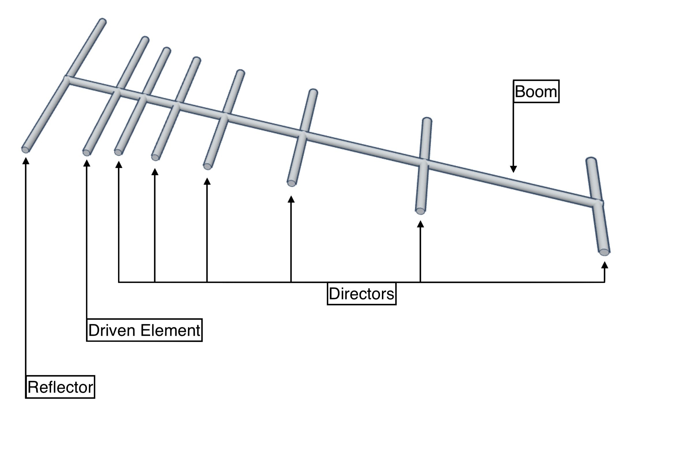

How then Yagi antennas have many different designs. Below are some types and callouts as to what various parts of them are for.
Like everyone else, I can't tell from the Ian image what the whole antenna looks like, but it looks like it is a wide Yagi with maybe two or three parallel arrays. What the separate dipole at the top is for, I don't know. For reference, I have copied Ian's image and reposted it here.
You could for all practical purposes, rotate your antenna down 90-degrees and approximate the antenna as it appears in the image. Of course many will say "Hey Martin, your antenna fell over!" :big_grin:

Thanks Rick. In some of the photos of Hornet, it does look like that antenna is in the position I put it in. At this point, I'm going to leave it and dare someone to prove me wrong! :)

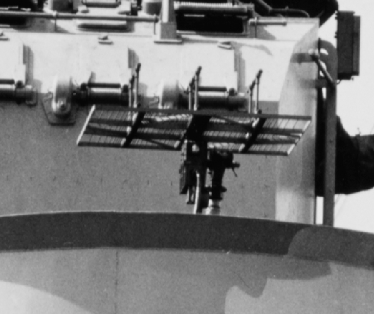

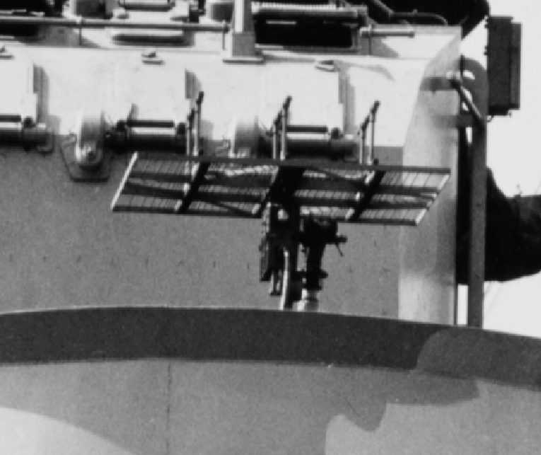

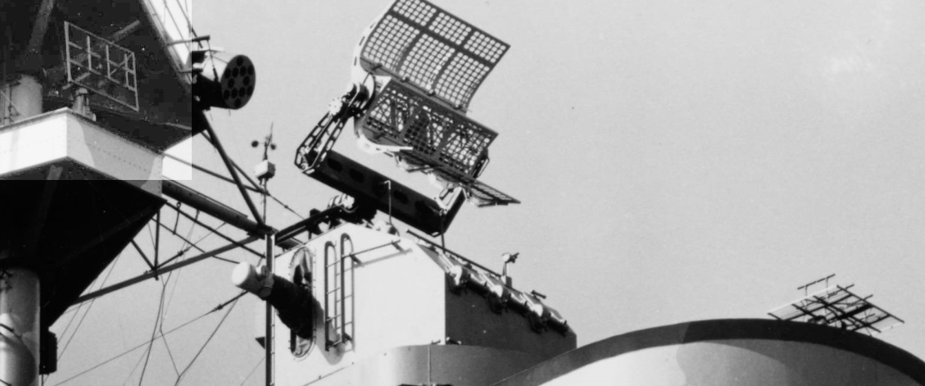

Here's another view of the reflector forward of the Mark 37 director:
Again, to my eyes this reflector looks identical to the one mounted on the foremast. My guess for this antenna is that it was elevated to aim straight up to clear space for work on that deck, but as always that's a guess.
Martin - your model is looking fantastic!

Thanks Ian - for the photo and for the comments. Much appreciated. I agree, I think it's turn up for the moment.
