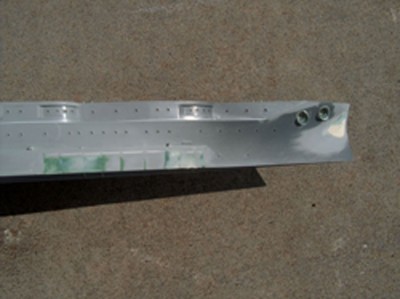

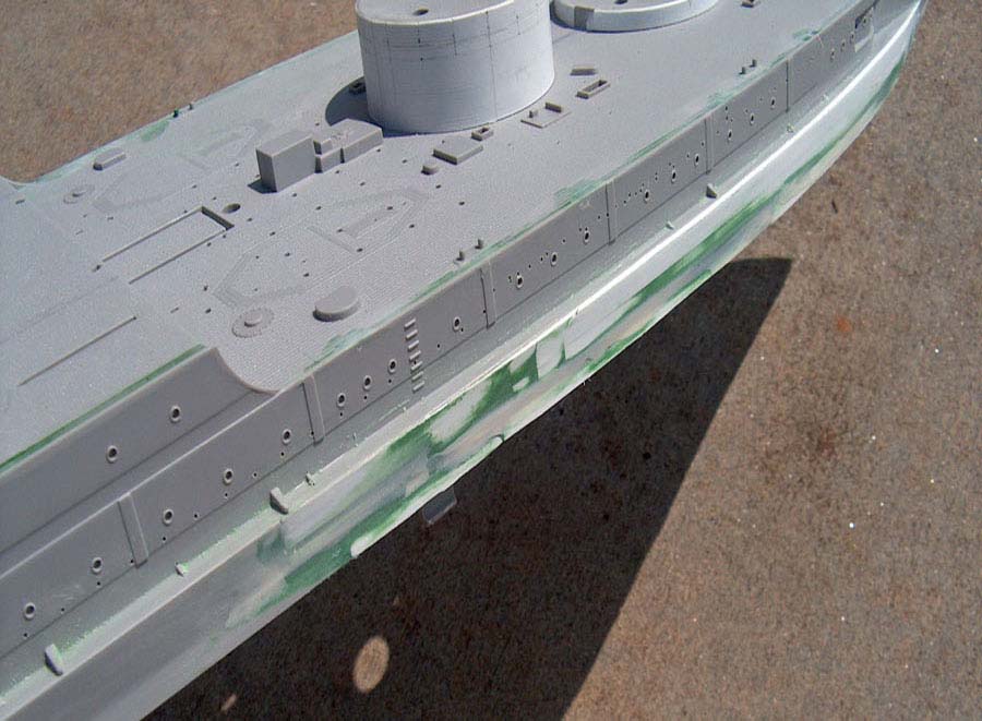

Now that someone has kindly shown me how easily it is to post pics I can now show what progress I have made. I won't have to bother Tracy anymore and I'm sure he's very happy.
. I have to some repair work on the hawse pipes as I broke one and the two on the port side are oversized. I have tried to correct the blister at the forward ends and also I am widening the blisters at the aft end. Hope you like. All comments welcomed as I know that what I have done is not perfect.

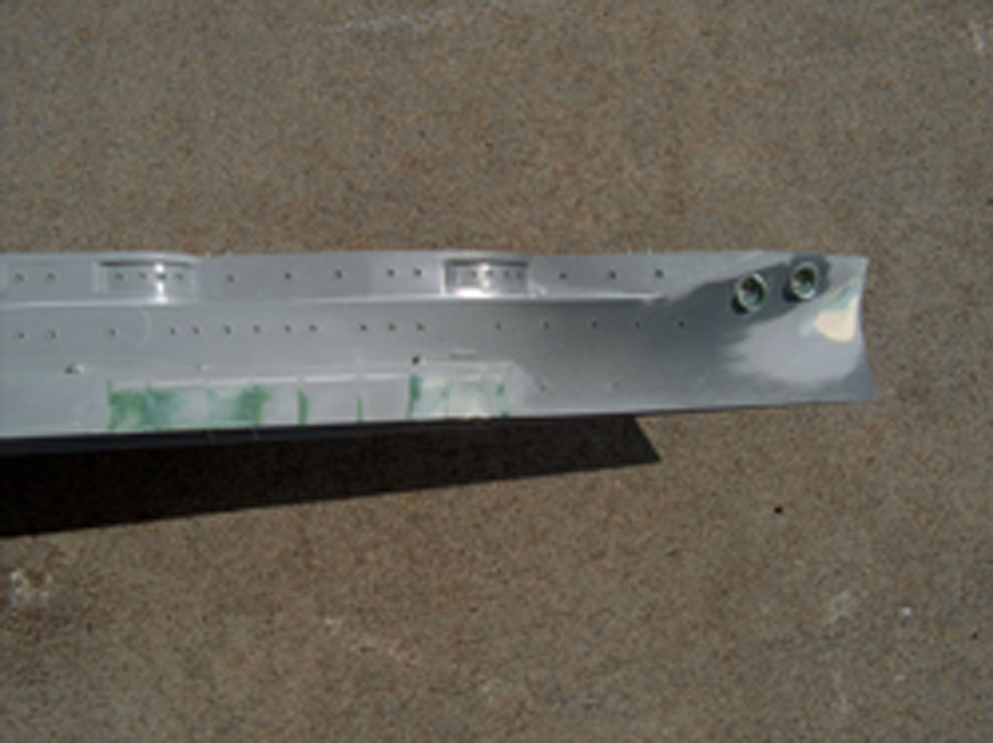

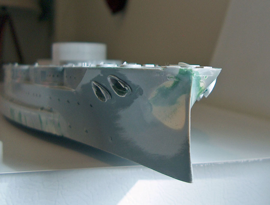

I tried to attach more pics but it didn't work for me. Please bear with me. I filled the bow with resin and now you can see how much of the plastic at the bow I sanded away by how much resin is exposed.

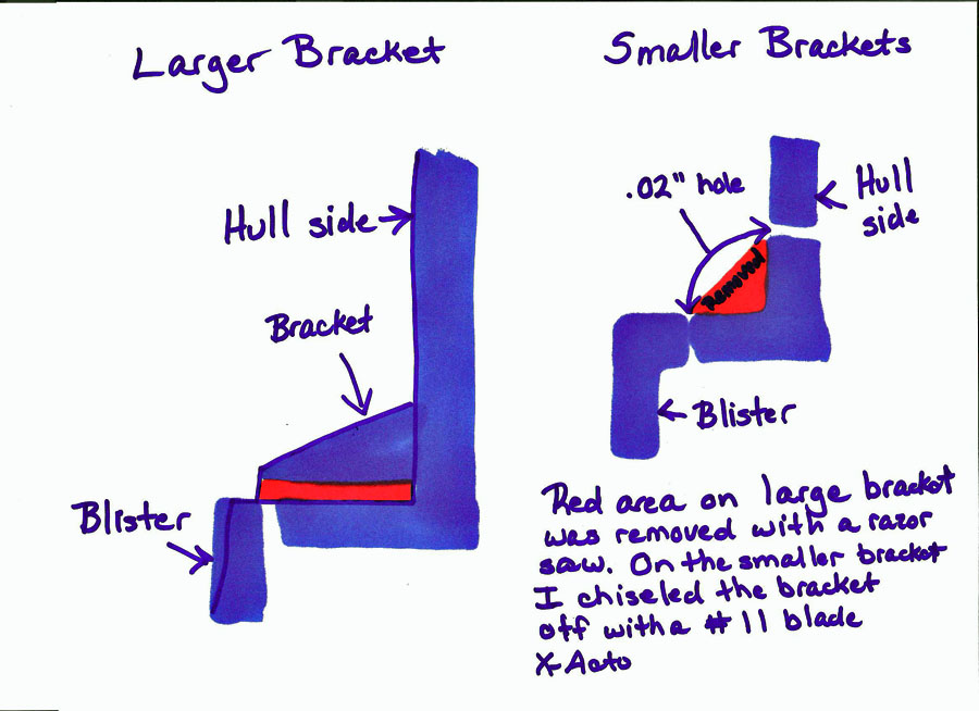

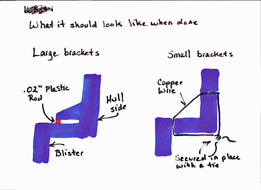

John D, before I started to mess with the blisters, I made some changes to those two types of brackets that you see that set ontop of the blisters and connect to the upper hull sides. I'll draw up a pic to show what changes I am making to the larger type. In regards to the smaller brackets , I cut them all off only after I driilled a .02" hole at each end so that I may run some copper wire through the holes thus creating a some what more accurate version. When it comes to the avgas line on the port side, I drilled one .02" hole every 1/8" where the line runs along the hull side. Here I plan to spot glue the avgas line and then run nylon thred through the holes which will give a decent representation of the mounting brackets.
Sorry for the crude drawings but I'm limited in time this morning
