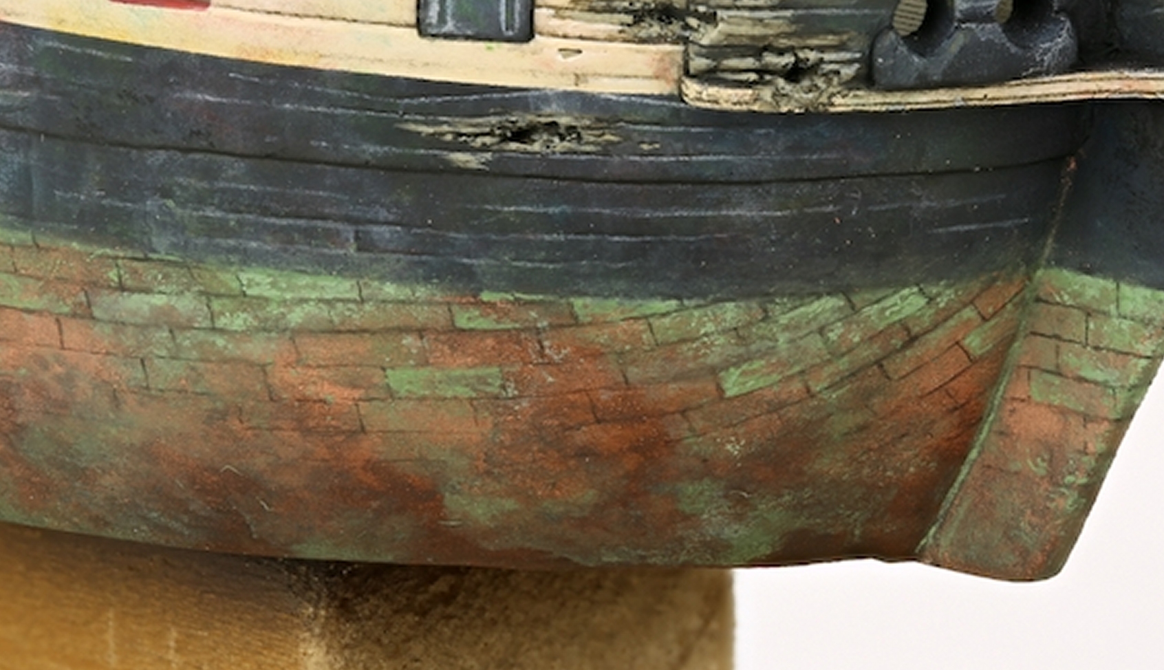

The one thing still left on the outside of the hull, was the copper plating under the waterline.
This is a nice tale of things not always going as planned�
I chose to avoid airbrushing metallic paint, instead starting from a mid-dark brown. In hindsight, this was a mistake!
I mottled a couple of green shades over this, by applying thinned green paint (Humbrol) on a wetted surface (mineral spirits), and �blending� it around with a wetted clean brush.
Next, I added some more of the same paint, but this time I stippled it on with small pieces of sponge:
Now, I only had to add some copper into this.
But I couldn�t make it look like the copper was the base material, with dirt and corrosion on top. Instead, it looked just like what it was: copper paint on top of green and brown, rather than the other way around.
I wish I had photographed it, but believe me it looked terrible! :Mad_6: :Mad_5:
marijn van gils
Posts: 2707
Re: HMS Victory and Le Redoutable at Trafalgar (1/300)
Post by marijn van gils »
So back to start, and this time properly.
I hand painted a solid coat of copper. I used Lefranc & Bourgeois copper �guilding liquid� from the art supply store. It has a fine pigment, brush paints well, and is pretty resistant to subsequent weathering.
Rather than risking painting the copper too high up, or masking and pulling paint of the model, I just left a thin green border. That will blend into the corrosion effect later on.
With a couple of (dark) brown shades, I added a first dirt/corrosion layer. Again thinning the paint quite a lot, and �mottling� the paint around with a moistened clean brush.
After drying, I repeated this with a couple of green shades, but applying most near the waterline.
Next, I added some more greens with the sponge technique:
Now, I painted the demarcation of the copper plates with almost black (black with a little dark brown) paint.
I �faded� the effect (well, just gradually painted less of it :big_grin: ) towards the bottom. This will be under semi-transparent resin, and the deeper in it the less the hull will be visible.
I painted the top rows bolder than the planking above the waterline, to clearly distinguish both.
Finally, I took a couple of green colours again, and hand-painted (parts of) individual plates with a fine brush. The goal was to �separate� individual plates here and there.
And that was it!
Except for the copper, I used Humbrol paints exclusively. Normally, I would have preferred oils for painting the lines, and maybe for the green corrosion (because oils remain workable/correctable longer). But since most of this surface may be in contact with epoxy resin later on, I chose a more resistant paint.
Of course, I had to (more or less) follow the pattern of the plating on the real thing.
Especially at the bows:
� and at the stern:
And that concluded the painting of the outside of Victory�s hull! :smallsmile: :smallsmile: :smallsmile:
