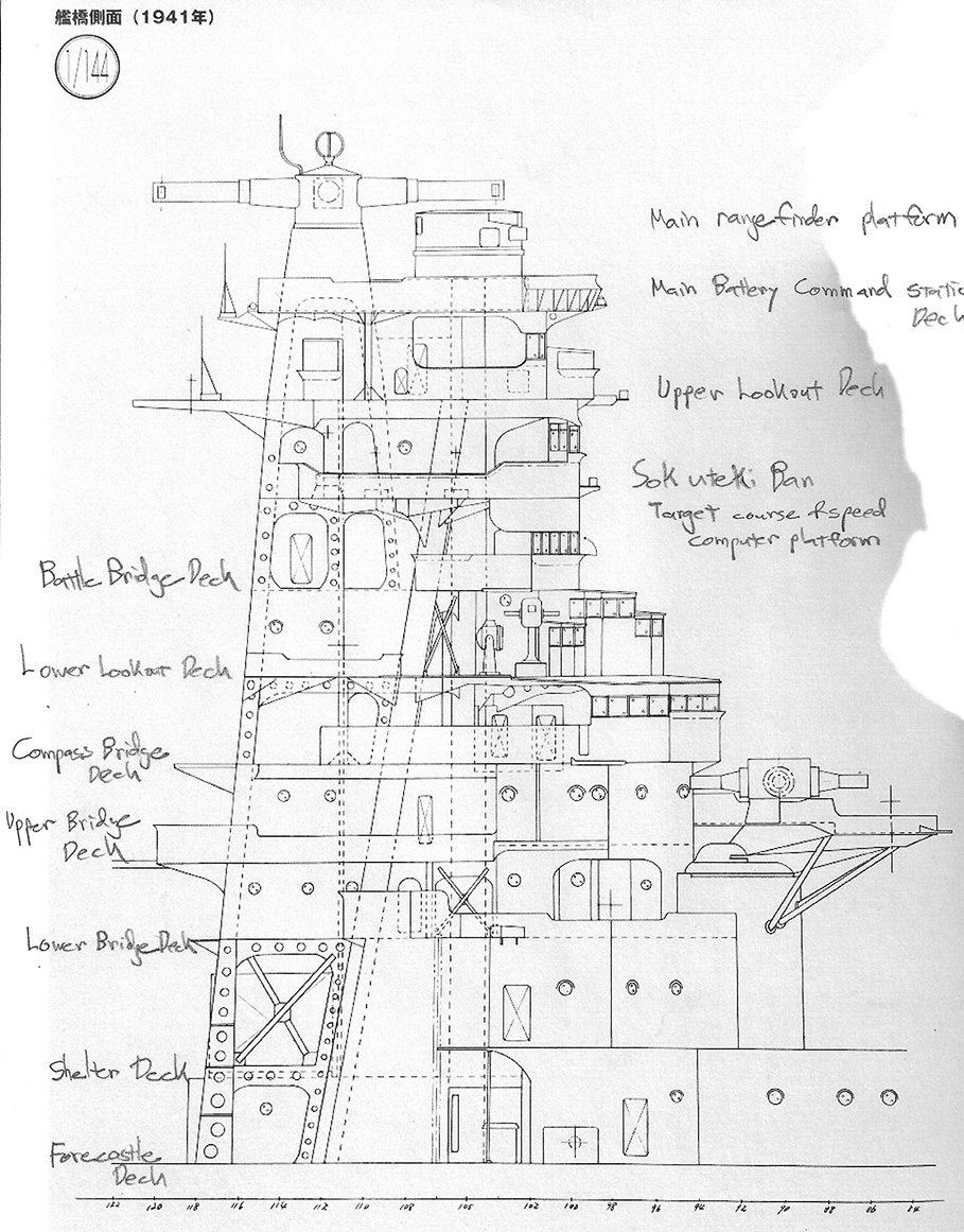

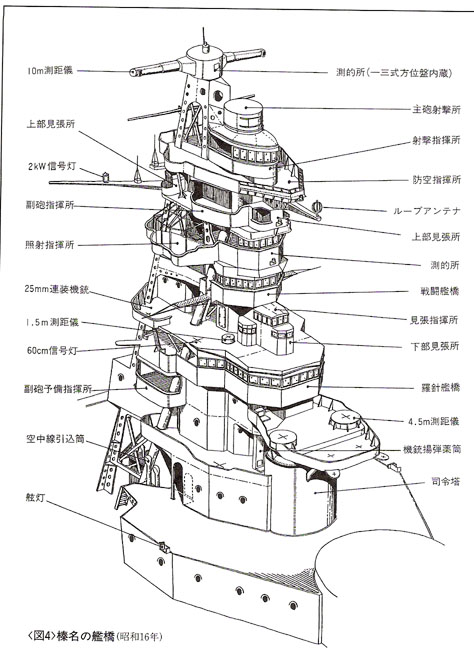

Apologies if this has been answered before, I looked through the thread but there's a lot of it so might have missed it.
I'm interested in what was on each level of a Kongo class pagoda bridge tower (not Hiei as she was different). Dan posted a great annotated drawing earlier in the thread but ufortunately I cannot read the Japanese on it. I'm attaching it again for reference.
Would someone be kind enough to translate or otherwise just write up in basic terms what the main function on each level was?
I understand the image below is Haruna and at this time she has an extra level at the top compared to her sisters, but I assume the rest is the same for Kongo and Kirishima.
- Posts: 9049
Re: Calling All IJN Kongo-Class Fans
Give me a day or 2 to rough something up.
- Posts: 9049
Ok, the home scanner wasn't working, so I had to improvise.
Levels from top to bottom for Kirishima 1941:
Main Rangefinder Platform
Main Battery Command Station Deck
Upper Lookout Deck
Sokuteki Ban (Target course and speed computer platform)
Battle Bridge Deck
Lower Lookout Deck
Compass (Navigation) Bridge deck
Upper Bridge Deck
Lower Bridge Deck
Shelter Deck
Forecastle Deck
This layout applies to all the Kongos (Haruna had one extra platform on top until 1944) and the other Japanese BBs. Other classes may have an additional platform or so.

- Posts: 8532
So the ship would be conned from the compass bridge and "fought" from the battle bridge?
- Posts: 9049
So it would seem. Can't swear to it.

- Posts: 1559
- Location: England
Thank you Dan, your work is very much appreciated! The list was what I was after, the drawing is going above and beyond.
One small query, the uppermost platform gets extended and sticks out forward on Kongo and Haruna. Am I right in thinking this extension is an air defence lookout and command position?
I have been able to cross-reference this with information I have for Fuso. That gave me the final pieces of the puzzle, and I have been able to visually match up or logically deduce the levels on the Ise and Nagato classes too.

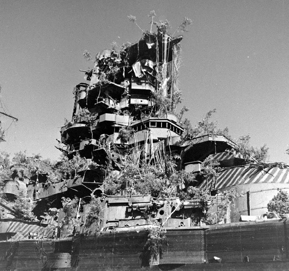

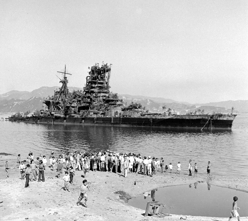

Logic dictates it was green because all of their camouflages were green by end of war as they sat in port. I think I read somewhere that Amagi even was planned to be kept after armistice, as Japanese believed in summer the ware will hopefully end with some agreement - not unconditional surrender, and they then would (bizzarely) get to keep some of their ships. Of course it didn't quite work out this way as Kure bombing was pretty much Pearl Harbour revenge style disaster for what was left of the navy. Everything was sunk.Mr. Church wrote:Some colour footage of Haruna's wreck filmed after the war:Guest wrote:Hello! Does anyone have a good reference for the Haruna's final paint scheme. Ive seen a few photos with the striping on the turrets and on shipbucket seems the entire hull was painted a IJN gray-green color. Any help is appreciated.
https://www.youtube.com/watch?v=O6RAfIwsnR8
It's difficult nigh impossible to judge exact colours from old films like that but it gives you some idea at least.
So now I convinced you she should be green (and myself).
Having said that, I see Japanese modellers - who I think are worth paying attention to - paint here grey. (at least some of them). I would focus on tracking down models built by japanese modellers for ideas. They have better access to primary sources.
Haruna was wrecked very much on starboard side, just not seen in these pics.
So - in summary - I would be 60-40 to paint her grey. They put a bunch of tree branches on her, why do that if she was already green? The painted turrets in bizarre pattern then.
- Posts: 9049
That's always been my suspicion.They put a bunch of tree branches on her, why do that if she was already green?
