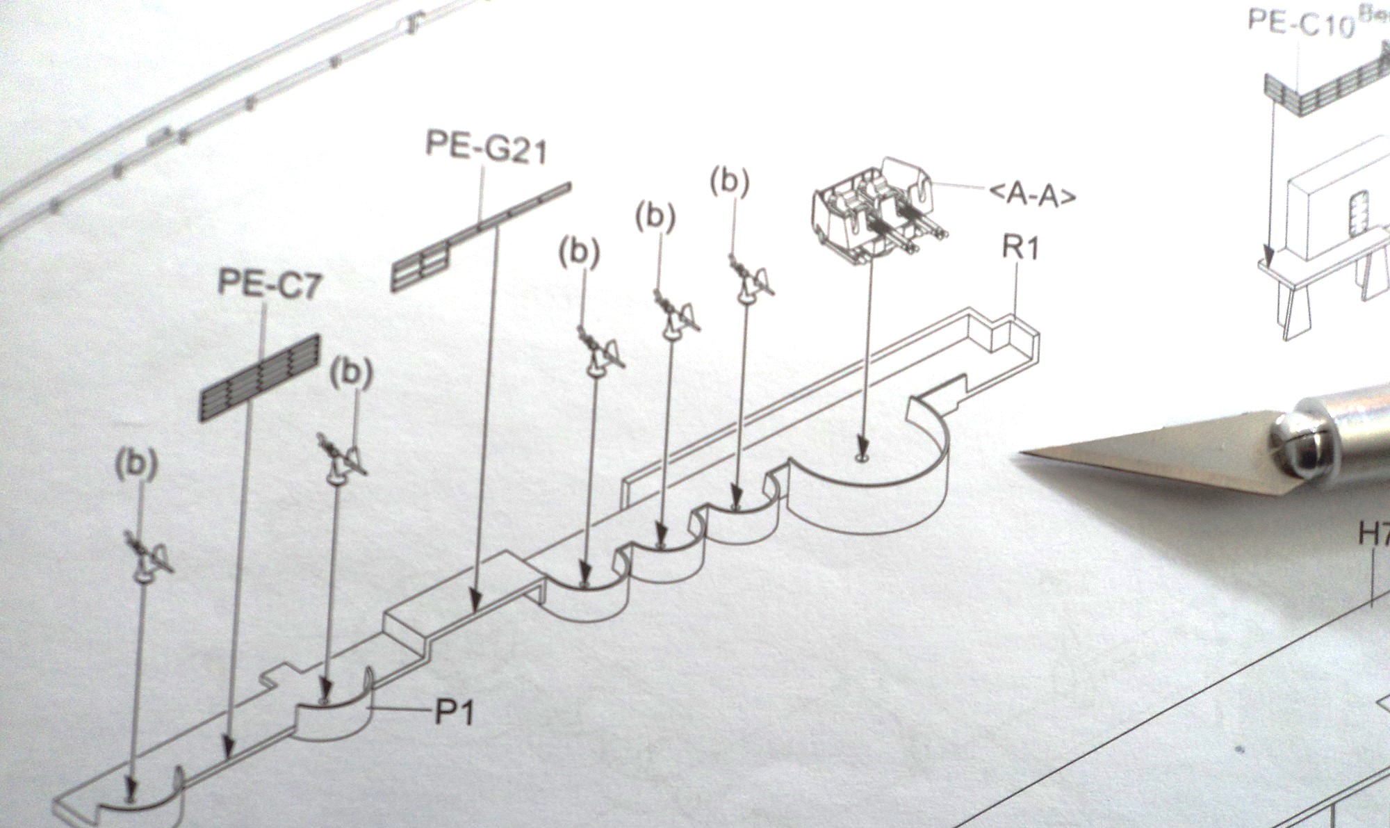

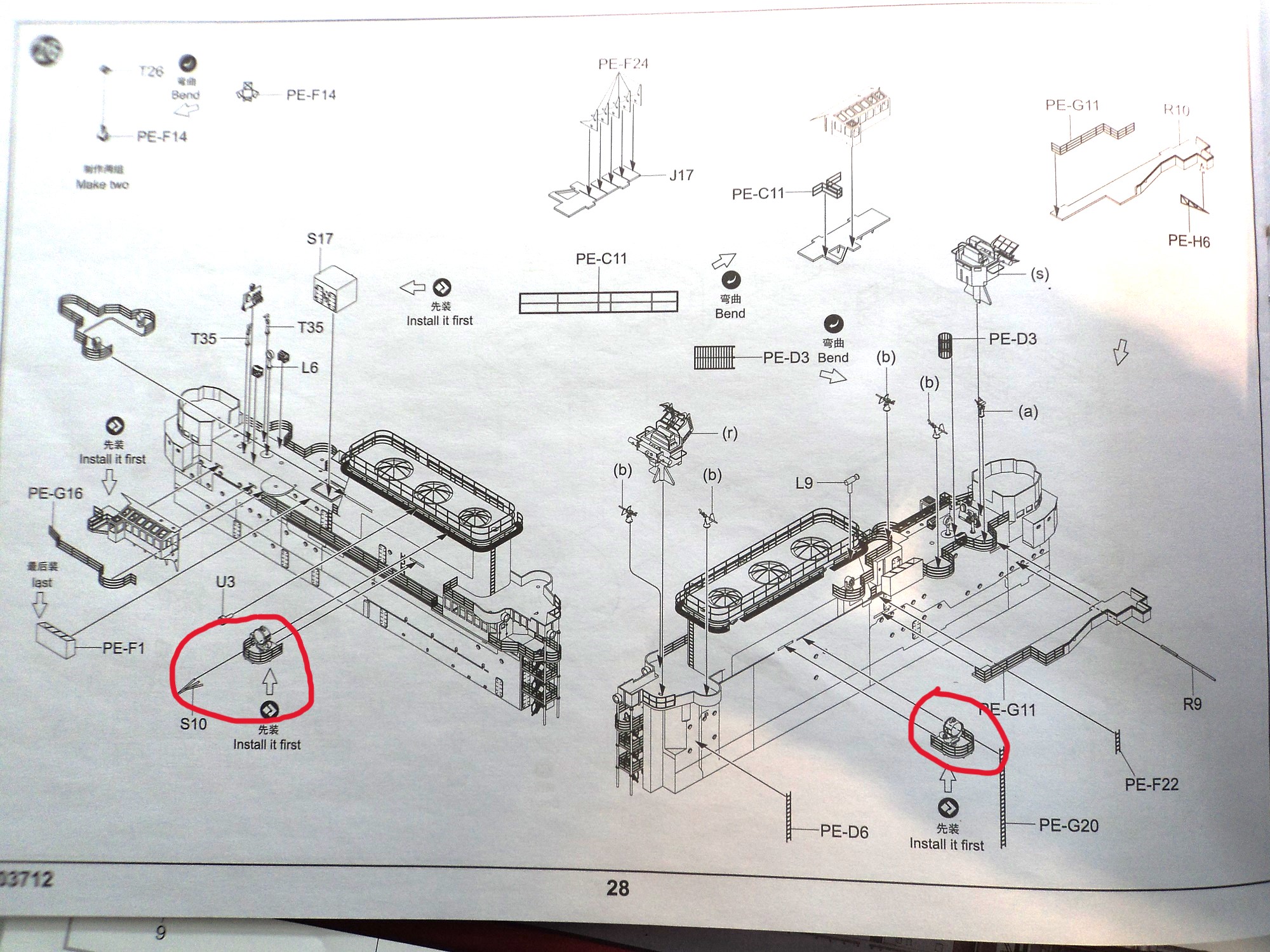

I'm getting started on the I Love Kit Enterprise and have already run into an issue. I thought it would make sense to add the degausing cables before I painted the hull, so I got out the parts and the instructions and... it doesn't work. I'm starting from the port bow and the instructions call for using PE part E-23. But if I position that piece to go under and around the forward sponsons, which it looks like it has to do, it doesn't get anywhere near the bow, and doesn't have a upwards angle to the forward part to go over the hawse pipes. And I don't see any extra part that would fill in. Could anyone (Martin) who has built the kit help me out here?
Thank you!
Michael
Thank you!
Michael
- Posts: 8561
Re: Calling all USS Enterprise CV-6 fans
Michael,Blue Devil wrote:I'm getting started on the I Love Kit Enterprise and have already run into an issue. I thought it would make sense to add the degausing cables before I painted the hull, so I got out the parts and the instructions and... it doesn't work. I'm starting from the port bow and the instructions call for using PE part E-23. But if I position that piece to go under and around the forward sponsons, which it looks like it has to do, it doesn't get anywhere near the bow, and doesn't have a upwards angle to the forward part to go over the hawse pipes. And I don't see any extra part that would fill in. Could anyone (Martin) who has built the kit help me out here?
Thank you!
Michael
The kit supplied PE, in general, is not that good, and the degaussing cables, in particular, sucked. I made my own from plastic rod, using lots or photos to guide me. David Doyle's Enterprise book was very helpful. I used .20 rod, IIRC (but it's been a few years). If I had to do it again (and I do have another in the stash), I might go with a thinner rod instead. HTH!

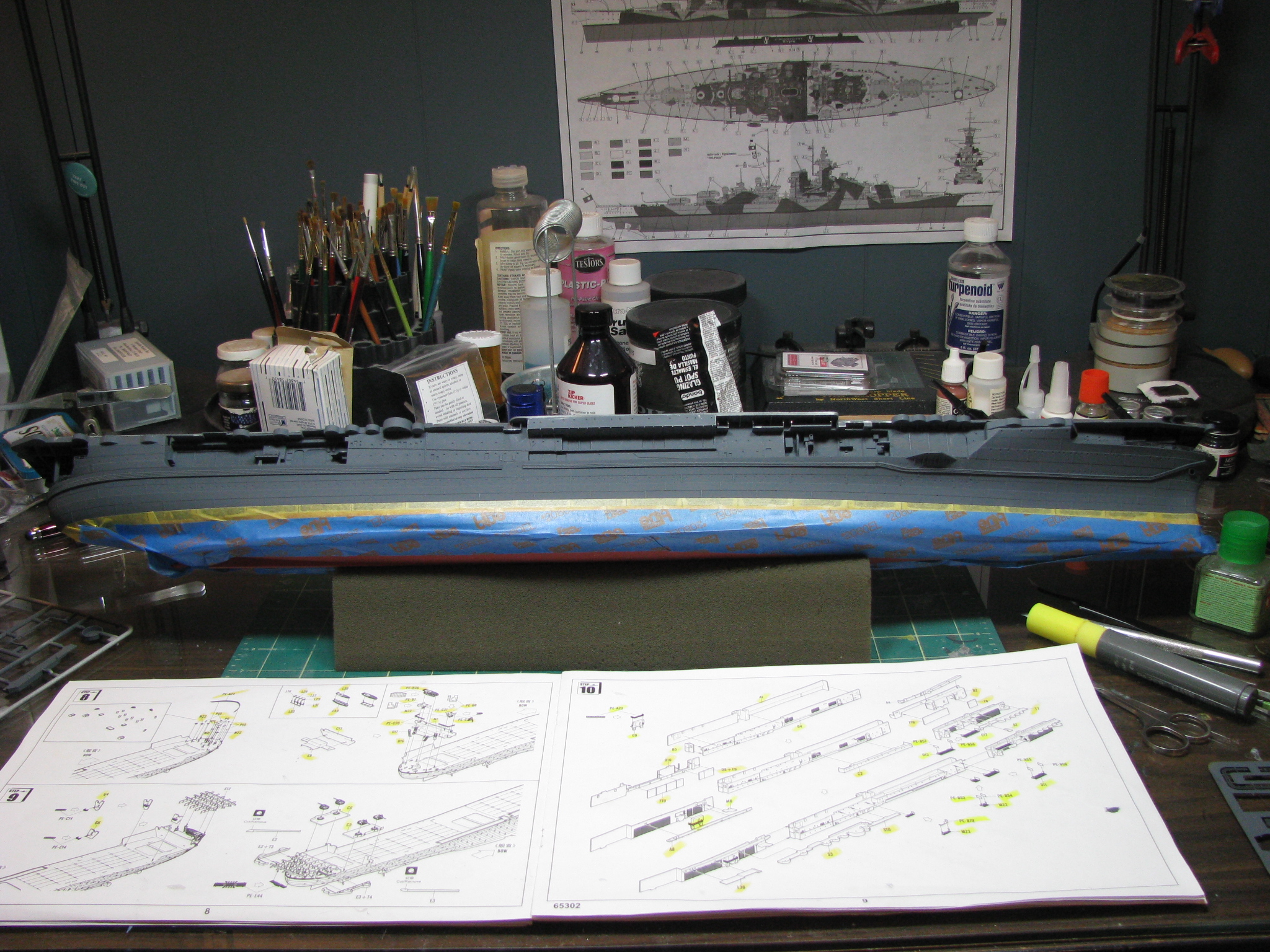

Thanks Michael: I did some more studying on the 1/200 Enterprise comparing photo's to the kit and marking the instructions accordingly. The Trumpeter kit also provides the four 1.1" guns and provides the three tubs for the quad forty's. The tubs are the wrong shape for the the 1.1's so new tubs will have to be have to scratchbuilt, not too difficult I wouldn't imagine. The forward bandstand is wrong for a Midway Enterprise too, as it had two 20's so that has to be changed, again, no biggie. I do have the 1/350 Yorktown and Hornet kits, so thanks for the offer, but won't be needed. I have the Doyle book coming as well as the updated "The Big E" with photo's by Edward Stafford. I read the Stafford book several years ago; it was a great read, could hardly put it down, so looking forward to to getting into it again, this time with Pictures, so even a Marine can follow it this time.Blue Devil wrote:Good luck, Mark! I'm having enough fun trying to do the same thing to the 1/350 kit. I do know that the smaller kit still has the parts for the 1.1 mounts and tubs from the Yorktown, but don't know if the 1/200 version has the same. I have screen shots of the 350 Yorktown instructions if that would help you at all. And Dick J mentioned a while back that the Big E actually had 2 20mm single mounts on the fantail, which I did find a picture of in the Doyle book. Odd place to put them, pretty limited field of fire, but I'm sure it was temporary.

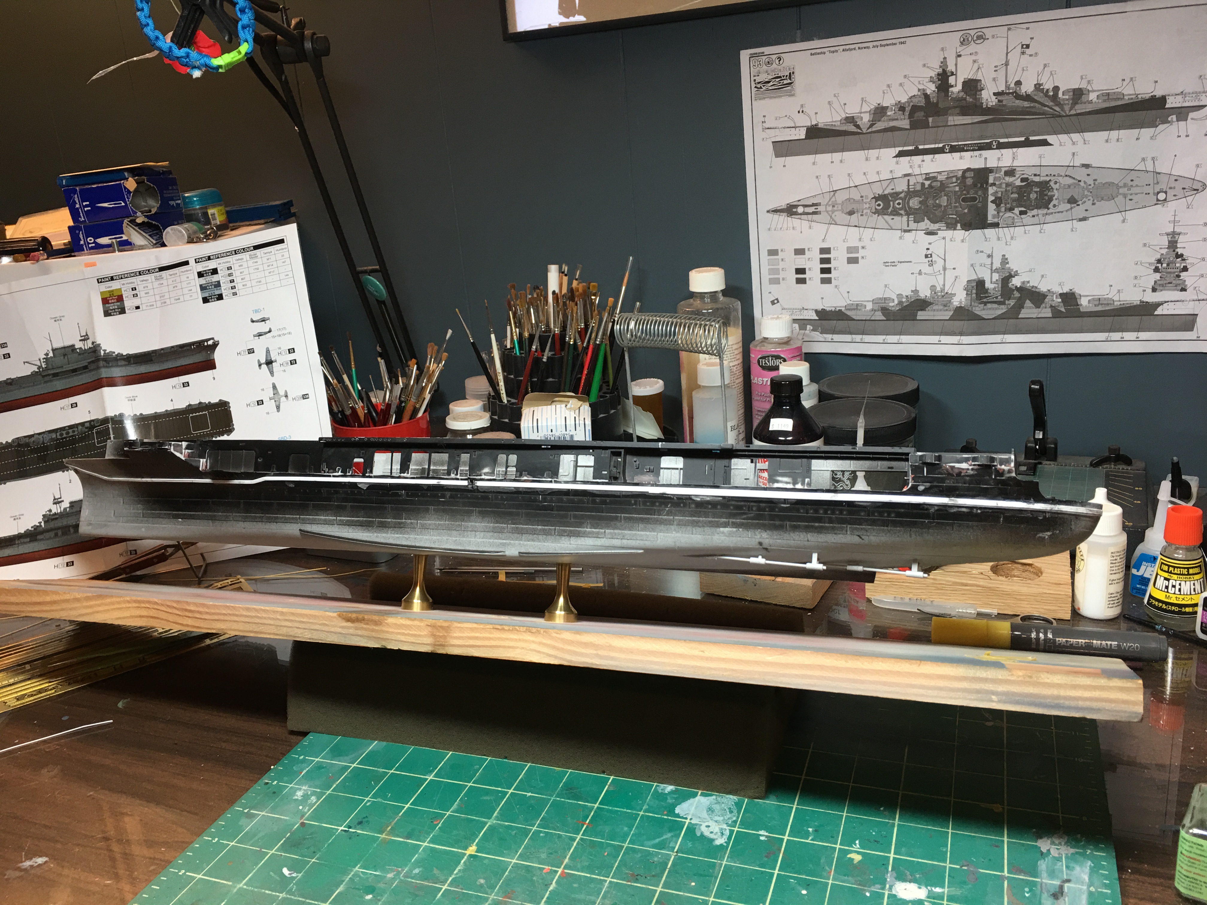

About portholes here is a photo of my WIP CV-6, do I need to cover the portholes under the degaussing cables, or they were presents during Santa Cruz ?
