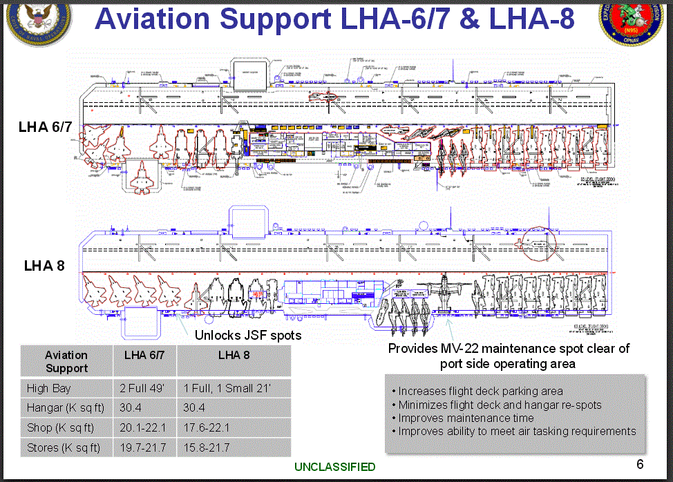

We have data on the proposed LHA-8, or next baseline of the LHA-6 class:

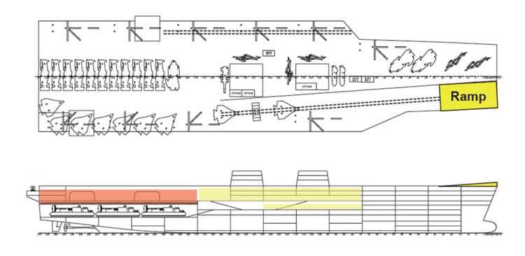

Having a reasonable reference for the internals, and having haunted USS Essex (LHD-2) yesterday, I am working a series of ideas, some more involved than others.
- Two concepts could be built from this baseline - a helo/VTOL carrier (for which I will use the designation of CHM) and a CATOBAR carrier (for which I will use the designation of CVM)
Using LHA-8 as the baseline to modify
CHM-A: "Cadillac" - the "everything the way you'd like it but it is probably too expensive" version:
- LHD Plug Plus lengthening (+77' in length forward of the island), new LOA should be approximately 921'.
- Carry hangar forward to where the forward frame of medical will be on LHA-8, medical is pushed forward into the former troop berthing, troop berthing is reduced and becomes additional berthing for the airwing.
- Add elevator forward of the island on the starboard side - this would be where the new deck overhang is added on LHA-8. There are existing lifts in this area (direct access to the cargo ammo mags, which become aircraft weapon mags), which would move forward. As an alternative, the current ammo lifts could stay and the aircraft lift moves forward of them. (note that the 56' plug of the plug plus is the forward bulkhead of those magazines, which would make moving the lifts possible while expanding the magazines into the new 56' section)
- Elimination of vehicle stowage (and the associated ramps for moving vehicles between decks) and well deck allows shops an storerooms to be more logically laid out to support aviation, increases shop space and increases available stores space - this should increase the readiness of deployed aviation assets.
- Engineering plant change to a modified DDG-1000 plant. This changes a 70000shp plant for a 105000shp plant with higher levels of automation (reduced manning), and could push speed to 26-28 kts in addition to the increased waterline. Also increases electrical generation capability.
- Unless a phased array radar fit can be shown to be less expensive by eliminating multiple radars and reducing maintenance and personnel, stick with the LHA-6 sensor suite.
- Would like to see the additional 8' of flight deck beam carried for most of the length of the starboard side, at least from stern to the rear edge of the forward elevator. Will offset balance with 8' of width added to port, if needed (These most likely eliminate the ability to transit the Panama Canal, however the Canal locks are being widened, so that will have to be checked)
- LHA-6 has a ship crew compliment of 1059. Increasing automation in engineering, eliminating the extra personnel needed for support to the amphibious functions which have been removed, I am hoping to see a ships company reduced to 750-800. (airwing would be additional)
This should easily ship and support 36-48 F-35B and 4-6 support helos.
LHA-6 construction cost is $3.4 Billion, no data on development cost. If we can build this CHM for $4.2-5.1 Billion (25-50% over LHA-6), it certainly compares favorably with continuing CVN-only construction (USS Ford cost is estimated as $12.8 Billion for construction and $4.7 Billion for development).
This CHM will not have all the capabilities of a CVN. There is no tanker here, no AEW yet (hopefully a UAV for that). The reach of this CHM would be a 900nm radius (F-35B radius of 450nm in each direction) without off-board tanker support. But much of that additional support could be networked assets from land bases - P-8 for maritime patrol, AWACS for USAF or allies, tankers from USAF or allies (I almost hate to point out this is the concept used to legitimize little to no tanking, and the elimination of Sea Control squadrons, from CVNs).
Operation cost should compare very favorably with an all-CVN fleet - 800 ships crew instead of 3200 ships crew on a Nimitz (which it may nominally replace in a budget strapped environment).
You almost reach a three-to-one ratio in construction and personnel costs, thus either getting three decks which could be in three places and carry a total of 108-144 F-35B instead of one and 60-72. Granted, the CVN has AEW and more range with it's F-35Cs.
I like the basic idea here, as it allows for a 'medium' aviation ship for numbers, letting the CVN and CVN airwing return to the more diverse roles and more capable aircraft they once carried (dedicated tanker, sea control, first-line fighter and attack aircraft) instead of settling for less capable multi-role aircraft just to keep numbers up.
CVM-A "Cadillac": as above, plus:
- Reverse aft lift arrangement - starboard side aft aircraft lift moves to just aft of the island, portside lift moves aft to facilitate an angled landing deck.
- width of the flight deck increased by sponsoning to approximately the outer edge of the elevators on either side. Forward of lift #1 (starboard side forward of the island) the deck would narrow again.
- New island of even smaller footprint moved outboard, carrying SPY-1 for most all functions in order to reduce the footprint needed, other required functions moved below the flight deck.
- three wire arrested recovery system on an angled landing deck
- Two EMALS-type catapults forward
How much would this cost? not really sure. Could this be had for $6.4 Billion or less (half the construction price of a Ford)? If so, and it can reasonably operate a 36-48 aircraft wing (most likely 36 F-35C/SuperHornets, 4 E-2 and 4 EA-18G) this may be a good deal.
Other less modified versions to follow (CHM-B, CHM-C, etc)

Another view of the proposed LHA-8:

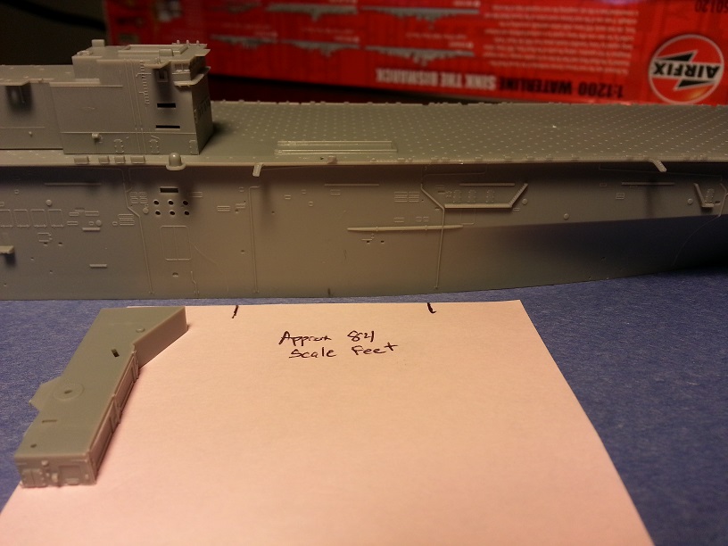

So I have received one of the two kits I will need to feebly attempt this.
I am using the Hobby Boss LHDs. Excellent kits. Happy with what I have seen so far.
To capture what I intend to do:
This shows the standard island as the LHDs are and as the kit intends: The way the kit is constructed, the "Front Porch" and the after section of the island are already separate, facilitating the 'Reduced Island' proposed for LHA-8: The larger effort will be extracting an elevator side and adding it forward, thus representing both the increased length of the "Plug Plus" and adding the proposed elevator forward, all at once.
The section to be removed: You will notice that that is marked out as approximately 84 scale feet. the Plug Plus was to be 56'+21' for a total of 77'. I need to extract slightly more than that to get the proper hull shape for the elevator support, so I will be 7' longer than proposed. Oh well, not going to sweat that in 1:700.
Where it will be added: The aftermost reference point is where the added section will begin, and carry forward.
Flight deck will also be extracted, in excess of the elevator section, to cover the area forward as well as replace the area which came pre-formed to accept the 'Front Porch'.
It should not be difficult to join to sections of the hangar deck to have the extended hangar visible when completed.

That section is flat - the hull curve actually starts where you see a light pencil mark on the model - so as complex as this will be to get right, I don't have to deal with hull curve or knuckle.
It isn't where the lengthening was supposed to go under 'Plug Plus', but probably the place where I can add the length and get the best modeling result.
Side note: "Plug Plus" included adding 10' to beam in at least one of its iterations - I don't intend to add any beam to the hull. Just way too much work along the entire length of the vessel, so I guess it is just "Plug" not "Plug Plus". I may add flight deck width, that remains to be seen.

Re: CVM?
Right now, I am concentrating on the VSTOL carrier.
The cat/trap version would be a lot of different work, moving the port elevator aft and sponsons with a much expanded deck.
We have a great separate CVV concept working in the other thread.

Re: CVM?
You are - the kits have separate lower hulls. My intention is to build waterline, though.MAJOR-B wrote:Love the idea.. quick question would this work for a full hull version as well.
I think if the answer is yes then you have to make two cuts in the donor kit one for the plug and one for the correct section of the lower hull... am I tracking?
Thanks
Major-B
Second kit on the way, so we will see if I can pull of this cut and graft in a reasonable way soon.
With the reduction in island foot print, and the addition in length, this is going to make a very long looking vessel, even though her length to beam ratio will be less than 1:10 (I am estimating final length of 915' in scale - 831' of the Wasp class + my 84' section)
