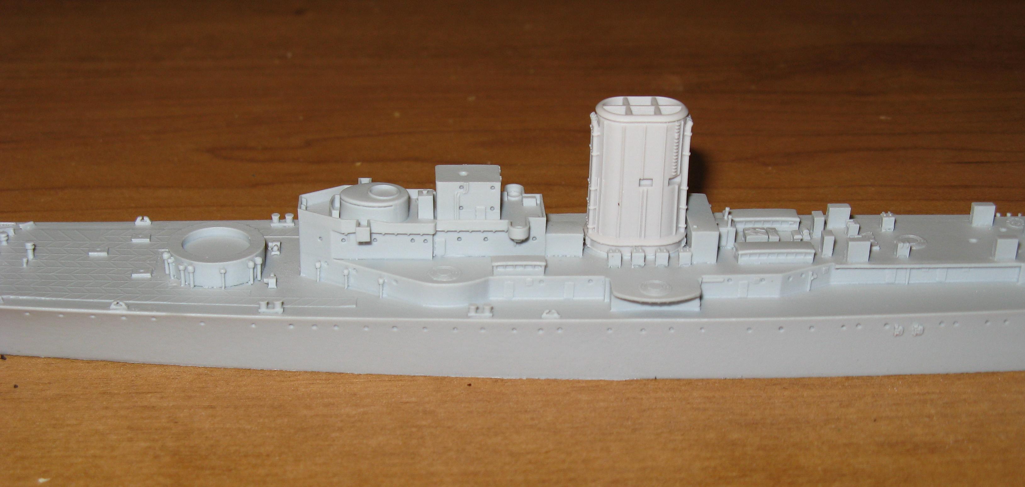

While trying my new camera I took those two pictures of the new HMS Courageous model. It's not much of a preview but it shows a lot of the details on the hull and funnel. I'll take some more pictures soon. Enjoy!

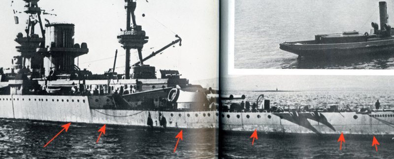

B) The box top art and the elevations show a vertical strake on the hull port and starboard, lined up with the rear of the tower. This strake looks like it ends in a small deck box. Query: there is no part for this strake, and no mention of it in the plans themselves. So, what is it? Maybe I should just fabricate a pair our of sheet styrene?

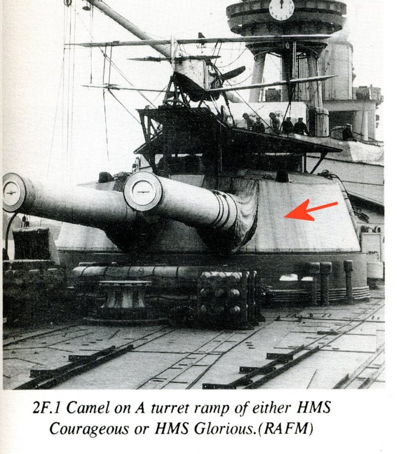

Doe anyone know what these are--or what hey do--or have better pics...?
see below
