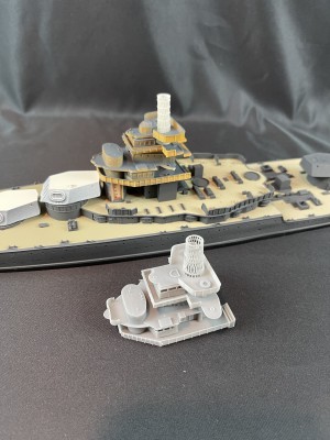

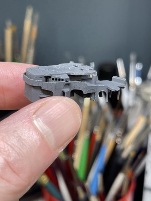

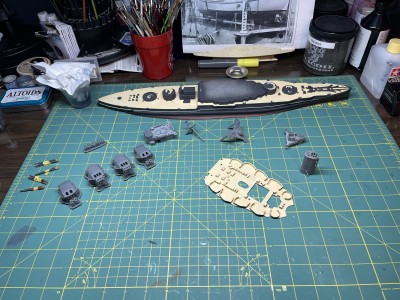

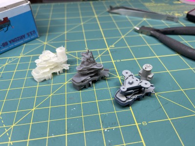

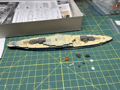

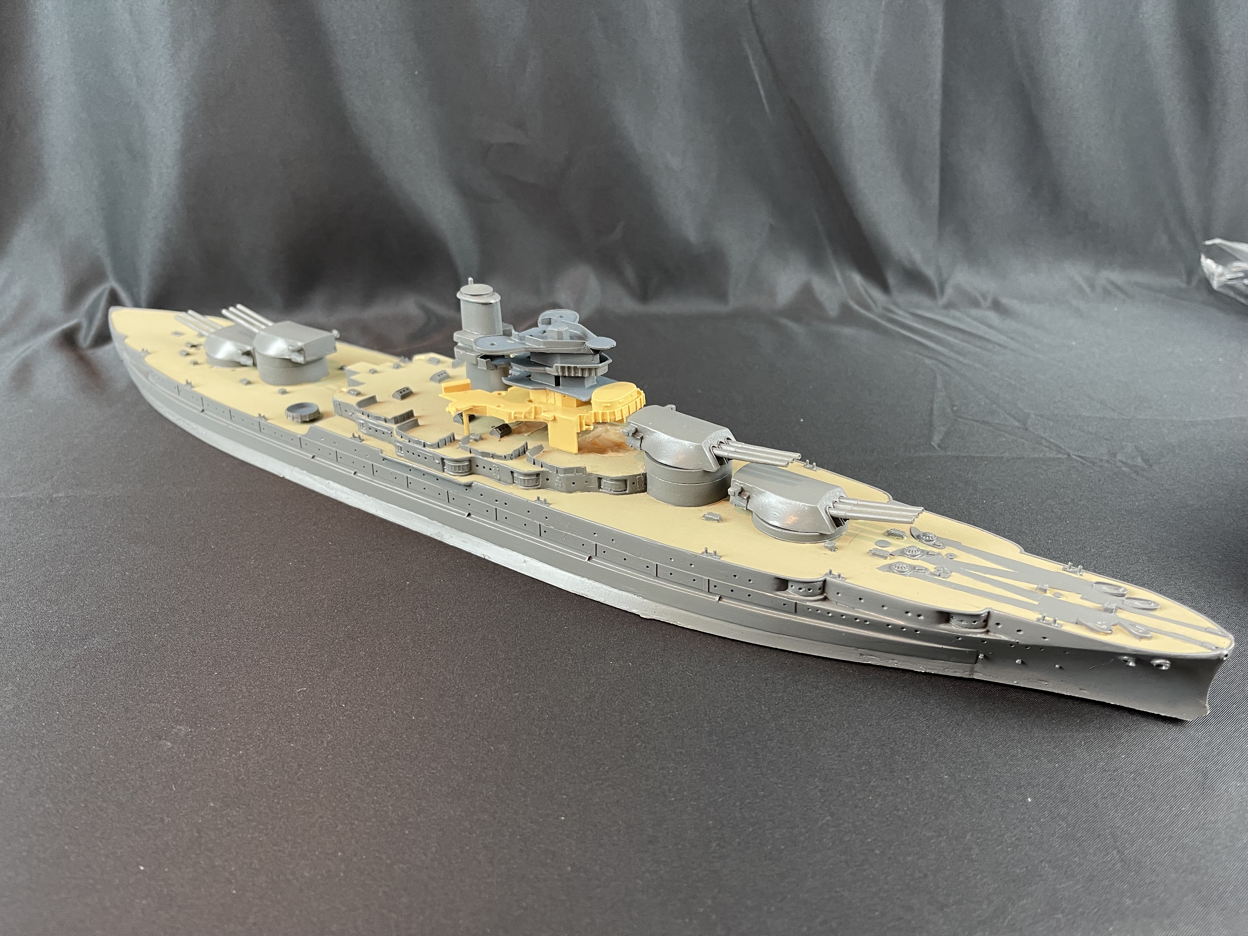

For the Dragon Arizona, I'm using the following, along with the base kit:
ModelMonkey superstructure (new version)
ModelMonkey turrets with barrels
ModelMonkey funnel
ModelMonkey spotting tops
ModelMonkey Mk19 gun directors
ModelMonkey (via Shapeways) 3in gun tubs and 1.1 inch director platforms
3D Modelparts "birdbath" gun tub
3D Modelparts splinter shields
3D Modelparts 5"/51cal guns
3D Modelparts 5"/25 cal guns
I'm also using PE and a wood deck.

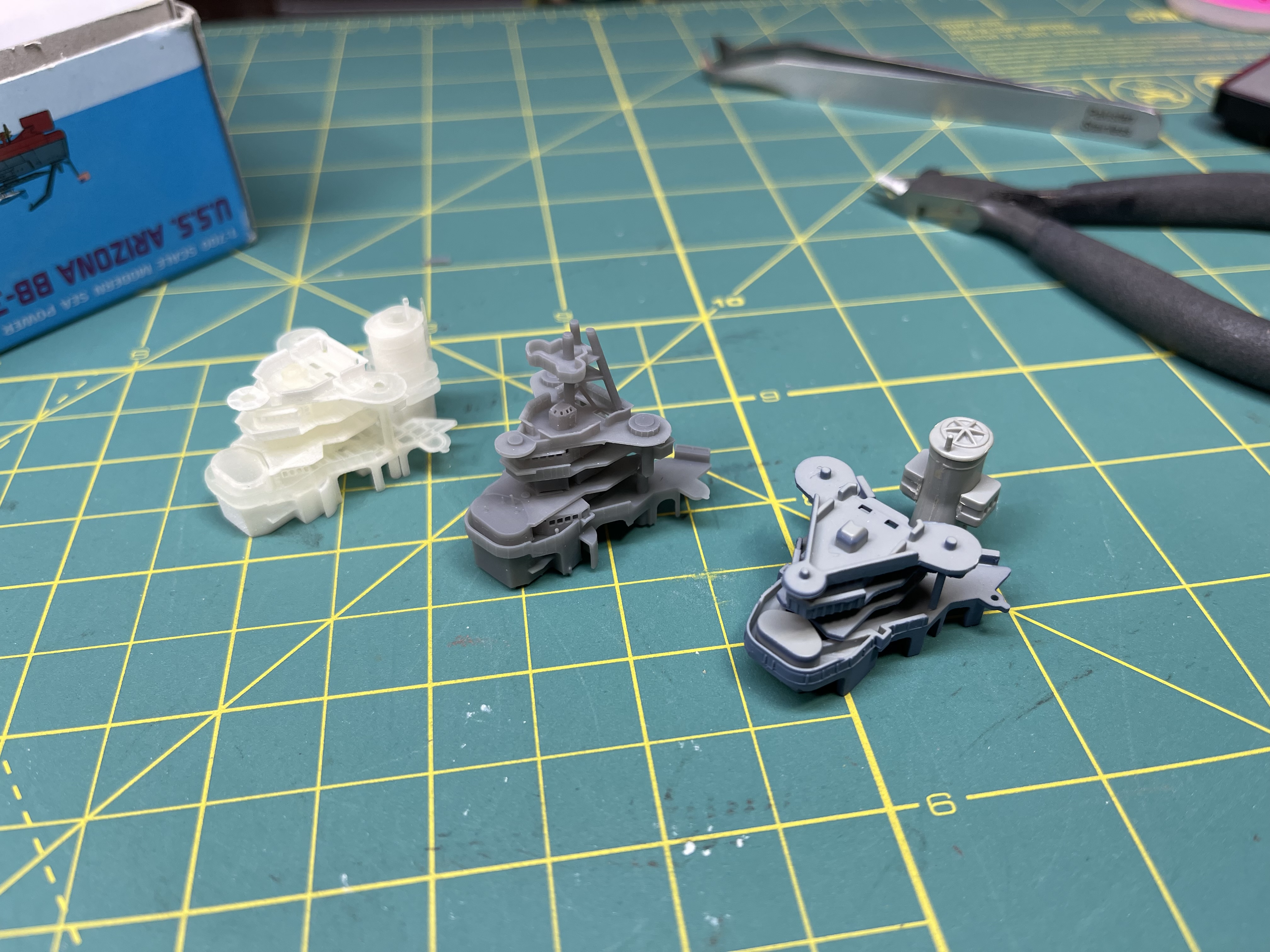

As mentioned, I had started the kit eons ago, after seeing the one Tony Bunch built. I got started, lost interest, and put it aside. Then 3D printing came along, so I bought ModelMonkey's superstructure and funnel via Shapeways, said "ooooh - pretty!", and put it all back in the box. I took it out from time to time, did a little work trying to fix the casement guns, but eventually was dismayed by the "frosting" on the Shapeways printed superstructure and funnel parts (this seems to happen to many Shapeways printed items) and put it back in the box yet again.
When I discovered that ModelMonkey recently released an upgrade version of his Arizona superstructure, printed on his in-house printers (which are far superior to anything Shapeways has ever done), my interest was sparked again. Here's a comparison to the various parts: Once I got the new AZ superstructure, I removed everything from the print rafts, cleaned up the support attachment points (the tedious part of 3D printed parts), cleaned the parts and painted them with Colourcoats 5D. I did have to remove all the printed on outlines for the deck houses, as the tolerances were so tight I couldn't get the deckhouse above to fit over the outline printed on the deck below. I also ran into a little trouble getting the top of the conning tower to fit onto the deck below, as it doesn't lay flush over the structures on either side of the bridge. That's where I'm currently at. As mentioned, I've been paying more attention to the Oklahoma recently.

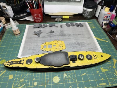

Re: WIP � US Standard Type Battleship(s)

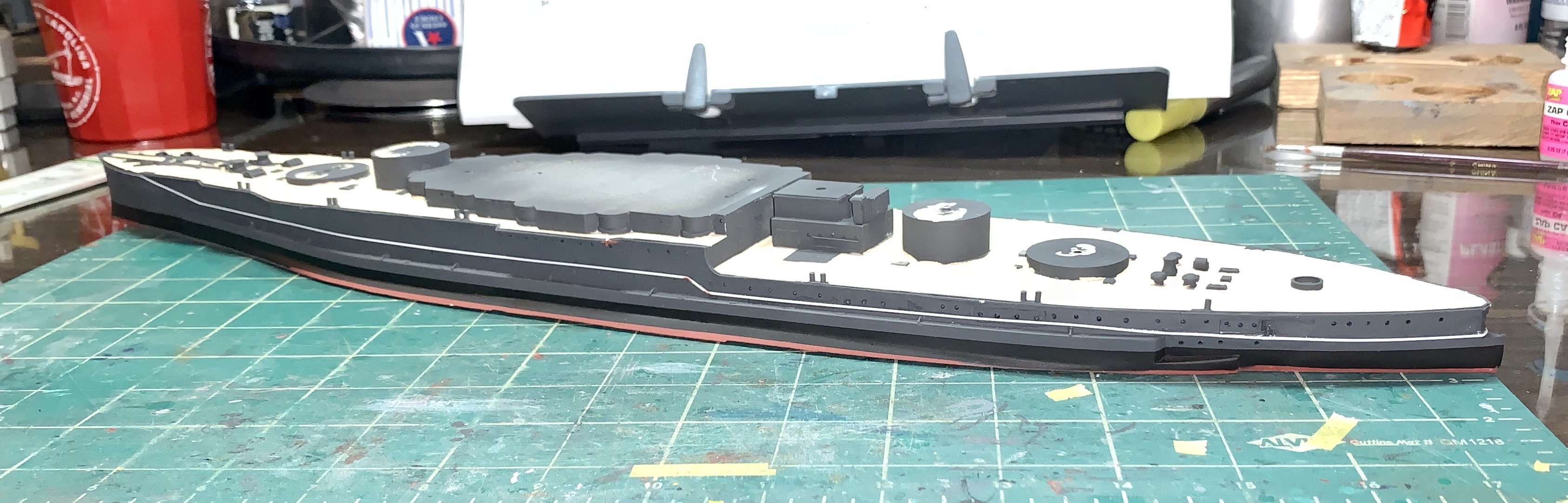

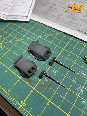

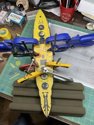

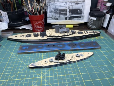

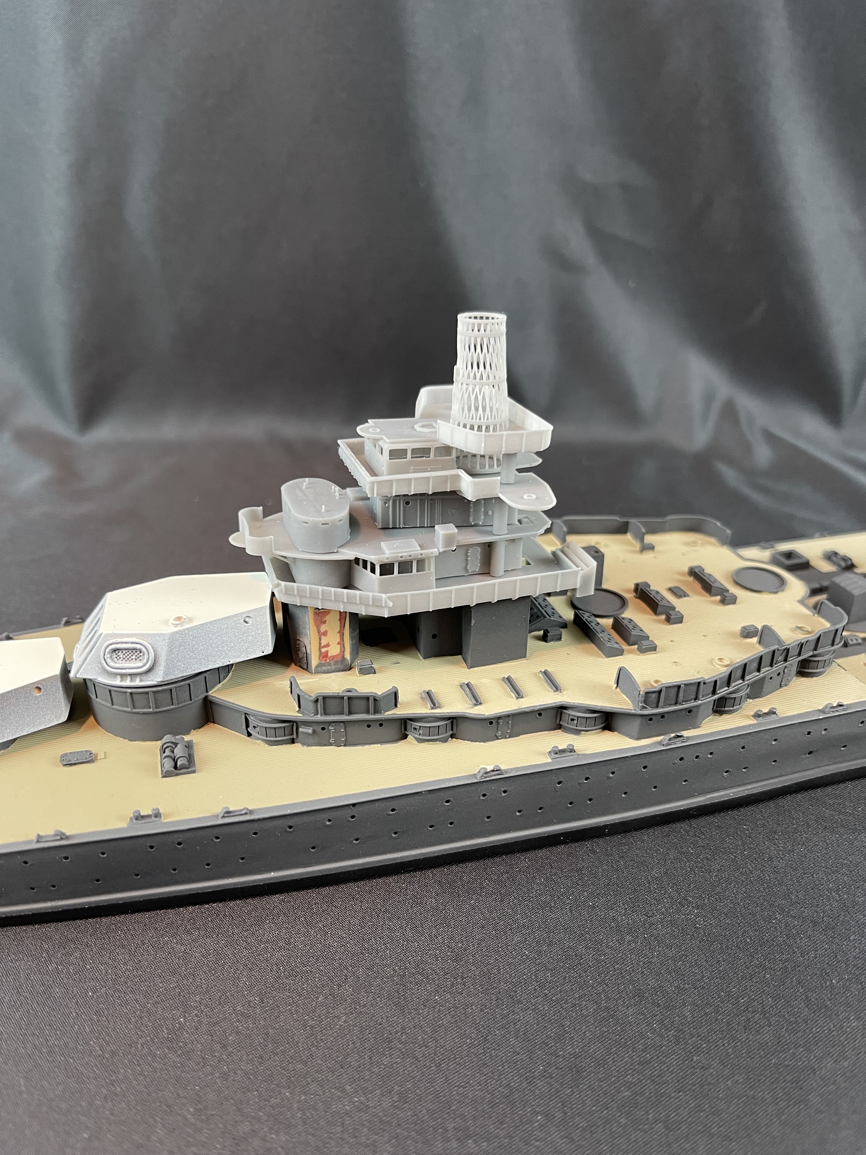

For the ISW Oklahoma, along with the base kit, I'm using the following items:
Kraken Hobbies superstructure
Kraken Hobbies funnel
Kraken Hobbies birdbath
ModelMonkey turrets with trunions
L'Arsenal 5"/25 cal guns
Brass barrels for the main and 5"/51cal guns

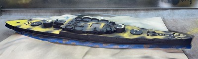

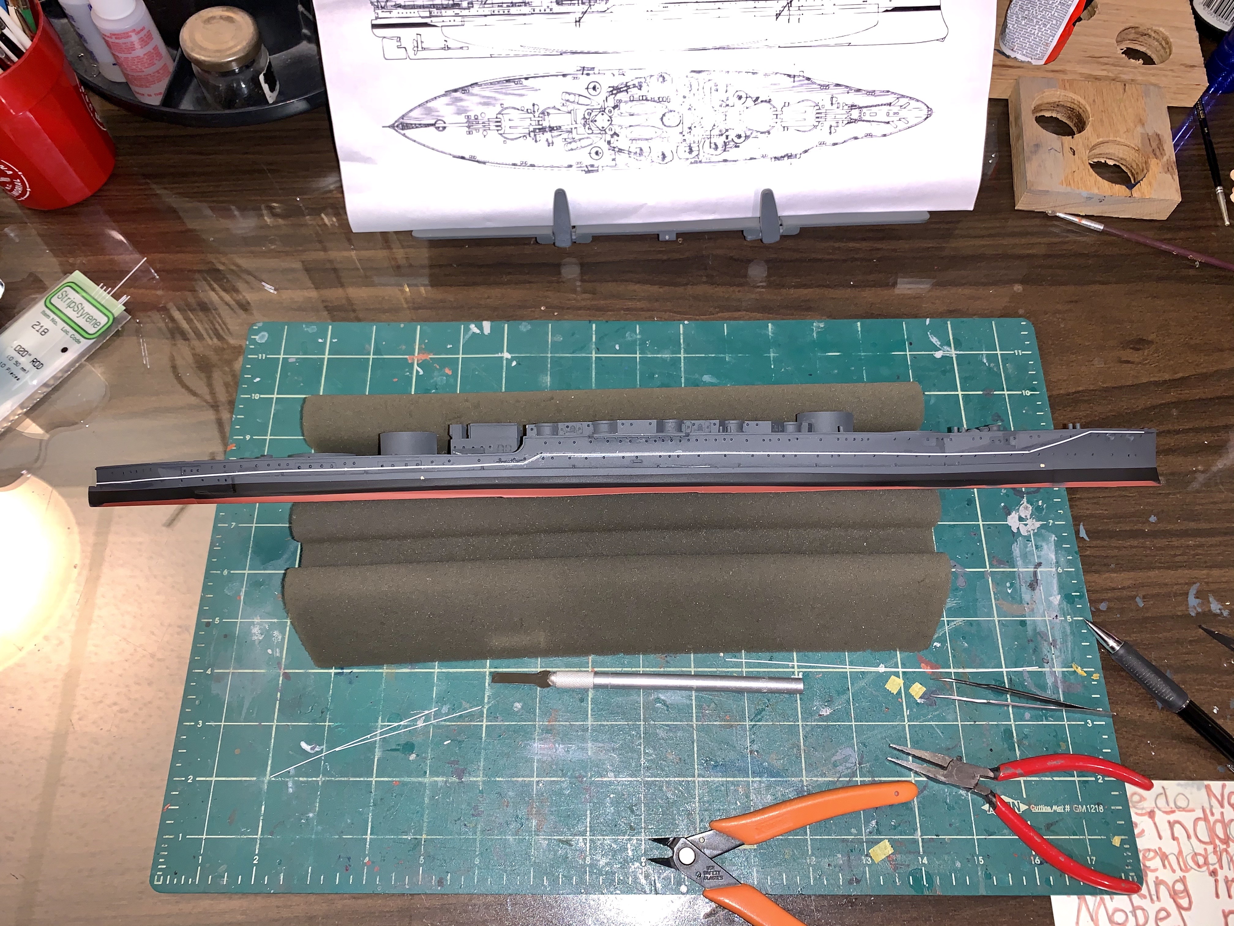

As mentioned, I had started Oklahoma some time ago, getting the model sort of done up to the 01 deck, including getting the resin turrets and brass barrels completed and partially painted with their turret top colors. Speaking to another modeler, he said I was missing the Oklahoma's degaussing cable. That, of course, derailed me for awhile, until I was motivated to add it. Of course, AFTER I added it, Jeff Sharp mentioned that she probably has hers moved internally before 12/7/41.
After going through the trouble of adding it, it's staying. Anyway once I had the Kraken Hobbies superstructure, funnel and birdbath in my hands, I knew it was only a matter of time before I returned to Oklahoma. That time is now.
I realized that in leaving the 01 deck off, I was going to have to do some repainting work, so I opted to re-mask the entire deck. First I masked the 01 deck, then the main deck. Once that was done, I glued the 01 deck to the hull using CA glue. I think I used enough clamps to secure it in place. The fit was pretty good and needed minimal filling. Once that was done, I then removed all the resin bollards cast onto the hull, as 1/3 of them were missing and some of the rest were a bit wonky. Once those were off, I added turned brass bollards I picked up from some outfit in China off eBay. A bit tedious, but worth it. They look much better. After removing all the 3D printed parts from their print rafts and cleaning up the attachment points, I set those parts and the hull aside, and started working on some of the resin parts that will need to be completed before painting can start, like platforms for the main mast and the boat cranes. Out of 5 cranes included with the kit, I was able to find 2 that were usable. I also noticed I accidentally bought an AZ 3D printed forward spotting top, so the correct one is now on order from ModelMonkey, and the incorrect one placed in the box with AZ.
That's it for now. I was hoping to accomplish more today, but (another) major plumbing leak at my house derailed me from time at the workbench. More to come, as time permits.

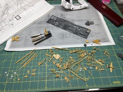

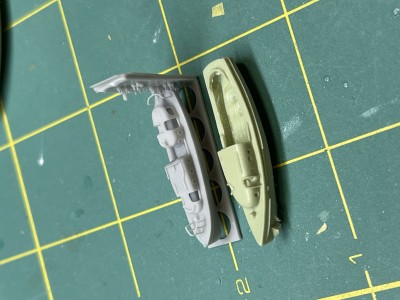

Thanks guys. Appreciate the comments. I've been sorting through the resin parts for Oklahoma, looking for those that are usable. Out of 5 boat cranes that came in the kit, I was able to salvage 2. Looks like one secondary battery gun director is missing as well.
The boats that come with the kit are a little rough. Here's one compared to a Black Cat 3D printed version. I'm hoping Ben from Black Cat adds more US boat to his product line, as I'll need some 40 and 50ft motor boats to flesh out Okie's boat complement. Plus, there's all those other battleships that will need boats (eventually).

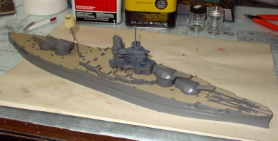

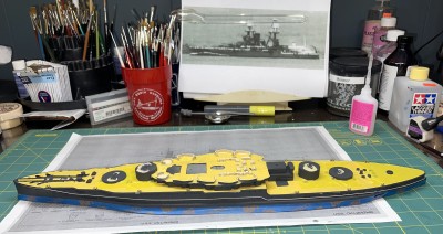

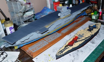

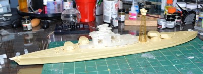

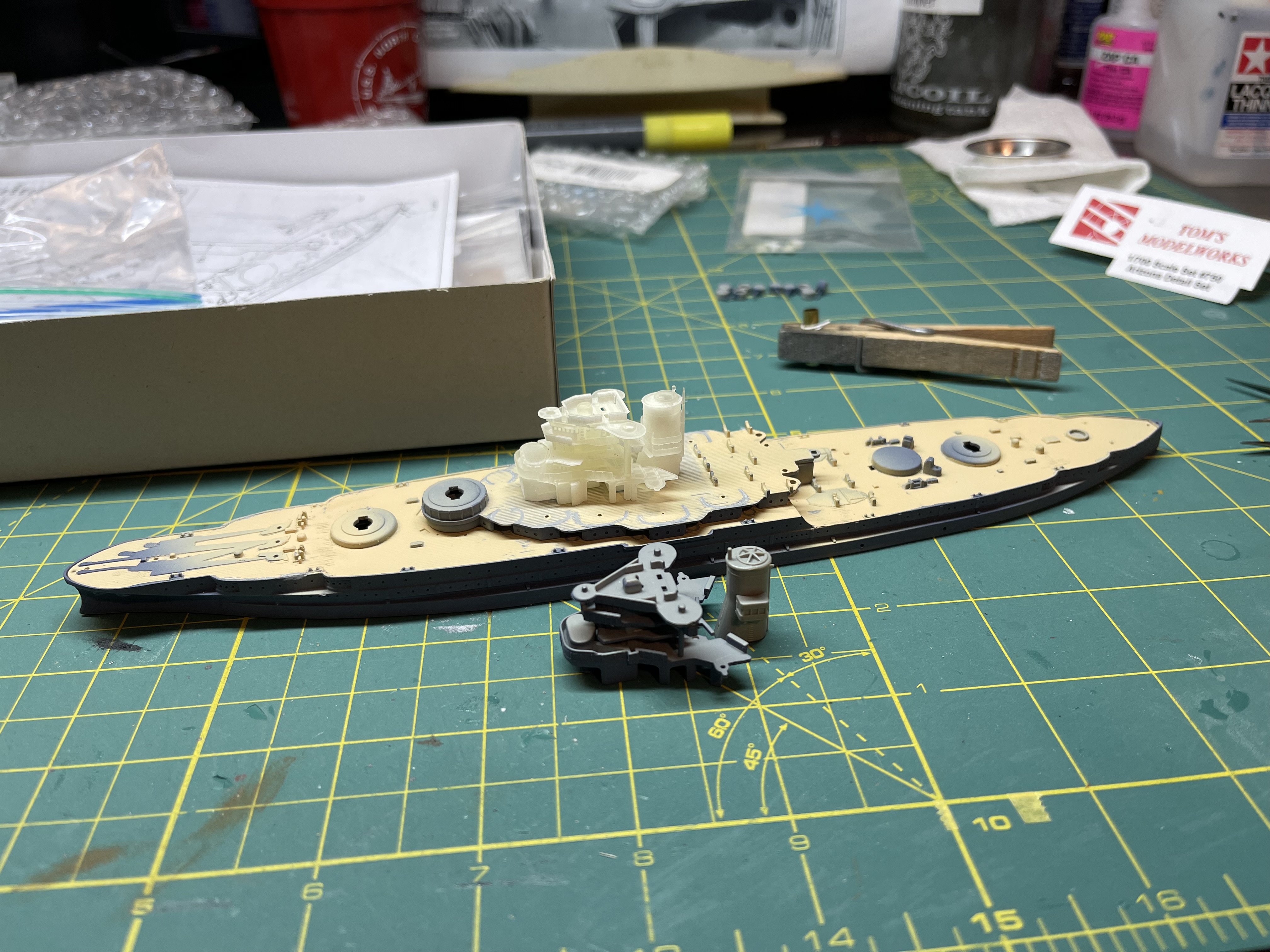

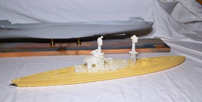

I went back through some photos and found a few pics of the other battleships mentioned in the first post.

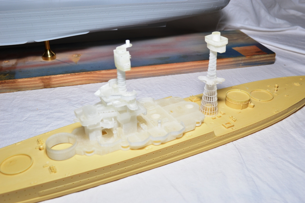

First up, Tom's Modelworks Arizona. The first photo dates from 2007, and very little work has been done since then (parts dry-fit only). The 2nd photo is from today. I had gotten a replacement forward superstructure from ISW at one point, but, whenever I get to building this, I'm going to purchase a ModelMonkey 3D printed superstructure. I've already got his turrets stashed aside for this build. The color is a Floquil dark gray I used before I was really versed in what the actual colors looked like. I plan on a complete repaint when the time comes. Then there is the BlueWater Navy California. Again, started and stopped. Partially because much of the superstructure parts were warped or damaged. But....Kraken Hobbies to the rescue, with a new 3D printed superstructure! I'll also being using ModelMonkey's 3D printed turrets, spotting tops and cage masts. Finally, the BWN USS West Virginia. This model was never started. It was, however, sold, via this forum, to an unscrupulous buyer from Canada, who stiffed me on the payment. I ended up getting the Canadian police involved - they went to his house, confronted him, and got (most) of my items back. However, the buyer, in a fit of rage at being caught, damaged all of the models he sent back. This time, it was ModelMonkey to the rescue - he designed a replacement 01 deck and superstructure to fit this kit. I'll also be using his cage masts and spotting tops (and probably his turrets). Hoping I live long enough to build it.

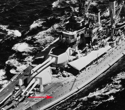

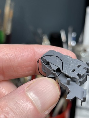

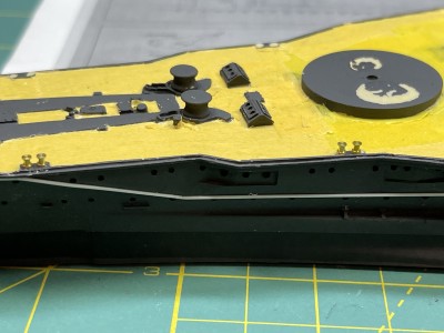

Assuming we're talking about the same thing, isn't that just an exaggerated plating line? It's certainly exaggerated on the 1/700 kits.you might want to remove that bulge on the Wee Vee above the armor belt as not supposed to be there.
That's what I am seeing, just an overscale representation of a hull feature that was there on the real ship.Dan K wrote:Assuming we're talking about the same thing, isn't that just an exaggerated plating line? It's certainly exaggerated on the 1/700 kits.you might want to remove that bulge on the Wee Vee above the armor belt as not supposed to be there.
I think you are right - it's meant to represent hull plating.Dan K wrote:Assuming we're talking about the same thing, isn't that just an exaggerated plating line? It's certainly exaggerated on the 1/700 kits.
Agreed. Overstated plating.

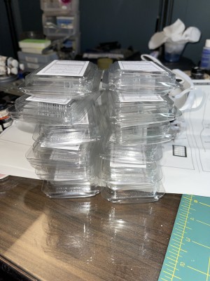

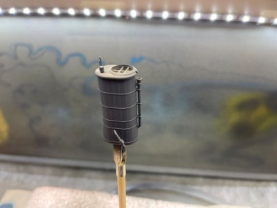

Between being busy and having a stomach bug, so not so much going on. But a new order from Black Cat arrived, with 5/25cal guns searchlights, 3in guns, paravanes, 3D printed inclined ladders, ships boats and other goodies.

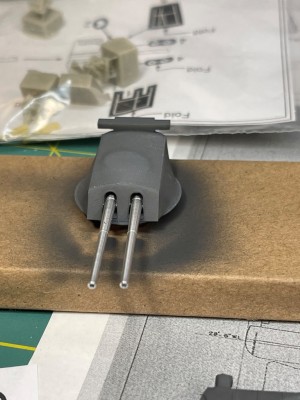

Thanks Jim - appreciate you stopping by and also your comments.JIM BAUMANN wrote:But these old kits--
(despite the softness of some of the smaller parts...
like the old cast ships boats etc --- )
DO deserve the work you are putting in--

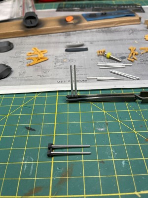

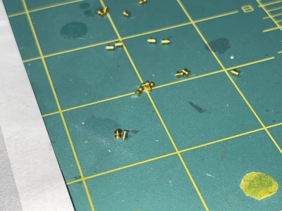

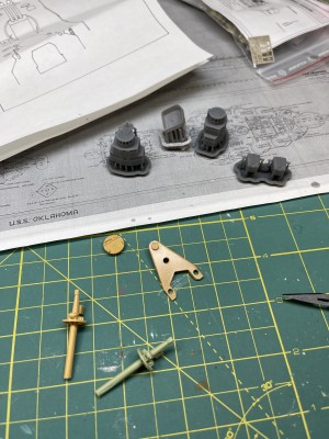

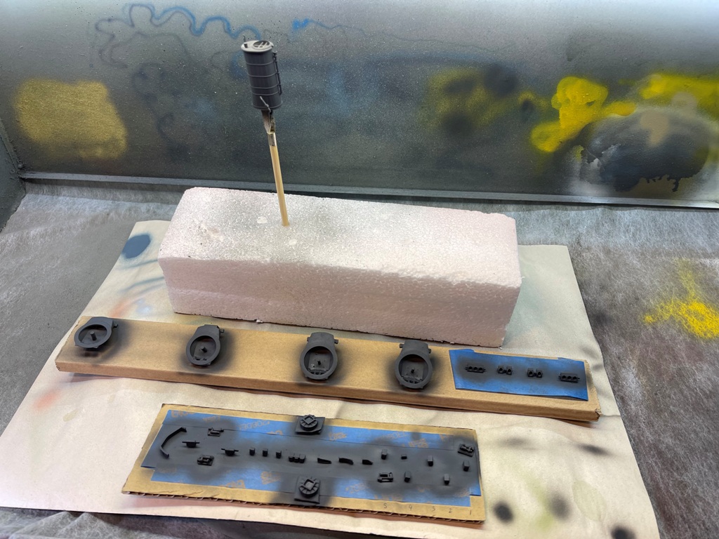

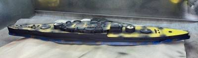

Broke out the airbrush and was able to get some 5D laid down on various parts. The kit supplied 14in brass barrels were too thick at the breech end to fit into either the separate trunnions or the openings in the ModelMonkey turret faces. I picked up a set of Master Models turned metal barrels for the Arizona, as I needed the 5/51cal barrels as well. These barrels were better but I still needed to widen the holes in the trunnions to get them to fit. Hoping to get some more time at the spray booth this weekend.
