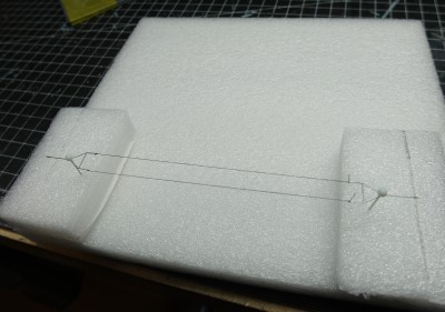

First I built a device to run the longwave antennas parallel between the triangles.
This way you can get the same tension on both sides.
And the first threads are already hanging. Also to the funnel.
