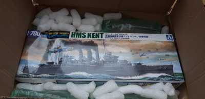

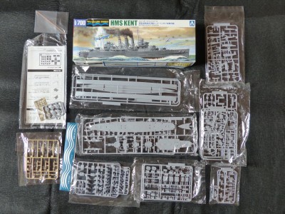

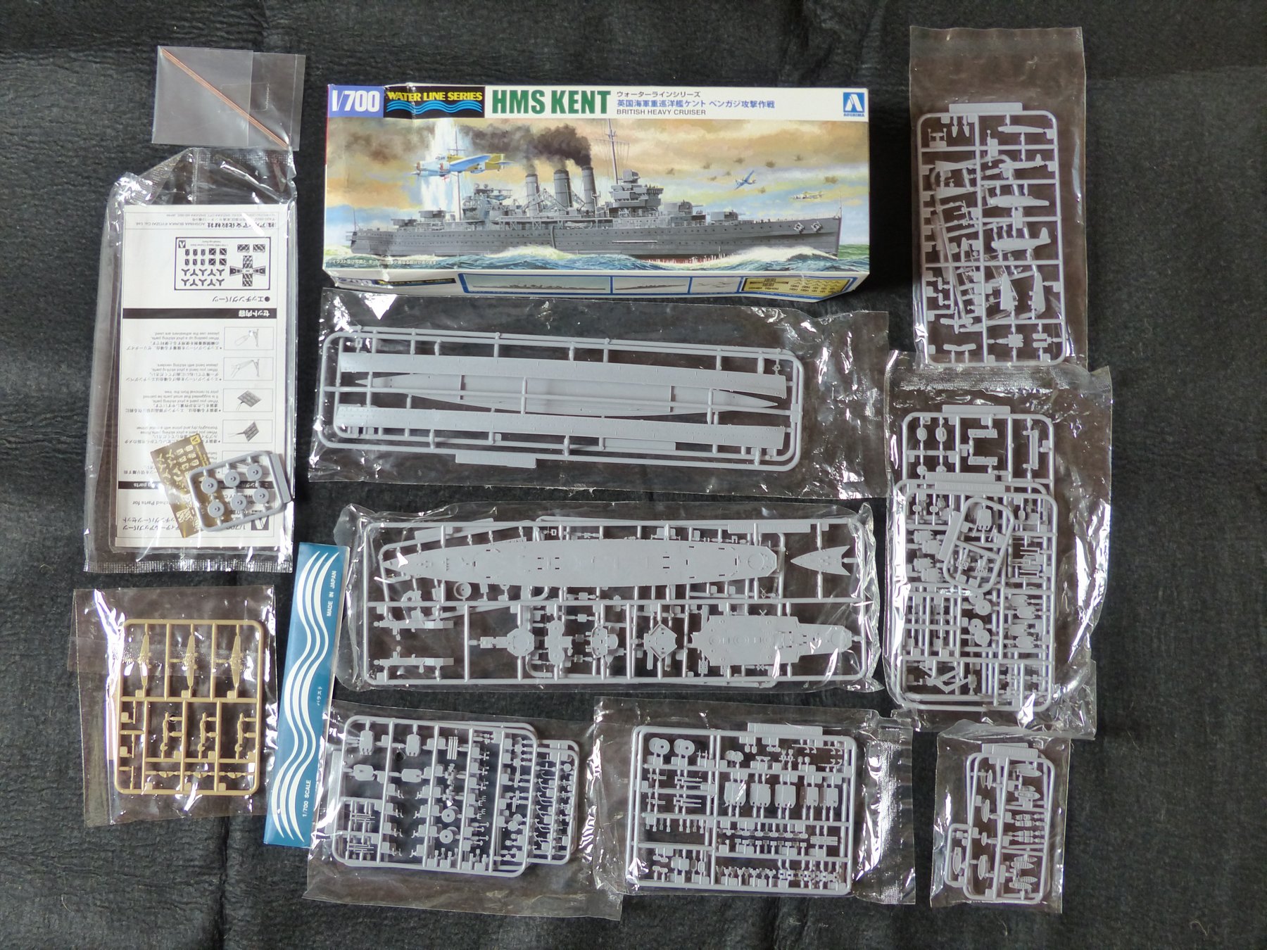

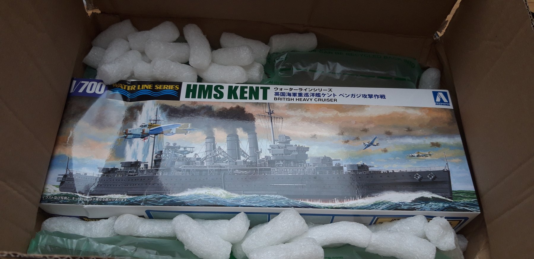

It took several painful weeks until my Aoshima Kent was delivered due to all those Covid restrains. Besides working on the Chicago and Kinugasa I spent them by continuing to catalogue modifications that will be necessary for the Australia conversion. As often, many more turned up than first anticipated.
Then the kit finally arrived! It was contained in a rather small but tall box packed tight with heaps of plastic parts. Sorry to say that, but most of it was not as good as I would have expected, some parts appeared almost toy-like and apparently were not much usable for me :( Overall, compared to the recent 1/700 kits produced by e.g. Flyhawk or Fujimi - but also to 15 years old Hasegawa Aoba and Furutaka classes! – it´s below standard these days. The good news though was that the hull and deck were clearly the best of the kit, nicely and crisply molded. It´s really a pity Aoshima didn´t do a better job, and the 1/700 Kent by Trumpeter (that did not exist at that time) would have been a better starting point in many respects.
In short, I ended up using only the hull, the main deck, the forecastle deck and the aft superstructure parts from the kit in the end anyway :smallsmile:

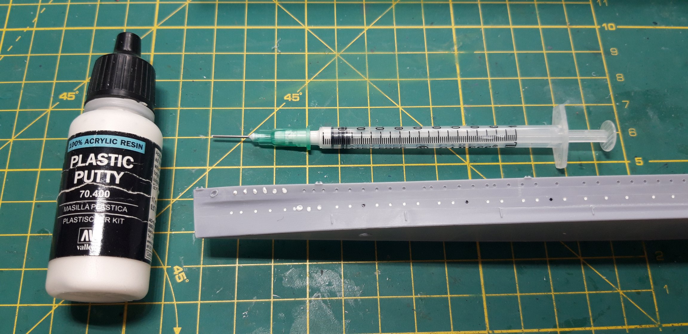

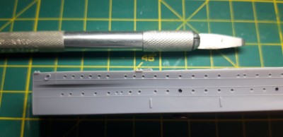

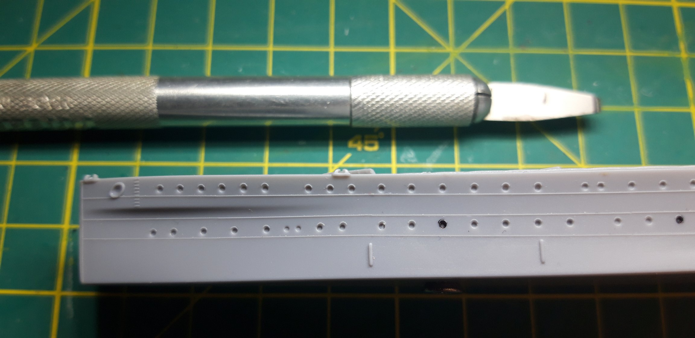

I mentioned that the Aoshima Kent hull was quite nice and crisp, especially the porthole brims looked really good. I like how the hull was constructed with internal bracing, more like hulls in 1/350. Also the waterline plate fits inside the hull so no seams can be seen from sides, really wise! Still it has some problems to correct – most importantly the overscale and unrealistic hull plating. I checked some completed Aoshima Counties on the internet and found this hull plating really ugly, so I hesitated no more to remove those lines. I modified a Proedge blade to scrape them off, followed by sanding with 1000 and 2000 grade sandpaper. I wished to protect the upper row of porthole brims so I covered them with masking tape while sanding.

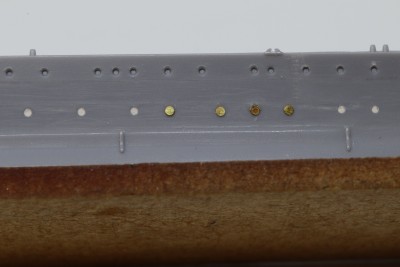

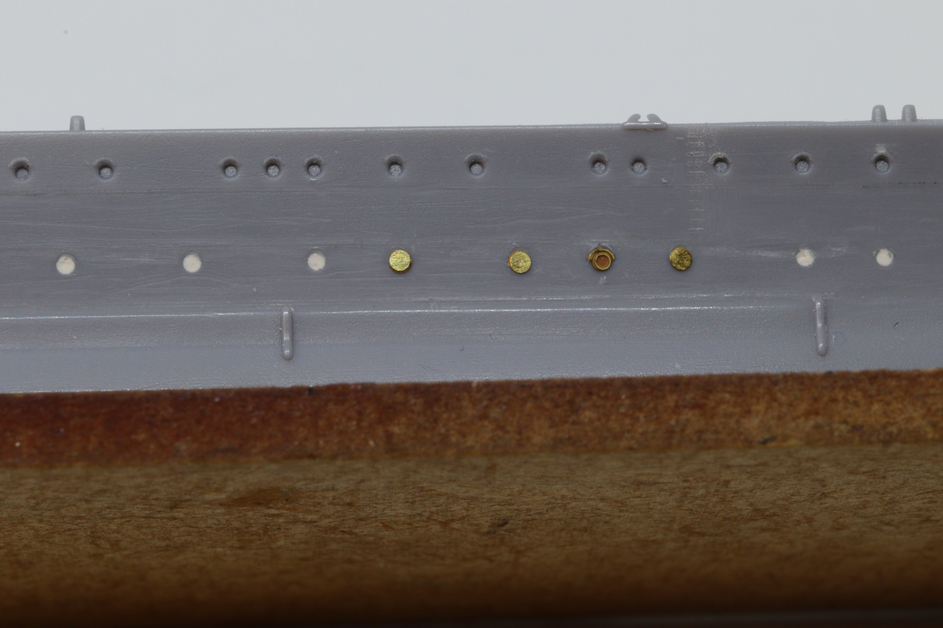

The next step – easier to correct – were the portholes. Australia had almost all of her lower row of portholes and some of the upper row plated over, altogether about 120 of them. I filled those with acrylic putty at first intending to plate them over with PE later.
Note: the vertical molds near the waterline should have been removed as well - I noticed that Australia did not have these covers over the water outlets only at a very late stage and it´s been very cumersome to correct at that time!
Then it was the main deck. It fitted nicely into the hull, very easy to install and with no seams. The deck planking is overscale as usual but I decided to leave it as in the kit to reduce the size of the PE set (I regreted this decision at a later stage but then it was too late). I also liked how the turrets were attached with separate barbettes so there´s no dilemma about how to postpone their installation while still being able to attach the deck and superstructure first. Very clever. So it´s only needed to remove all the representations of unneeded deck vents, reels, breakwater and anchor chains, all those to be replaced with PE or 3D parts later.
PostPosted: Sat Aug 24, 2024 6:22 am
Posts: 289
Great tip about the acrylic putty, Vladi. Results are impressive, I might give it a go. Thx for sharing :cool_1: Eager to see more in-progress pics soon

I should add that all the above work on sealing the portholes was in vain in the end. I was not satisfied how the PE seals turned out so I asked Simon and he´s been so kind to provide me with a set of 3D printed seals that look much better. So I had to drill the putty out from around 120 portholes – glad that the acrylic putty was quite soft :D
PostPosted: Tue Aug 27, 2024 1:05 pm
Posts: 8781
I know that moment all too well. :cry_3:

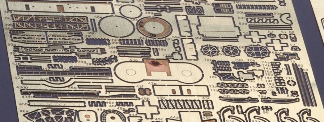

PE parts
The PE for Australia ended up to be my most comprehensive design so far, even more than my parts for USS Astoria. It included the complete forward superstructure and spanned over 2 and a half large A6 format brass sheets in 1/700. I didn´t count them but I guess there were close to 1000 individual parts. As usual, my first prototype version had some errors so I produced an improved version with even additional parts that I used for my build.
I did not make a complete deck overlay which I now think I could have done, but Aoshima´s deck planking is not bad. So the largest PE part is the overlay for the forecastle deck that was covered with wood planks, not metal as shown in the Aoshima kit. Additional large parts provide for a full replacement of the main bridge that was also different from Kent – more different than it appears at the first sight.
The PE set was designed for 1/700 but with the possibility of upscaling to 1/350 in mind. Upscaling would not mean degradation of detail in this case as the 1/700 is done in 0.1mm brass while the 1/350 would need 0.2mm thickness which would also bring an increase in the minimum dimensional requirements like line width, detail size etc.
Samples of my first attempt:

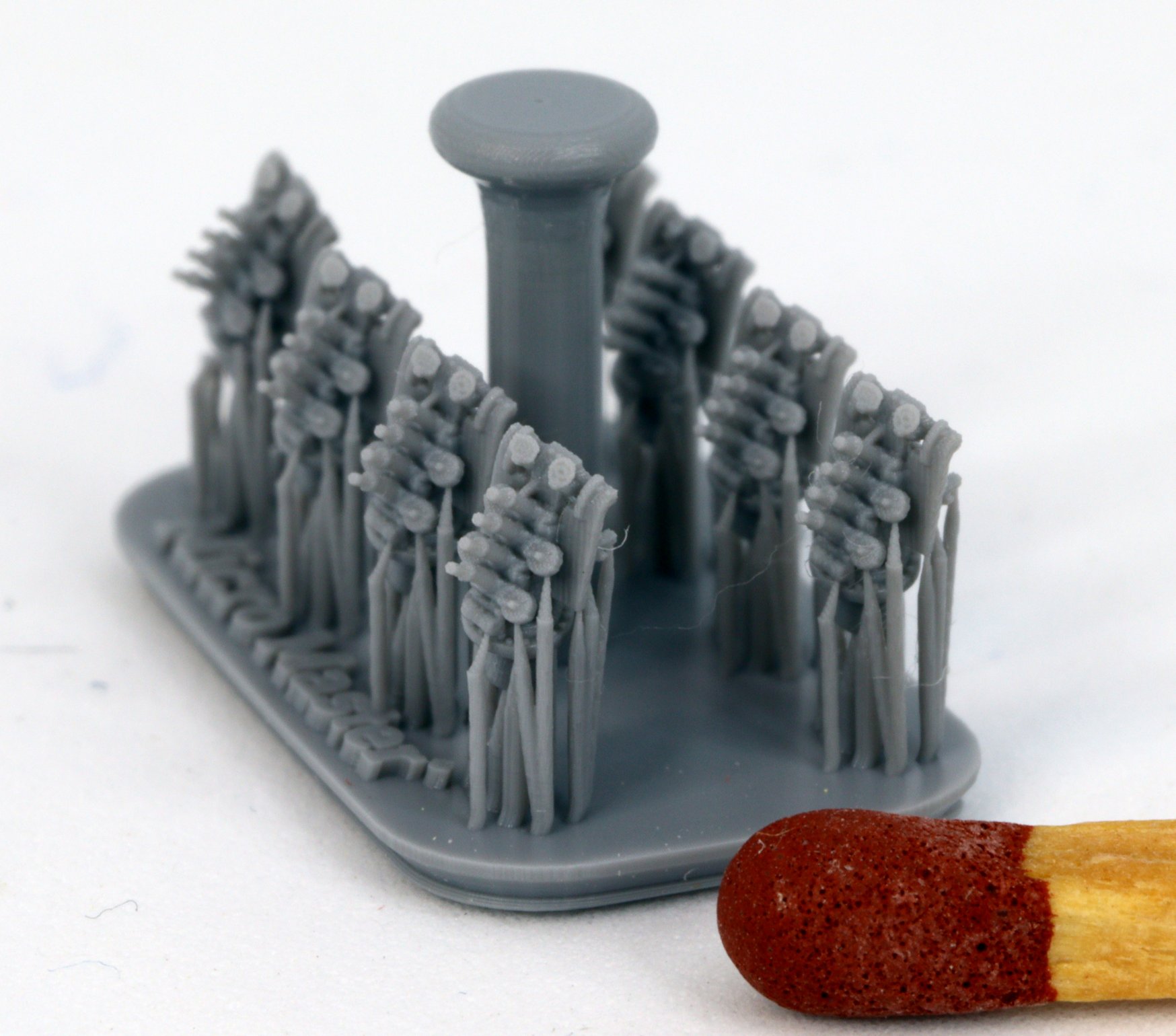

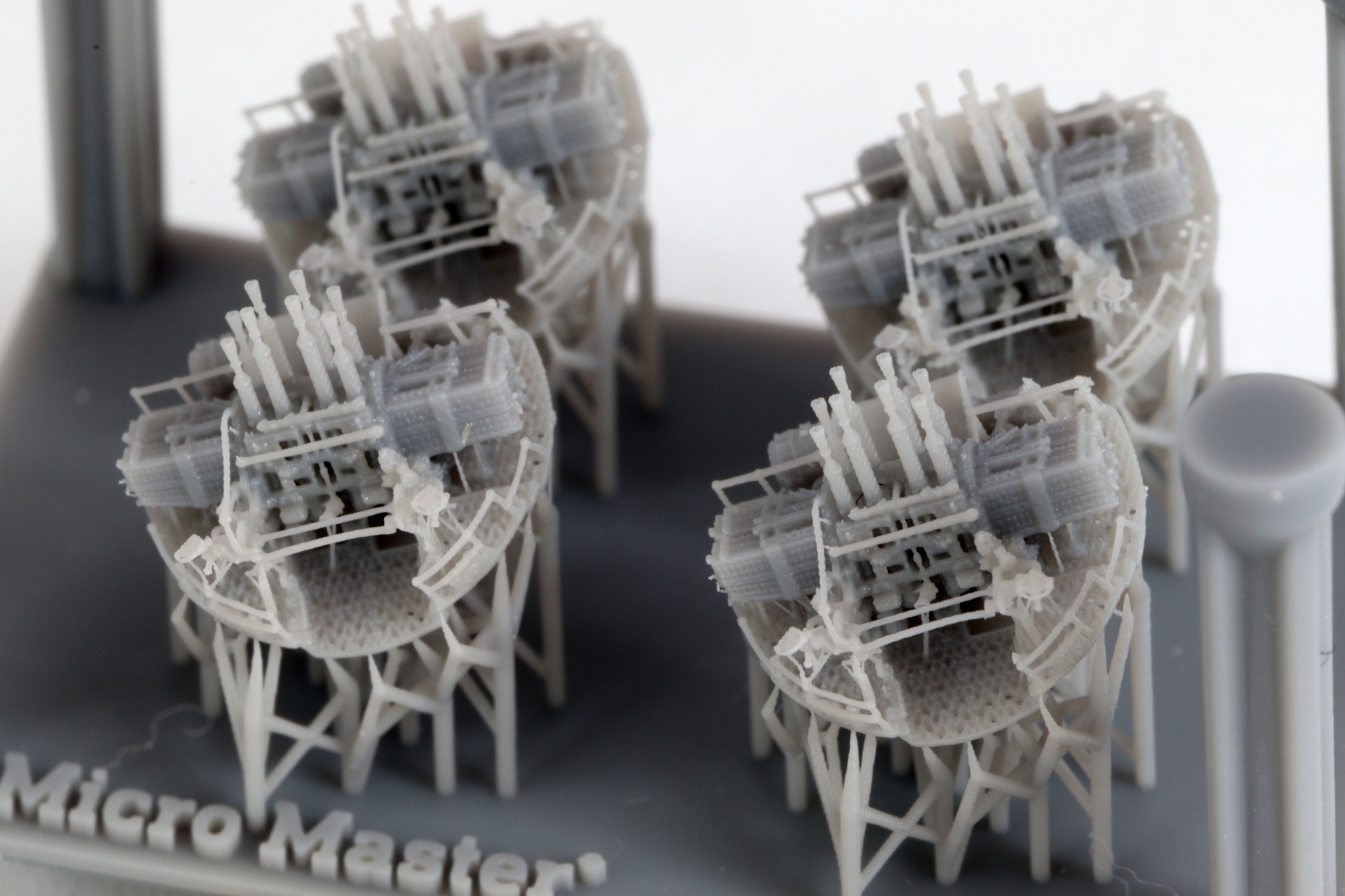

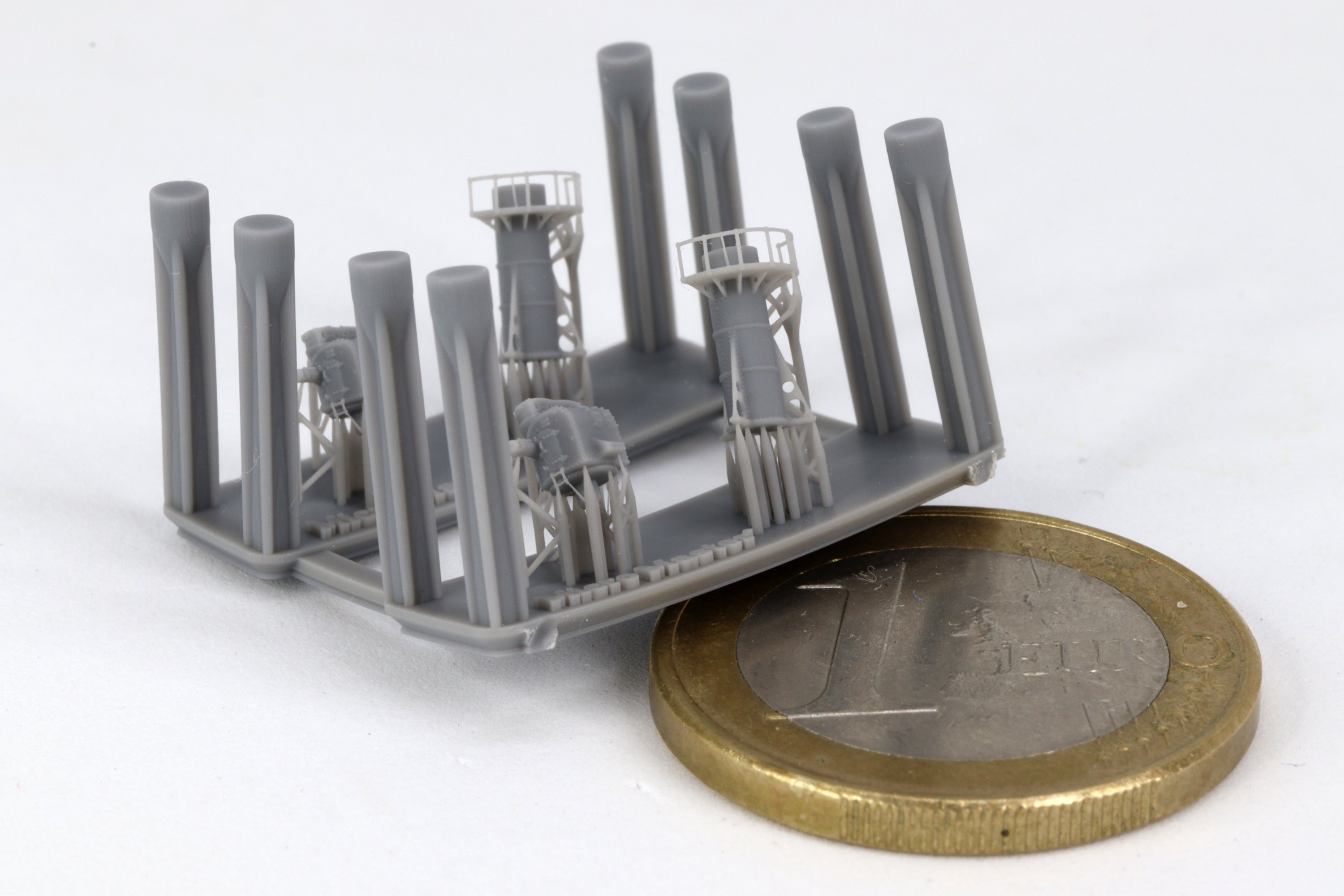

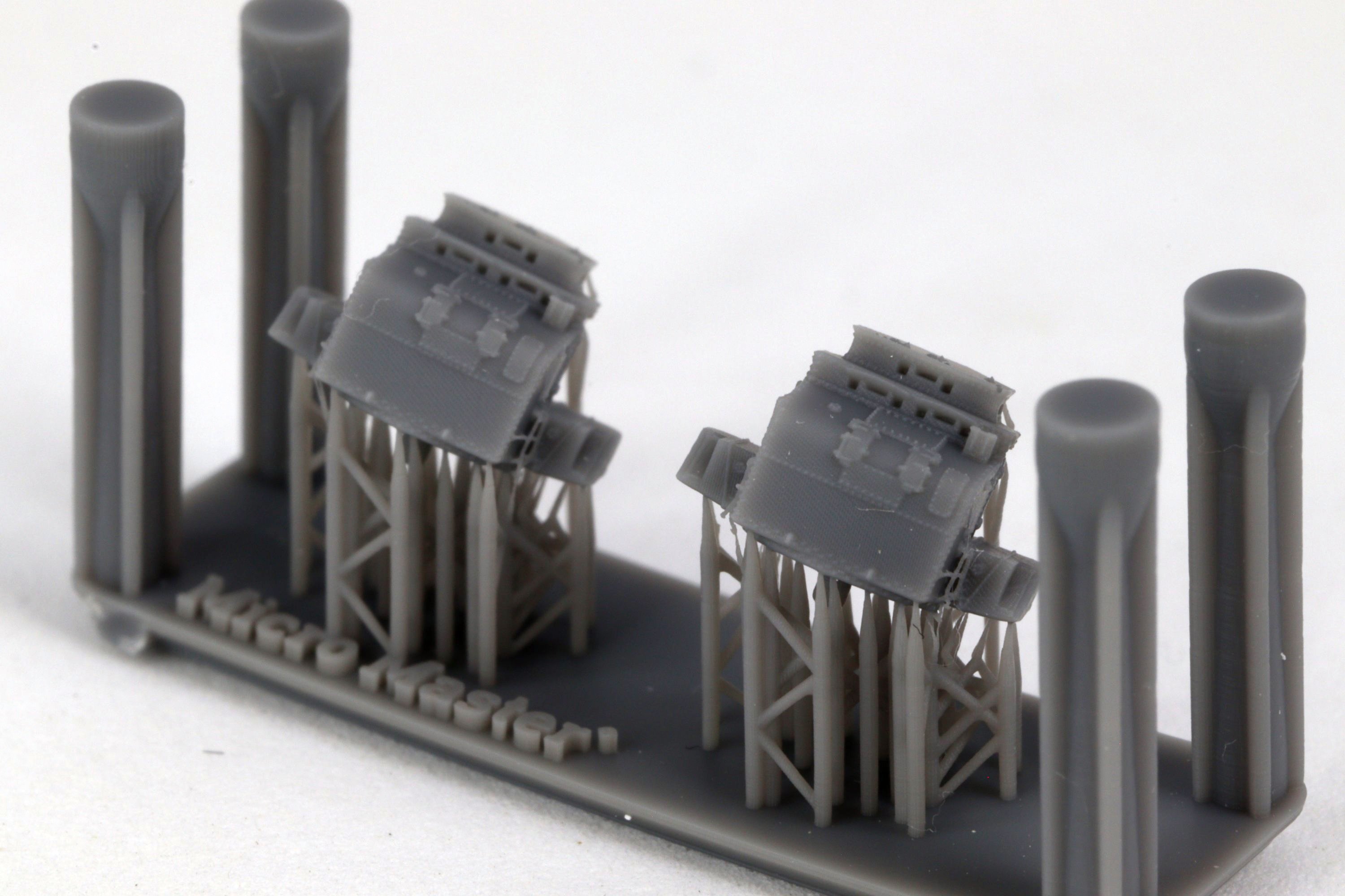

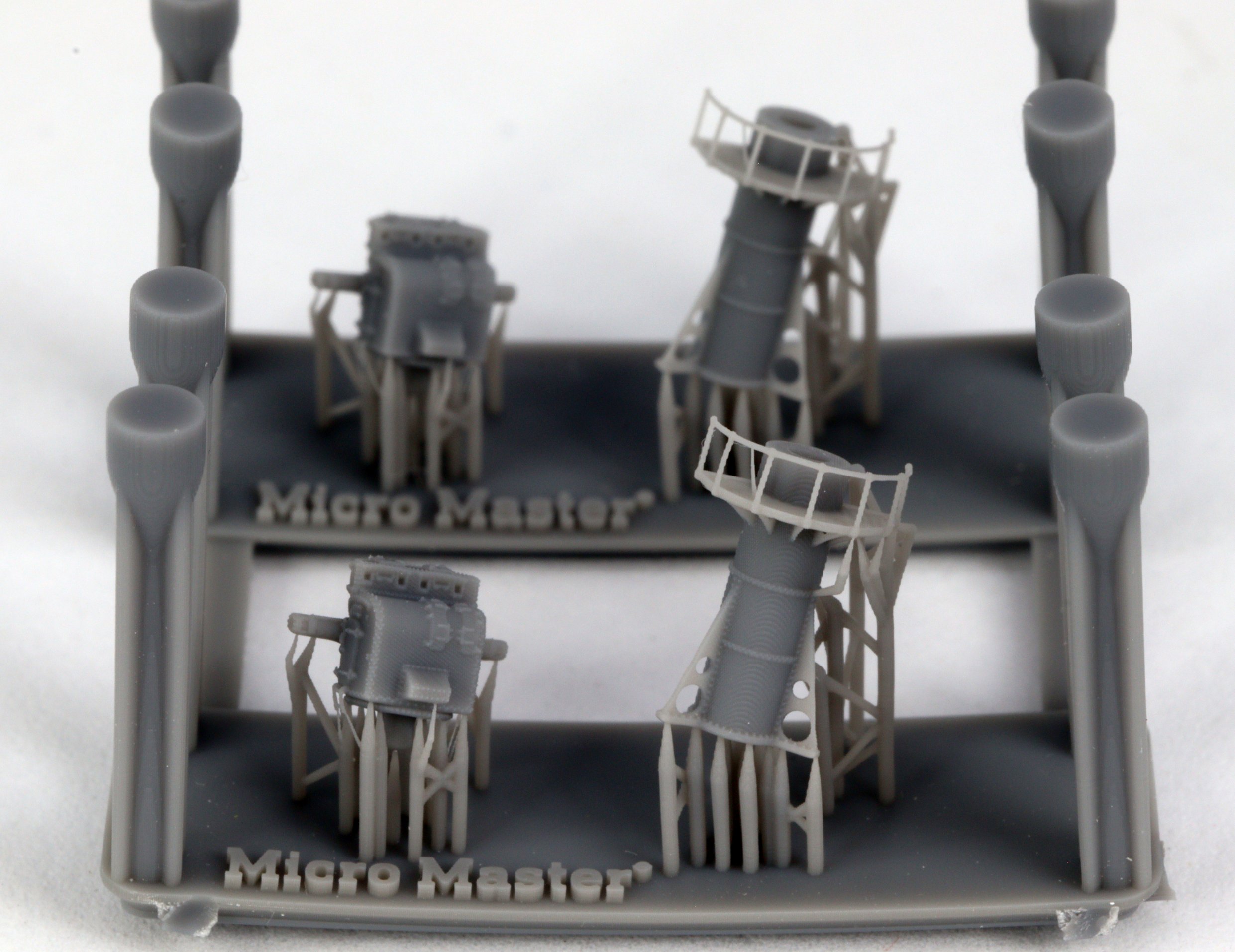

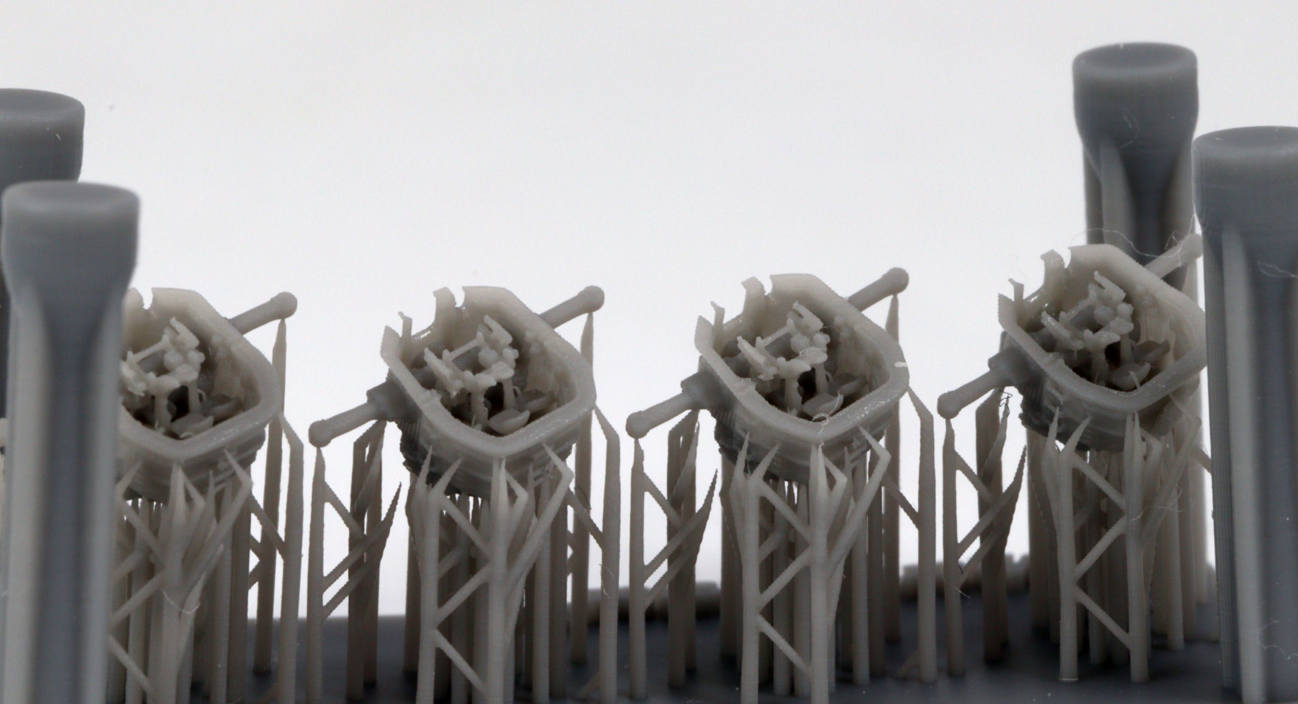

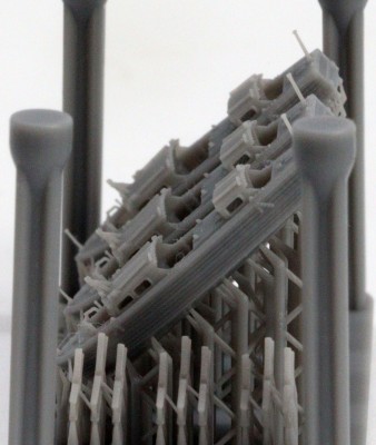

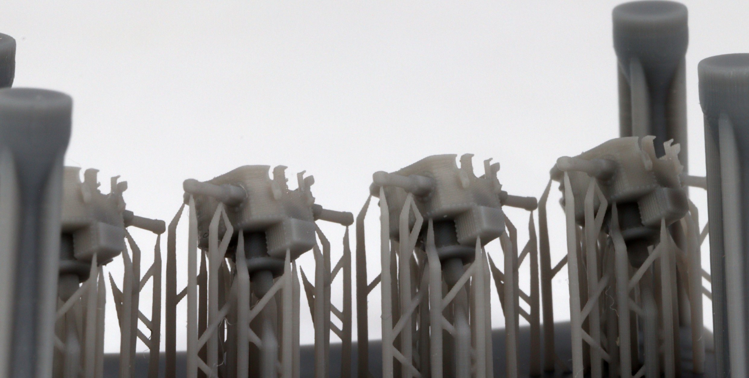

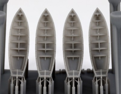

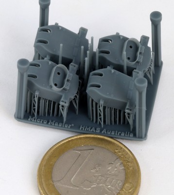

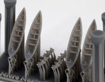

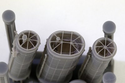

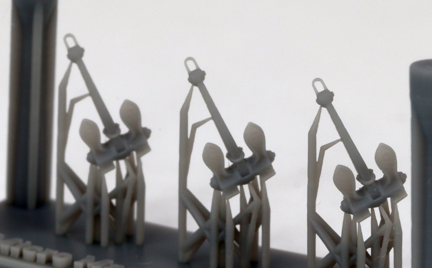

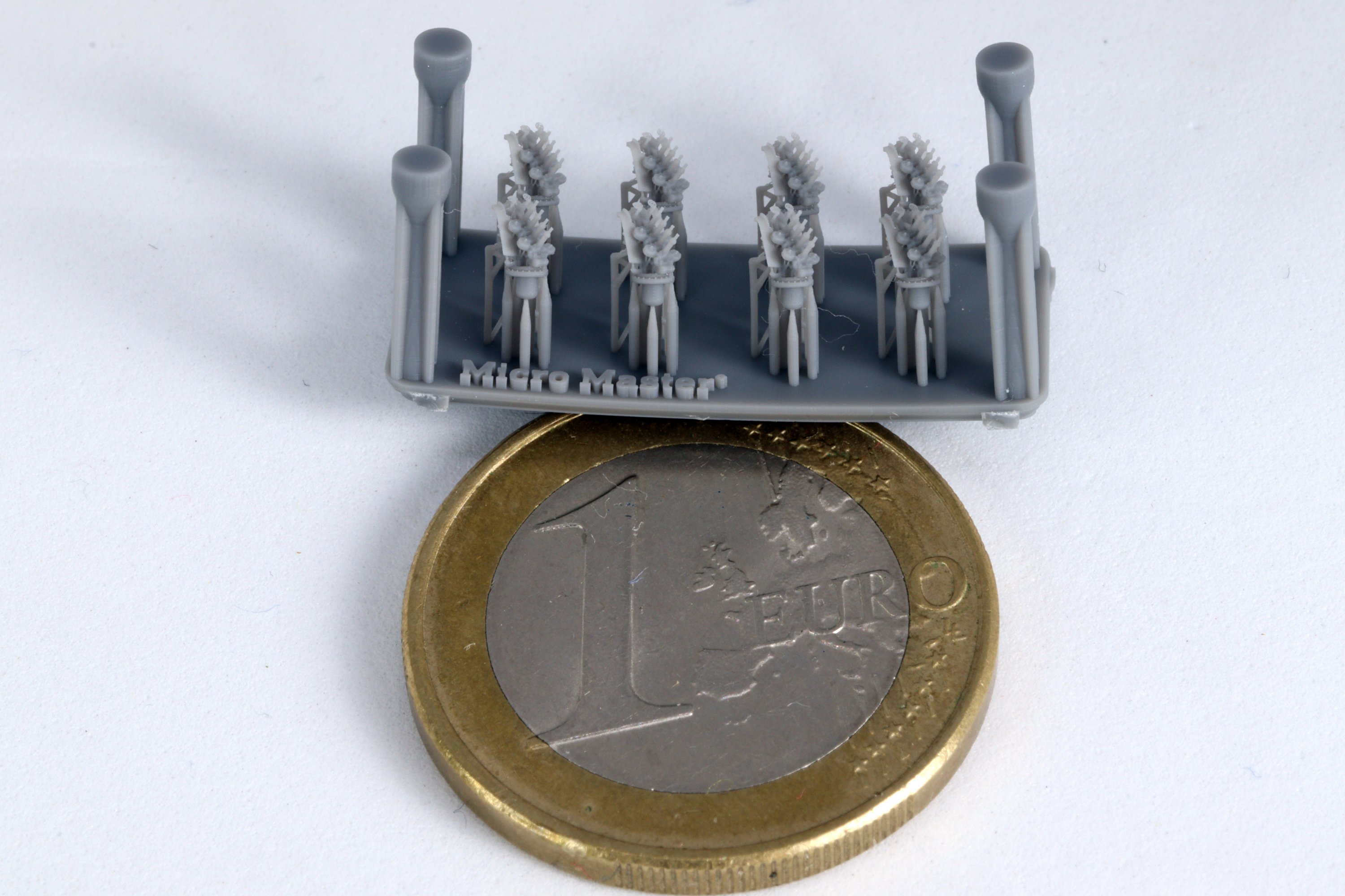

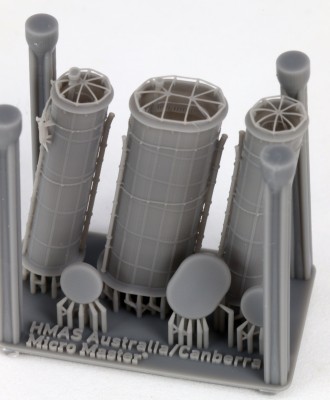

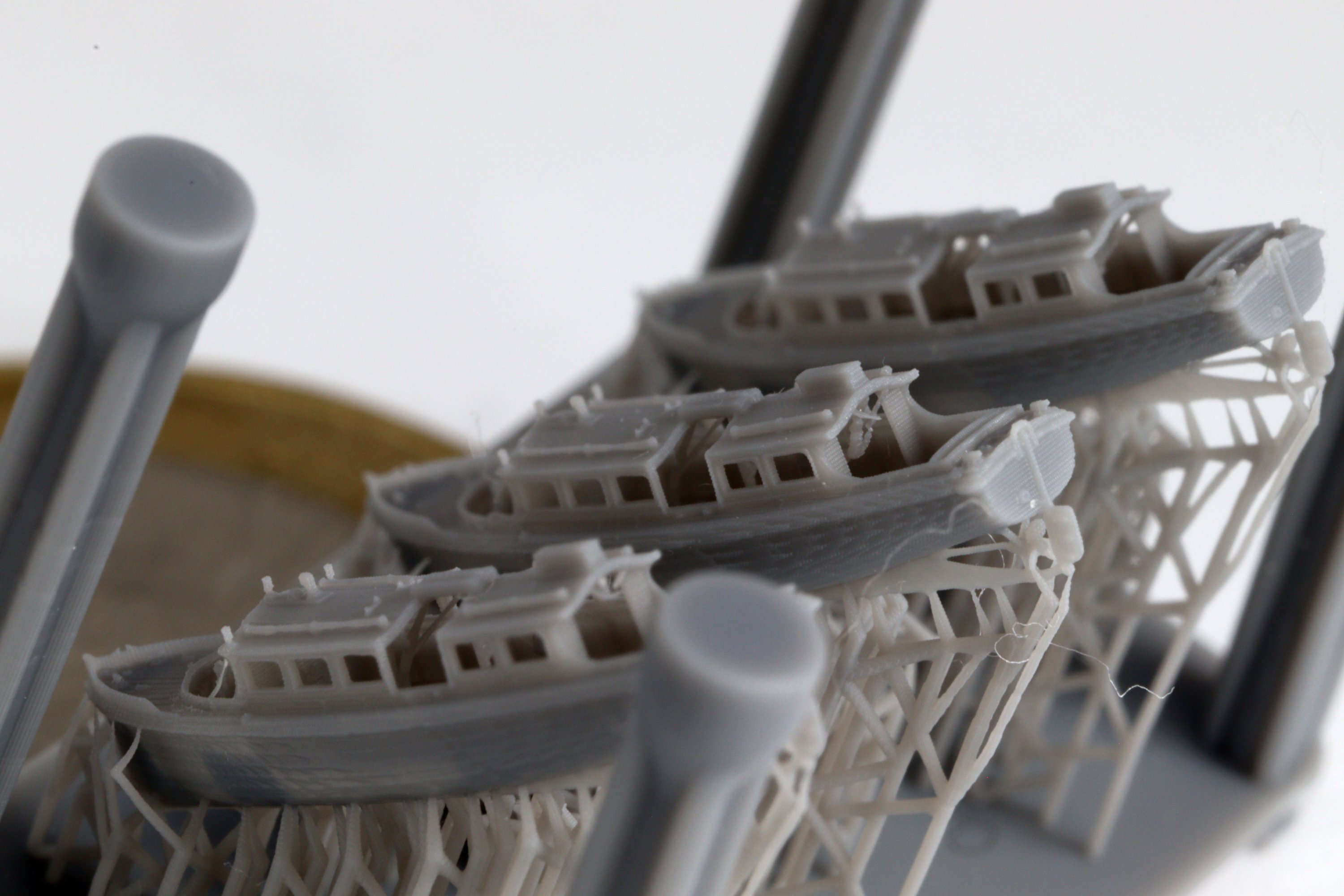

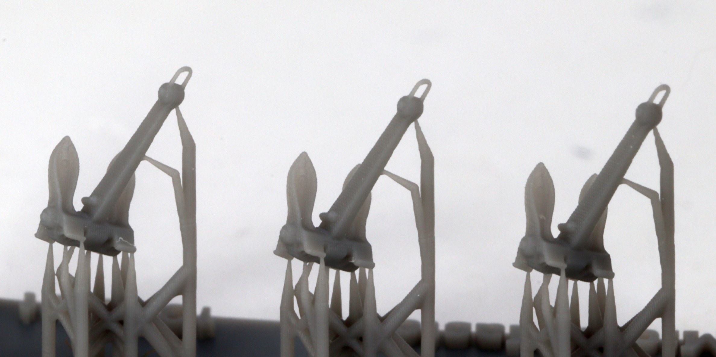

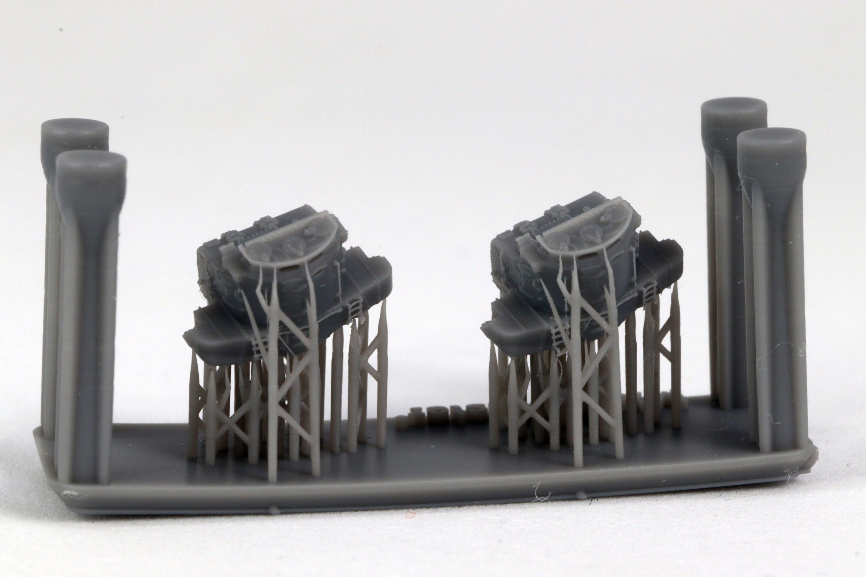

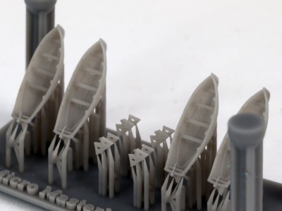

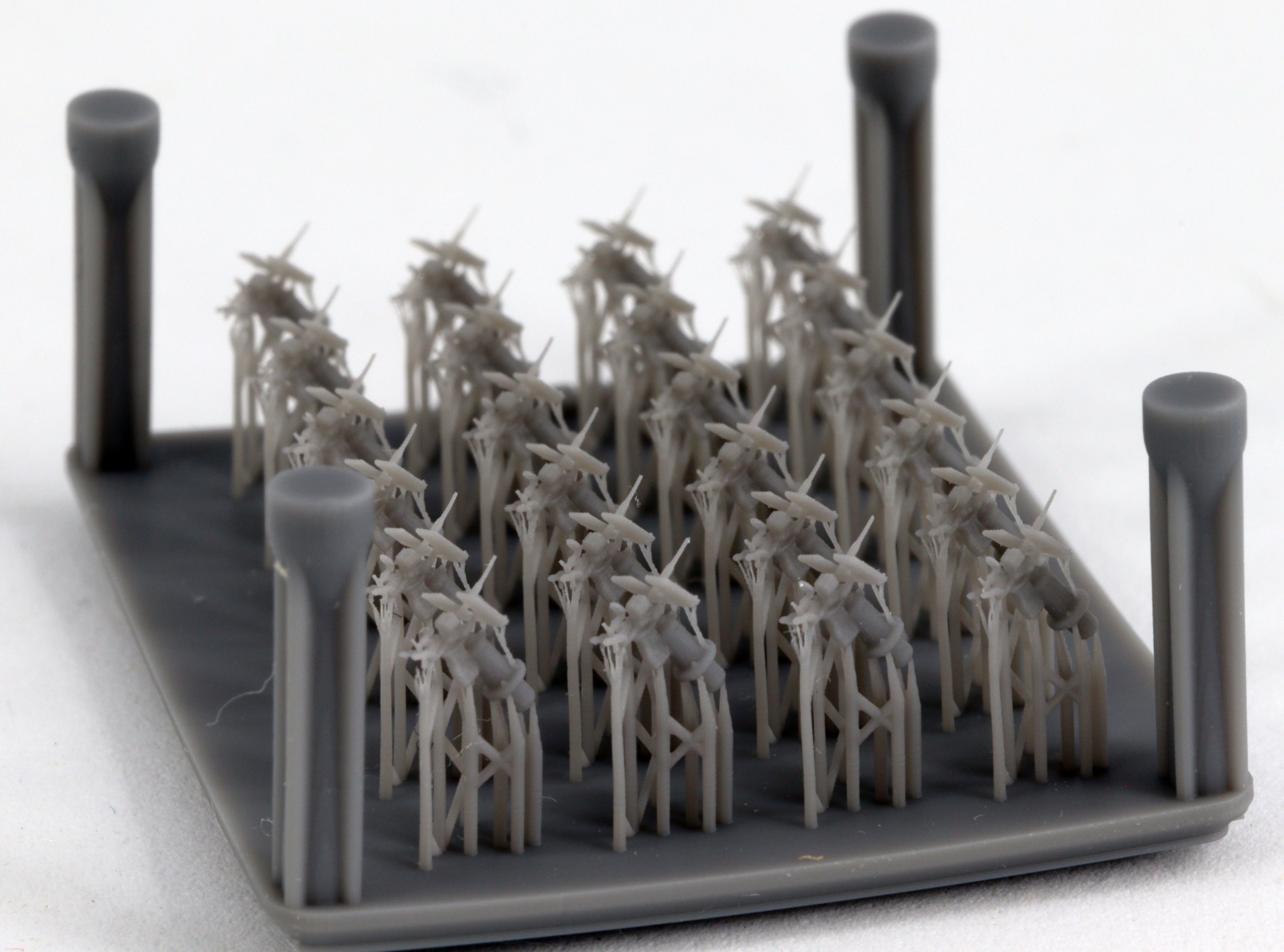

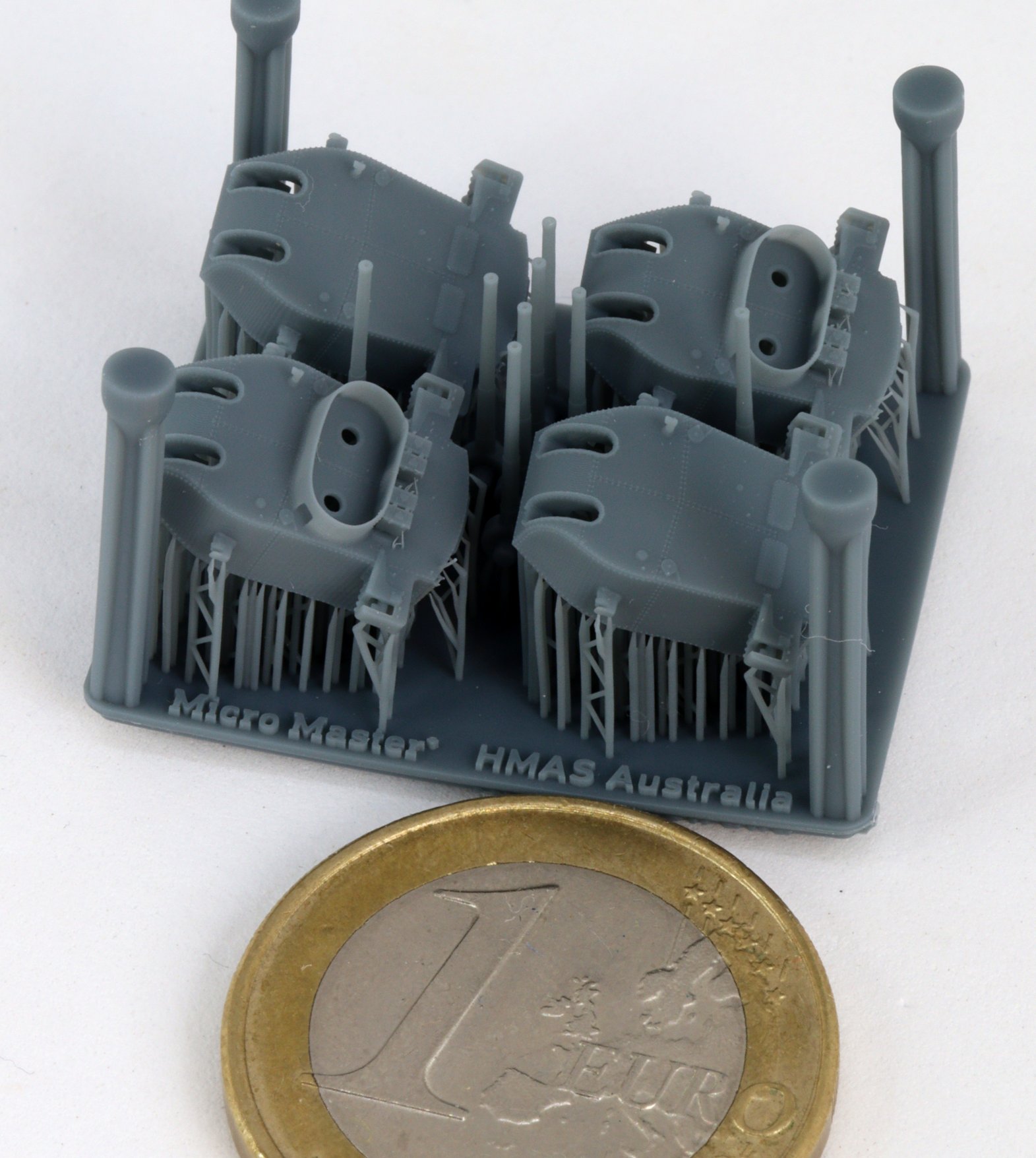

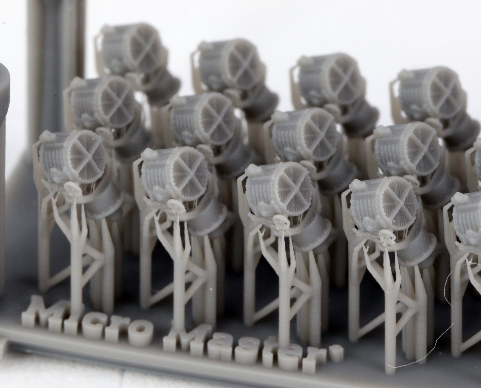

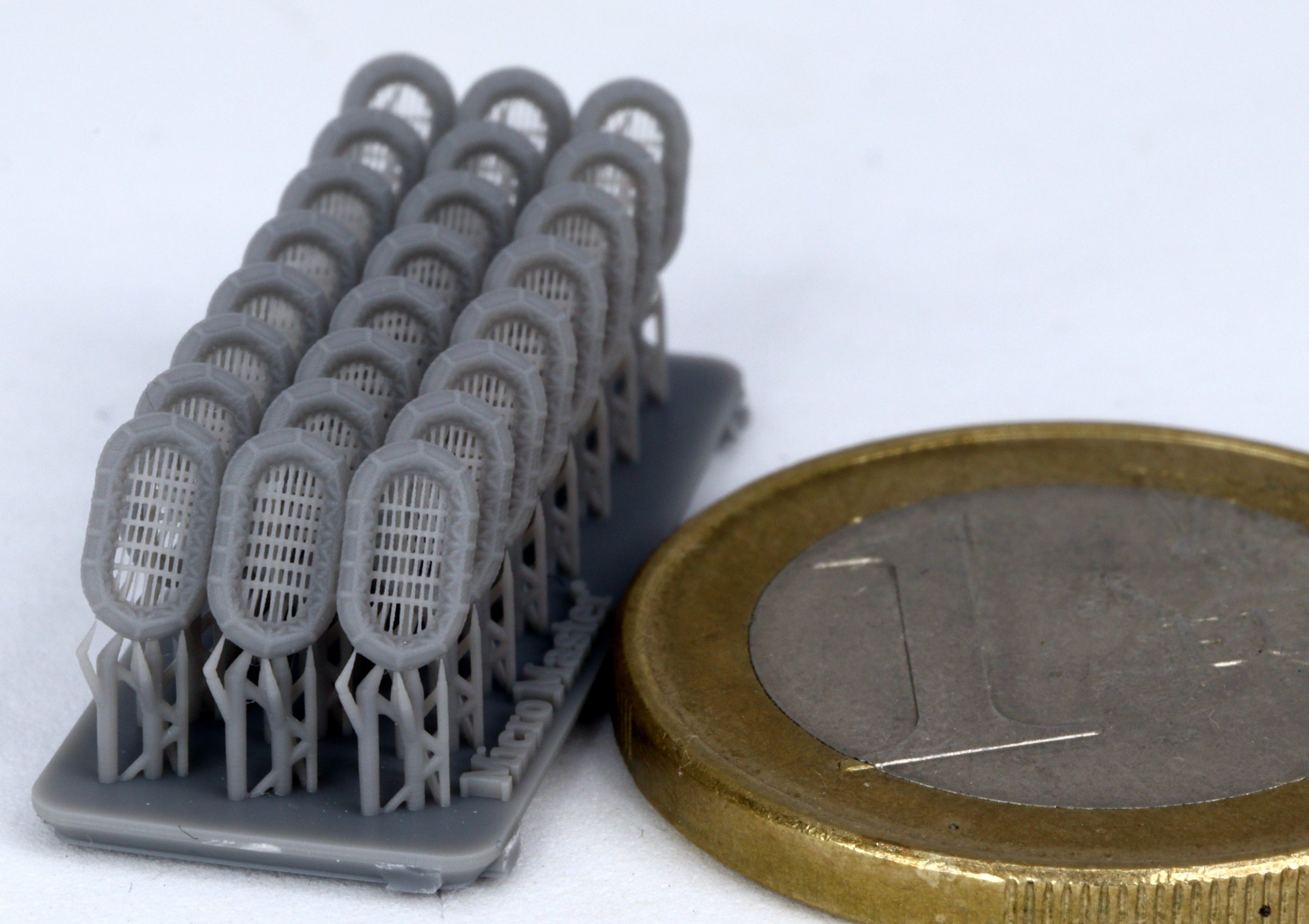

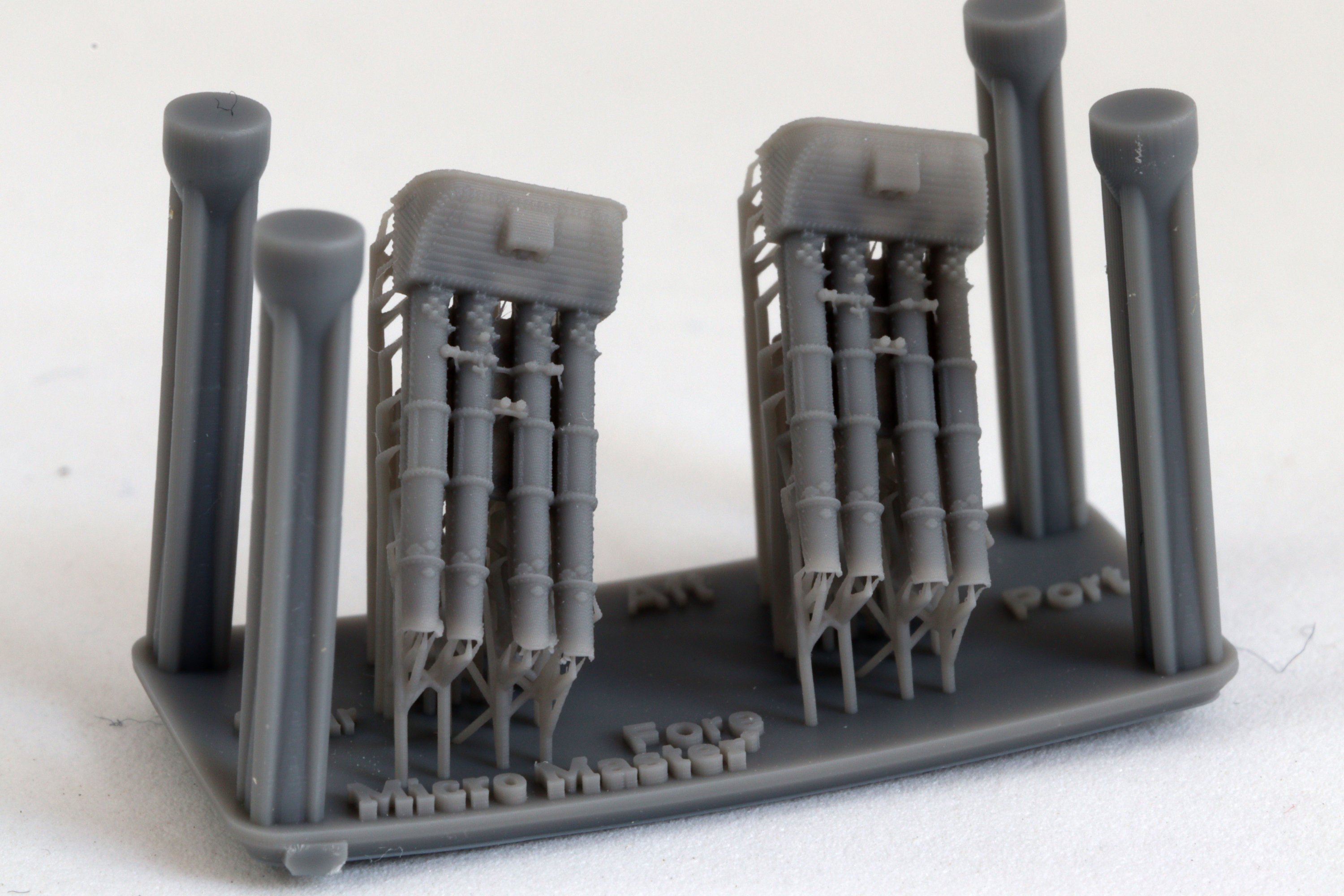

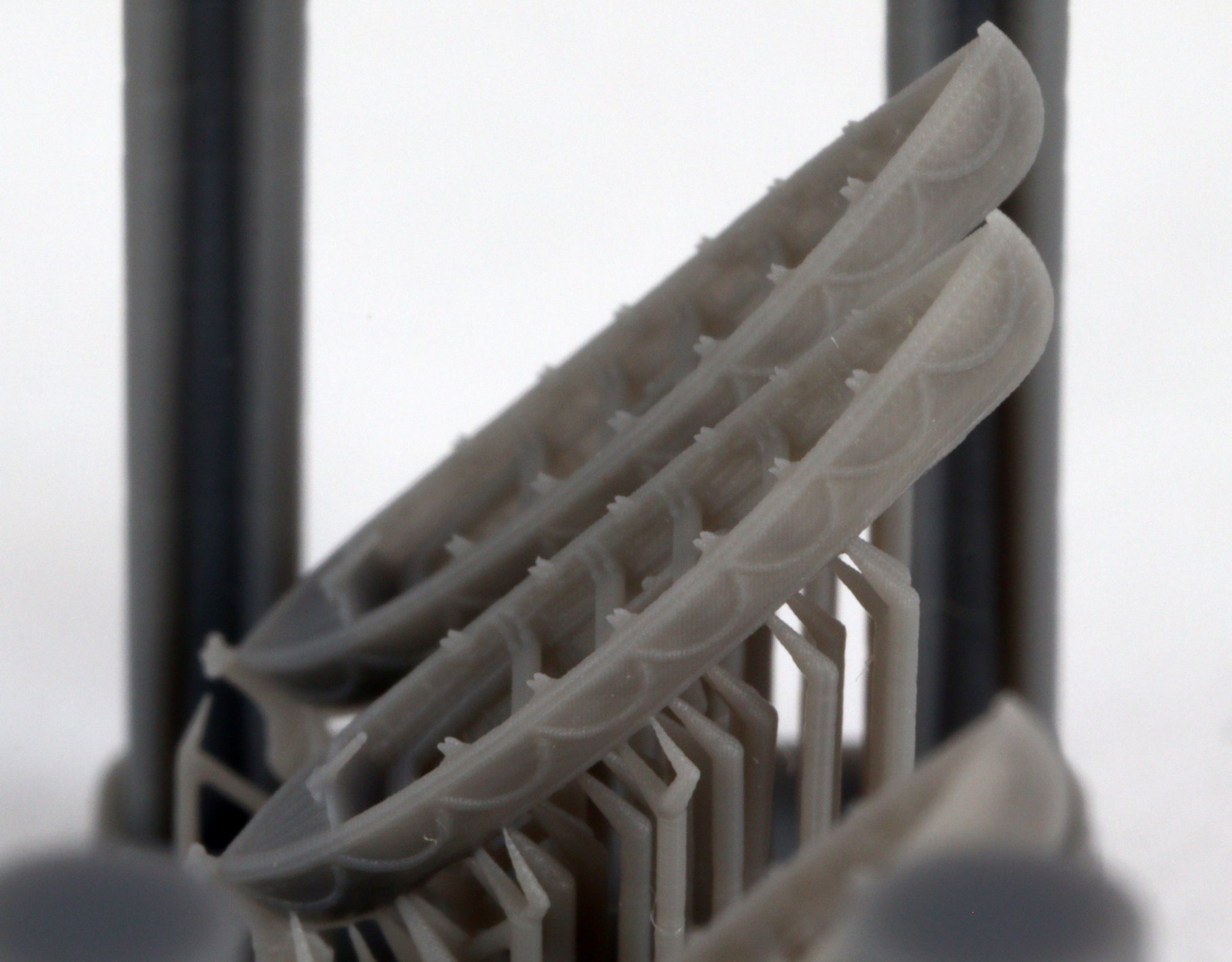

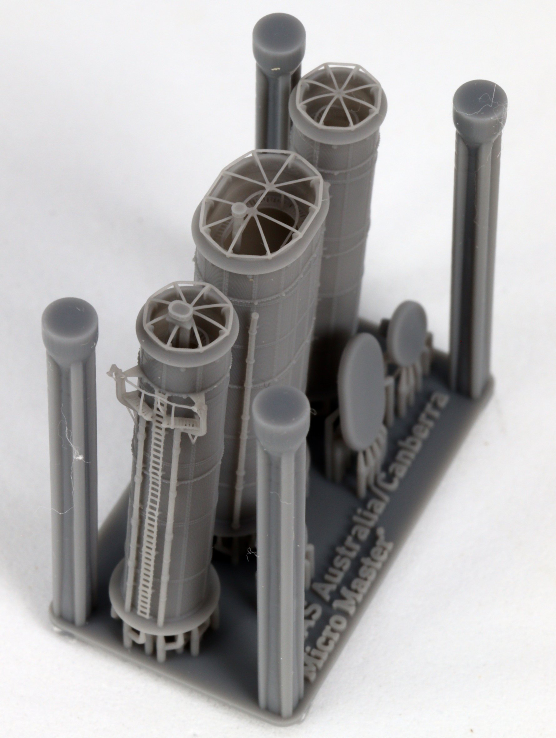

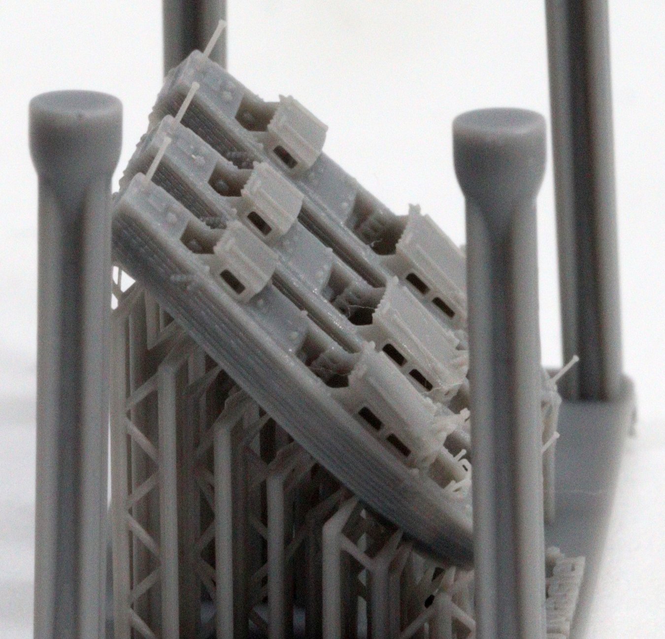

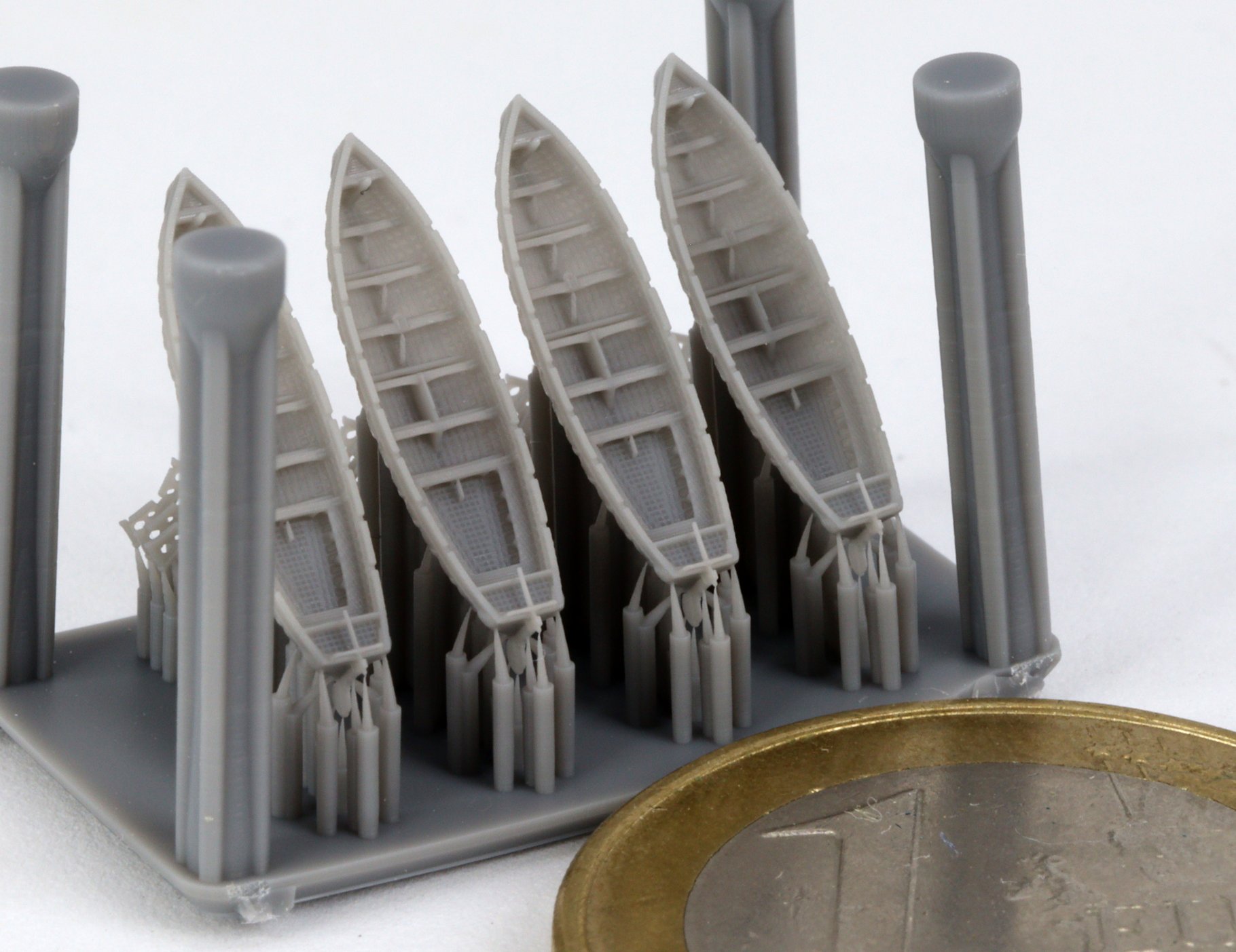

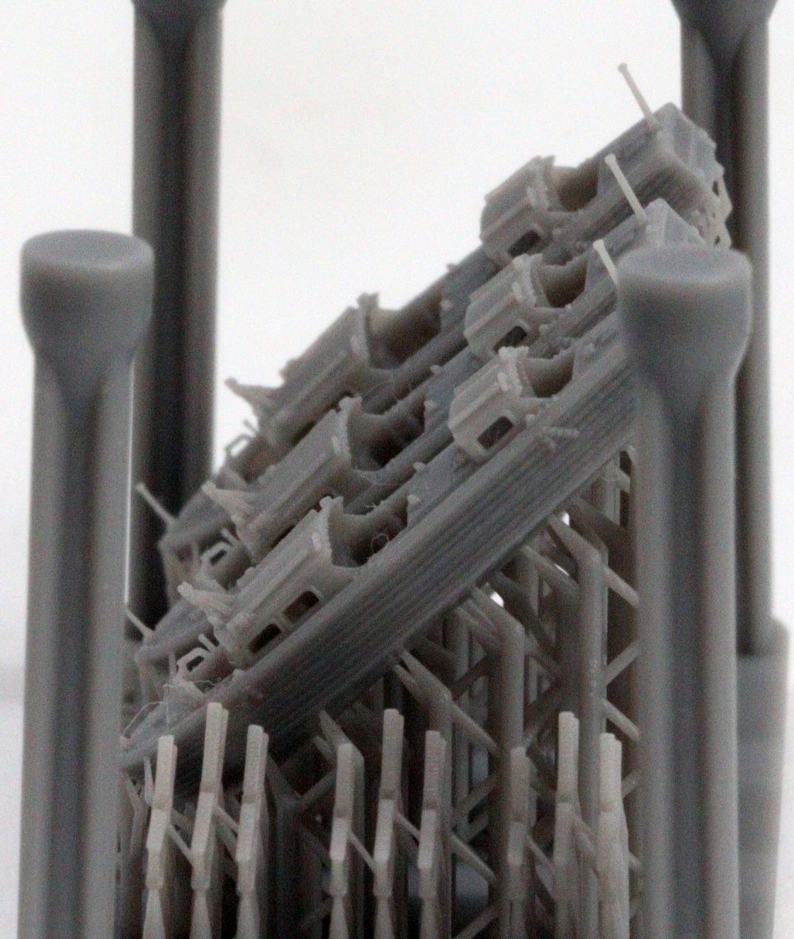

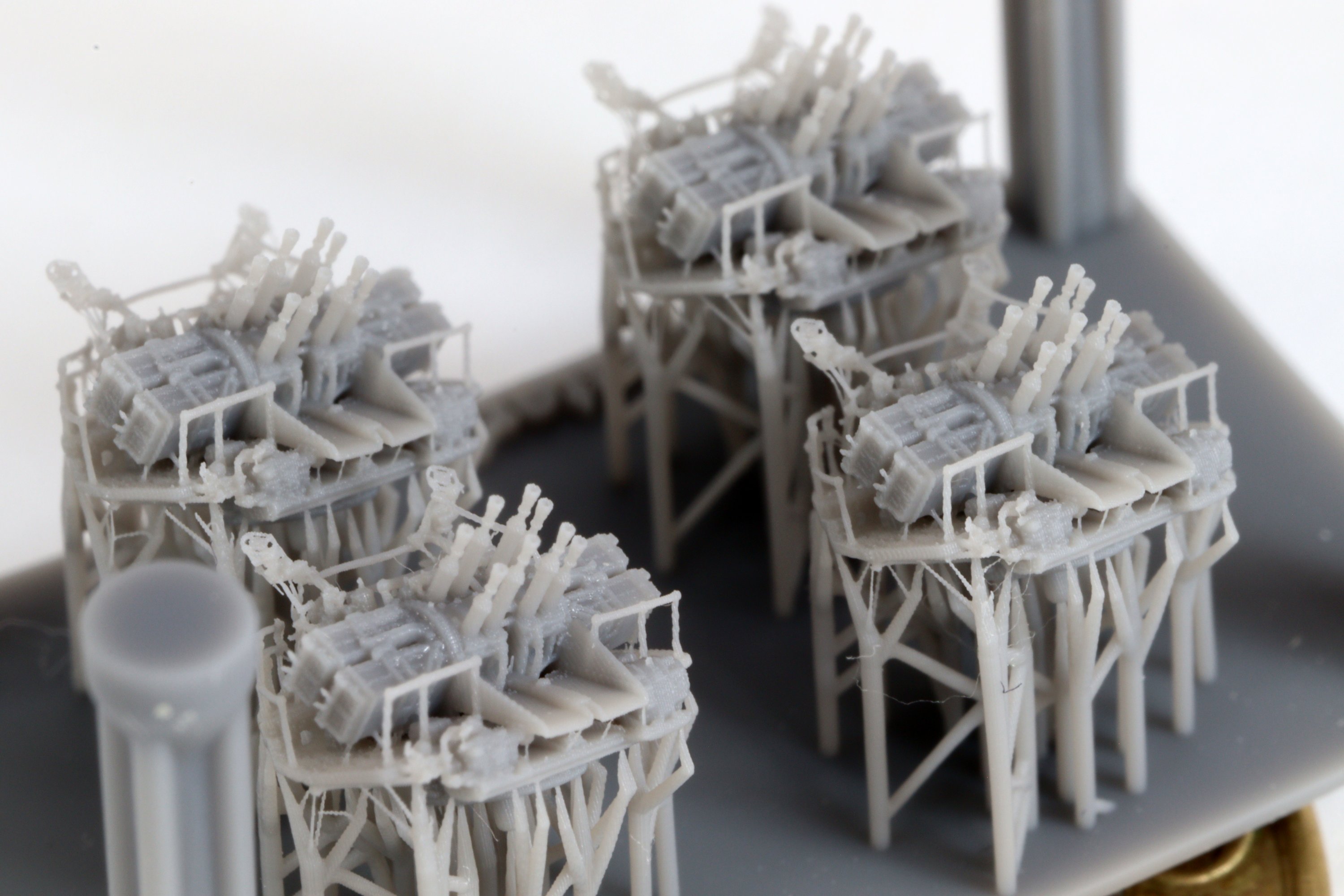

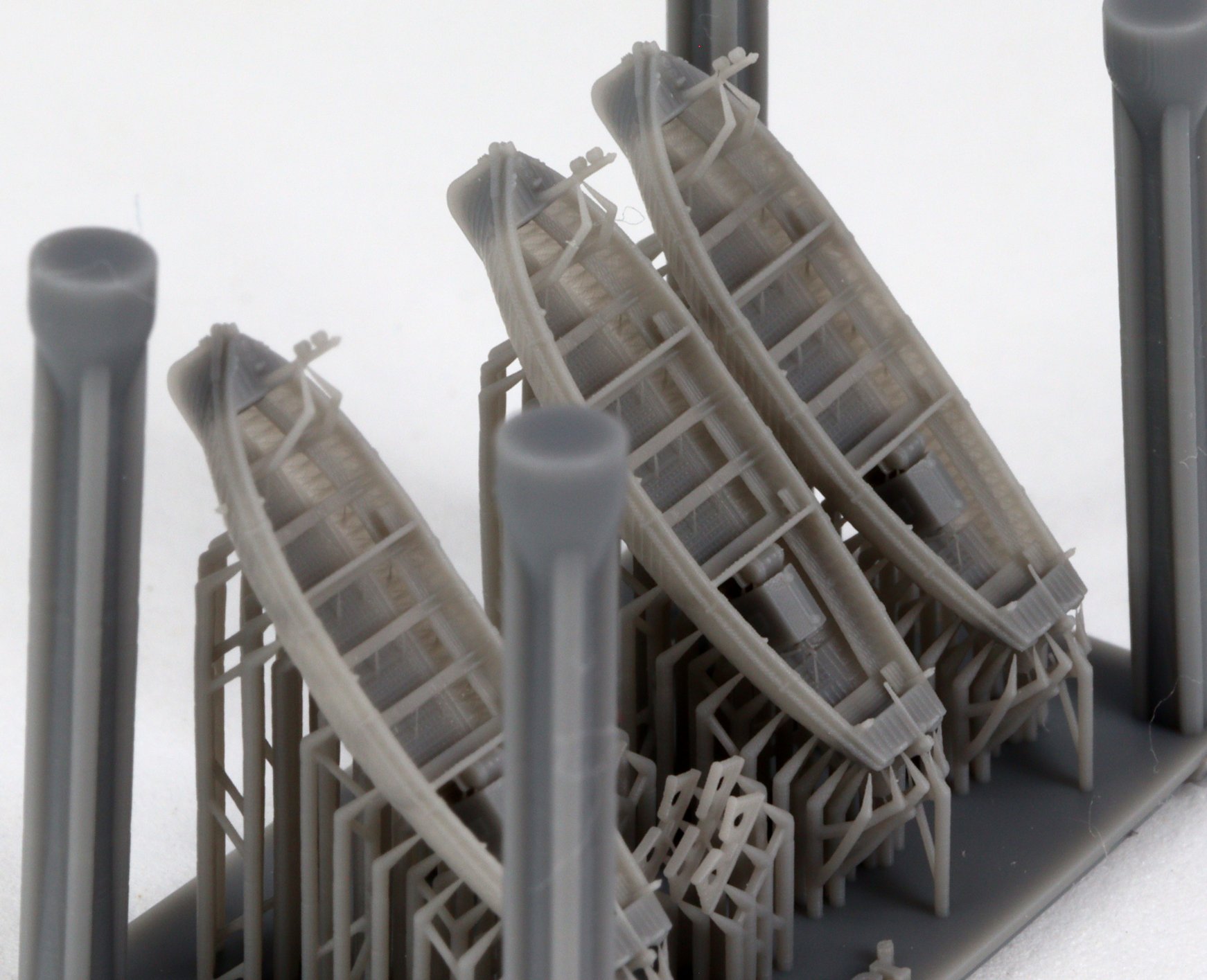

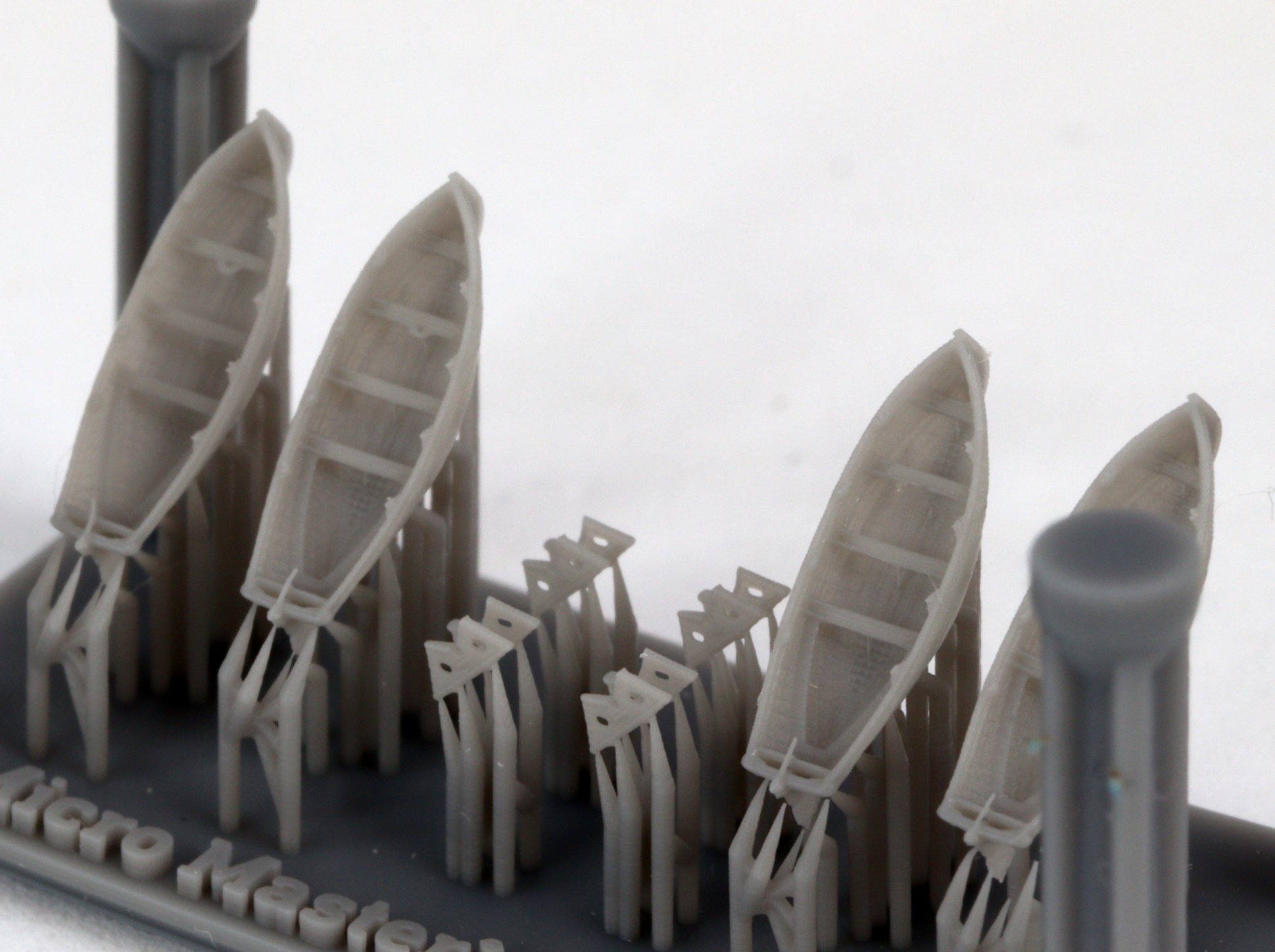

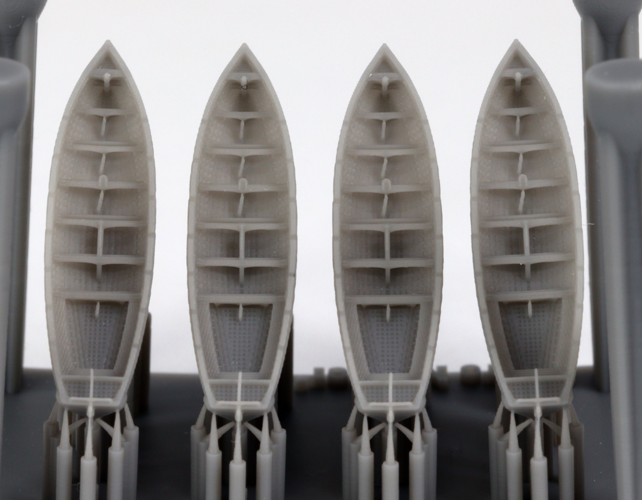

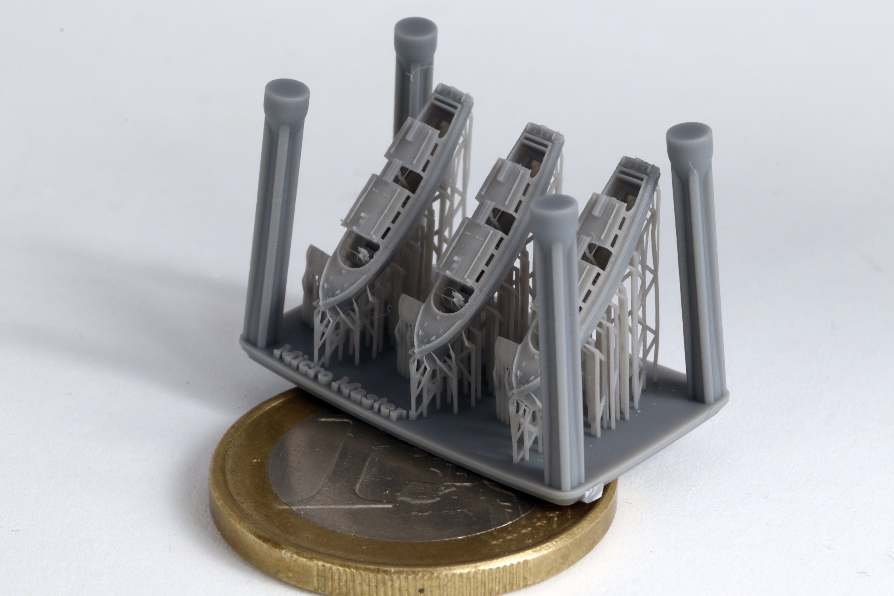

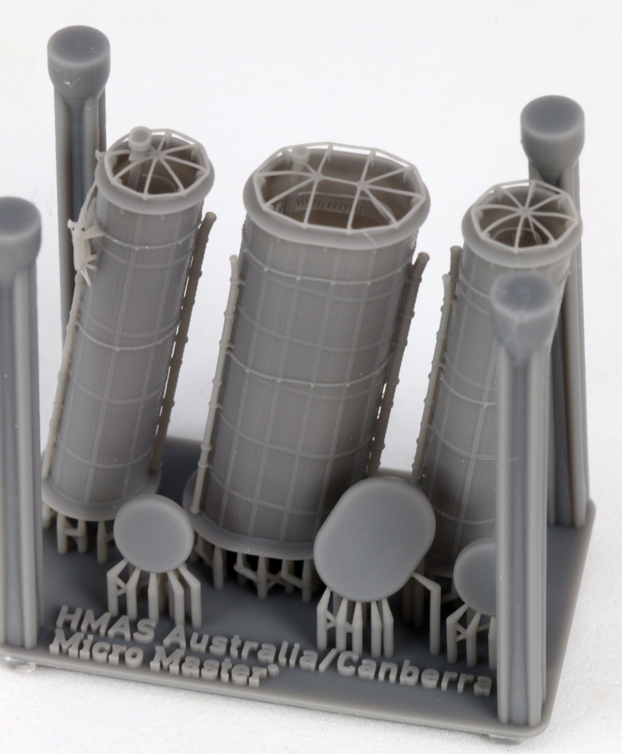

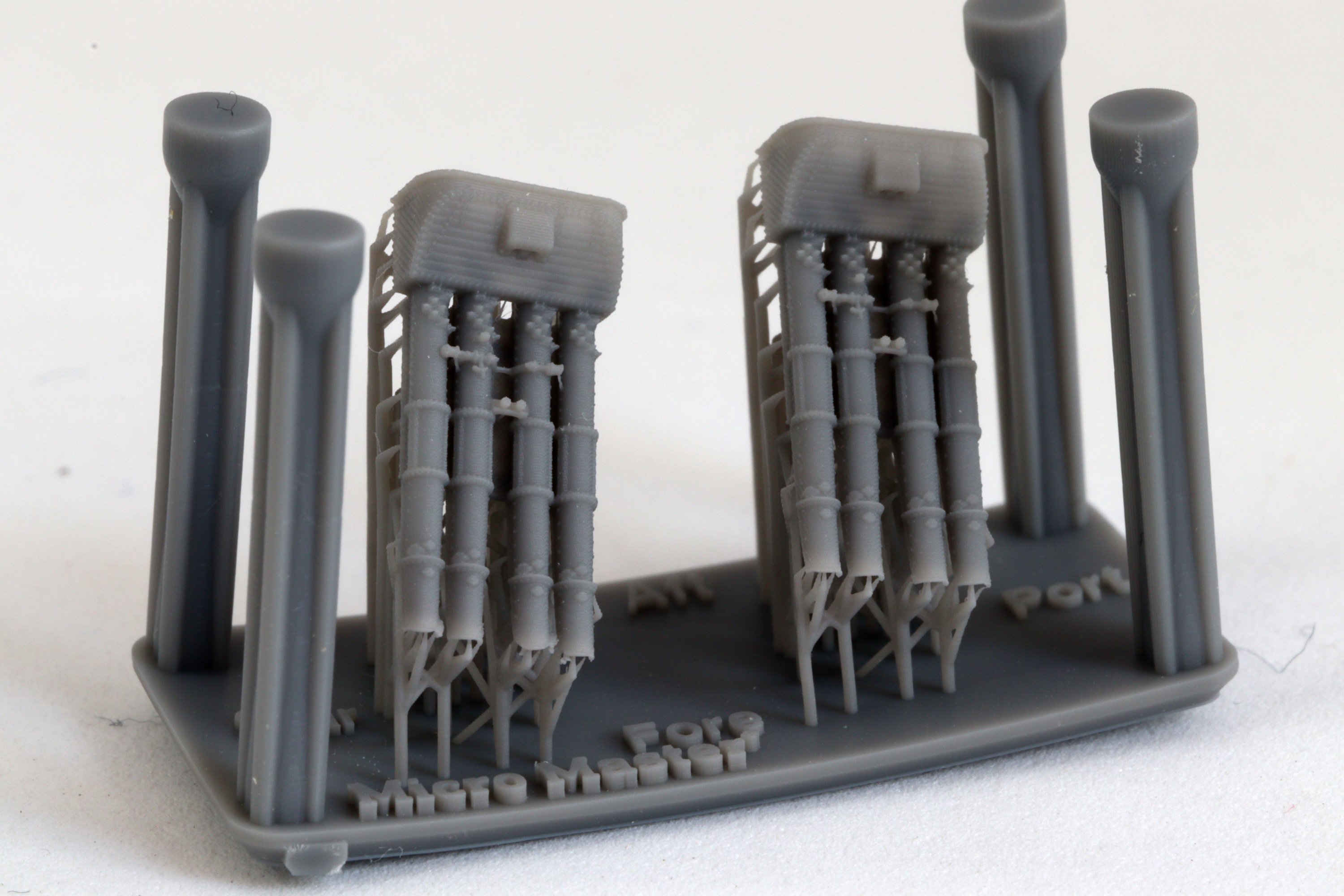

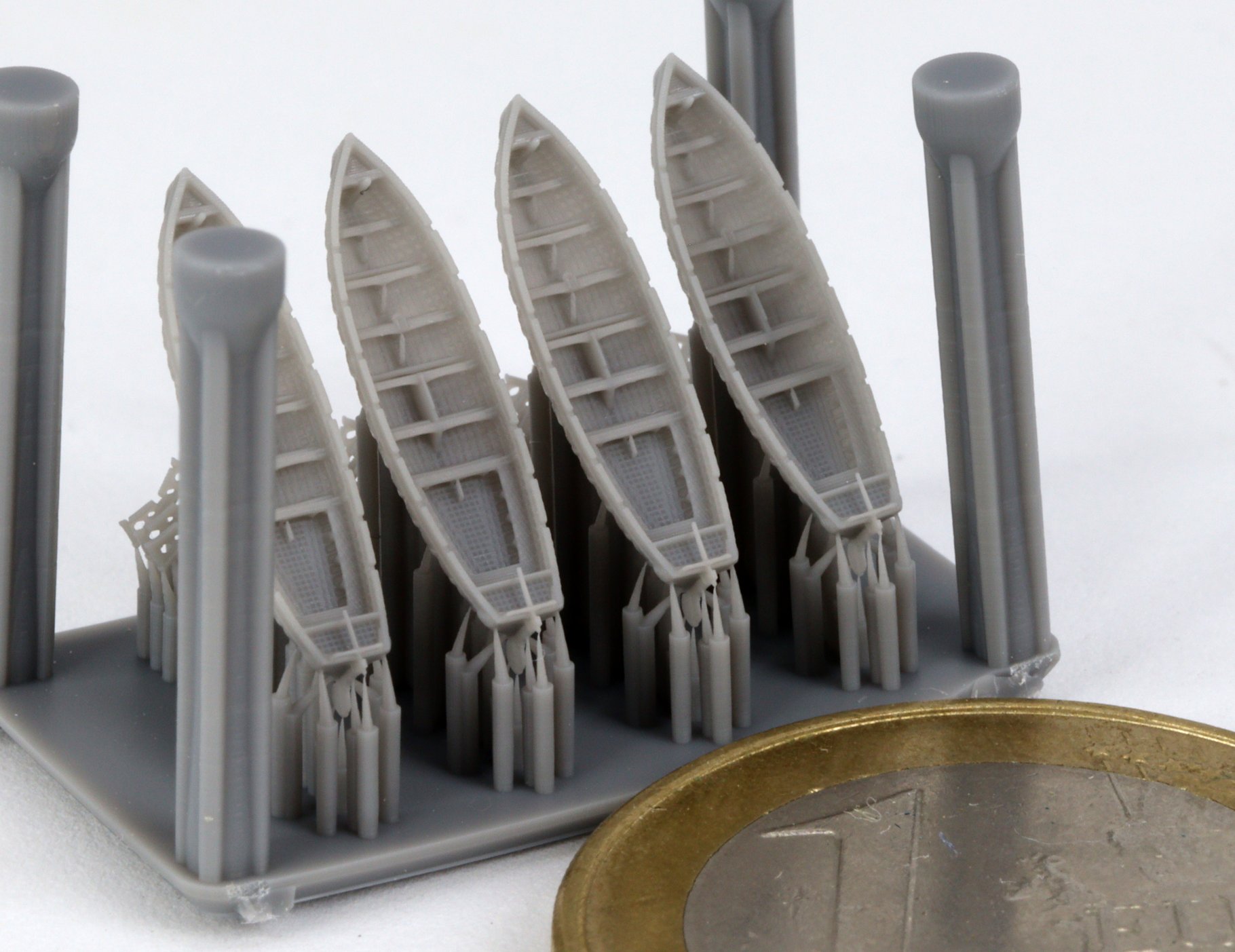

3D parts by Micro Master
Besides the enormous help by Brett Morrow the other main contributor to my project is Simon Percival of Micro Master. We´ve been in touch with Simon since the days of my HMAS Canberra project so it was only logical I asked him for help with the Australia.
All Simon´s 3D parts are being designed in very large scale with an enormous level of detail so they can be provided in any reasonable scale depending on the customer´s wish. The quality of Simon´s design and printing cannot be overstated, they are simply excellent, as can be seen on the attached photos. Remember this is all 1/700 so the details are really extremely tiny and stand out in the macrophotography. The print layers are OTOH actually invisible on those parts after painting and using appropriate weathering techniques.

PostPosted: Sat Feb 01, 2025 3:17 am
Posts: 289
Welcome back, Vladi! That's an incredible amount of details for such a small scale. Unbelievable what technology and fine design can do together. Is detachment of the pieces from the carrier complicated?
Looking forward to see the model assembled, am sure there will be some room for old fashioned scratchbuilding too. :thumbs_up_1:
PostPosted: Sat Feb 01, 2025 4:34 am
Posts: 749
Location: Czech Republic
Hi Stefano, thank you!
As can be seen on some of the close-ups, Simon has the supports extremely thin where they attach to the actual model, so they snap off really easily using Exacto or tweezers. He suggests putting the prints into the fridge to make removing supports easier, but that was never necessary in my case. Perhaps with larger scales the supports mave to be more substantial, I don´t know.
Hope I won´t let you down about the scratchbuilding - I´m using my PE in place of that, except if I made a mistake in the design :big_grin: or small cylindrical parts that are easier to cut off plastic rods than do from PE. That was in fact behind me starting with designing PE cause I disliked me not being able to become a good scratchbuilder, especially when it came to repeating parts.
