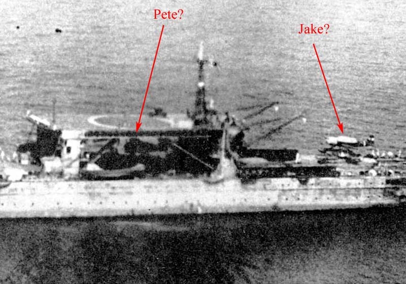

Some photos in her seaplane tender configuration. Credit Maru Special and Fukui. 1st photo is May 1942

Thanks for the pictures Dan. The first one shows indeed one Pete and one Jake and this matches her MI TROM "12 floatplane fighters and 4 scout seaplanes"
