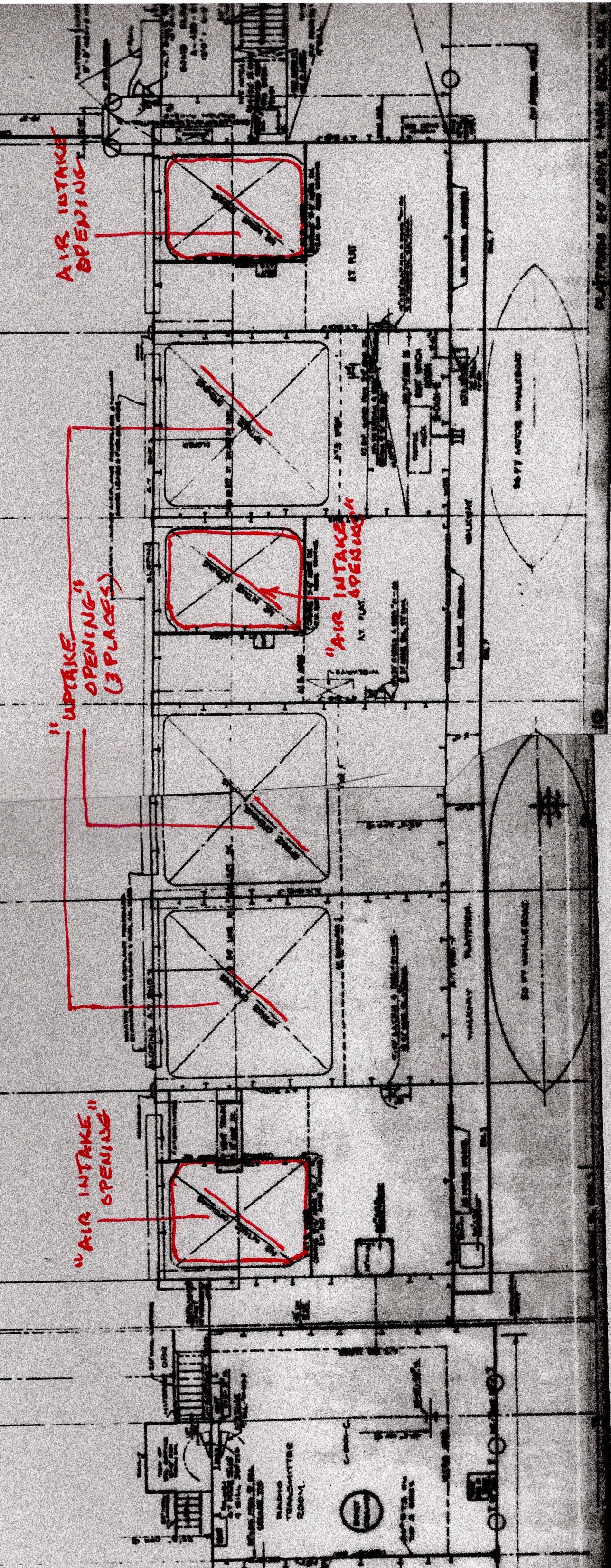

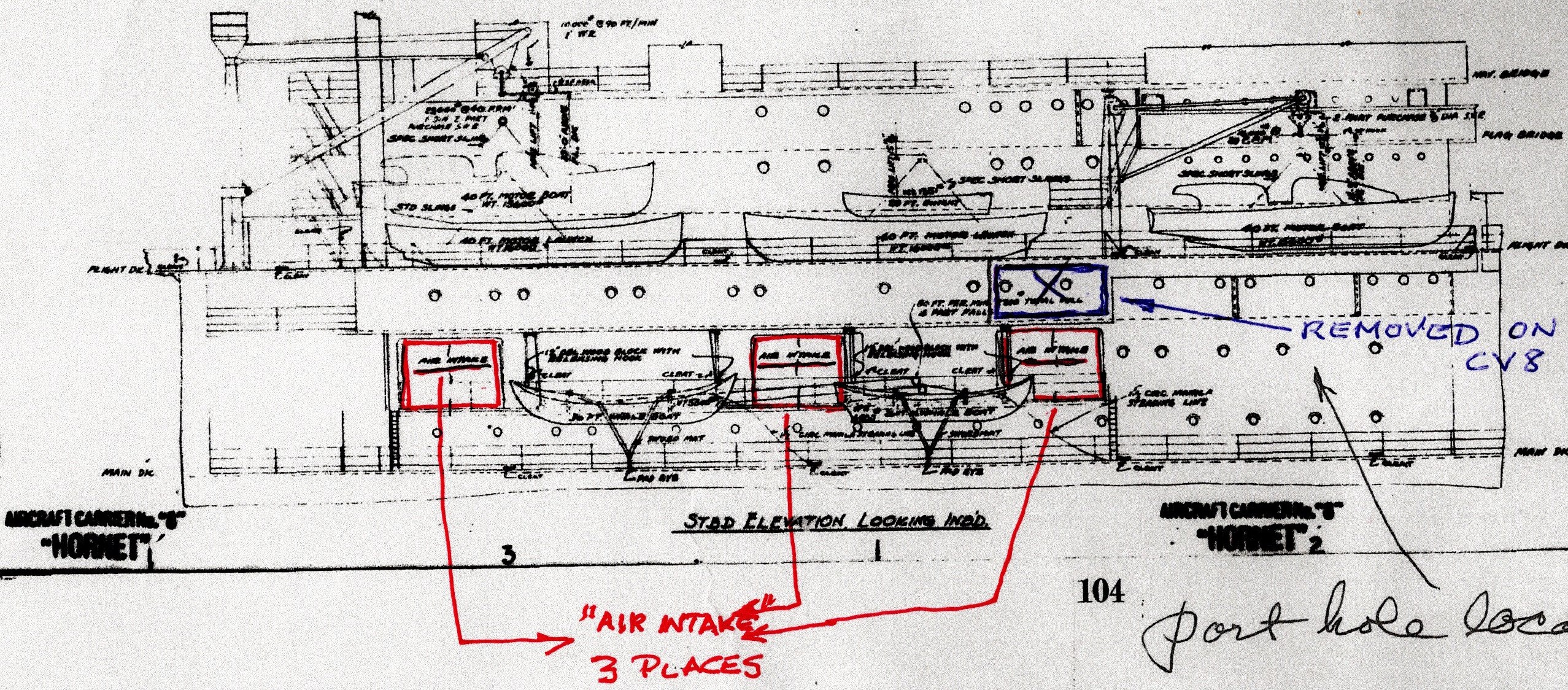

Good clean model there.
Note that the openings shown under the overhang are not roller doors like the rest of the doors on the hangar deck side bulkheads. They are air inlets for the boilers. I have never seen a photo where they are "closed". Easily seen on photos of HORNET launching Doolittle Raid: fairly heavy seas and all the visible roller doors are shut except those three pairs. More discussion on this in CASF HORNET CV-8 thread. They may have had mesh screen doors to keep sailors and seagulls out when steaming at flank. Careful looking at MD Silver Plans (HORNET plans I have do anyway) shows more details including location of air inlets for boilers inside those doors. Plans for CV8 are slightly altered CV5 plans so I assume CV5 and CV6 are same config as CV8.
Some annotation on original Blueprints may be hard to see so I have highlighted in colored pen what annotation says.
Keep up good work.

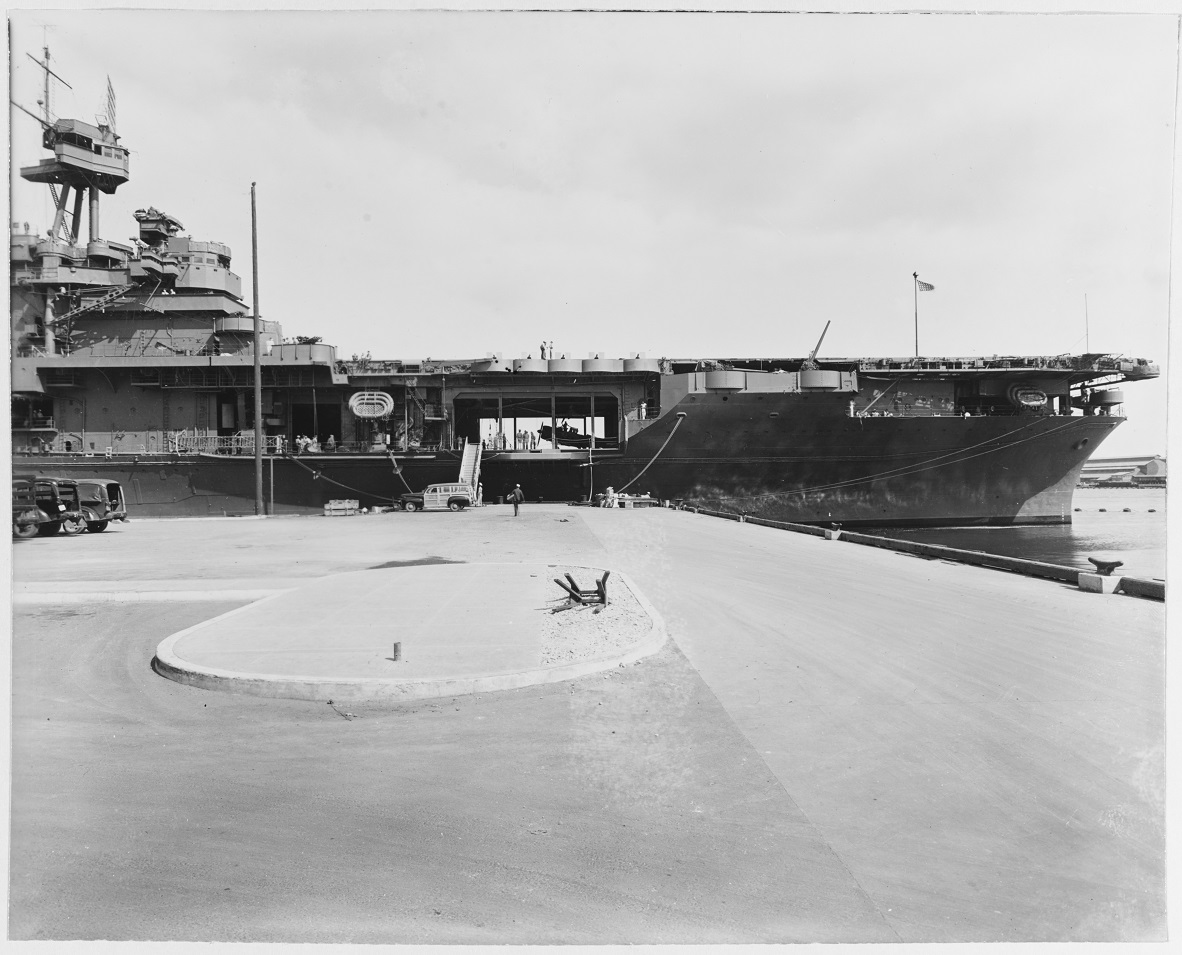

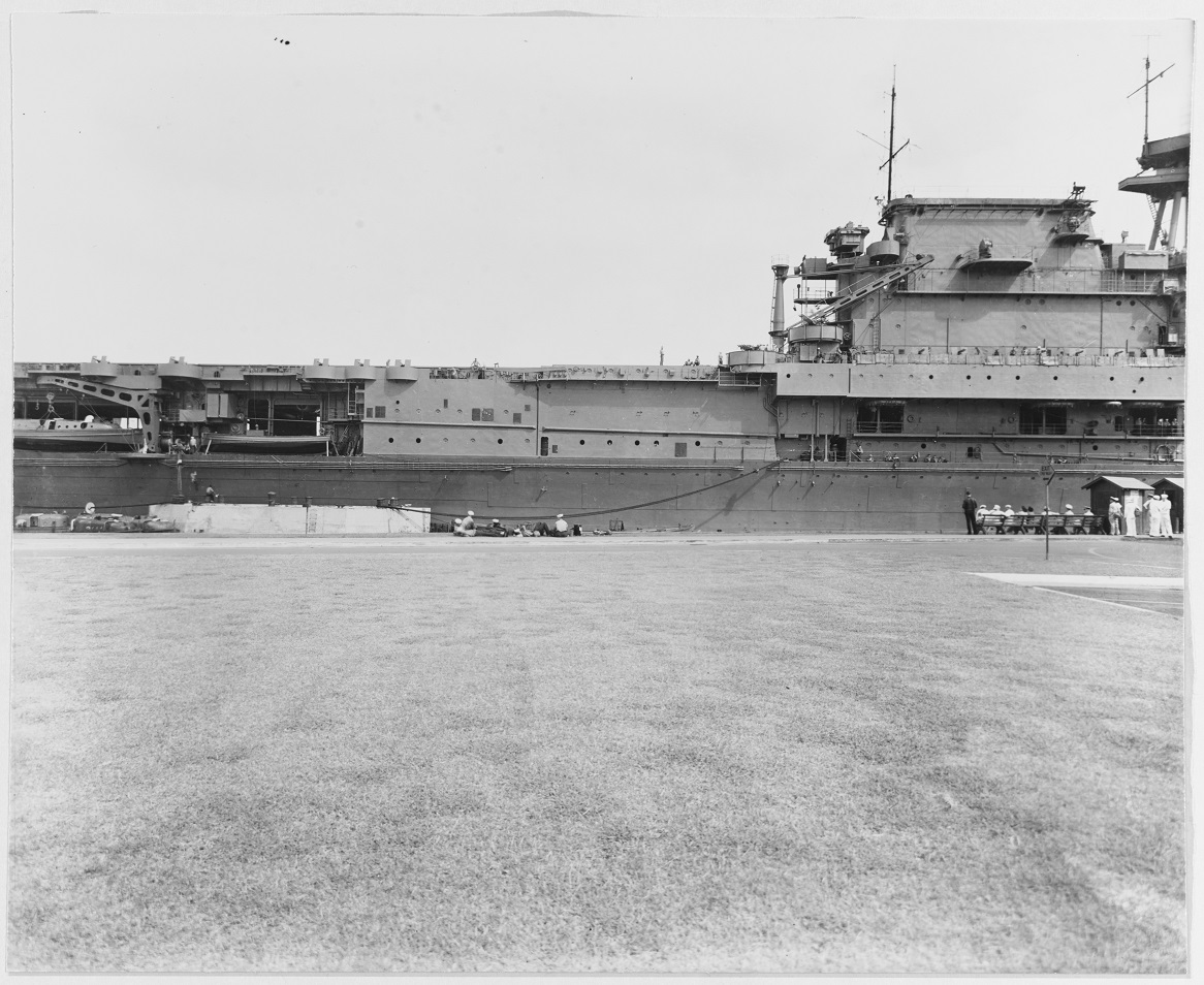

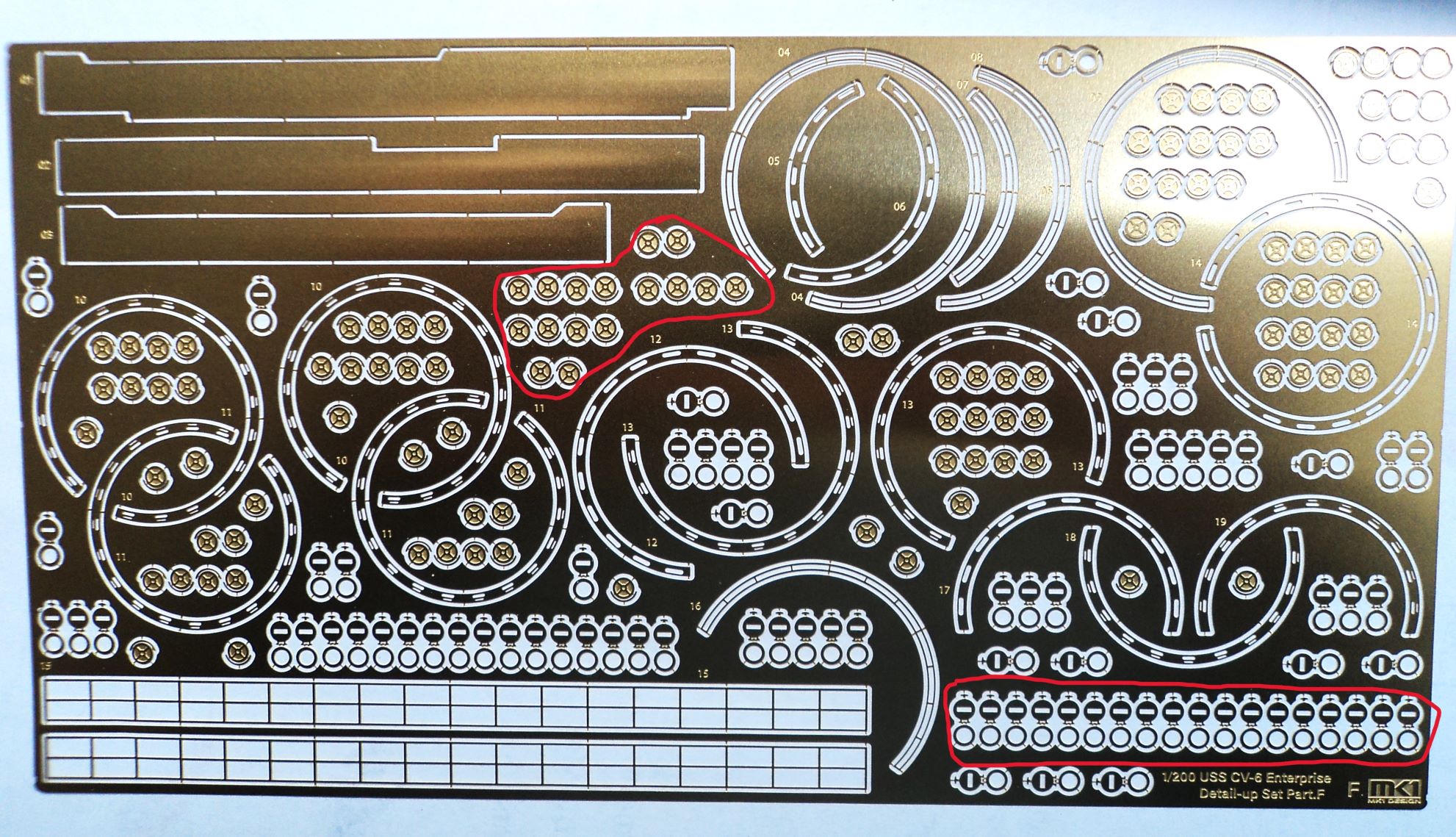

Regarding Portholes on the Midway era CV-6. I know that a lot of the portholes below the hangar deck were welded over with plates, however, in the images attached I can see that on the starboard bow area, the overhang below the Island Structure, and the portholes below the hangar deck seem to be recessed with a cover in the recess with an "X" on them. I suspect that they were able to open these from the inside of the ship during non general quarters or darken ship conditions. The Trumpeter 1/200 Enterprise hull, which in effect is actually labeled as the 1/200 Hornet, has modeled the portholes as recessed. Sadly, the uppermost portholes on the focsl are molded elliptical, due to the molding process. Attached is a crop taken of the island structure after the 1943 Refit": on the back of the "Yorktown Class Carriers" by Steve Wipers "Warship Pictorial" Series, that shows the location of the portholes on the lower forward Island Structure. I suspect that these portholes were there as constructed. Note that the porthole covers are open and adjustable; but have no view slits. The KA/MK.I PE set provides these portholes, but with a view slit and what appears to be the inside of the recessed portholes with the "X" on them; at least that is my impression as the instructions don't identify them nor do they show any location. To me, the modeler has several options, 1. leave them as is, 2. drill them out and place the "Inside" portion of the porthole, drill out the elliptical portholes and place place the inside portion with the "X" on these only. The PONTOS PE Set provides the modeler with the porthole outline with ringols. Also, KA/MK.I provides a porthole with attached porthole cover with a view slit, that can be displayed in the open position, as shown in the image of the island structure after the 1943 upgrade. My plan is to use the ones with the view slit on the superstructure as it adds interest to the Island, leave the majority of the portholes as is, drill out the elliptical portholes on the forward part of the hull and place the covers with the "X" behind them. Modelers dilemma: thoughts?

Your first two photos were taken prior to Midway. After that battle, the row of ports just below the degausing cable appear to have been covered by steel disks, just as was done on Hornet at the same time. After 1943, many of these were covered by the blisters. Ports in the island were not subjected to the same water tight treatment.

Thanks John, after carefully check photos, you are right, always open, I'll change that.

Thanks for that information Dick: That clears up a lot of questions as to the fit prior to and during Midway. Most helpful.

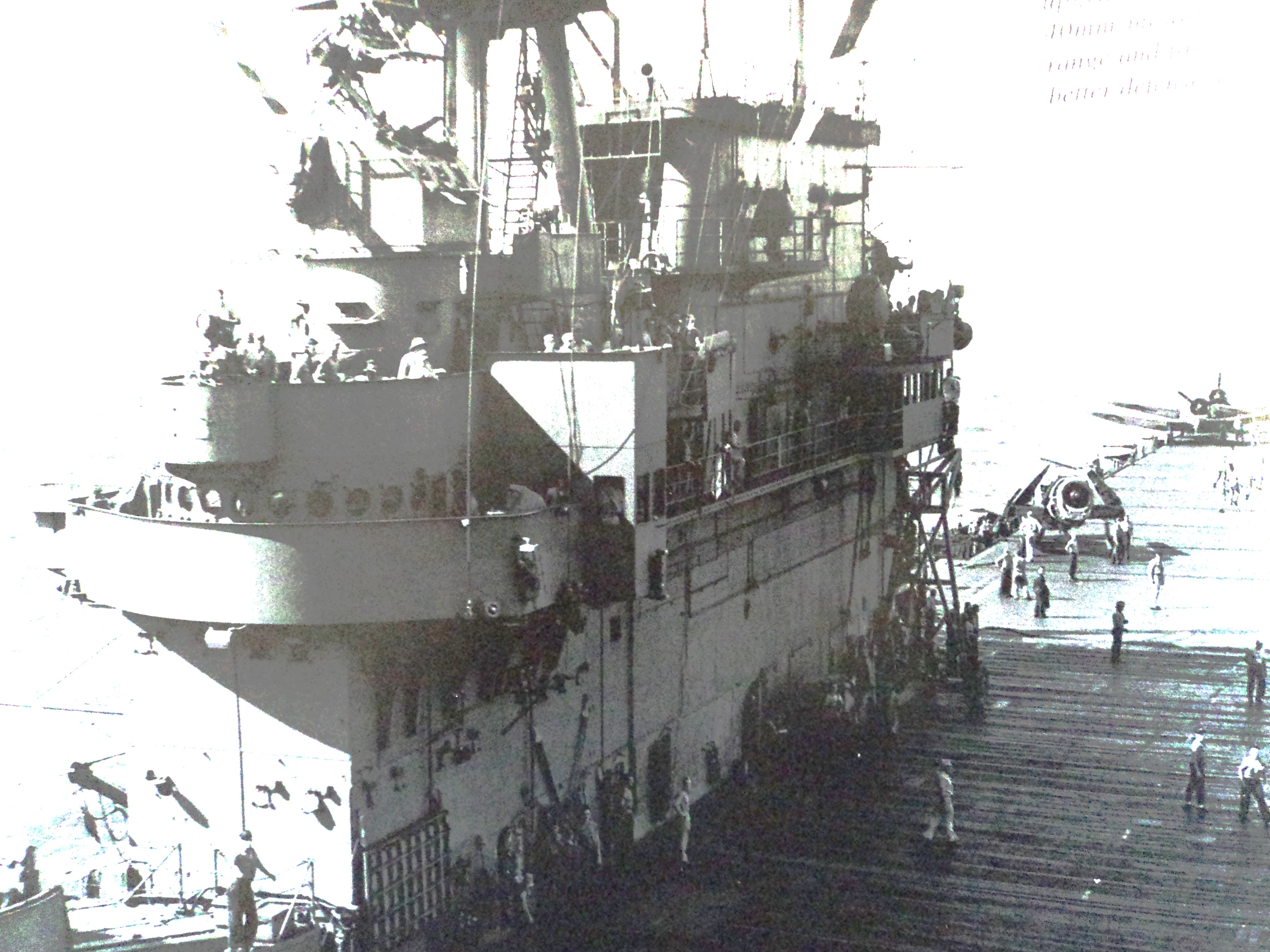

The actual catapult overhung the deck edge significantly, as seen in this photo of Yorktown.
https://www.navsource.org/archives/02/020544.jpg
That overhang is why the guard was found to be necessary. The catapults were totally removed, as demonstrated in the following photo of Enterprise, damaged and returning from Eastern Solomons. The angle of this photo would highlight the catapult if it were present.
https://www.navsource.org/archives/02/0206bf.jpg
The removed catapults were shipped back to the mainland for reuse in CVE's.

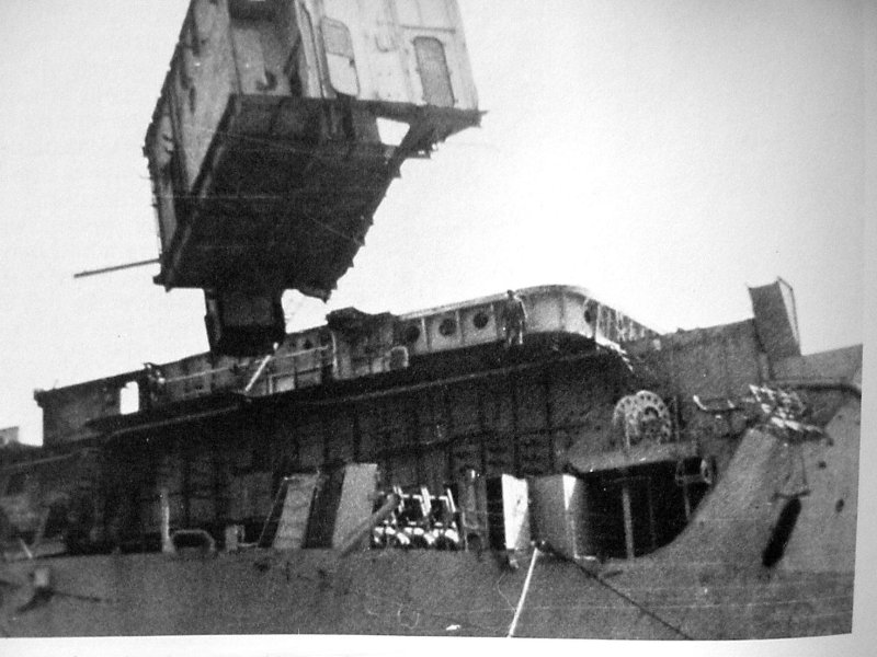

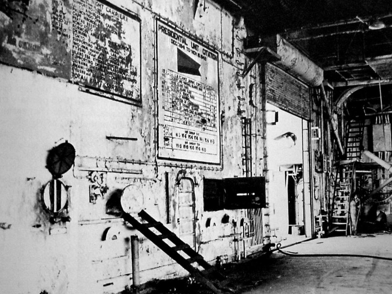

It's a pity that this operation to save this mythical ship didn't succeed after its exceptional fate during WW2.
It was well worth it!
On this day in 1958, the USS Enterprise (CV-6) made her last voyage from the Brooklyn Navy Yard to the scrapyard in New Jersey.
Admiral William Halsey led a campaign to preserve the Big E as a museum, but the campaign failed to raise enough funds to save the aircraft carrier.
