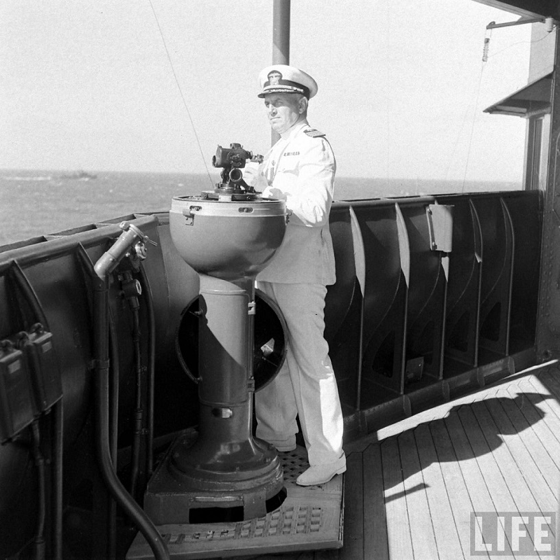

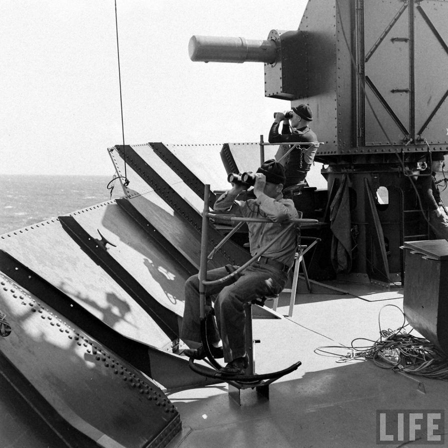

PostPosted: Sat May 14, 2016 10:19 pm
Posts: 1975
The Life Magazine collection had a couple of shots of Portland's bridge interior in 1941/42.
PostPosted: Mon May 16, 2016 6:38 am
Posts: 4046
Here are some photos that may help (if you already haven't seen them). The detail is pretty neat.
Indy:
Life photos that Dick may be referring to. Portland:
Use caution when viewing Life photos because many of them were reversed left-to-right before publication!
Have fun, Monkey around.™

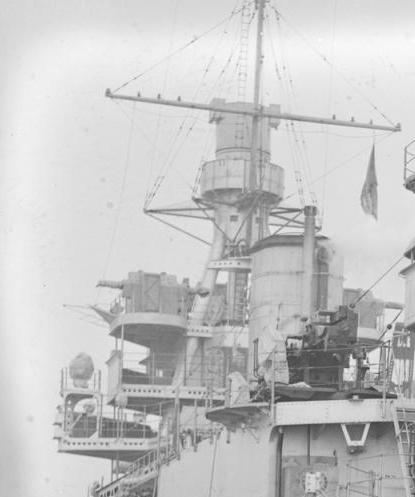

PostPosted: Wed May 18, 2016 8:12 am
Posts: 4046
These are Portland, not Indy, but they may help since prewar the two ships were more similar, if not identical. You may have already seen these, but if not, here you go. Loads of detail visible in these.
All photos from Getty Images, among other things a repository for classic Life Magazine photos.

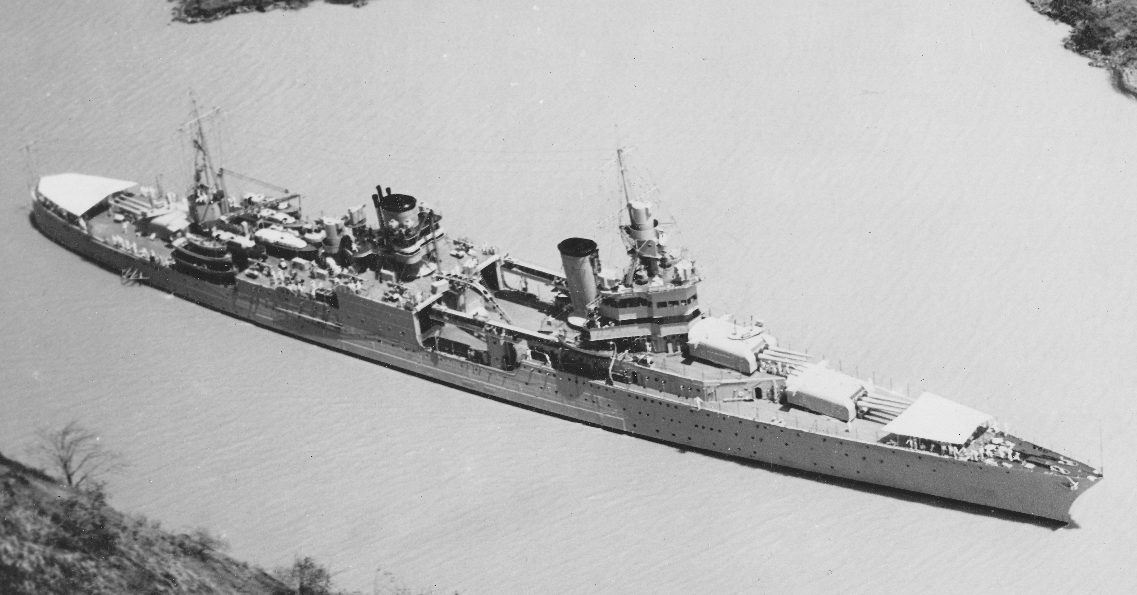

PostPosted: Thu May 26, 2016 11:09 am
Posts: 8349
Some of Indy...
