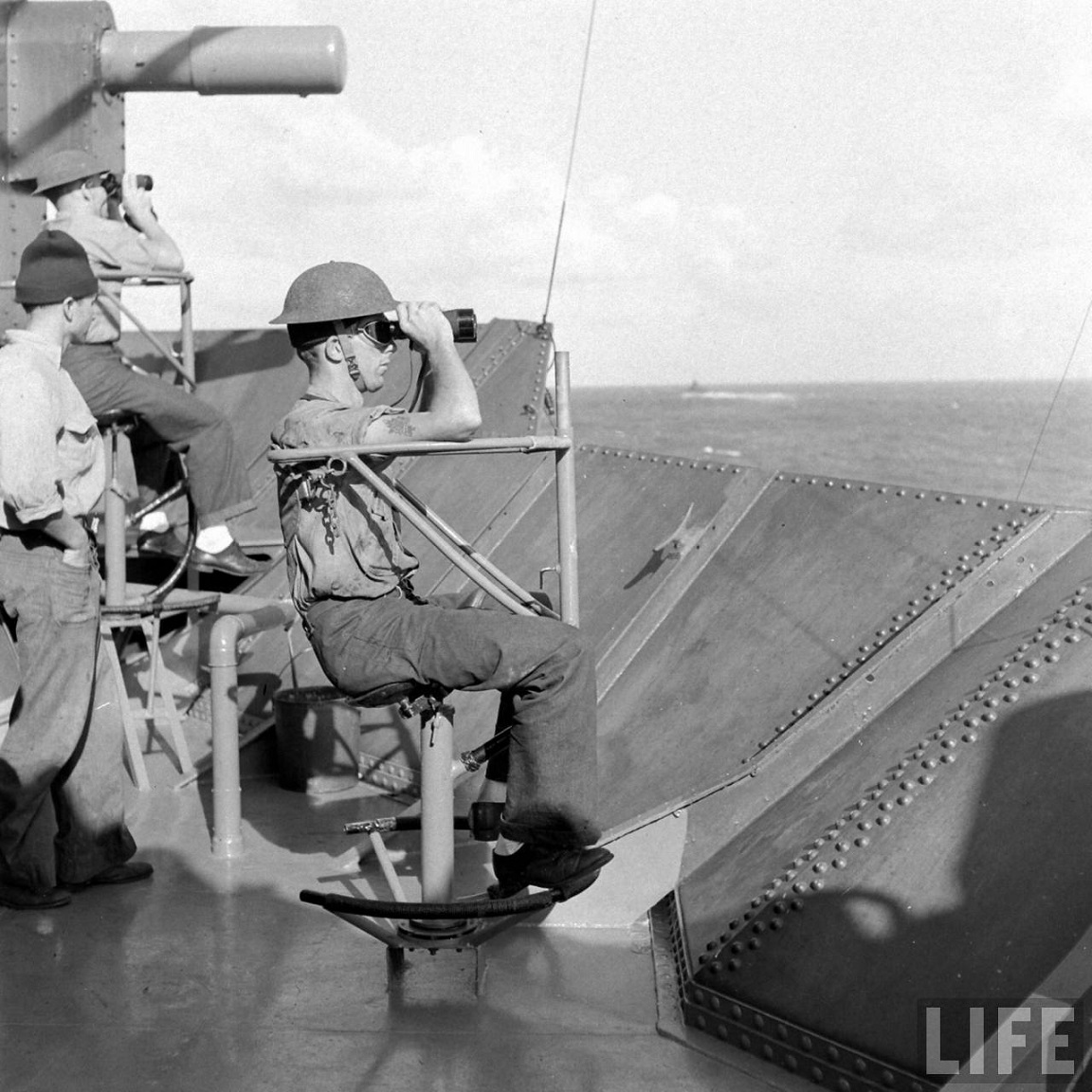

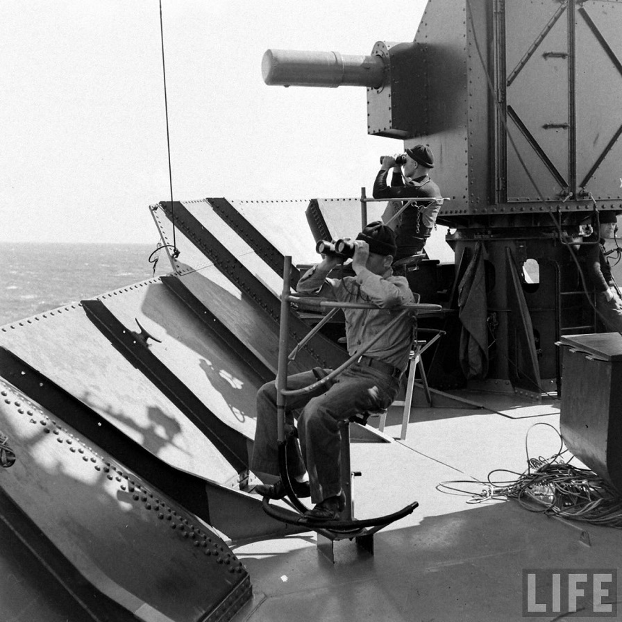

Here are some photos that may help (if you already haven't seen them). The detail is pretty neat.
Indy:
Life photos that Dick may be referring to. Portland:
Use caution when viewing Life photos because many of them were reversed left-to-right before publication!

Thank you! I'd seen the first one, but not the others. With those and the minimal data on the plans, I should be able to gin up something that looks reasonably accurate. The shapes on this bridge are far more complex than the photos indicate. It seems like everytime I examine the plans and photos, I find something new that I missed!
