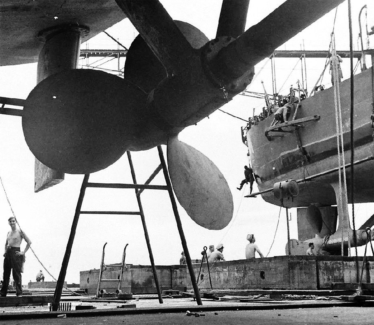

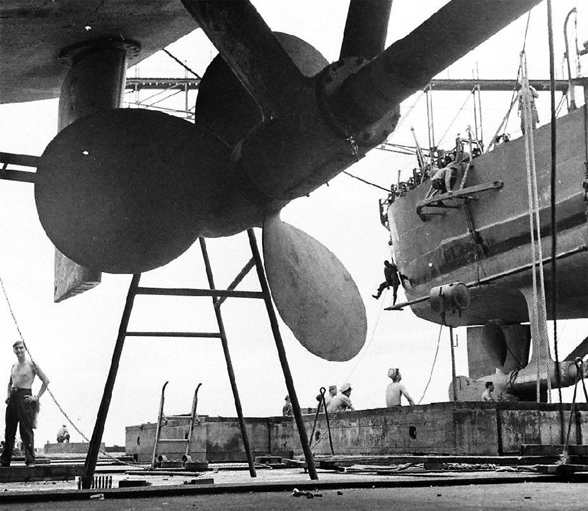

Speaking of Sonars, I need to research the sonar for these DE's, though at 1:514 it's terminally dinky. But if I do construct a larger model, likely something that can be accurately replicated. I did find a dry dock photo showing the three blade prop and one of the rudders.
Note especially the way the rudder pivots and the direction of rotation of the props, which seems typical Destroyer practice.
PostPosted: Tue Sep 13, 2022 7:11 am
Posts: 1813
Fliger747 wrote:
Note especially (...) the direction of rotation of the props, which seems typical Destroyer practice.
Well, the props seem to turn outward -- which is very standard IMHO. The opposite would have been really uncommon.
Roger Whittaker +9/13/2023
PostPosted: Tue Sep 13, 2022 11:24 am
Posts: 5060
Indeed the destroyer in the background shows the same directional convention. Fortunately in printing props one can mirror them in the slicer. At this scale the blades are extremely thin and I destroyed several installing them.

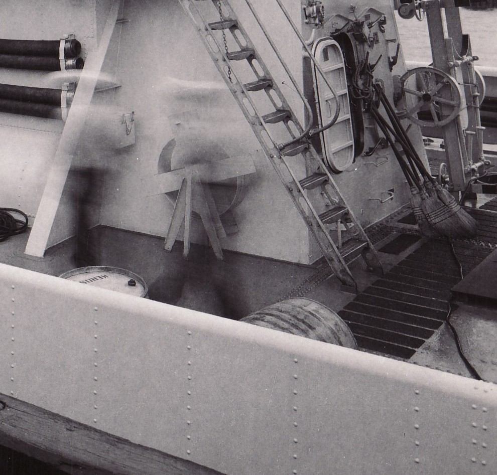

Whitehurst and a number of the TE- DE's have an oil tank, maybe 50 gallons or so, on a stand on the main deck at the aft most part of the deckhouse, portside. Anyone know what this was used for?
Thx
PostPosted: Fri Nov 04, 2022 1:01 am
Posts: 3841
Likely it was fuel for the ship's boat.
PostPosted: Fri Nov 04, 2022 12:37 pm
Posts: 5060
Certainly a possibility for boats fuel though i find no evidence of a coiled hose or other dispensing equipment nearby, and quite far from the boat. I presume during the war the TE's burned bunker crude which would not have been useful for powering the boat. That it's referred to as an oil tank rather than a Diesel tank may or may not mean anything.
Anyway, thanks, a good possibility that I had not considered!
PostPosted: Sat Nov 05, 2022 4:51 pm
Posts: 5060
The mystery oil tank. Perhaps useful for aging torpedo juice?
PostPosted: Sun Nov 06, 2022 1:17 am
Posts: 3841

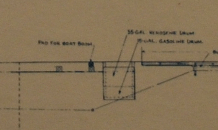

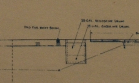

This tank may be for cooling water for the quad 1.1-in mount, but I doubt it. I have not studied the design of DE's, but on FLETCHER's built with the quad 1.1-in mount, the cooling water tank and pump were located below deck under the mount. Since it apparently was labeled as OIL TANK, that is probably what it held. But, for what purpose I don't know.
The "drums" I was thinking that Tom was referring to were the drums of fuels for the ships boats and other fluids that they didn't want to store below decks as a hazard. The drums were located at the deck edge, for easy jettison. Like this installation on BENSON class destroyers (in this case pre-WWII).
These deck edge drum stowage seemed to disappear during the war. Where they were stowed I don't know. In this 1941 image, you can see the two drums (for gasoline and kerosene) were sitting on the deck awaiting stowage.
PostPosted: Sun Nov 06, 2022 1:45 pm
Posts: 3102
Location: Mocksville, NC
Generally speaking, if a piece of equipment or tank, etc. is labeled specifically (such as "oil", "feed water") it contains exactly that - I too doubt that the cooling water tank/pump for the 1.1" quad above would have been stowed in an exterior (vulnerable) location. I wonder if it's possible that's a "lube" oil tank used for replenishing small oil cans, etc. for use in equipment maintenance.
