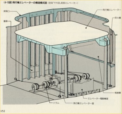

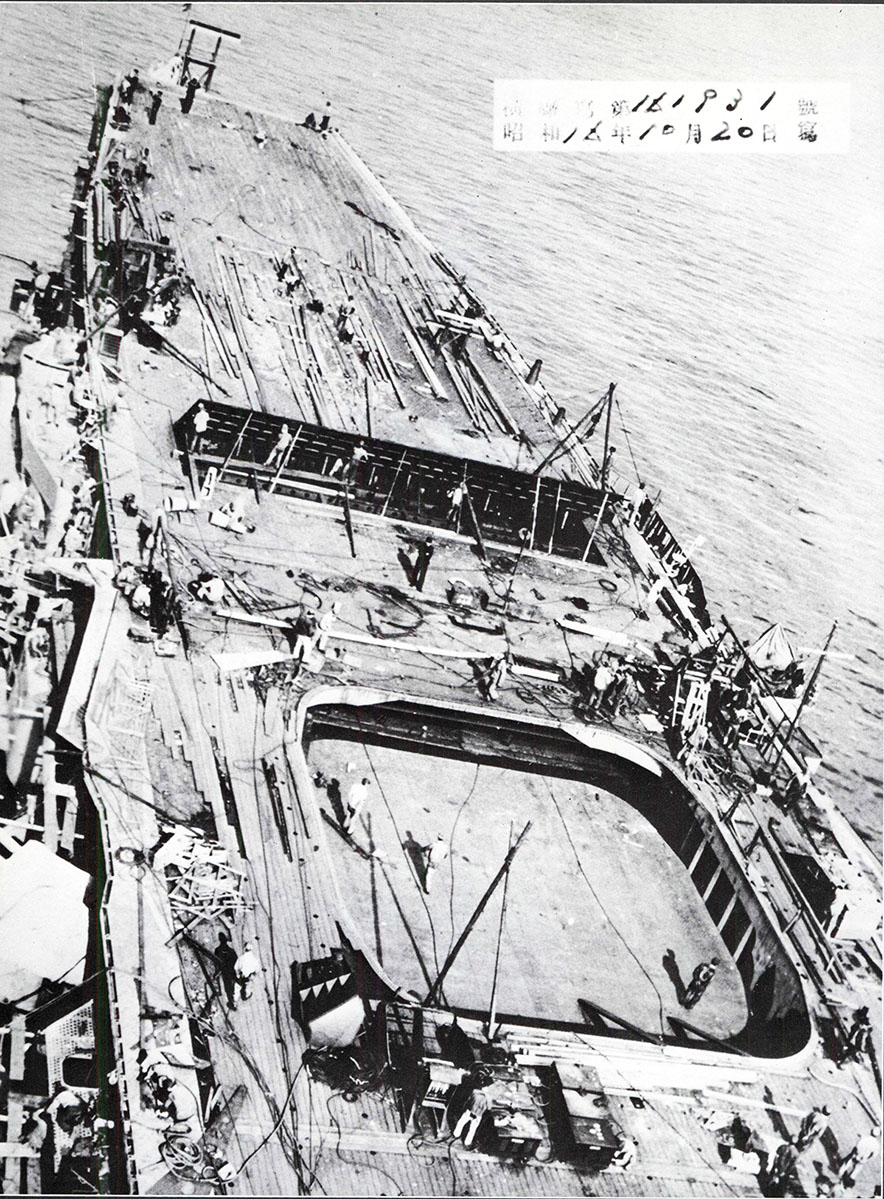

FWIW, I did a great deal of research for my Taiho and Hiryu wells. The documentation is a little sparse, and there is some variation betweeen types, but I feel that what I have created for my 1/350 Hiryu remains a fairly accurate representation of the wells themselves.
Even this diagram for Junyo doesn't match 100% the reality. There are large support pillars beyond the guide rails at each corner that seem to help anchor the whole shaft where it meets the hangar decks.
The camo discussion can be discussed as that time gets closer.
CV Junyo Elevator drawing, Gran Prix Shuppan volume.jpg [ 110.85 KiB | Viewed 5297 times ]

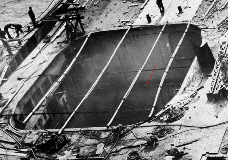

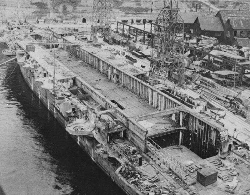

For my Amagi, I also had to construct part of the elevator wells. In addition to the Junyo pic, I found these 2 pics of Kasagi useful too:
And zooming in on the last pic:
Steven, the verticals you have constructed are the guide-rails for the counterweights (the rectangular blocks in between them in the first pic). To their left and right (towards bow and stern), there were support pillars to anchor the elevators at their 4 corners as Dan explained.
The other photo shows that the exact location of these varied, even in one ship, as did the finishing towards the flight deck. I think this was at least partly because of the varying shapes of the elevators: the counterweight guide rails and support pillars can only be located where the elevators are at maximal width.
Anyway, great work on the elevator wells so far Steven! :thumbs_up_1: :thumbs_up_1: :thumbs_up_1:
But one more thing: as you see on the pics, you will need to add a solid wall behind the mechanism too, and counterweights between their rails. When the elevators were down, these counterweights were up and thus visible. They were attached at the top with cables.

Marijn and Dan, thank you for the nice elevator illustrations, I get a better understanding of it now. Marijn, I agree with the extra lines and I hadn't mentioned the windbreak because I had just put it there. But on the last picture you made an error, you got the deck upside down. This is visible at the stern port side dark arrow point I mentioned earlier. So the stern is down on the picture and the zone you indicated would be on the left. That makes some things more clear that were obscured on the large picture, like the light backward-pointing arrow before the dark one.
I also see a sound base for the "grill shapes" on the picture taken backwards from the plane. If you look carefully next to the rudder of that plane, you see the dark lines crossing the deck marking stripes. Another grill is visible on the bow elevator floor on your color picture. Therefore I'll go with the masking.

Lovely work on the elevator, Steven.
To digress a little into minutiae on the references.
Dan, could this mismatch come from the diagram being titled "Chiyoda forward elevator"? Or have you found that the diagram was mis-titled (or am I missing something else)?
Marijn, could the "strange shape for a mast shadow" come from the ensign flying from that mast? The smoke makes me think that the wind is blowing in a direction that would spread the ensign in that direction, and the type 13 radar on the mast would make its shadow a bit "thicker".
Thanks for sharing all of this
George

I would caution against placing too much reliance on the appearance of the elevator wells from the CVLs. They were typically placed at the far ends of the hangar (also like Taiho) deck, with one end running up against a bulkhead. So, for some reason, as often as not, there is a certain assymmetry to the underlying support structures. See the Shoho pics below. The CVs had one or more elevators that opened onto a hangar deck on either side, necessitating a stronger supportive structure where the hangar and flight decks interfaced with the well.
The diagram above is from the Gran Prix Shuppan volume on the IJN CVs, and is is definitely for Junyo.
Shoho elevator well during conversion, 10-41, SOTW V248, p23.jpg [ 99.44 KiB | Viewed 5224 times ]

Regarding the mast shadow in that overhead pic:
I believe it is a shadow, given that Zuikaku's island throws a shadow in the same direction. Note that Zuikaku's yardarms had been re-arranged after a bomb hit damaged the mast at the Phillipine Sea. Where as the yardarms had originaly been horizontal and perpendicular to the axis of the ship, they were subsequently angled back and slightly upward, in the same manner as that of the Unryus. This would account for the dogleg shadow, along with a flag. and the Type 13 radar up there.
