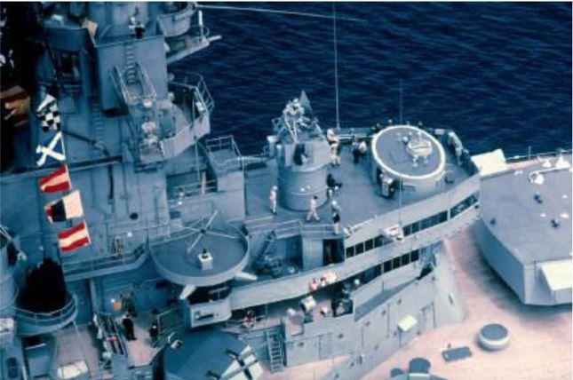

Just to make sure you understand that the helmsman is INSIDE the armored barbette - the helm and lee helm are NOT outside in the pilot house. So, if you took a picture of the helmsman looking back, your picture would be of a curved, steel bulkhead. The walls of the armored barbette are 17" thick and its an oval shaped tube that extends up THROUGH the pilot house to the 05 Level above the pilot house.
BB62 OverHead View of Pilot House & Armored Barbette 1968.JPG [ 56.61 KiB | Viewed 6780 times ]
This was taken in 1968, but the barbette & helm haven't moved an inch since then!!
Just thought I'd let you know :thinking:
