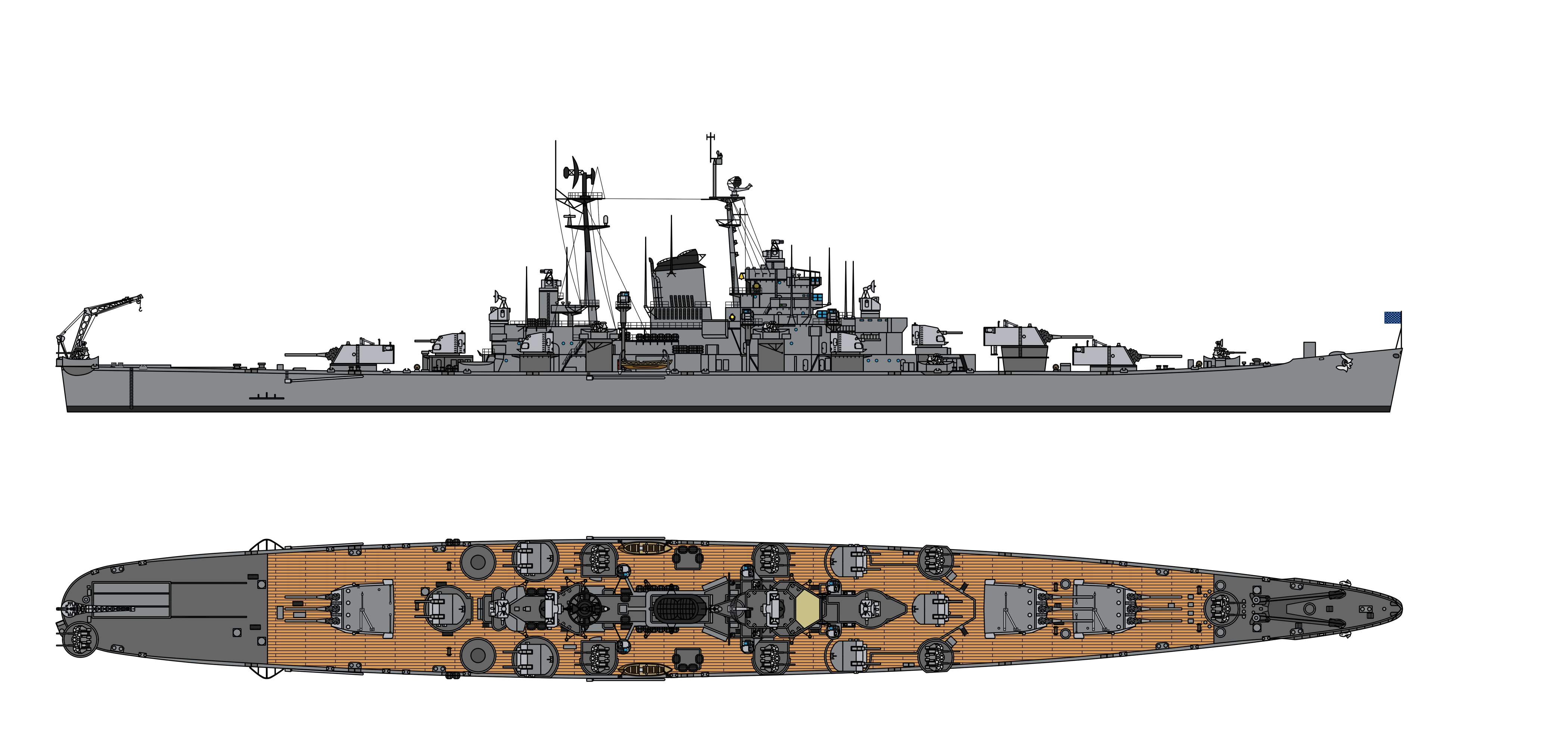

Here are my drawings of 4 units of the classes:
CA-68 USS Baltimore as looked like in 1944/45:
and CA-132 USS Macon as looked like in the early 1960's say 1960/61 (What I was able to determine from photos):
CA-122 USS Oregon City as looked like in late/post war in 1945/1946:
and CA-124 USS Rochester as looked like in the early 1960's say 1960/61 (What I was able to determine from photos):
I hope they are accurate.

Excellent! Thanks! I think it helps with the colors.

The stern of the Macon should look more like that on the Rochester, with the off-center hangar hatch and more rounded deck. In the late 1950's, she even had the starboard side twin 3" mount on the stern. That was removed in order to install a Regulus missile launching system. The mod included sponsons for the launch and changing the hangar hatch to slide sideways, as seen in this shot of the Los Angeles: https://www.navsource.org/archives/04/135/0413506.jpg Only the first 4 Baltimore's, with the two cranes, had the more square stern. The switch to the single crane caused them to round off the corners of the stern at the deck level in order to help hoisted aircraft avoid bouncing into the corners of the deck. Ironically, when the twin 40MM were installed there, it negated the benefits of rounding the stern. The waterline remained more squared off, giving the complex contours characteristic of the later Baltimore's, the Oregon City's and the Cleveland variants. The off-center hatch also was part of the "round stern, single crane" mod starting with Pittsburgh.
PostPosted: Sun Dec 25, 2022 11:04 pm
Posts: 1677
The round (a circular arc) stern at main deck level and square (ish) stern at the waterline is something that some modelers miss.It is tricky to model.
