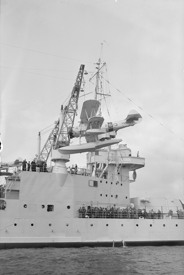

I think these pictures of CA-36 in Helsinki Finland have not been published here before. I'm planning to build a diorama of her in the narrow Kustaanmiekka strait. According to the archaive the pictures are from 1934, but this clearly is wrong. Any idea when she has been touring in the Nordics?
Please click on the pictures you find from links below to get full reso (you can download tiff)
PostPosted: Mon Nov 15, 2021 2:37 pm
Posts: 12326
She conducted her shake-down cruise "in European waters during July to September 1934", according to her DANFS entry, so I don't see an issue with the 1934 date? https://www.history.navy.mil/research/h ... is-ii.html
PostPosted: Mon Nov 15, 2021 2:39 pm
Joined: Mon Jan 10, 2005 6:54 pm
Posts: 266
Location: Milwaukie, OR
1934 should be correct. Minneapolis transferred to the Pacific in April 1935.

PostPosted: Mon Nov 15, 2021 4:31 pm
Posts: 1975
For the ship to be Minneapolis (not doubting the ID), the photos would have had to have been taken in 1934. The communications bridge below the pilot house is still open. By 1935, the deck had been raised by 1/2 level and it had been semi-enclosed. New Orleans was the only one of the original 5 to not have the comm bridge glassed in.
