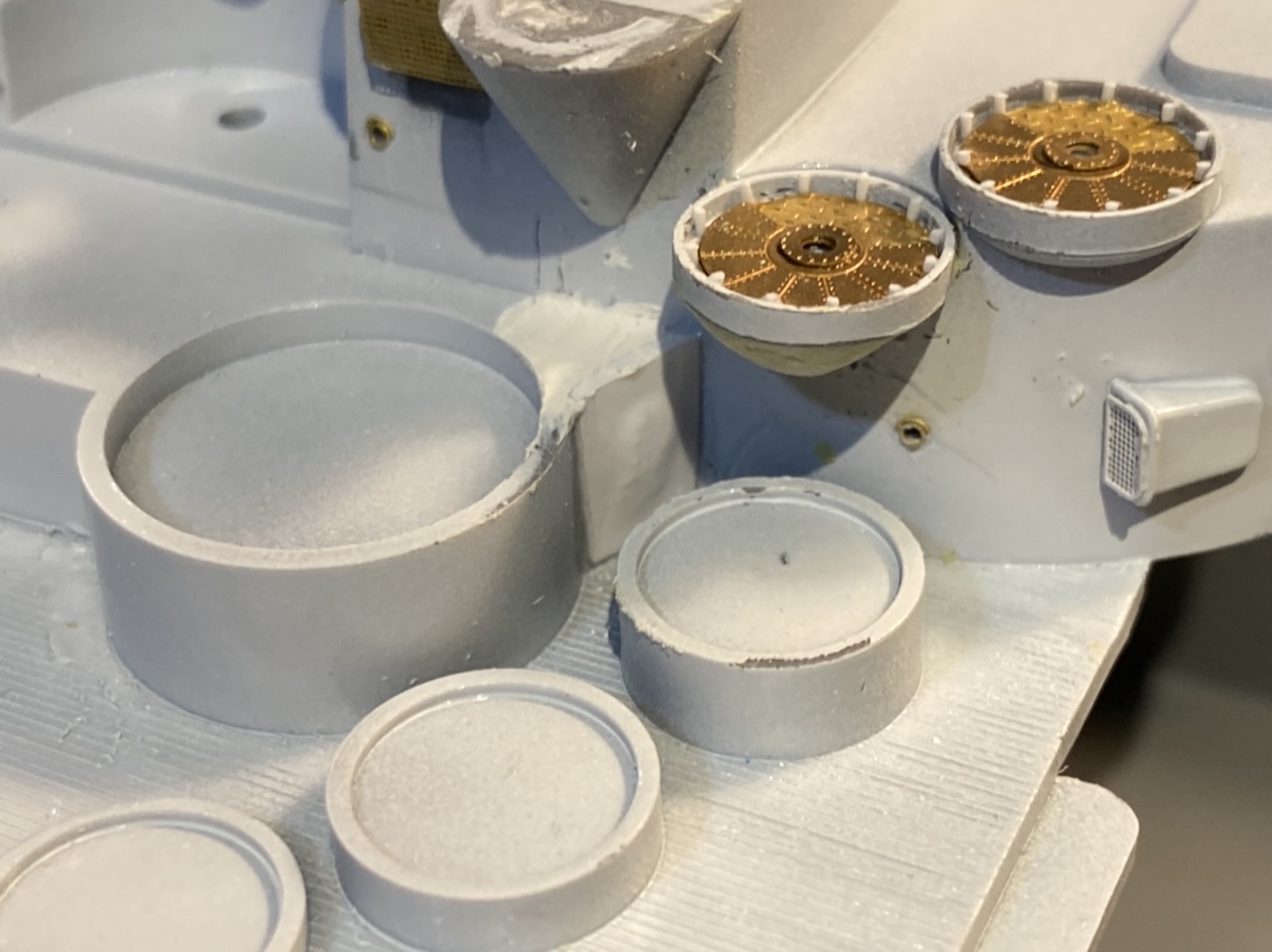

I was able to use the diamond plate sheet to detail the floor of these gun tubs.
Here�s the Eduard deck plates added.  The fit was pretty good and it sure looks better than when I tried to cut the pieces out myself.

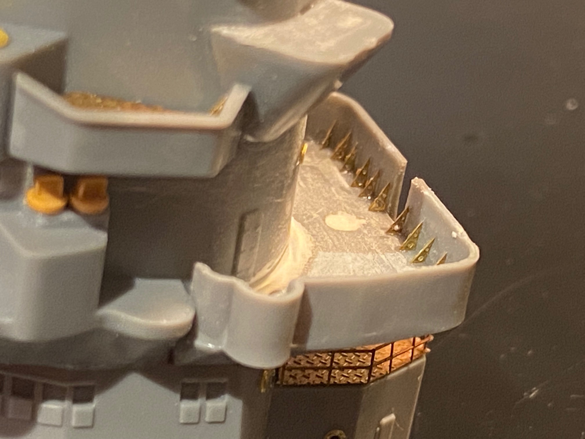

I�ve been working on the funnel on and off. There�s a lot of detail that can be added. The anatomy of the ship and super illustration books are invaluable here. I decided to remove the pipes that are molded onto the funnel structure. They are actually separate, secured by fittings at various points along their length. I�ve started to reconstruct them with the appropriate PE pieces added behind. I added some other small modifications as detailed below.
I used modified triangular perforated gussets to model the supports under the �skirt� of the funnel.
I added supports her at the aft portion of the platform.

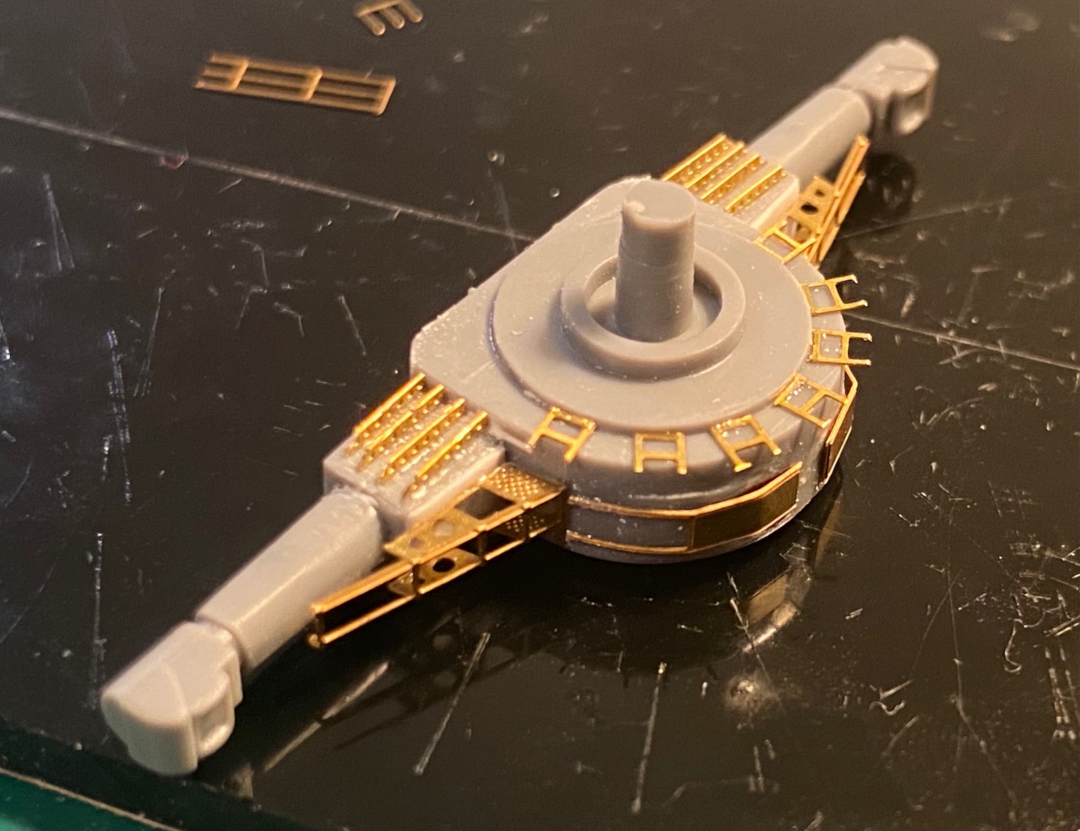

I�ve been working on a couple things lately. I�ve put together the supports for the rangefinder of the main tower structure. I had to be a little creative with this, since the Pontos parts were made for the new tool, and on the old tool the support itself is molded onto the observation deck below. I also added some supports for the bulwark of the deck. I did the same for some other parts of the bridge superstructure. I also started tackling the rangefinders themselves. There is a lot of detail to be added to these parts.
Here you can see the support beams on the column that holds up the main rangefinder and radar structure.  I also added some triangular gussets to the bulwark on this level.

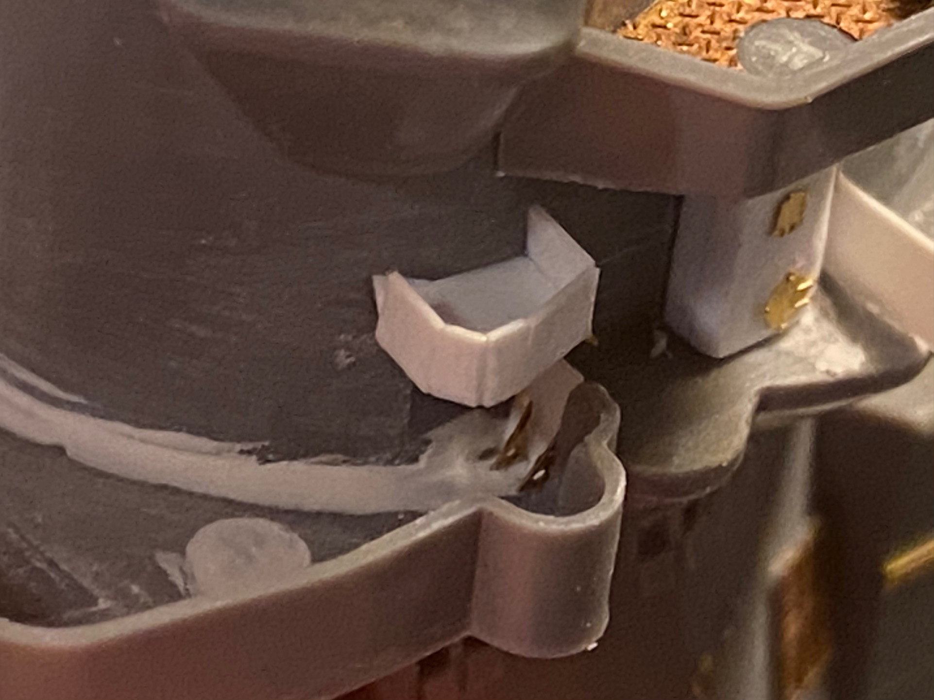

Here�s the other thing.  This searchlight platform is missing.
I tried to recreate the platform using some strip styrene
Anatomy of the Ship shows some triangular gussets supporting the platform

The aft rangefinder completed but not painted.
The bottom part of the main rangefinder
The top portion of the rangefinder
