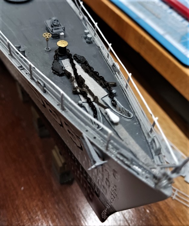

So, finally this evening I have finished the foc'sle adding the port anchor/chain & connecting the chain stoppers. As well, now have the windless control console (p) and the capstan brake wheel (s) in place -
Tomorrow, I hope to get all the paint touched up and then turn the model around to finish the forward main deck railings on the port side of the ship. I've also redesigned the two whip antenna bases that are on either side of the bridge, eliminating the antenna which will be replaced with a spring steel rod (0.032" dia. music wire) and then painted to suit. The original 3D printed whip antennas both curled within a couple months of printing them. I'll also replace the various whips on the fwd/after stack in the same fashion.

Re: 1/144 Scale USS STODDARD (DD-566) - Kitbash, Revell FLET
Beautiful chains Hank, I'll have to try them out.
The chains for models are expensive in the shops...
