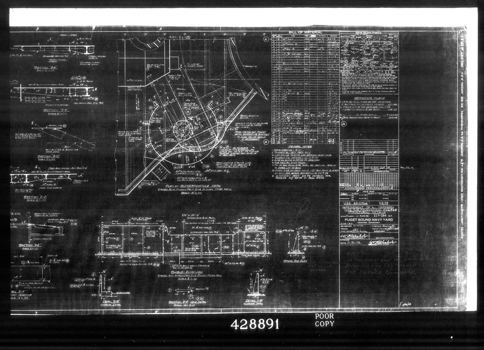

Sometimes, the only or best references available are the Booklets of General Plans. The best references are shipyard construction drawings and photos. Shipyard construction drawings are the actual blueprints used to build the ship. An example appears below, in this case a forward gun tub on USS Arizona. Note that it is fully dimensioned and extremely precisely drawn. BoGP drawings were used to familiarize personnel with a ship's general features, not intended for construction. BoGP drawings are not fully dimensioned, nor are they precisely drawn. Therefore, real ships can't be built from them.
Photos can normally better confirm the presence and location of specific details actually fit to the ship by the yard or crew. Frequently, details shown on BoGP drawings, and sometimes shipyard construction drawings too, don't match photos of the actual ship. As Timmy said, what actually gets built and what gets drawn may be different. And over time, actual features change. Therefore, determining a ship's actual features and their precise location often requires a bit of sleuthing. This is why the research we conduct in preparation for making a 3D model normally takes much longer than actually designing the model.
BoGP drawings were done by hand often by more than one draftsman. Some draftsmen were clearly more talented and precise than others. It is not uncommon to find the overhead "plan" view in a set of BoGP drawings doesn't quite match the side "elevation" view in the same set. This tends to indicate that the sheets were drawn by different people at different times. And it's a real headache when trying to design a 3D model from 2D plans that don't match. Construction drawings, on the other hand, rarely have this problem. They are supremely precise and stated dimensions in plan views nearly always match stated dimensions in elevation views. Explicitly stated dimensions can be used to check for any distortion in the drawing.
Also, the material the BoGP plans were drawn on may or may not have been stored well and therefore may suffer from distortion or damage. And any distortion may be differential. In other words, one side of a sheet may measure correctly but the other side of the same sheet may be distorted. One side may be true, the other side may be warped.
Still, sometimes BoGP drawings are all we have or the best we have and so that's what we use. They just need to be checked against other available authoritative references for accuracy, if those other references exist at all.
