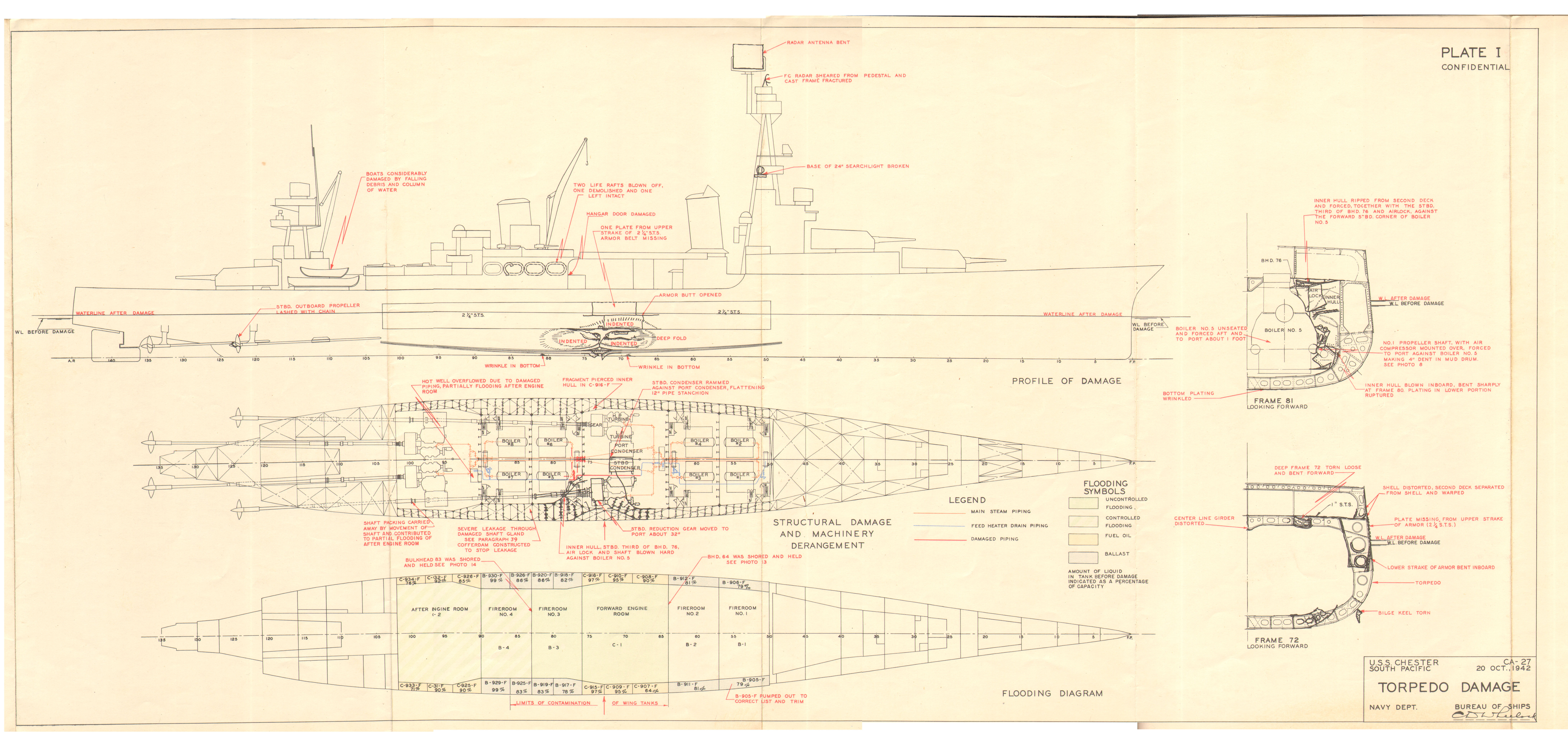

General question for you all (as I'm not able to find anything on this topic) -- the Northampton, Pensacola, and Portland class cruisers all have a visible riveted section of plating above the main armor belt, with tapered ends fore and aft running upwards towards the main deck. What is the purpose of this plating? There is no mention of it in any of the armor tables or battle damage assessments of the damaged ships (Northampton and Chester). It appears as though all the shell plating above the main armor belt up to the main deck is part of a continuous section of riveted plating.
The plating section's ends are visible in this photo of Louisville off Mare Island: https://www.history.navy.mil/content/hi ... 26545.html
The forward plating section is nicely visible in this additional photo of Louisville after refit at Mare Island as well: https://www.history.navy.mil/content/hi ... 30497.html
The battle damage assessment from Chester's torpedo hit in Oct 1942 does not mention anything beyond shell plating in this area, so I'm curious if this section was armor: https://ibiblio.org/hyperwar/USN/WarDam ... PlateI.JPG
I've re-read the appropriate chapters of Friedman's US Cruisers and can't find anything about it either. I know this is a rather obscure topic so appreciate any insights!

Thanks G-Opt -- was waiting for your reply :) I think that solves it -- so we can consider the "heavily riveted plating" as the "armor hanging plate". Very interesting. Thanks!
