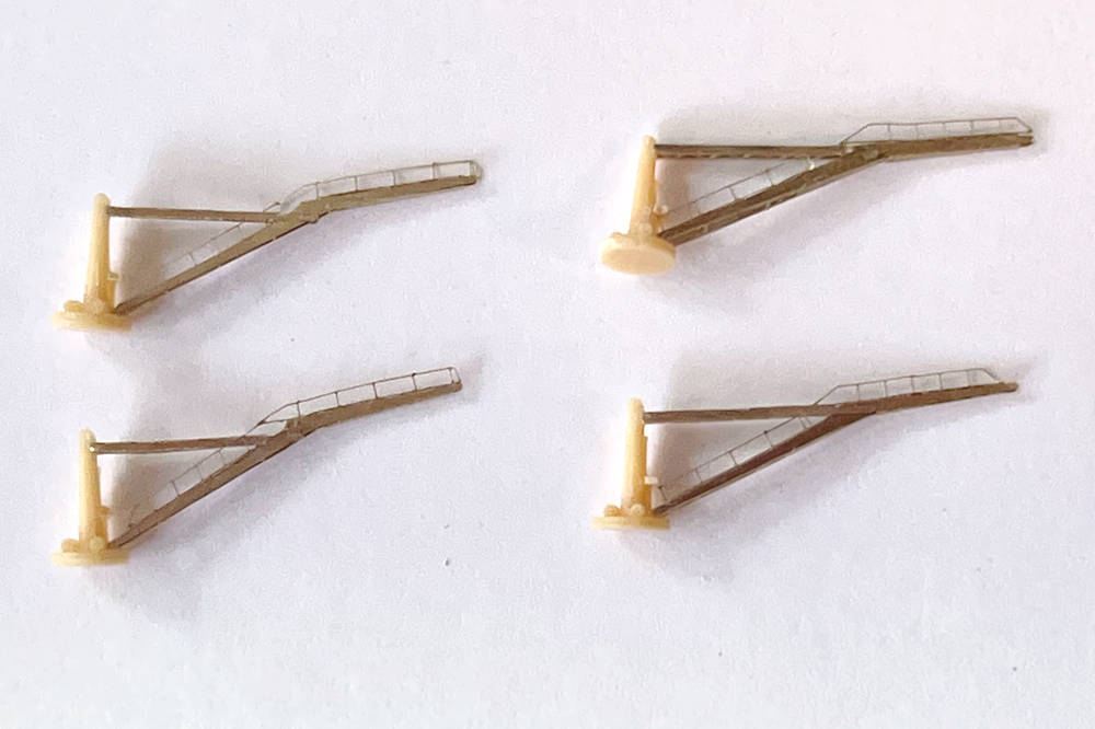

And the cranes are now mostly done. Although Nevada and Oklahoma are sister ships, and Arizona is very similar, their boat cranes are all different. Nevada and Arizona are the most similar, but post supporting the crane is shorter on Nevada. Oklahoma has the shorter post as well, and the bracing strut connects to a lower part of the crane arm. The cranes on Oklahoma (left) and Nevada (right) also had some boxes and such near the top, which I may add later.

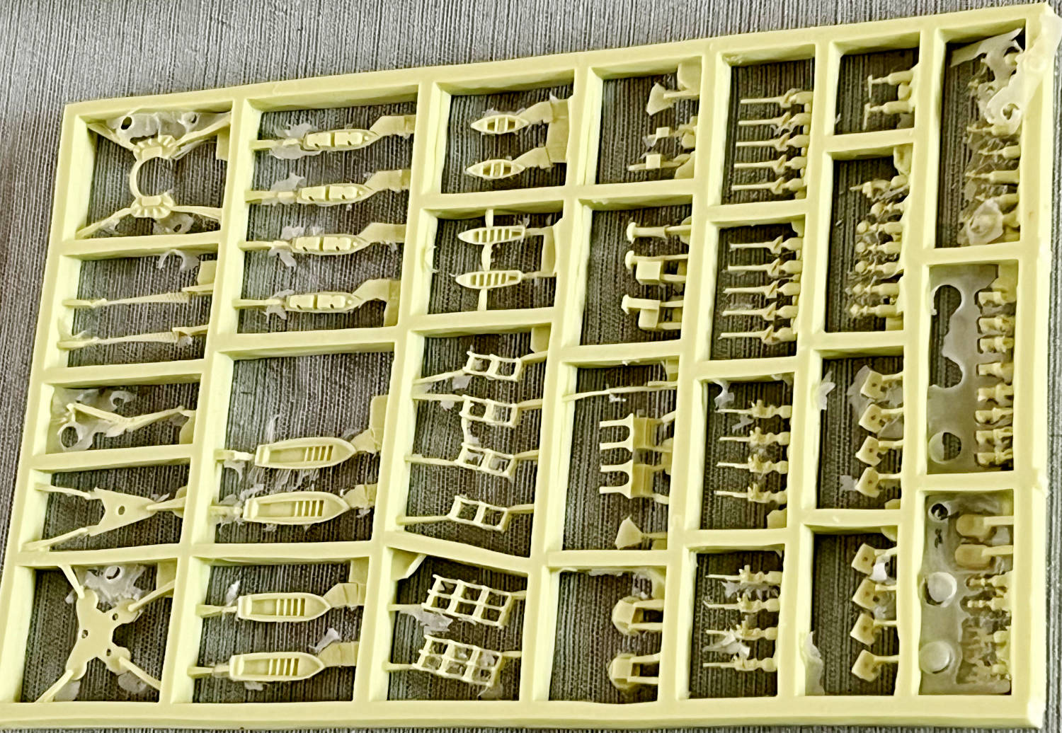

I thought that I had already posted a brief review of the Hi-Mold USS Arizona kit, but hadn't. Without further ado, here it is.
The kit is unique in the Hi-Mold line of kits in that 1) it's cast in a pale green resin (the others are light gray) 2) the resin parts have full spues rather than just casting blocks and 3) there are no cast metal parts. Also, the tripod masts are cast in resin and they don't just tell you to use some rod stock.

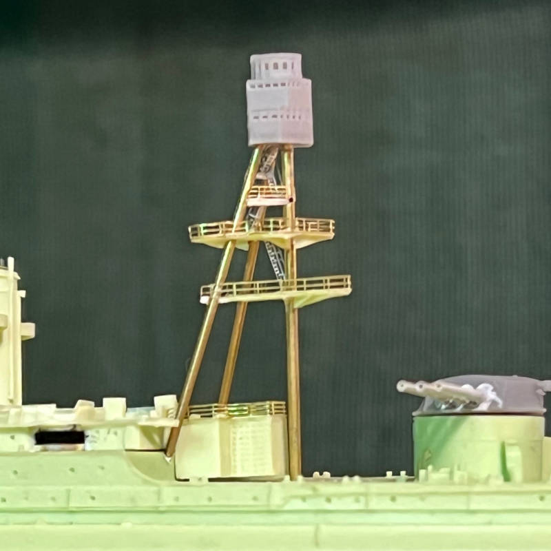

Here are a few pictures of the main mast for USS Arizona. It's just resting on the deck, so don't worry about it not being plumb. It was quite tricky to get the 3 poles in there, stuck into the bottom of the fighting top, threaded through the platforms, and lengths adjusted so that the main mast is vertical and the platforms aren't twisted. At this point, I'm almost looking forwards to cage masts...
I needed to open up some of the holes in the platforms to allow the legs to have the right angles. I used white glue to fill the resulting gap, then CA to strength the gap filling, and finally putty on top to give a smooth top surface. The lower two platforms got 2 bar railings, and those above got 3. It took quite a lot of fiddling to get the ladders the right length and in place, but now that's done and it looks quite good.
