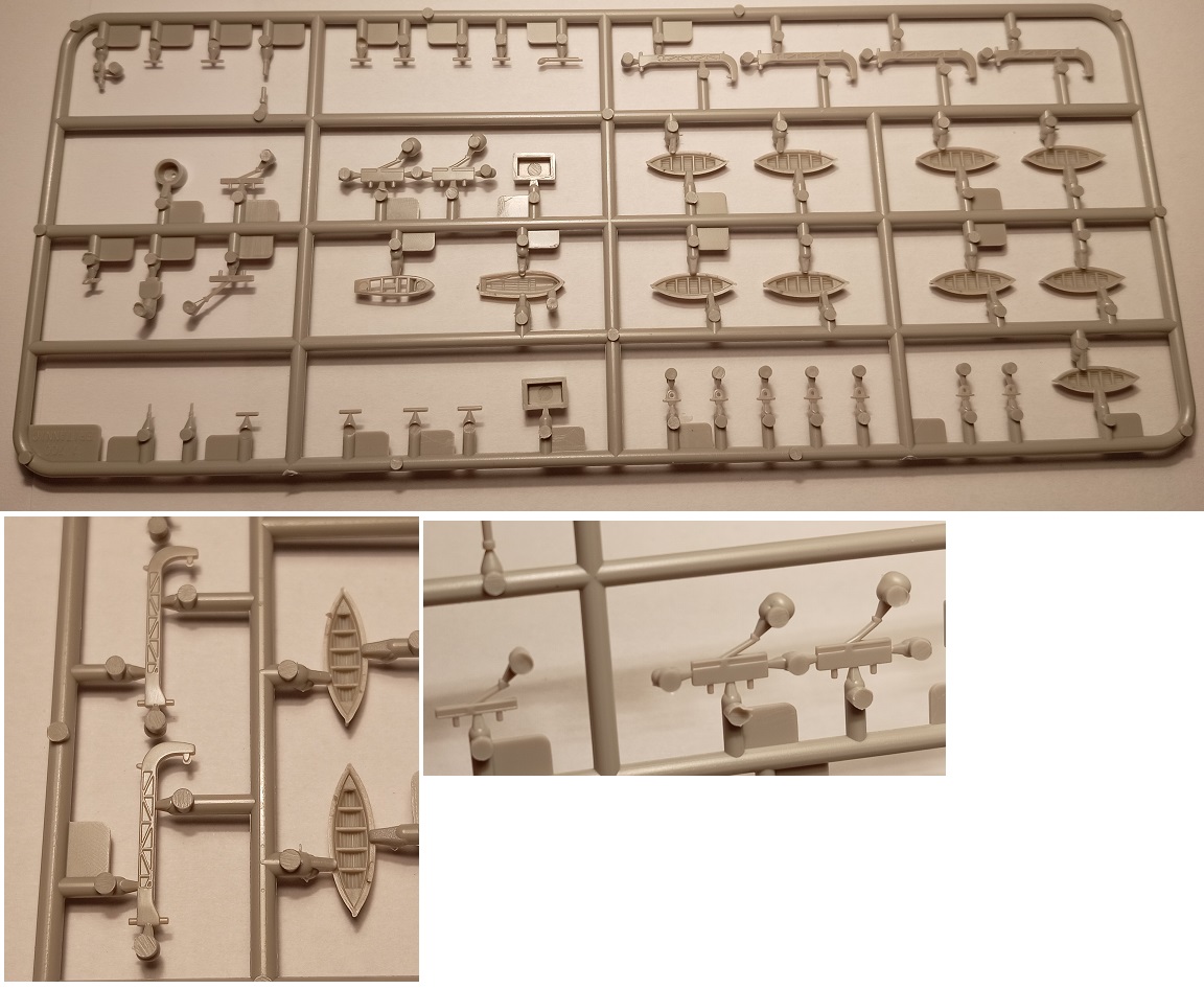

The first thing I looked for were the large gantry davits. Well, these need to be replaced. The mechanism that helps the cranes operate is also too simple, the rail that guides the small arms will need to be replaced.

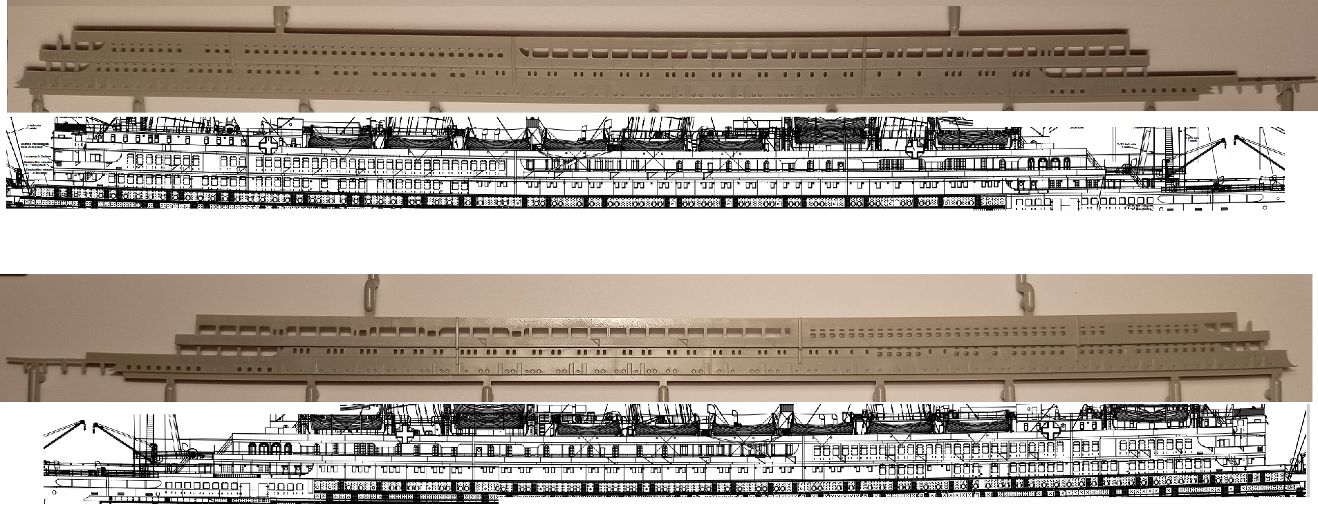

The superstructure (boat deck, A, B deck sides) actually follows the lines of the real ship based on the drawings and photos. However, due to the limits of plastic molding, it might have been better if the large divided windows had remained one larger opening. Repairing this will be a piece of shi....
Many of the small parts are surprisingly nice. I didn't check to see if each fan is facing the right way or if their engine housings are completely correct, but overall their main features resemble those on the Britannic. I think they made the most of the plastic, but e.g. the boat cranes also need to be replaced.

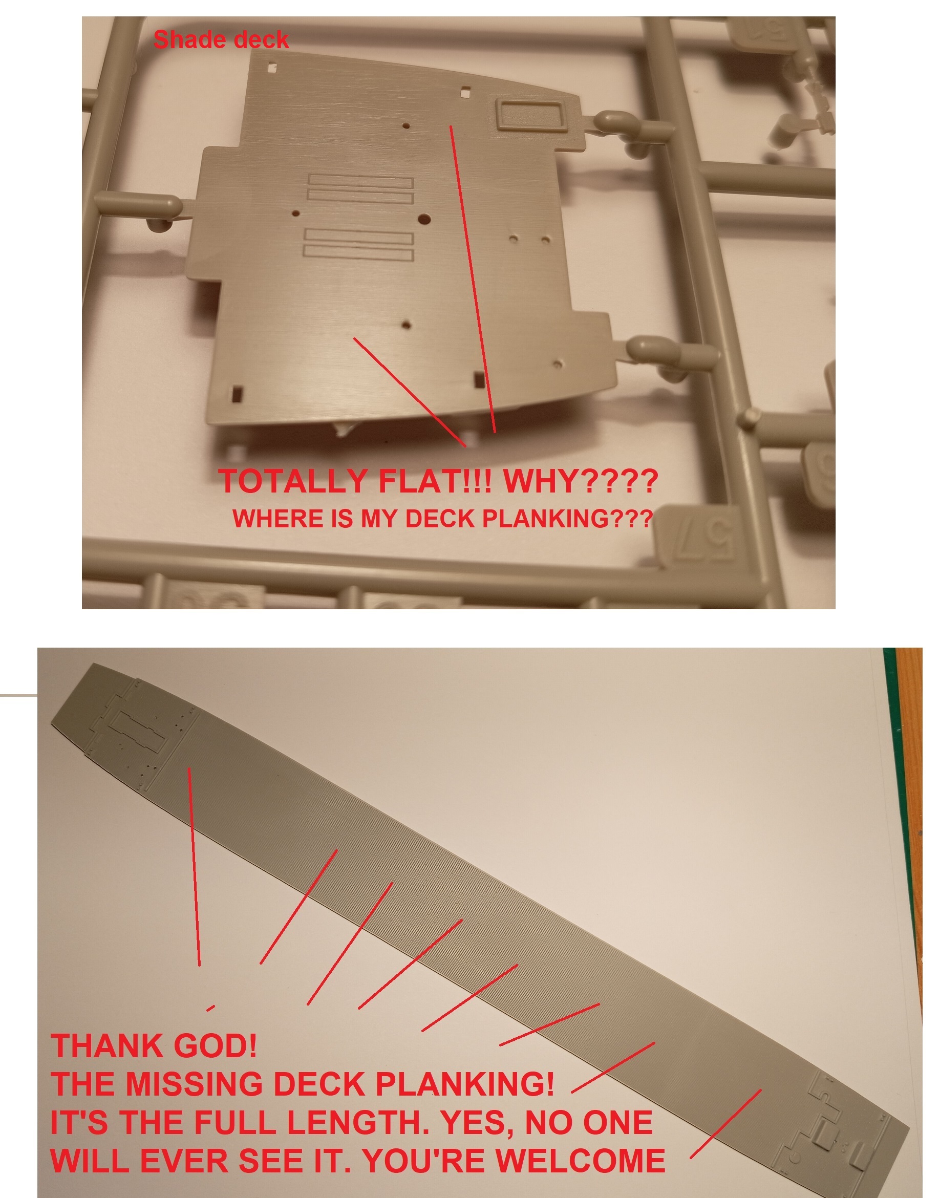

Anyone who wants something perfect, or at least close to it, will have to make a lot of improvements: Almost every part of the superstructure has flaws. Windows, doors are missing or are in the wrong place. One of the characteristics of the Britannic, besides the cranes, is that the superstructure in the rear has been completely redesigned. Certain elements of the aft deck are good, but the shade deck has no deck planking. Which I don't understand because the B and C decks are completely covered with planks (no one will ever see anything of them).

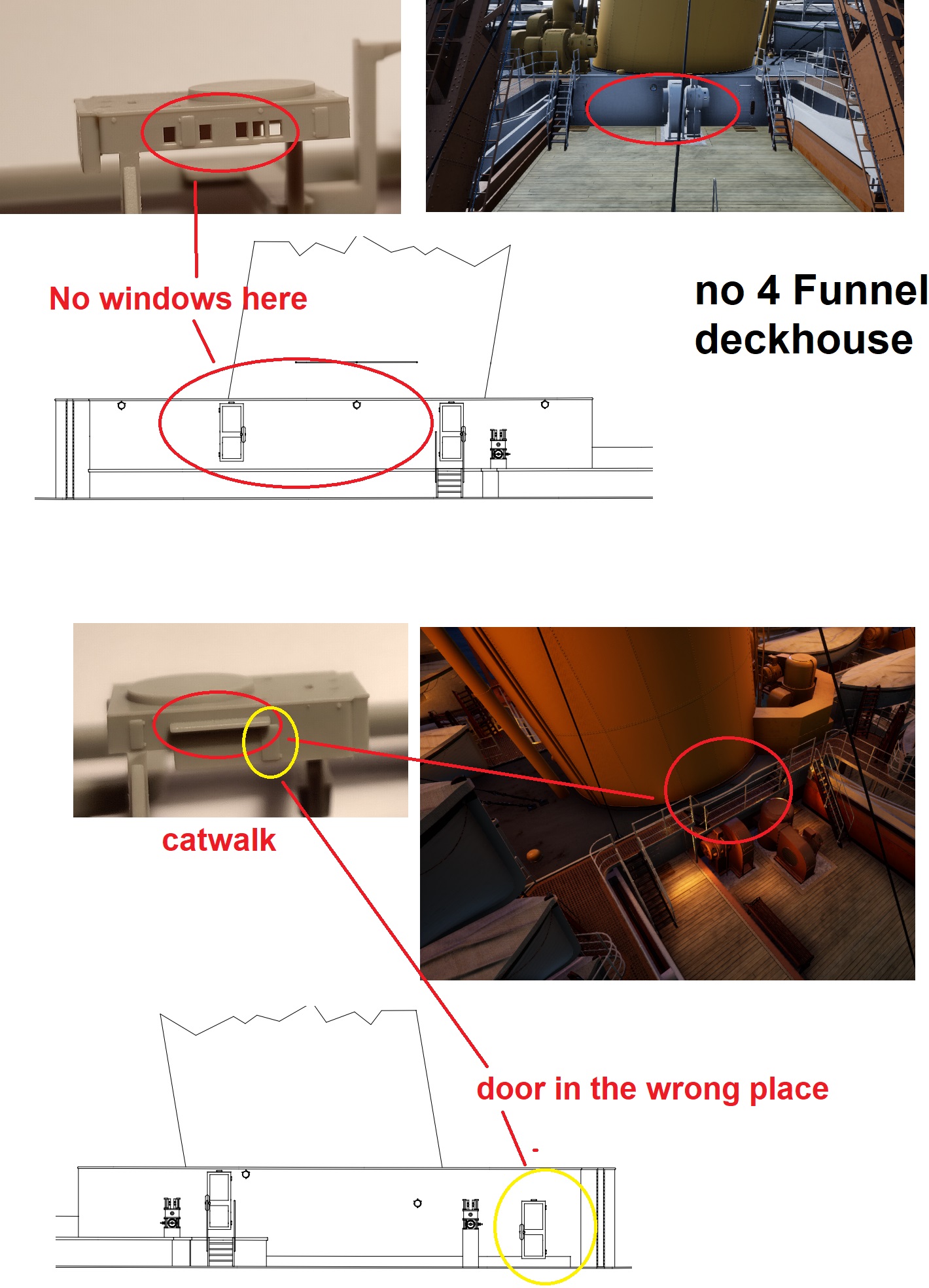

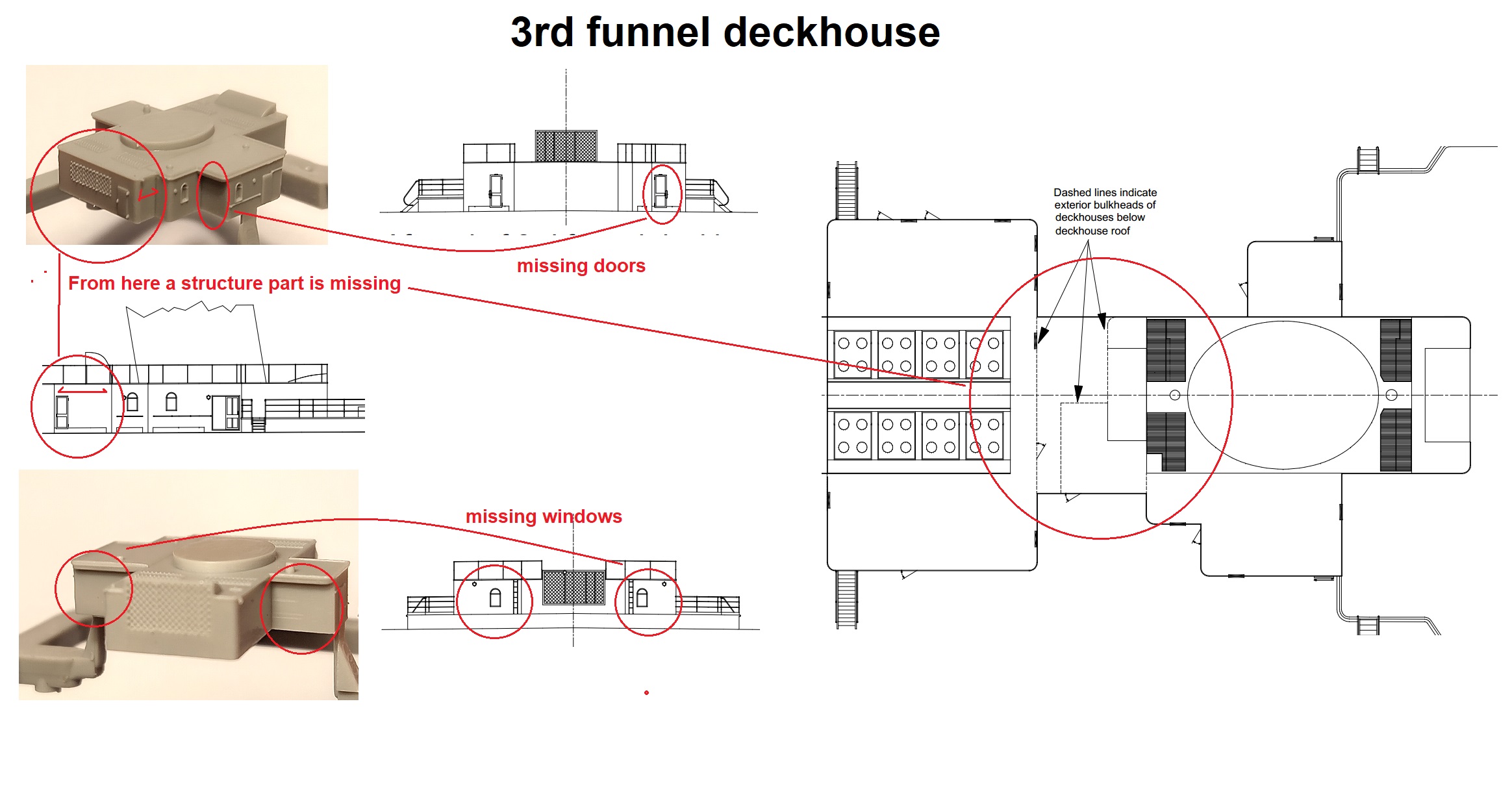

Well, that's all I noticed at first, and the rest will come out during the construction. If I overlooked something, or you see something I didn't, don't hesitate to write it down :thumbs_up_1:
