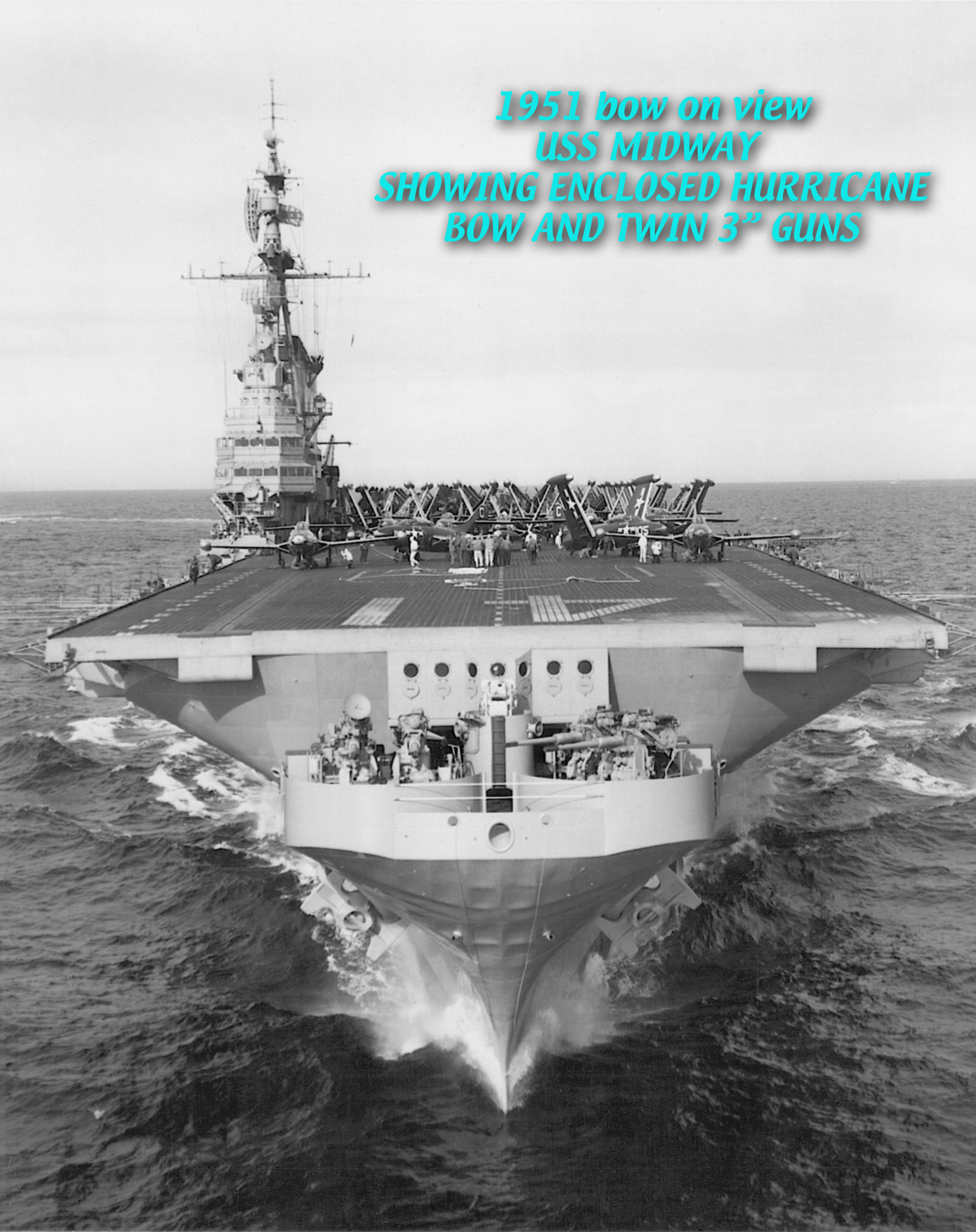

I am well aware that the Midway class were the first US carriers with armoured flight decks. Essentially, all US carriers from Lexington to the Essex class had steel flight decks with wood sheathing on top, primarily for anti-skid purposes (I understand). This image, from Ray Bean's Midway class set, seems to show fore-and-aft planklng on the flight deck, and he refers consistently in the section covering the ships' early careers to the use of blue flight deck stain (which implies wood since stain does not work on steel) but I've not located documentation of wood sheathing on their decks. That is why I was asking the question.

I don't think that is planking as it is parallel to the ship's centerline as all previous carriers had the planking perpendicular to the ship's centerline. go thru this link to see if wood planking used on the flight deck. http://www.midwaysailor.com/midway/specifications.html

This image of Franklin D. Roosevelt circa 1950s, also from Ray Bean's set, also seems to show fore-and-aft planking.

I'm pretty certain it is not planking but anti-skid mats due to the layout.

Ah! All is clearer now. Thank you. Maurice
