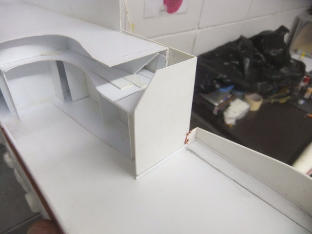

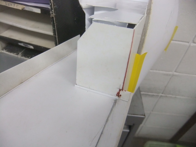

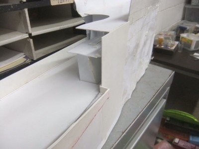

MAIN ISLAND STRUCTURE..
(SEPT 26th) Today I cover the structure with a thicker styrene sheet !

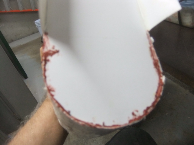

PostPosted: Tue May 27, 2025 4:57 pm
Posts: 185
First I'd like to thank you for following this project , it's quite appreciated !

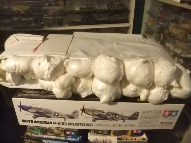

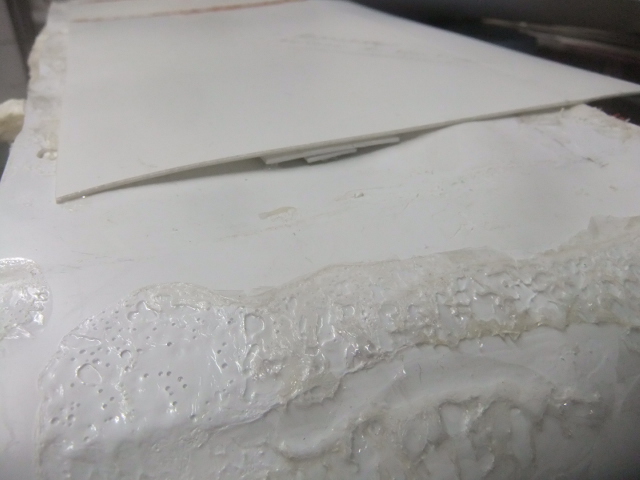

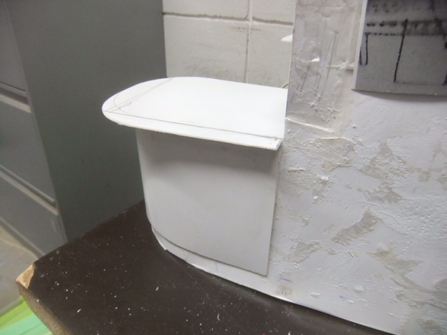

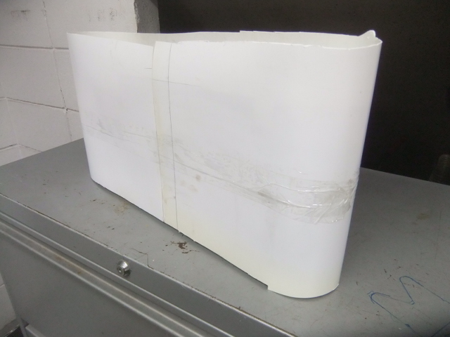

(MAY 27th) Today I realize the glued used last time as melt in the styrene , so I decided to remove it and stat applying a new styrene but this by section !
If you like to view the complete WIP on this project , just follow this Google link
https://photos.app.goo.gl/sn9TYRzgtaaH59SS9
If you like to view the stuff I have completed so far, just follow this link
https://photos.app.goo.gl/KeUxQzjhxGm5zeYC7
Hope you will enjoy this project !
Jmarc
PostPosted: Thu May 29, 2025 3:38 pm
Posts: 935
I can't tell how thick the plastic is, but it looks like 0.020" or 20 thou. You need to use at least 40 thou, or even better, 60 thou.
I used 20 thou on a 1/96 ship model many years ago and it warped and fell apart because it was too thin.
Darren (Admiral Hawk)
PostPosted: Thu May 29, 2025 4:09 pm
Online
Posts: 512
I agree on the use of at least .040"(1mm) styrene as that is what I use on my 1/144 scale ships.

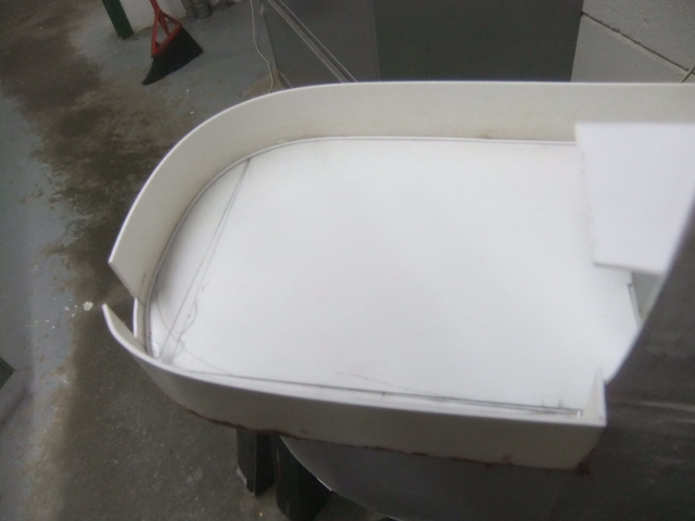

(MAY 30th) Today I cut out and glued the plateform !

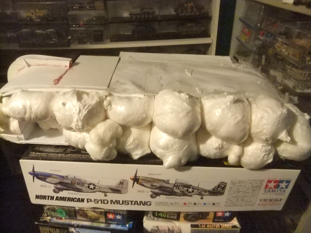

PostPosted: Tue Jul 01, 2025 2:44 pm
Posts: 185
(JUL 01st ) Today I apply some expande foam in the island !
Jmarc
