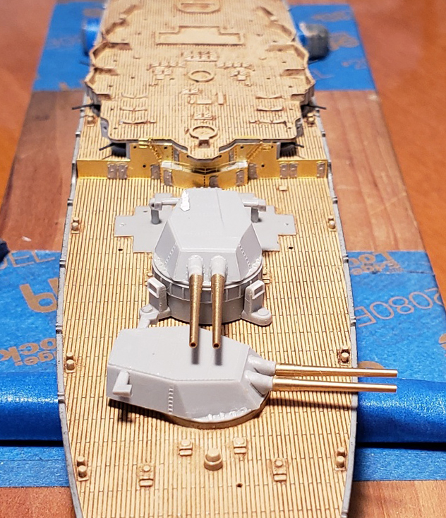

This one has been sitting in my stash for quite awhile! As soon as I saw the over exaggerated butt ends on the decks of these kits, I quickly shelved this kit away for a later date. This wont be a super detailed WIP. This will simply show my solutions to a few issues with this kit. First of all, I will not be using the supplied Main and Upper Decks. Instead, I will scratch build them using Evergreen V-Groove Sheet Styrene 2025 for the decks.
This gives me a clean slate to work with.
Each Big Five ship had some very unique features on their Main Decks that the kit supplied decks simply do not take into account. One feature that this process allows me to do is to eliminate the bolted on deck plates on either side of the Main Mast. None of the Big Five had this feature.
Thankfully, USS West Virginia's plans are available so I can nail down the specific features on her Main Deck pretty closely. Of course, a handful of photographs are necessary as well!
Here are a couple of shots of the Main Deck in progress. West Virginia had a handful of Cowl Vents on her Main Deck. A big shout out to Scott Reigel for supplying me with these vents!
