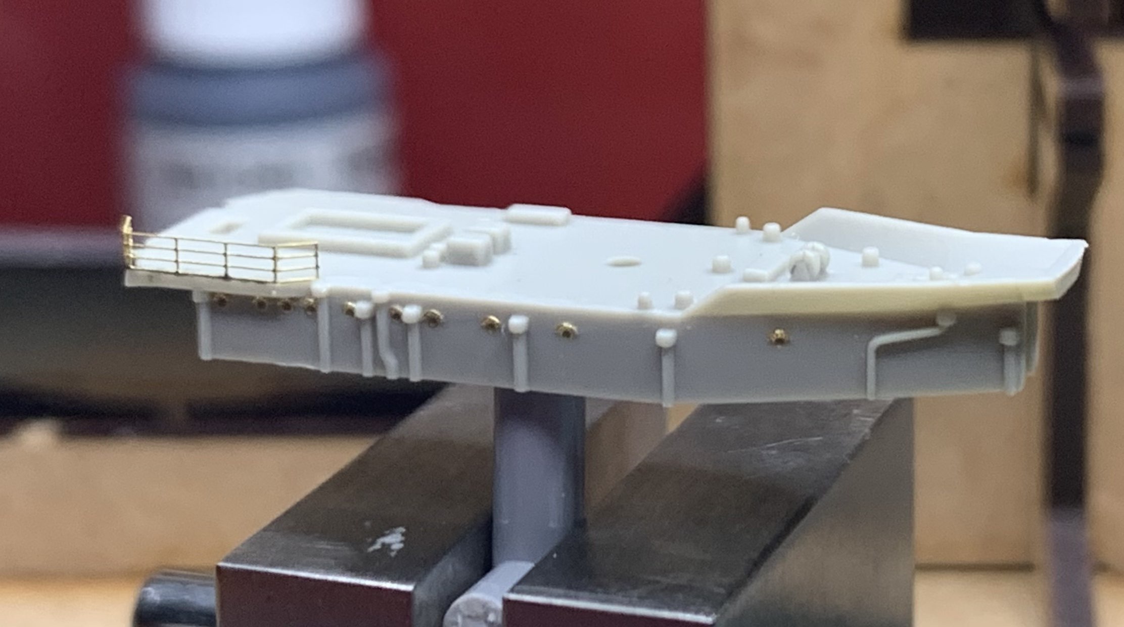

Been working on and off on this one, hence the belated update. Mostly just cleaning up parts and some more portholes.
I find this work to be more tedious than difficult. If I misalign one porthole part I can easily remove it and try again, but the fact that there are so many of them makes for a draining experience. Not looking forwards to doing this on a battleship or carrier.
I did however find that positioning a strip of tape as a guide above the portholes helps quite a lot. It's not perfect but it makes it such that you can't really see misalignments unless you were the one building the model.
Also managed to do a bit of railing on the superstructure. Recently I picked up a book by Dai Sasahara which included some interesting tips on working with generic PE rails. For those unaware this guy possesses an objectively superhuman level of attention to detail even for 1/700 modellers. Instead of bending the rail into shape with tweezers, he recommends cutting the rail at the bend point and then placing each part separately at the requisite angle. The idea is that this eliminates the slight curve you get when bending rails - overall quite time consuming (especially trying to figure out where to cut the rail) but the finish is definitely a bit nicer.

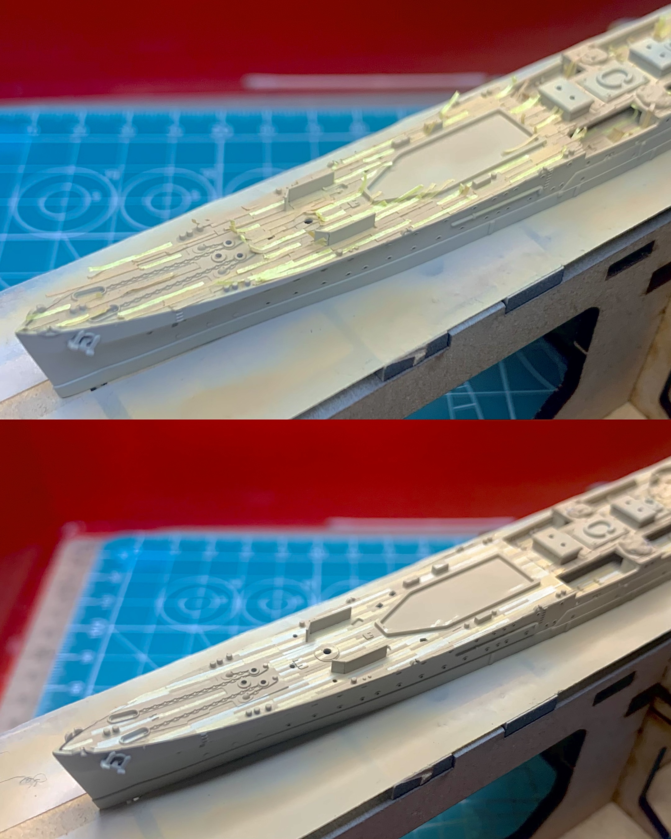

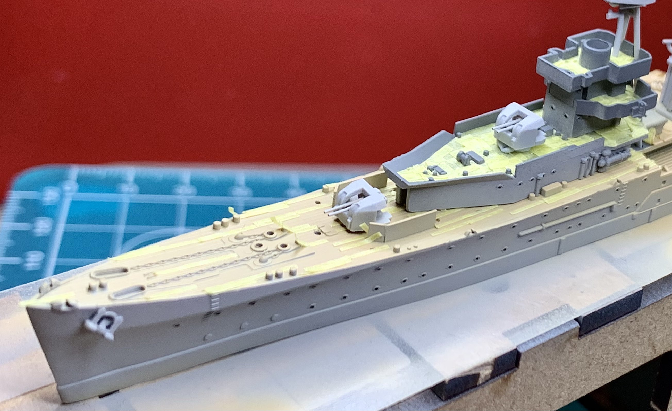

Onto painting the deck now: here I used the plank masking method I�ve previously applied on a couple of other models.
In this case it seems I left too much of the light tan colour (which is Tamiya deck tan) showing through, so there is a little more contrast between the plank shades than I want. It should be toned down a bit by washes and also by the tonal crush I will get after painting the camouflage colours on the hull.
With this done I masked the whole deck off. Overall this whole process took about 2-3 days, mainly just masking. Using a wooden deck would reduce this to about one afternoon of work but I personally don�t really like using those (a little thick at 700 scale and there�s a risk of peeling). I will definitely look into buying laser cut masks for my other kits as the final stretch of masking was especially tiring.

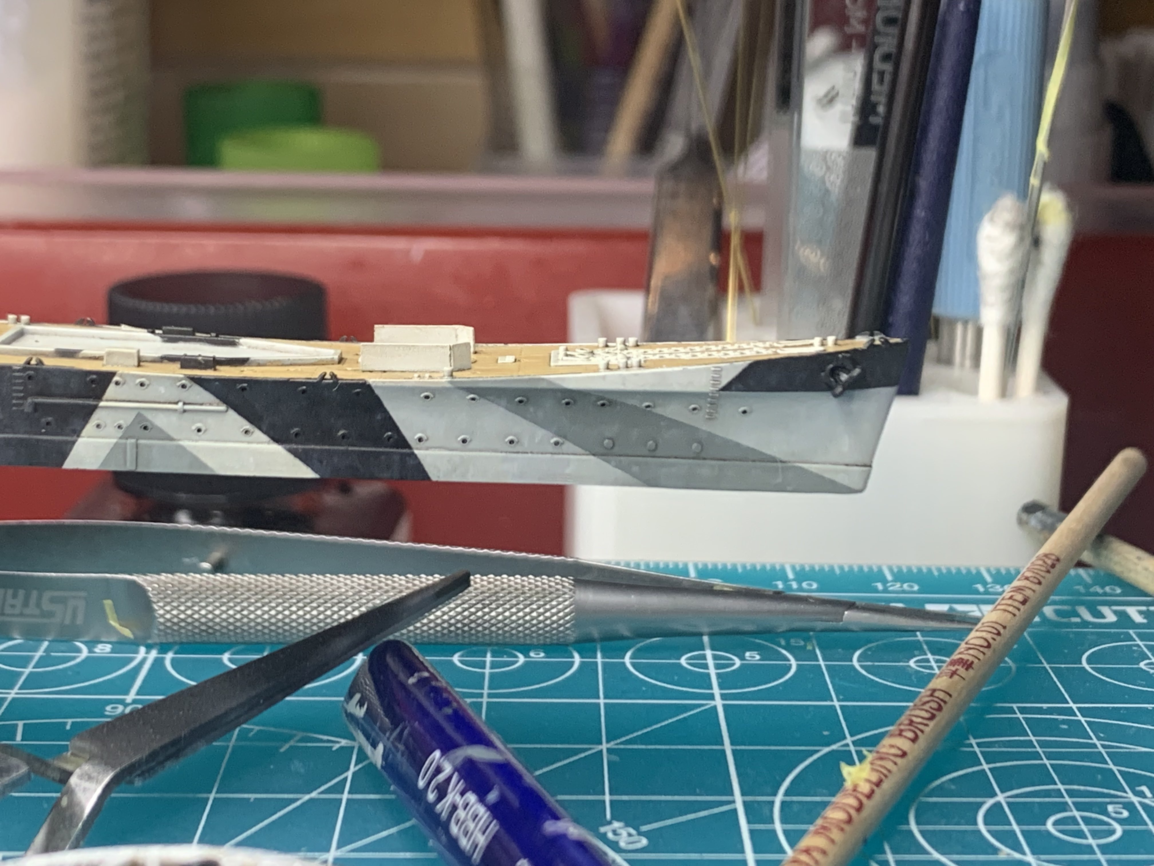

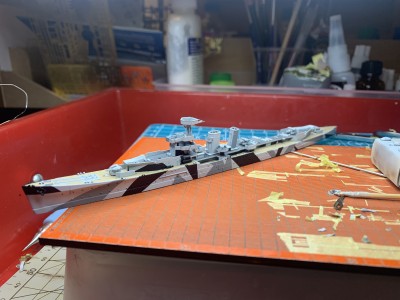

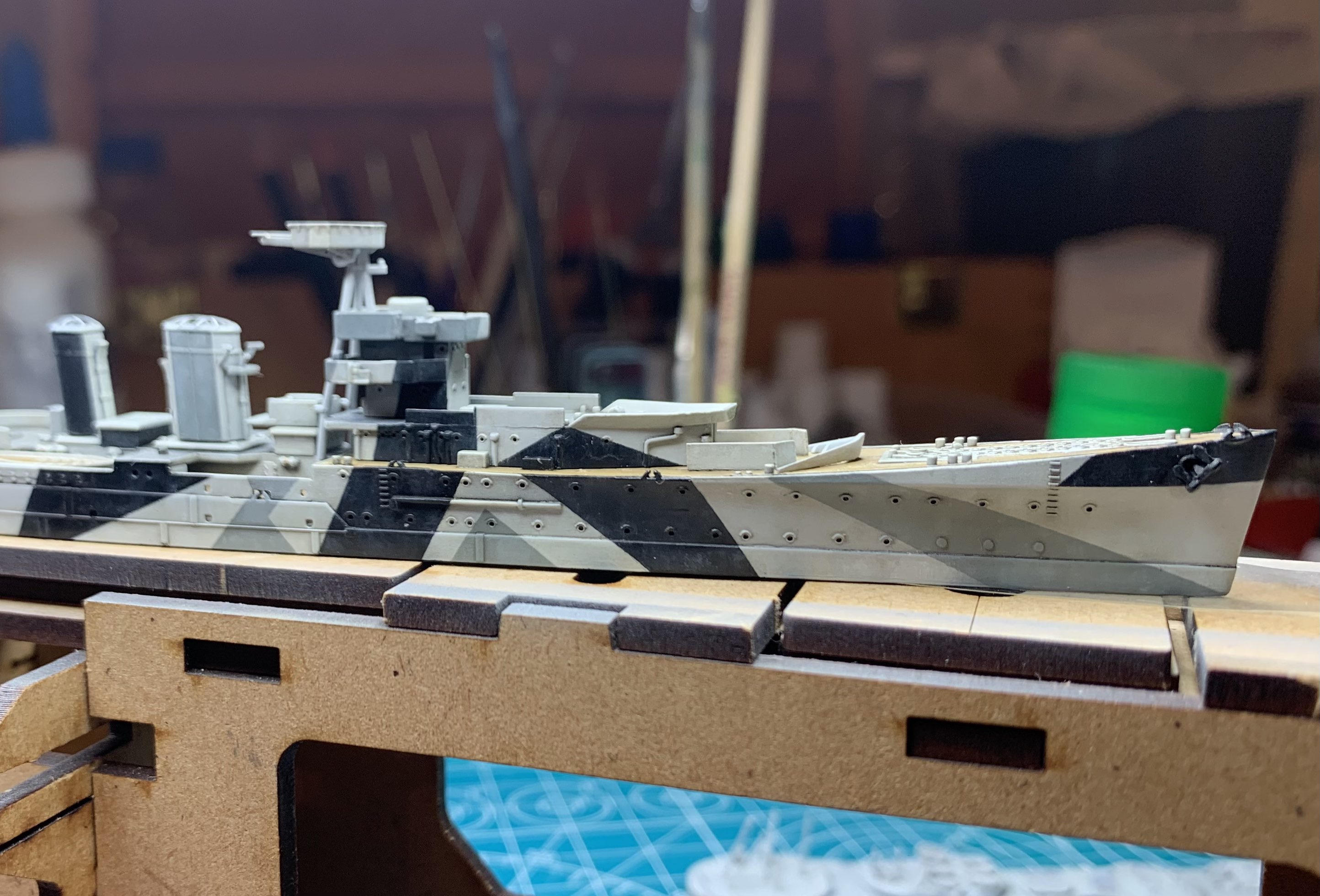

A bit of progress over the past couple of weeks.
Some of the black sections are a bit washed out and will be touched up later.
Posts: 8515
Re: HMS Calcutta 1941 (Trumpeter 1/700)
Nice work, love the camo!

Indeed, great colours! De wooden decks seem to look very good too. :thumbs_up_1: :thumbs_up_1: :thumbs_up_1:
Pieter
Posts: 1604
Post by Pieter »
Nice paint work. What are your plans for a base?
pascalemod
Posts: 2010
Location: Stockholm, Sweden
Post by pascalemod »
Gorgeous camouflage! wow.

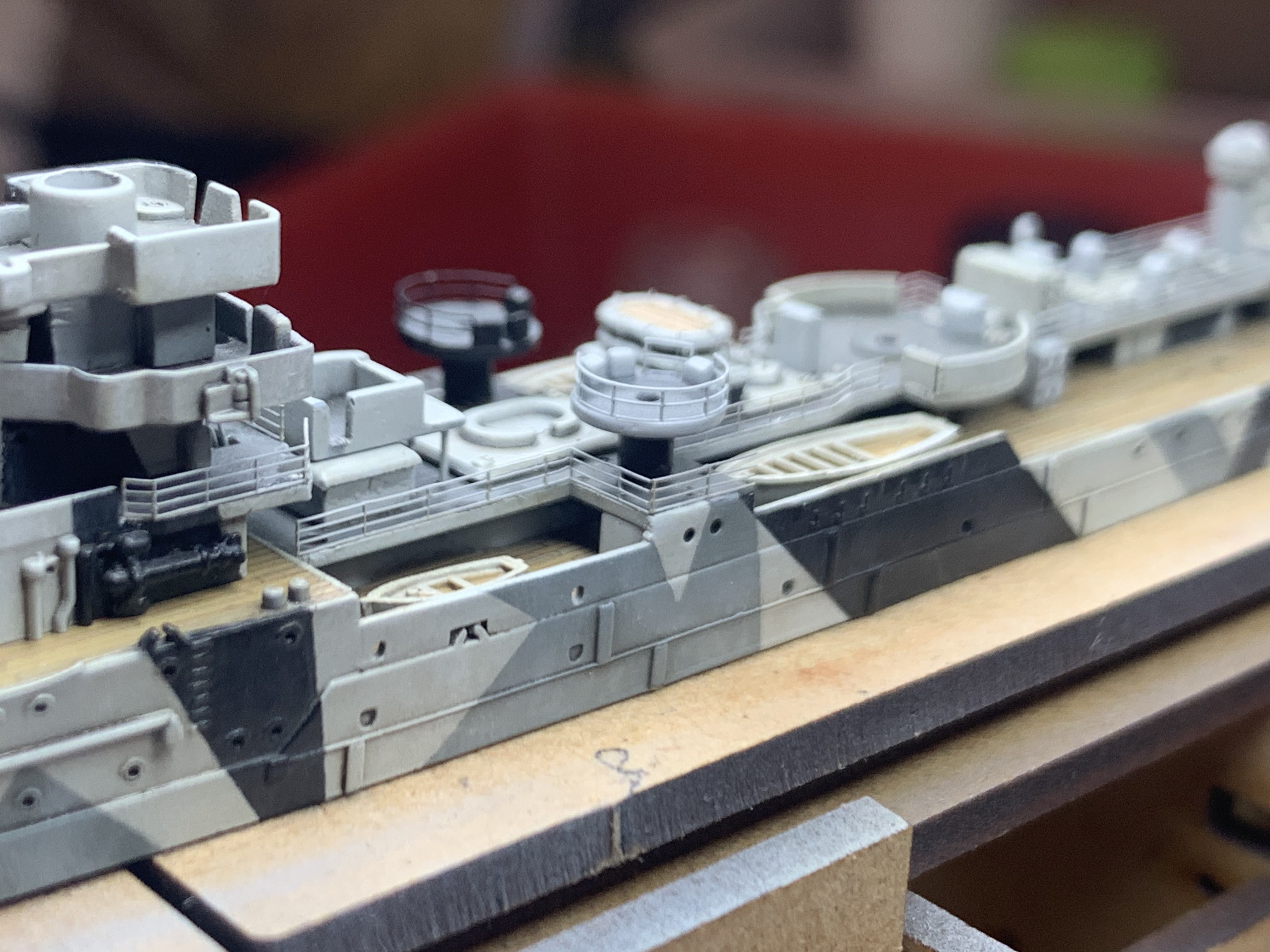

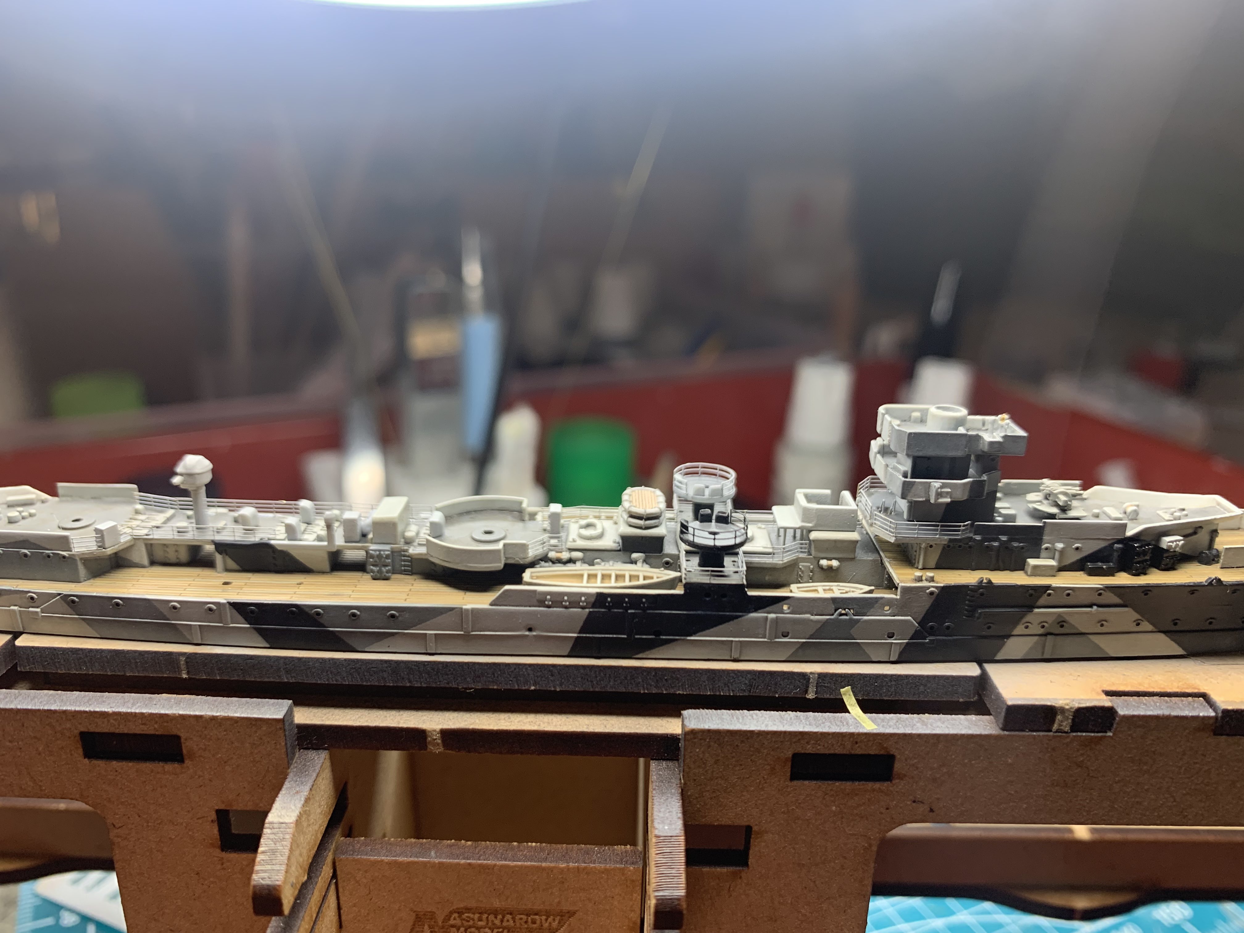

Railings for the superstructure, a bit more tedious given these are stock rails. A lot of trial and error to get the bends correct
Pieter wrote:Nice paint work. What are your plans for a base?
Thinking of a small sea base w/ figures at the moment

Nearly done now! Not much to updare other than rails and glueing a bit more of the superstructure together. Up next is rigging, flags, and the searchlight platforms i have to repaint for the 3rd time :( Image

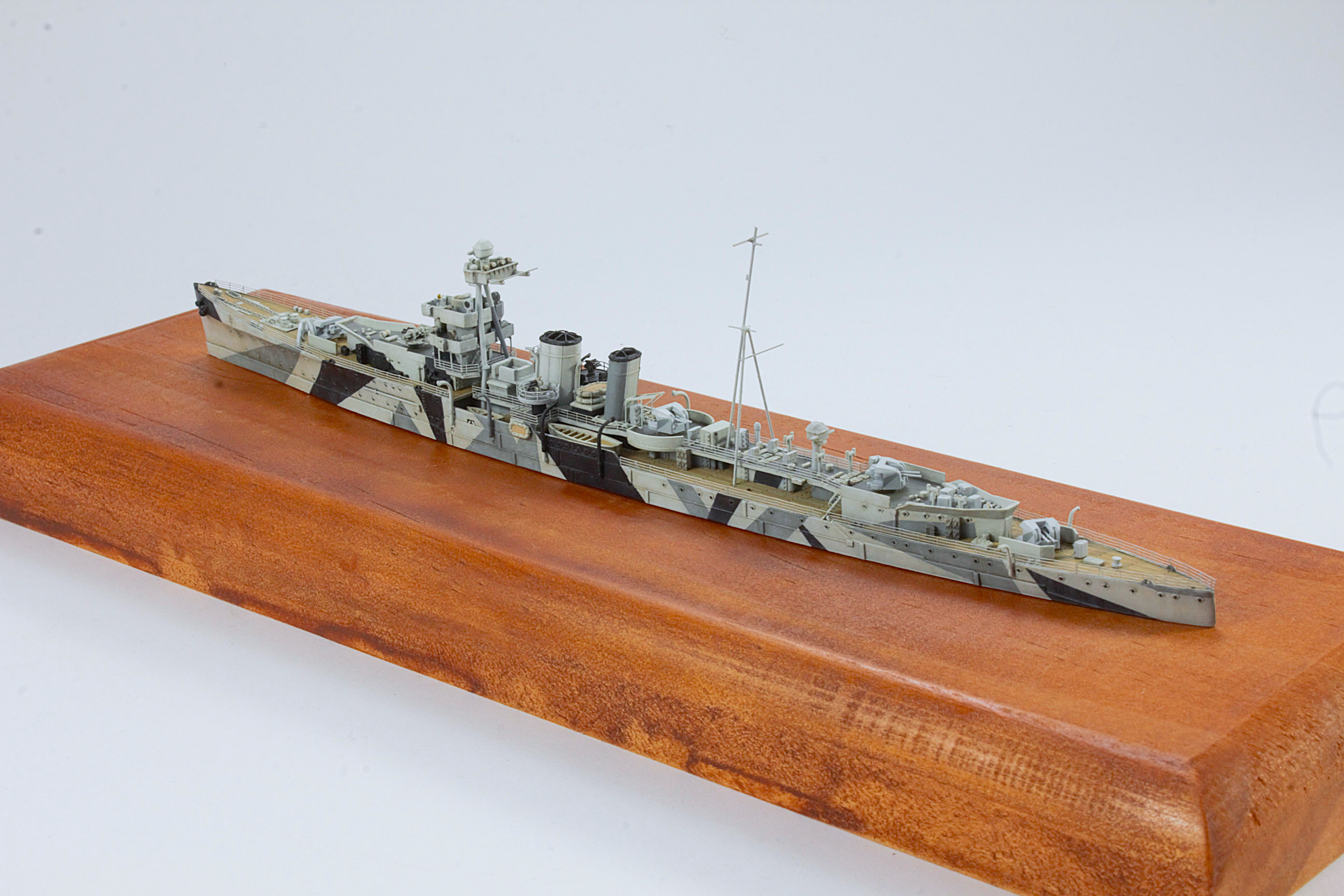

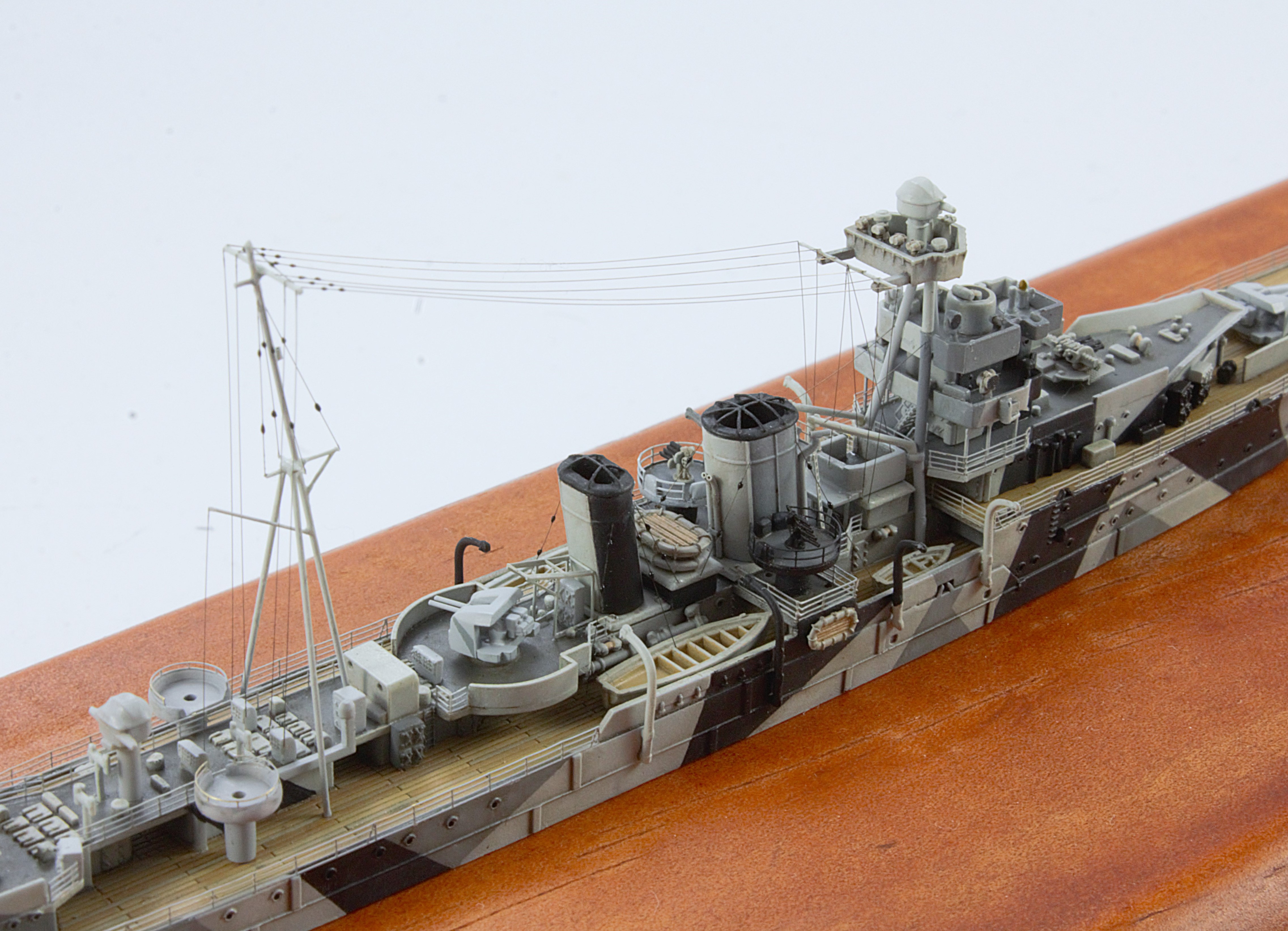

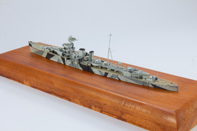

Rigging is done, onto the home stretch now!
Best Regards,
Sherman
Posts: 8515
That is gorgeous! Excellent work!
Christian Bruer
Posts: 574
Joined: Tue Nov 21, 2006 7:44 am
Location: Germany
Post by Christian Bruer »
Excellent work and finish. I much like the paintwork, she looks great in her camo pattern :thumbs_up_1:
