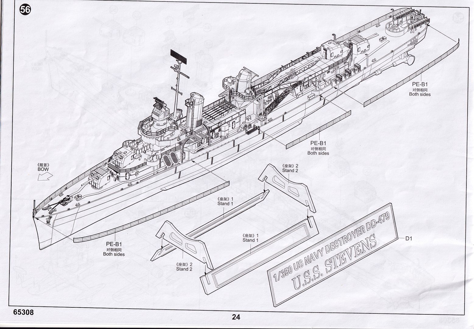

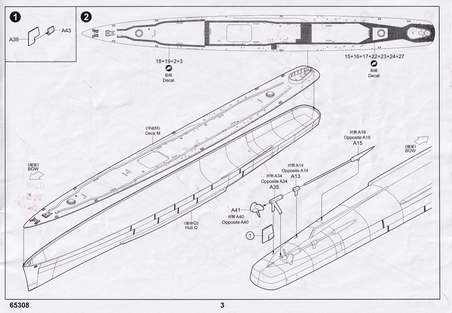

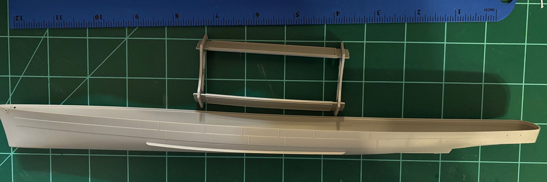

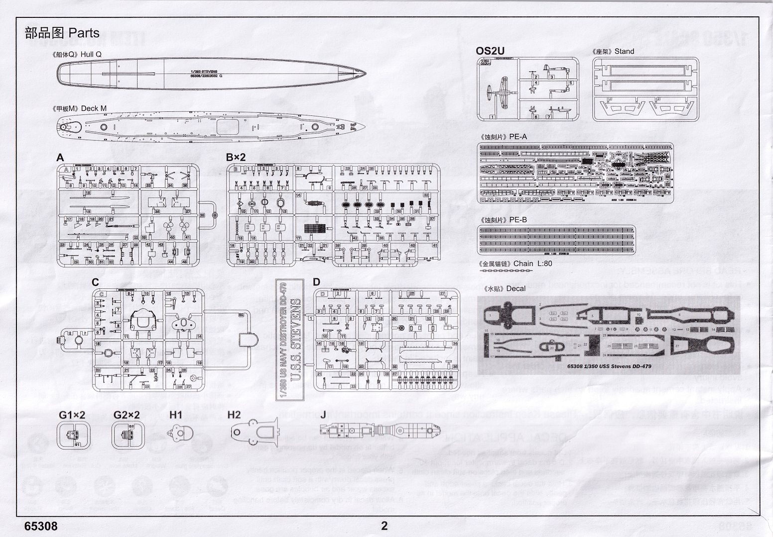

The kit, I didn't take photos of the kit sprues before I started to build. So I have scanned some images of the instructions. The kit comes as a Full Hull only, which I wasn't happy with. No scribed line for the waterline was added to aid water-lining. As is too common on many ship kits now, the hull detail is overdone. This hull makes it look like the STEVENS has an ARMOR BELT!!! My solution will be discussed in my "Works in Progress".

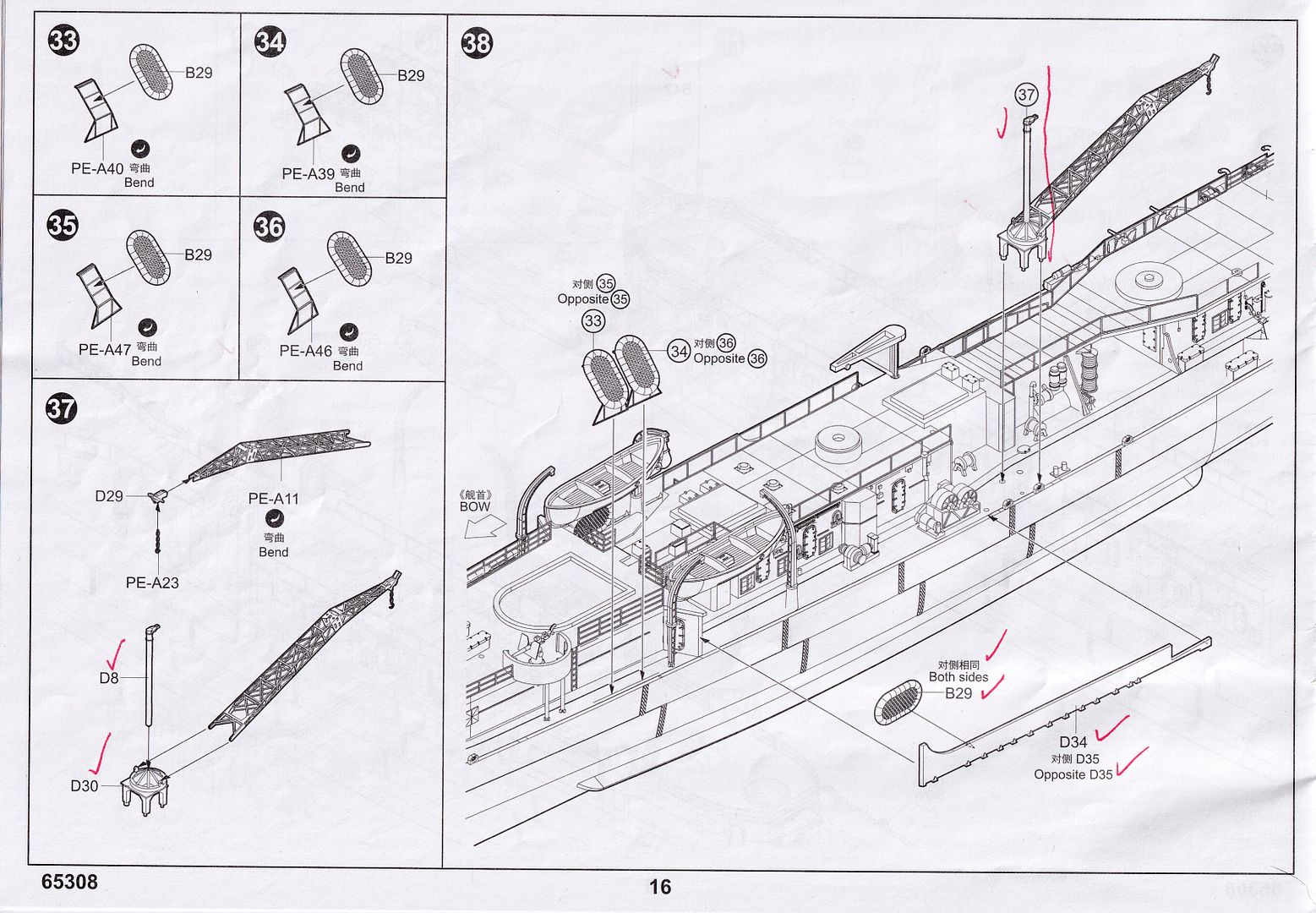

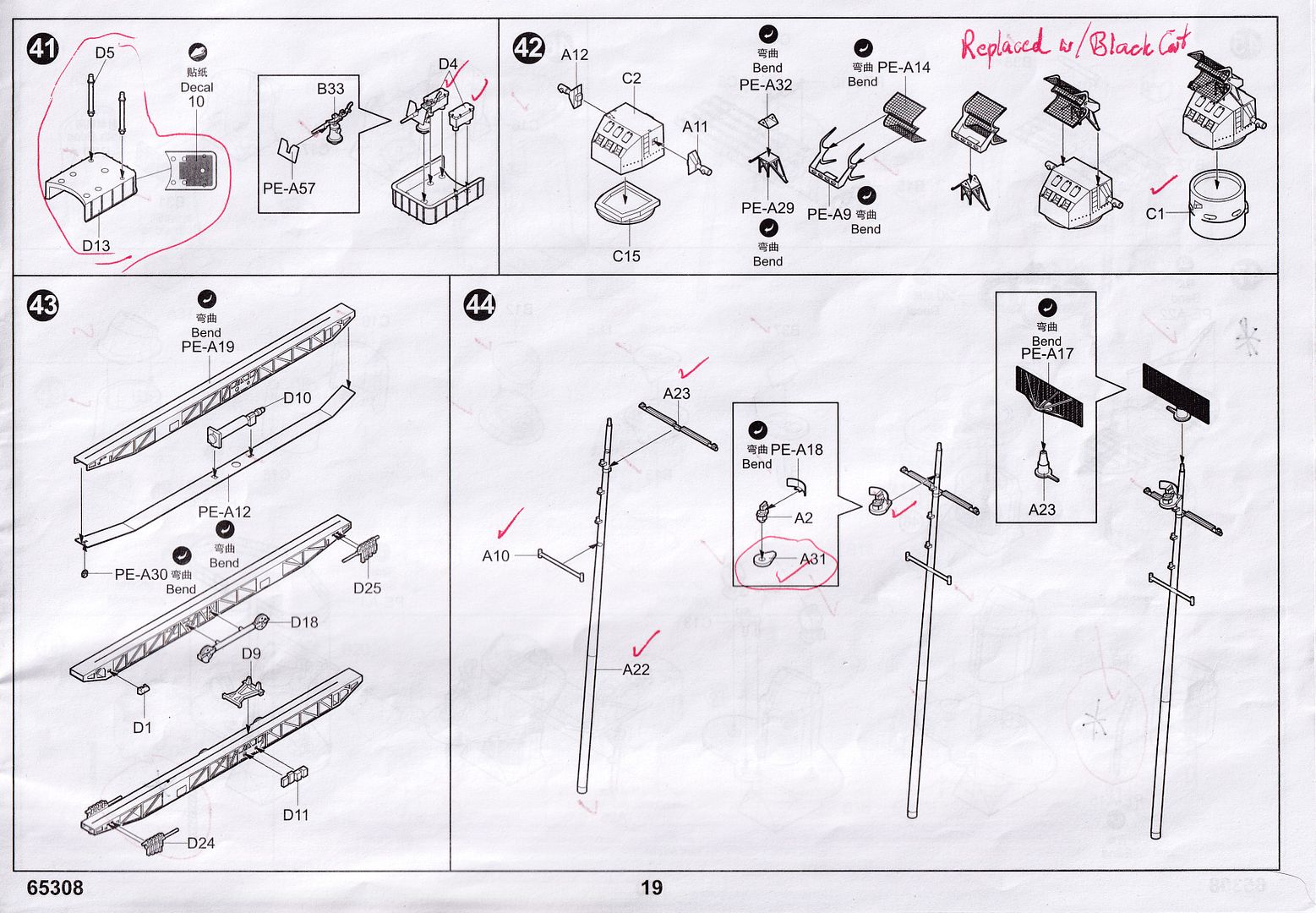

The parts are a combination of molded plastic and PE parts. The crane and catapult are mostly PE and a few plastic parts. Some of the PE parts are tricky to assemble because no detailed illustration for NOW to fold the more complex parts risks breaking a key part if you make a wrong guess the first time. (Example are the rolling racks for the K-Gun depth charges are quite confusing as to NOW you should fold them) Several of the parts using PE, I feel would be better replaced by 3-D printed parts by the kit manufacturer. Oh, the Kingfisher is molded in clear plastic and the decals are wrong period.

The weapons are typical for Trumpeter and are best replaced by aftermarket 3-D printed parts.
