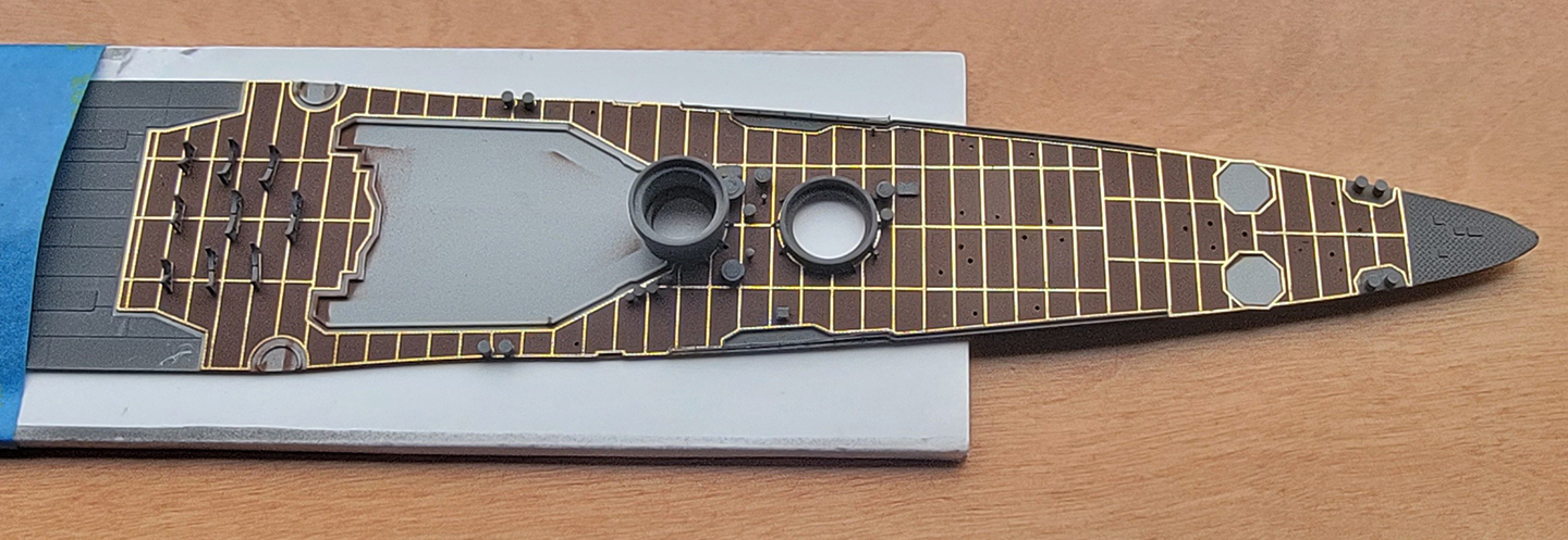

Given the identicality between the VF Takao and Atago brass tiedown sets, Martin Quinn was gracious enough to give me the Z photoetch fret from the Atago kit which holds the rearmost section of the brass tie-downs. I’ll hand him back the Takao Z fret when it returns, which will be soon. With the fret in hand, I was able to complete the main deck and add the remaining deck fittings, including hawser reels fore and aft.
- Posts: 9042
Re: VeryFire 1/350 Takao 1944 (高雄)
With the deck complete, I mated the deck to the hull and glued it together. There’s a tab on either side of the main deck which fit into slots in the inner hull at deck height, around where those torpedo reload tubes are located. The tabs align the deck with the hull quite well, provided one has test fitted and adjusted the deck before-hand. I glued the middle, let it dry, then worked my way out to the deck ends. This worked out well for me.
There were some seams to fill between the deck and hull, but not many. I was able to fill them with repeated applications of paint.

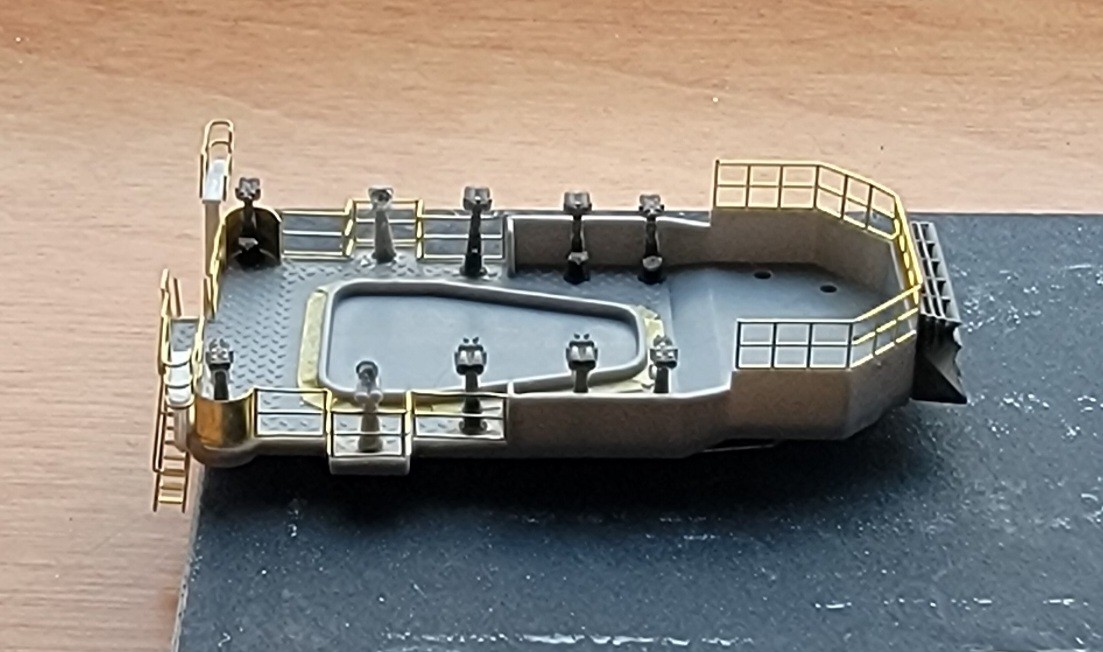

I then began adding the 3D printed directors and their bases. The 3D printed parts are great, but they have to go on perfectly the first time – there’s no time for adjustments with the superglue I use. Veryfire did not provide low railings for the 60cm signal light platforms, so I used 1/700 railing around those.
I also added voice tubes to all the directors, made from brass rod.
