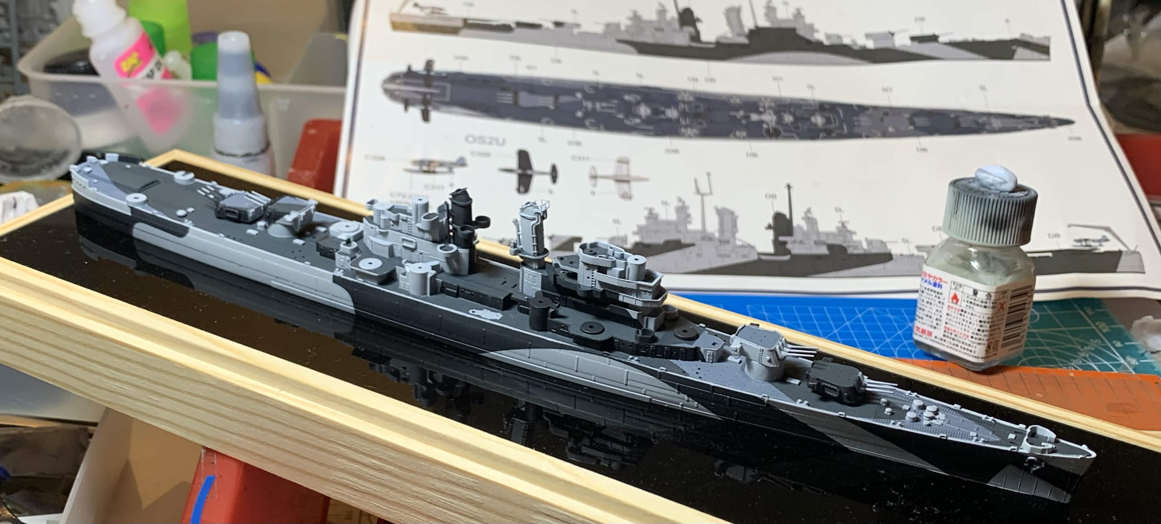

Hi all,
This is the newish USS Houston kit from VEE Hobby. Really nice kit featuring lots of slidemolding that allows everything to go together very easily. My main (albeit minor) gripes with it are the following:
- Hull plating is more stated than it needs to be
- No PE replacements for the oerlikon/bofors gun shields
- A bit more flash than you would expect from a modern kit
- Some small molding issues (e.g. the 152mm turrets are too tall on one side)

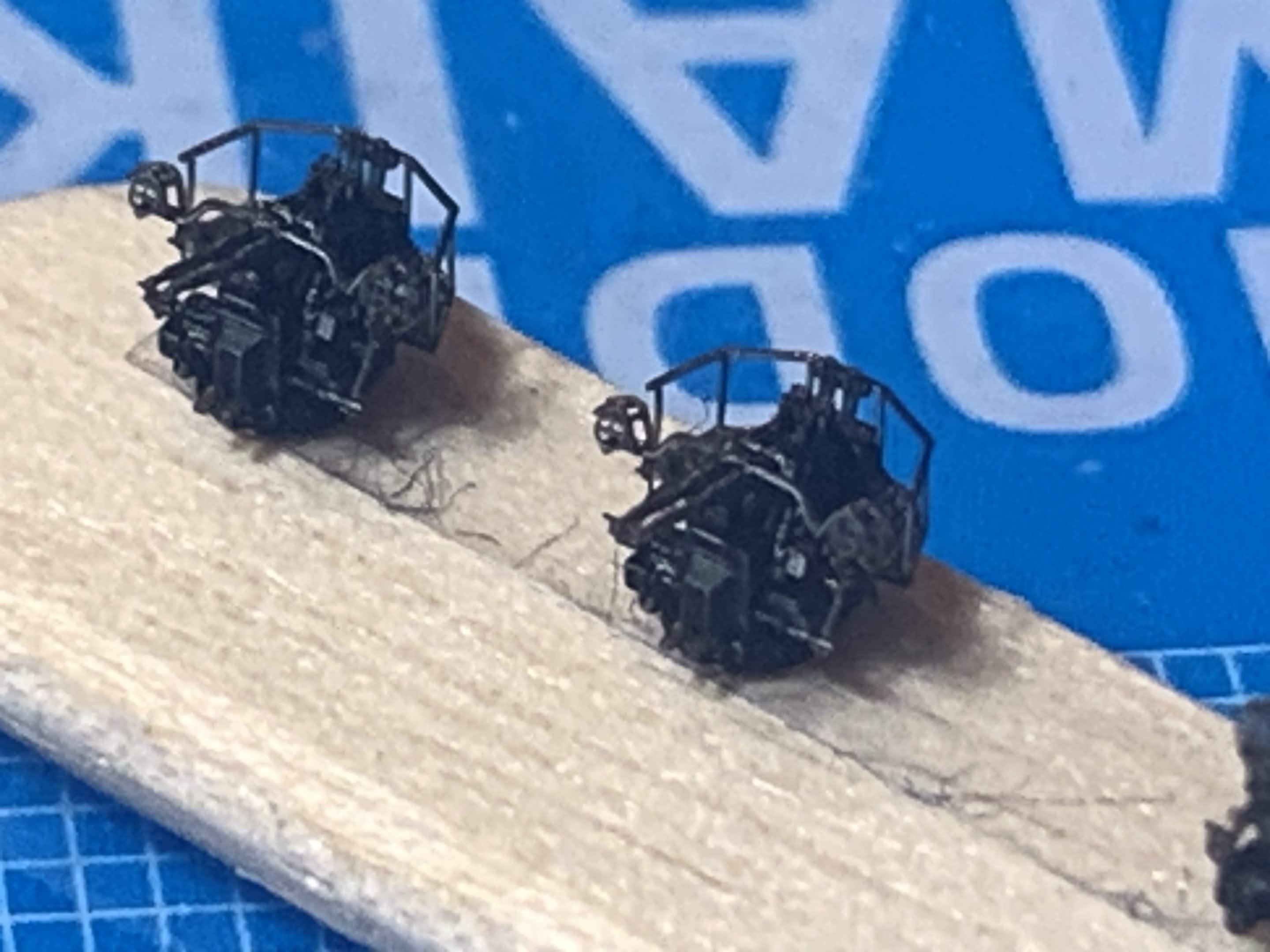

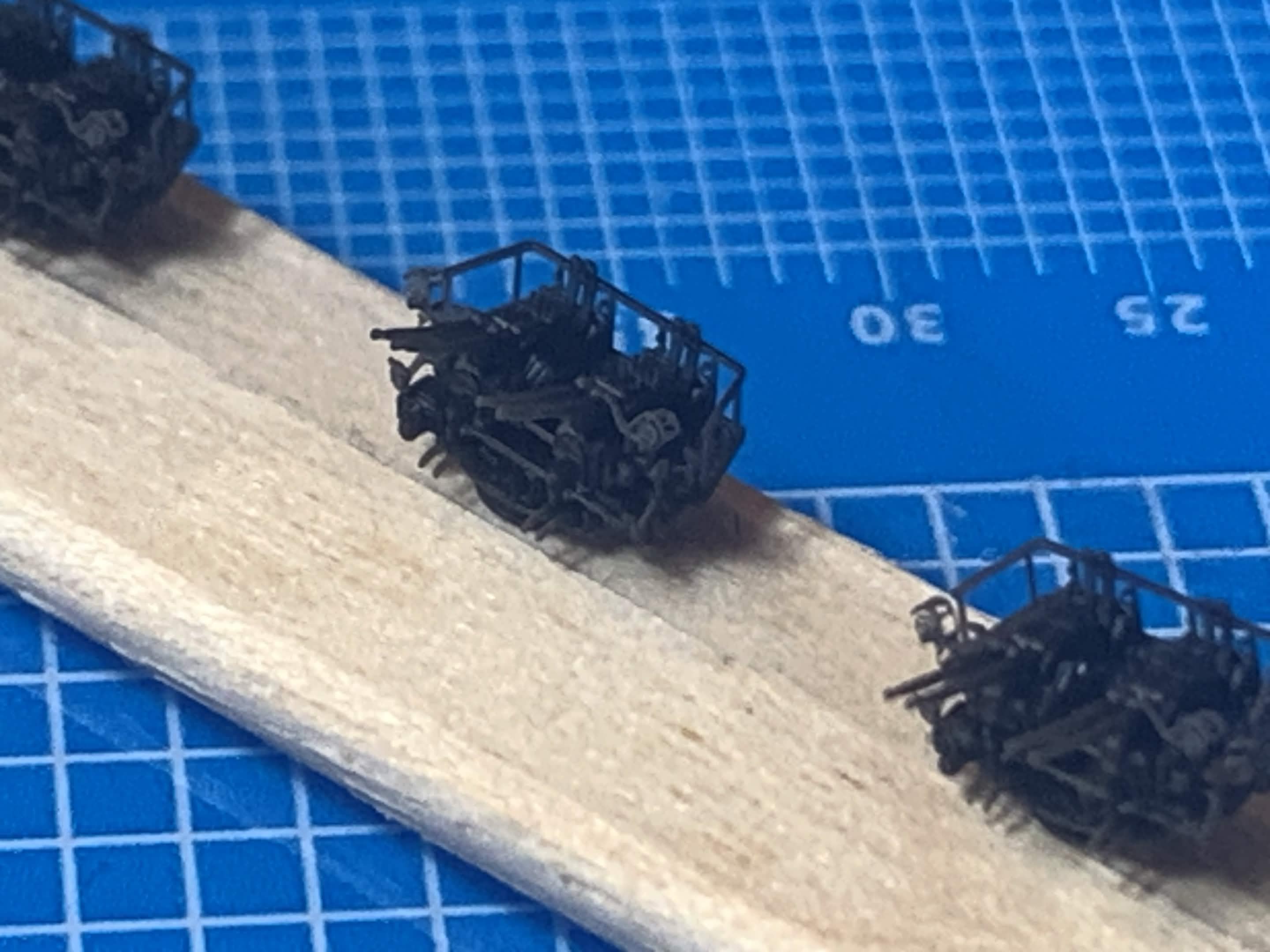

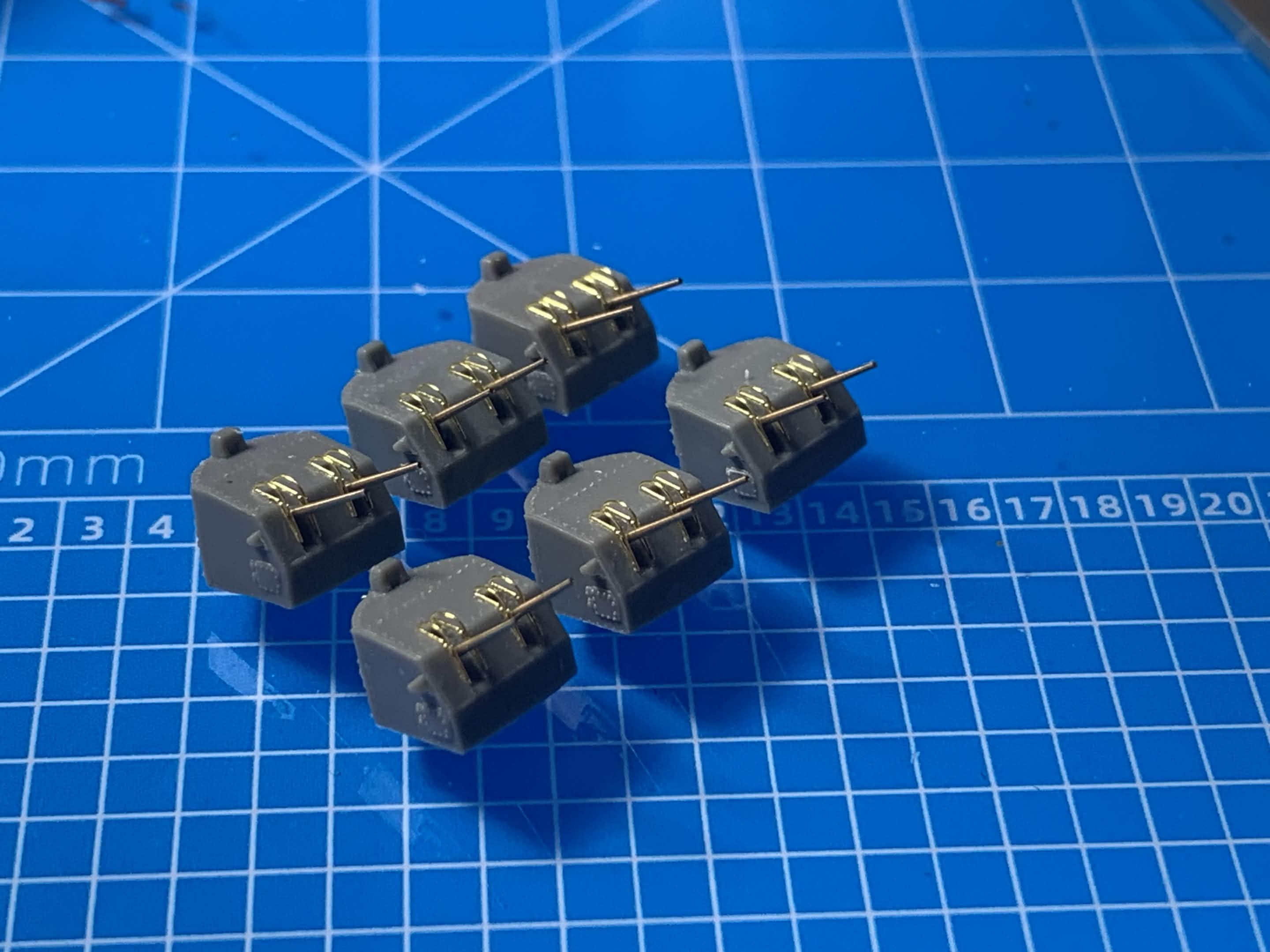

The included PE is reasonably comprehensive though I still opted for some add-ons including:
- 40mm bofors quad (bunker studio) and twin (muyi model) mounts
- 20mm oerlikons (serpent hobby)
- life rafts, boxes and OS2U kingfishers from various other chinese brands
Also intending to add figures (IONmodel) if time allows.
A word on the AA guns: I was really happy with these save for the oerlikons which have some nasty overscale rivets, will consider a different brand next time. Comparing the bofors, the Muyi mounts seem to have a little more detail but are also a lot harder to remove from their supports.

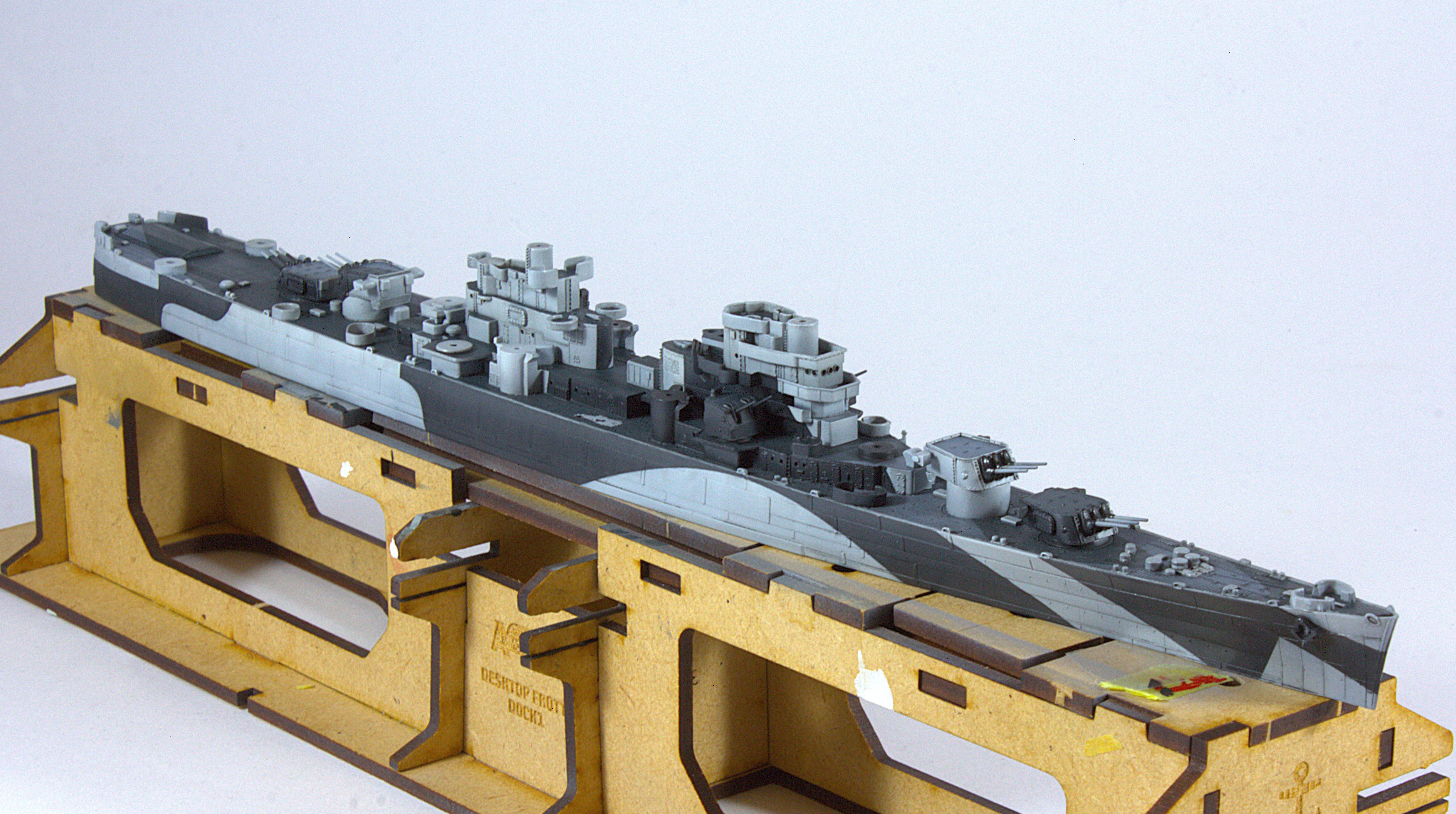

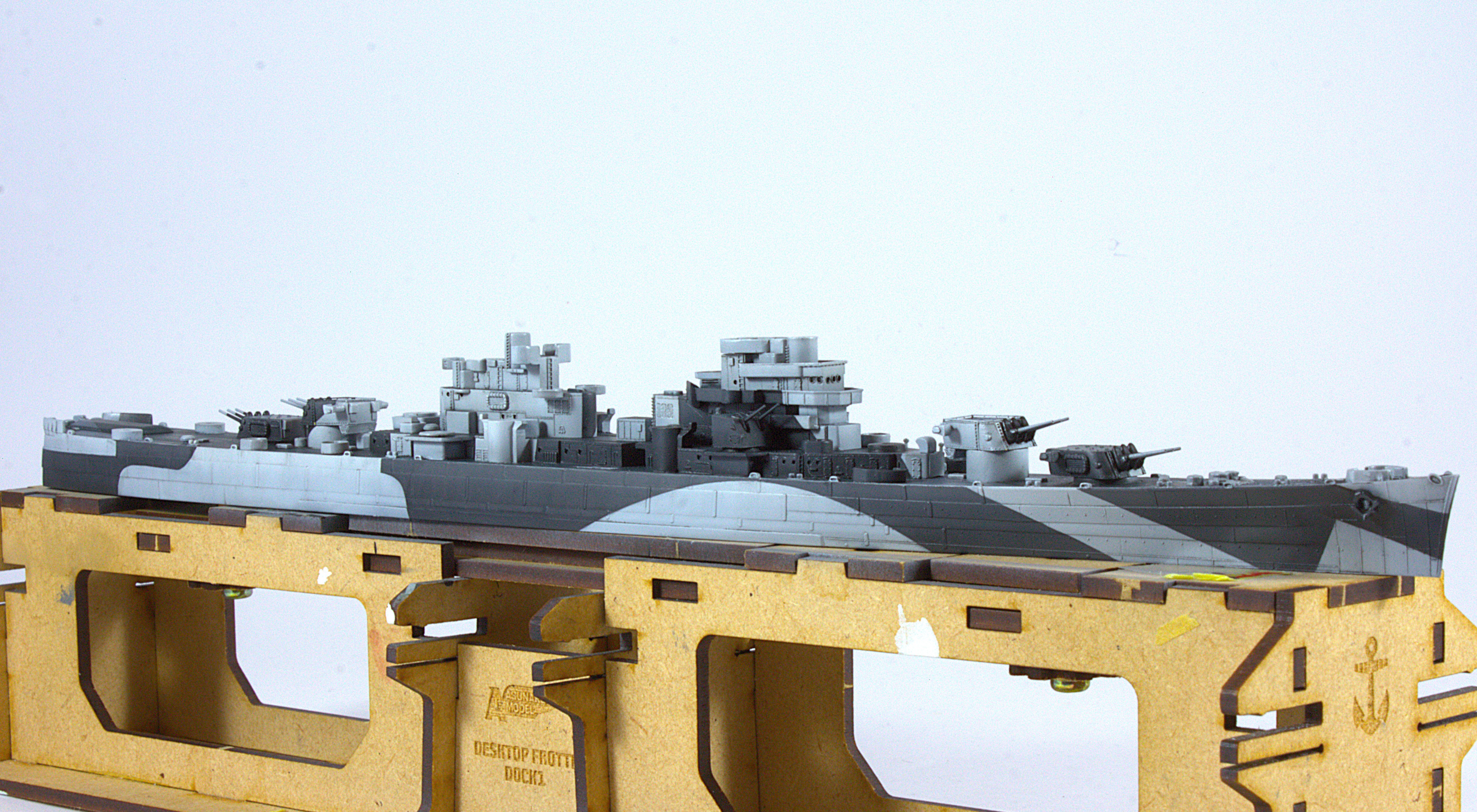

Re: USS Houston CL-81 (VEE Hobby 1/700 DX)

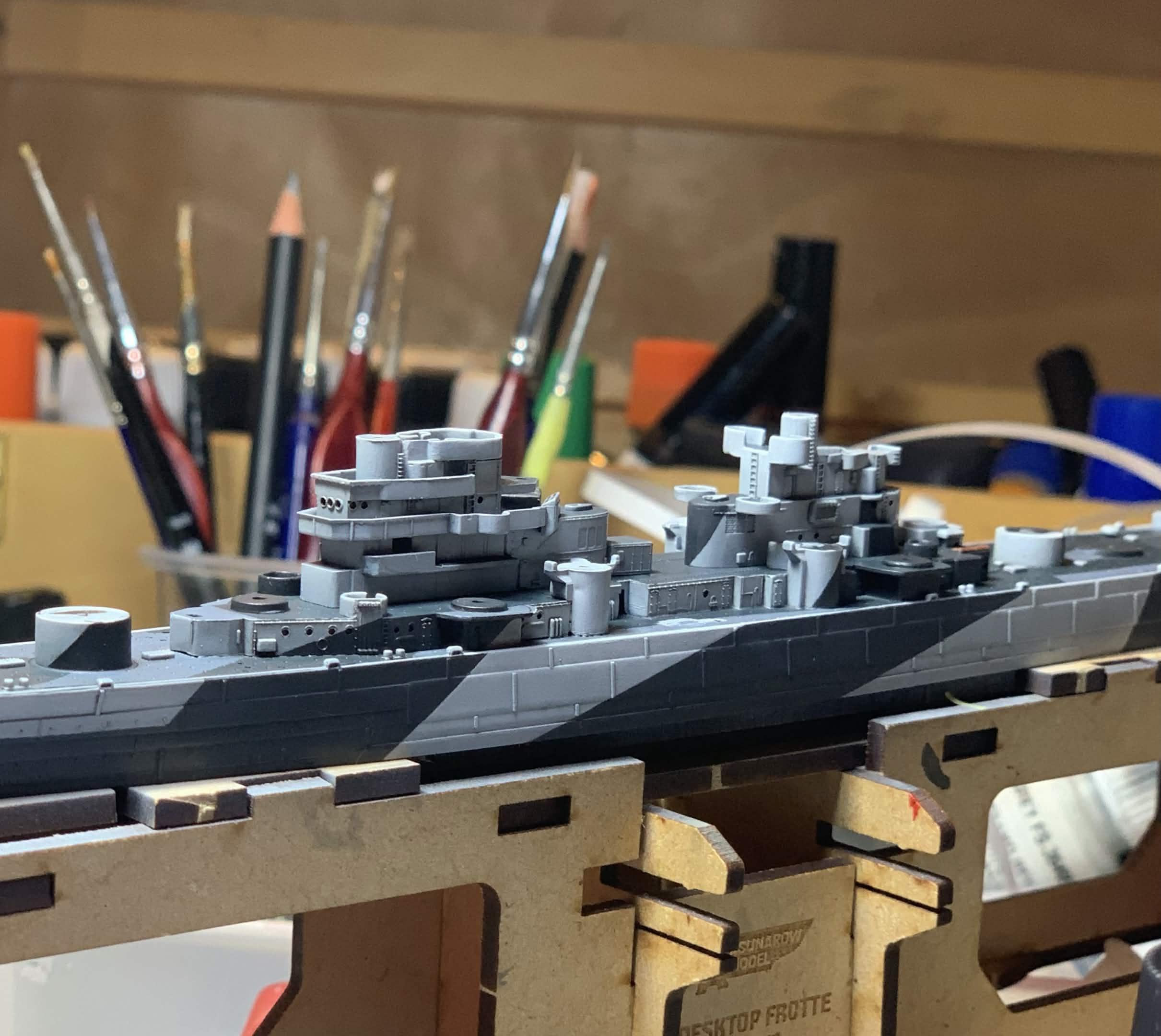

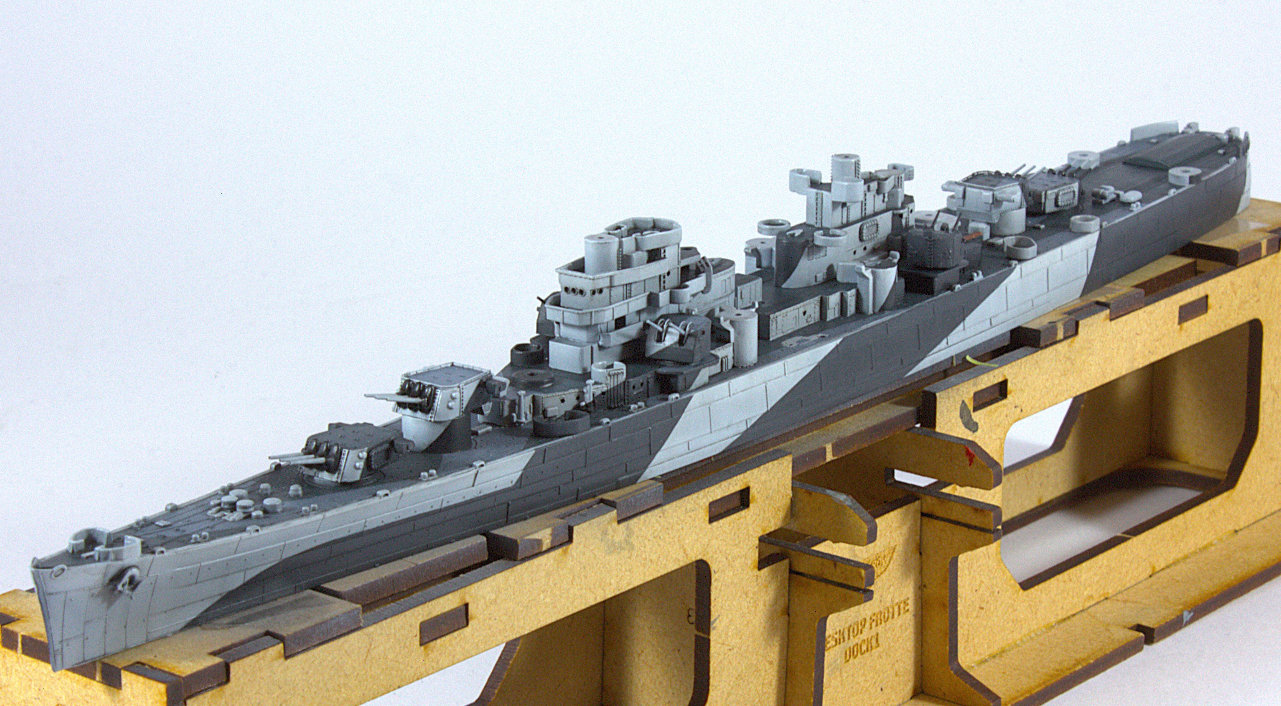

Quick stint with Houston in the photo booth.
At this stage I've only applied a wash, normally I would go over her with oils and get a more faded/worn look but I'm feeling pretty lazy and want to just get on to putting the rest of the thing together. Also, since the model depicts her not long after commissioning she would be fairly clean anyways. Let me know what you think.

- Posts: 9063
Coming along nicely.
- Posts: 8555
Agreed, she is coming along nicely.
- Joelle
- Posts: 219
- Joined: Fri Aug 12, 2022 8:50 am
- Location: Herdecke
It makes an excellent impression—even with just a simple wash.
