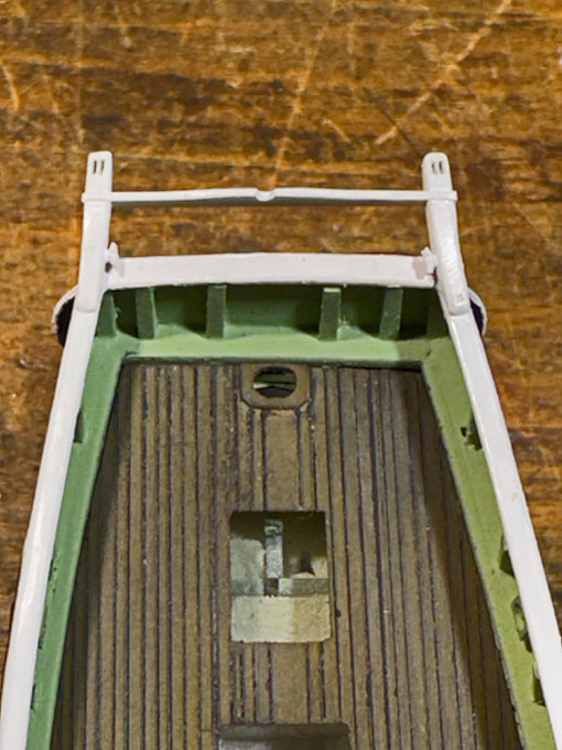

Nice paint work. About acrylic paint drying too fast, all marks of acrylic paint offer a 'retarder' that makes the paint dry slower without attacking the piant layer below it. Acrylic 'thinners' do attack older paint layers which can be useful sometimes, for weathering for example or for doing carrier decks. I used acrylic thinner on my HMS Glory.
- wefalck
- Posts: 2102
- Location: Paris
Re: Pomeranian Rahschlup 1846 � 1/160 scale � Baltic trader
Thanks, I am aware of 'retarders', but I have actually never used them, as the fast drying in most cases is a desirable property.
The Vallejo and Schmincke acrylics that I am using just require water for thinning. Other brands may use a mixture of water and alcohol as solvents and then one can use alcohol for thinning. Using an incompatable solvent for thinning can lead to a breakdown of the acrylic emulsions and coagulation. Acrylics using alcohol as solvent are likely to dry even faster.

Great job on the paintwork Eberhart! Especially the striping; not easy in this scale...
Another paint type that I find very useful for brush-applied basecoats that need adjusting (like the stripes or the stern carvings) is enamel. I always liked Humbroll, but with all the formula changes I prefer Revell nowadays.
Just like gouache, it can be removed or 'pushed around' with a damp brush (but white spirit instead of water of course) after application. But not forever like gouache, so it is best to apply a small area, adjust with the damp brush, paint the next area etc.
The main advantages over gouache: it is waterproof, so it doesn't need a protective coat, and it is easier to obtain a smooth surface.
I have also found that for detail painting, one of the most important factors is the quality of the brush. So far, I haven't found anything better than the Winsor & Newton series 7. Expensive, but such a joy to paint with...
When applying thin and long decals, it can help to cut them in shorter sections and apply those one at a time. Of course, that can make it a bit more difficult to make the line perfectly follow the curve of the sheerline without any minor kinks, which is really important for these lines.

Thanks, Marijn,
Indeed, enamels would have been an option, I still have a box full of decade old Humbrol tins. As I always stored them upside-down, they may be still good. However, I never liked the mess of cleaning brushes with them too much, even though I discovered early on in my life, that washing powder meant for wool (the German 'Rei') works very well and saves on expensive thinners.
The other option I had in the back of my mind was oils, but their long drying times is a drawback, also it can be shortened by using turpentine instead of lineseed oil as medium.
Good brushes help indeed. Unfortunately, sable-brushes are ruined quite quickly by acrylics and are not recommended. I usually use the Da Vinci brand synthetics. Buying brushes is another matter. Even in shops one often finds that they are already damaged.

ahoi wefalck
Looking nice!-- I also loathe masking for its--in my hands anyhow--lack of precision !
I think you may obtain a sharper definition / demarcation of the white lines using thin decal striping

Jim, I would have indeed used decal strips (as I did on SMS WESPE), if the colour didn't need to go around the edge of the wale. OK, perhaps a white decal strip and then painting over it and the edge ... I could still do that.

In between two heat-waves hitting Paris over the last three weeks I managed to overcome my lethargy and spend a bit of time in the yard.

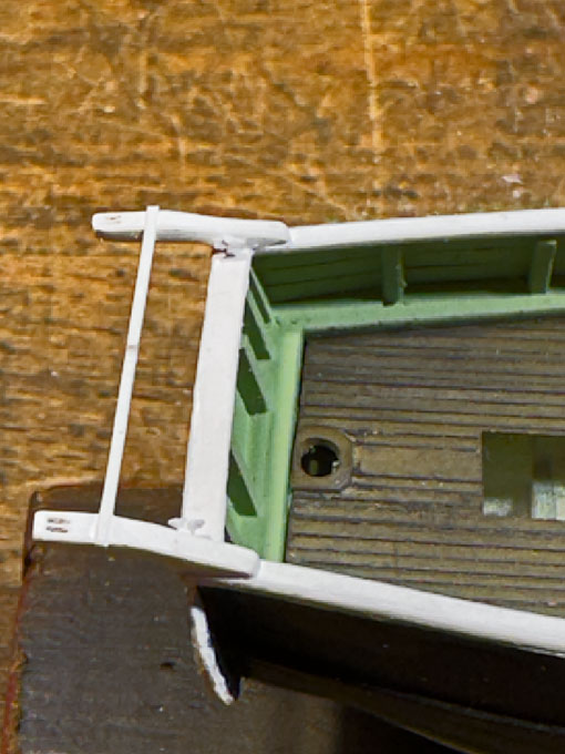

Stern-davits
Theses vessels typically carried a small tender in stern-davits. It was used for general work around the vessel and ferrying people and lighter goods between the anchorage and the shore.
The davits were fashioned from pieces of 2 mm x 2 mm styrene rod. In a first step, these were slotted with a 0.2 mm saw on the milling machine for the halyards. These slots than were capped with small pieces of styrene. Finally, the curved shape of the davits was elaborated with fine files. The davits were cemented onto the capping rails.
A connecting piece was fashioned from a pieces of styrene rod 0.5 mm x 1.0 mm. This piece also serves as a support for the boom, when it is lowered.
Two cleats for the boat halliards were carved from styrene strip and cemented to each davit.

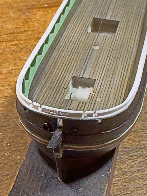

Bow monkey-railing
The capping rail at the bow on such vessels was surmounted by a kind of monkey-railing. Into this monkey-railing fairleads for hawsers and for the down-hauls etc. for the jibs are cut. This piece was bent from a 0,5 mm x 1,5 mm styrene strip, cut to length and cemented in place. The further shaping took place in situ.
With all these pieces in place, the rails etc. were painted white.
At this moment also the deck was permanently glued in place. Before that it was assured that the mast could be stepped at the correct angle and the hole for the mast opened to the correct diameter.
To be continued (heat permitting) …
